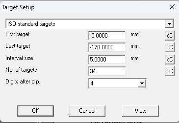

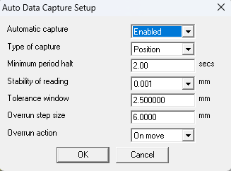

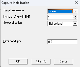

I'm trying to axis comp a machine with a Renishaw ML10 Interferometer. Unfortunately no matter what comp type or file formatting I can come up with I cannot get the system to take effect. The machine is repeating +/- .001mm on every step of the run.
I've been working on this for days and had no luck. I also can't get any feedback from HALSHOW that mentions it in effect or a component related to compensation. My understanding this a rolling backlash table to linuxcnc, hower the values never change. The man pages are extremely sparse, but strait forward. Name a file, stuff it with (Target) (POS Move) (Neg Move) and select a type 0 or 1.
Please help! I offer cookies of all types.

Just a guess, but I think your screw compensation table is backwards:
"Compensation files must start with the smallest nominal and be in ascending order to the largest value of nominals"
Last edit: 04 Sep 2025 17:00 by PCW. Reason: sp
- Posts: 21190
- Thank you received: 4658
04 Sep 2025 16:43 #334416
Replied by andypugh on topic Axis_Comp having no effect
If the comp table is backwards then the interpolator function will only ever read the first value, so you will get a fixed offset, and no apparent compensation.

I'm happy to say, I was just being dumb and -5 was lowest number in my head except it was negative so it was obviously the highest number. I also spent a bit of time playing with spreadsheets and the raw RTL file and it was easy make a mistake shuffling data.
