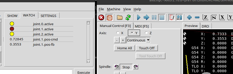

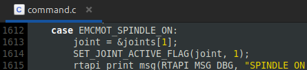

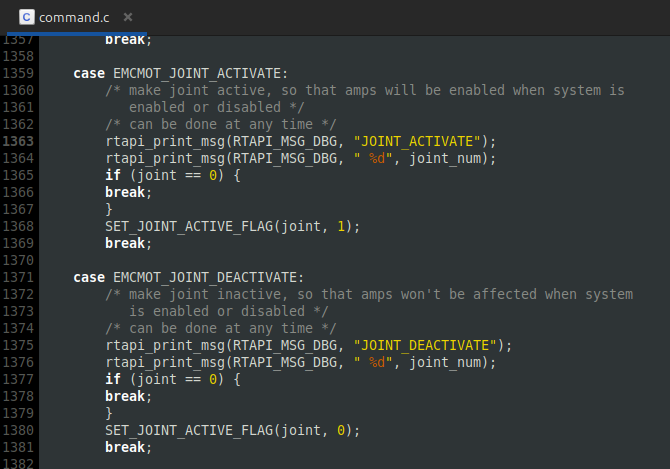

02 Apr 2026 17:44 #345069 by Aciera
Replied by Aciera on topic CSS/G96 for other than X-axis?
Not sure if there is an easier way of trying this but I inserted the the actions of 'EMCMOT_JOINT_ACTIVATE' / 'EMCMOT_JOINT_DEACTIVATE' (ie set/reset 'SET_JOINT_ACTIVE_FLAG' for a specific joint :
into 'EMCMOT_SPINDLE_ON' / 'EMCMOT_SPINDLE_OFF':
Which lets me clear 'joint.1.active' using the spindle control but it does basically the same as disabling the drive as 'joint.1.pos-cmd' is still updated as the axis is jogged or commanded through the interpreter:
The problem with the following error when reactivating the joint remains the same as if it was done in hal or the drive disabled.
