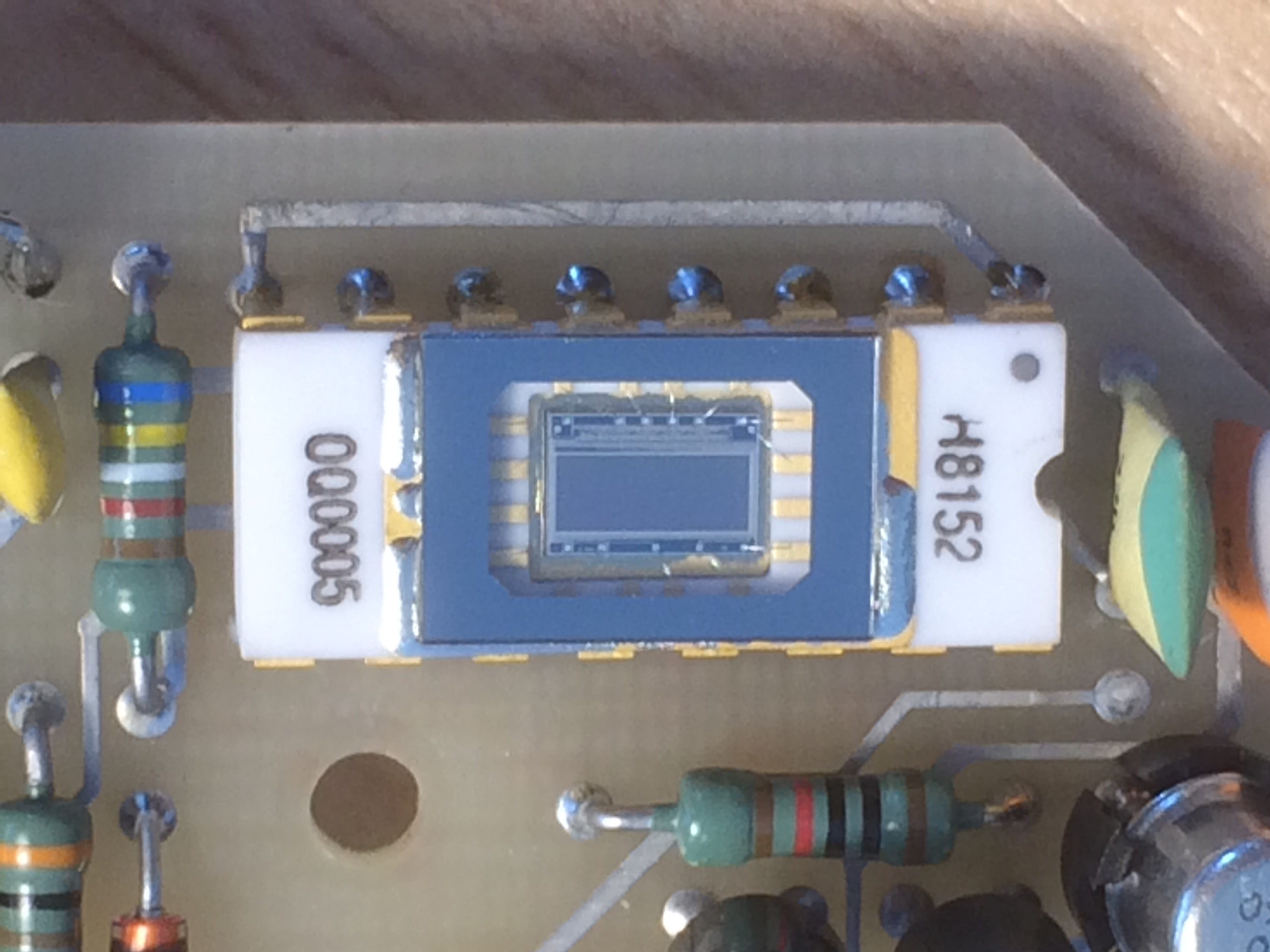

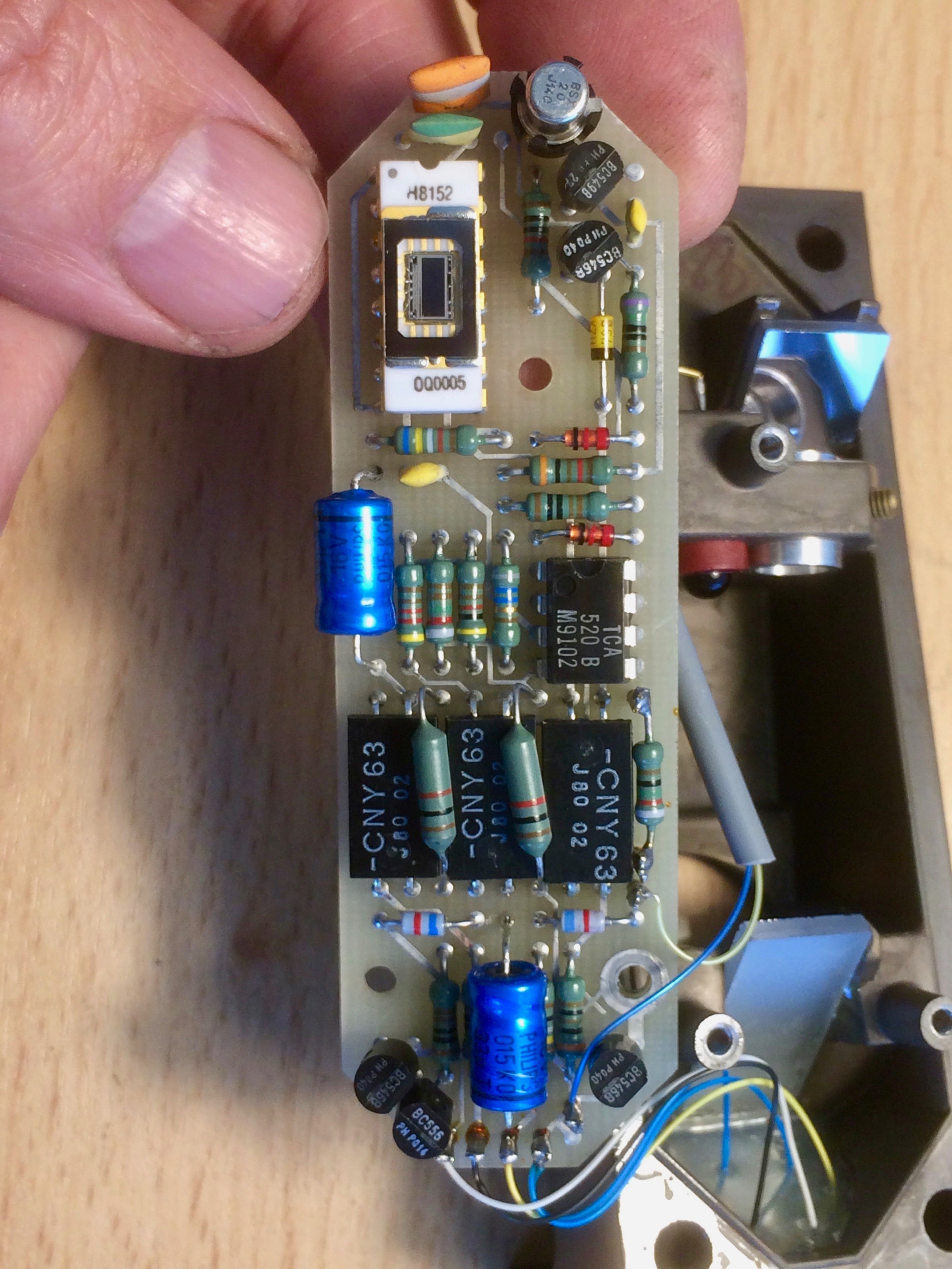

My actual problem is a PE 2480/10 ( 9418 024 80101 ) Messkopf Lesekopf reading head is defective.
Fault was that Z-Axis was noisy - hardly following the commands by the control - sometimes humming / jumping up and down by 0,2 mmtrs approx. . Interchanged Y and Z reading heads and found that problem was with the reading head (fault changed to Y-Axis.
Since defective anyway, opened it up , measured checked the lines on the plug , -seem to be within the voltage areas as per diagrams by Nick Müller / Sascha Ittner. Checked voltage across light source :1.34 Volts across the led , Voltage before serial resistor 10.6 Volts , Resistor 820 Ohms, current 10 mA approx. . According to this voltage drop it should be a IR - LED of longer wavelength (type unknown). After remounting the reading head to the machine , the Y reading did not work. To verify cable and electronics on Y-Axis mounted back good known reading head and working well. So probably I killed a component on the board completely - possibly the diode array by static.
My questions are:
Does anybody here have
1) further docs (internal diagram) of this reading head ?
2) Setup handbook for this measuring system (Philips) ?
3) Type and source of the Infrared - LED used ?

What I could not yet find is a source for this opto scanner ic -
it is referred to as
OPTO SCANNER
Type : OQ 0005 as documented in the above thesis, stamped as OQ0005 on my ic (see attached photos)
Maker: unknown
Housing : DIL 16 Pin Package SOT-84 ceramic with glass window
Technical data
General
Crystal size 4.9 x 3.5 mm x mm
total sensitive area : 1,8 x 4.4 mm x mm= 7.92 mm x mm
Pitch of the photodiodes : 20mym
Number of groups of photodiodes : 10
Number of photodiodes in a group: 22
Supply voltage max 11V here 8,4 V used.

Hi Ralf,
Have you read my quite long thread over at Practical Machinist? The "fix your maho thread"?
In there you will see that most of us have given up on the Philips read heads, as they don't give out a normal quadrature or any known pattern, but have their own proprietary way of doing this that makes it rather difficult to use for retrofitting to a different system.
Sorry to give you this information, I know most others who have converted their Mahos with these scales have replaced them with standard ones.
Too bad though.... the Heidenhein ones are so fantastic! With the correct converter (EXE) boxes found cheaply on ebay you can get sub-micron resolution. I have 0.1 um resolution on mine now. And I do have the original correction sheet from the manufacturor I can insert in a correction file.
One important thing worth knowing: What year is your machine from, and does it have brushed DC or brushless servos? This is a rather big difference!

Yes , these units have their own kind of output - some kind of PWM modulation as per description by Sascha Ittner (pdf on Github , diagrams recorded by Nick Müller).
If I should convert to Linixcnc , I would like to keep the Philips heads with Sascha´s solution (Head through wall
But at this time I just want to make it work again with the original system.
And yes - brushed motors Indramat (8 Brushes each tacho + motor)
And there is a company in eastern Germany that can repair these heads - at a price I guess I am not ready to pay.
So I bought a used one today for 150€ and hope that will be it for the moment.

Still I would like to know who the maker of this photo array was and if it is still available ....
