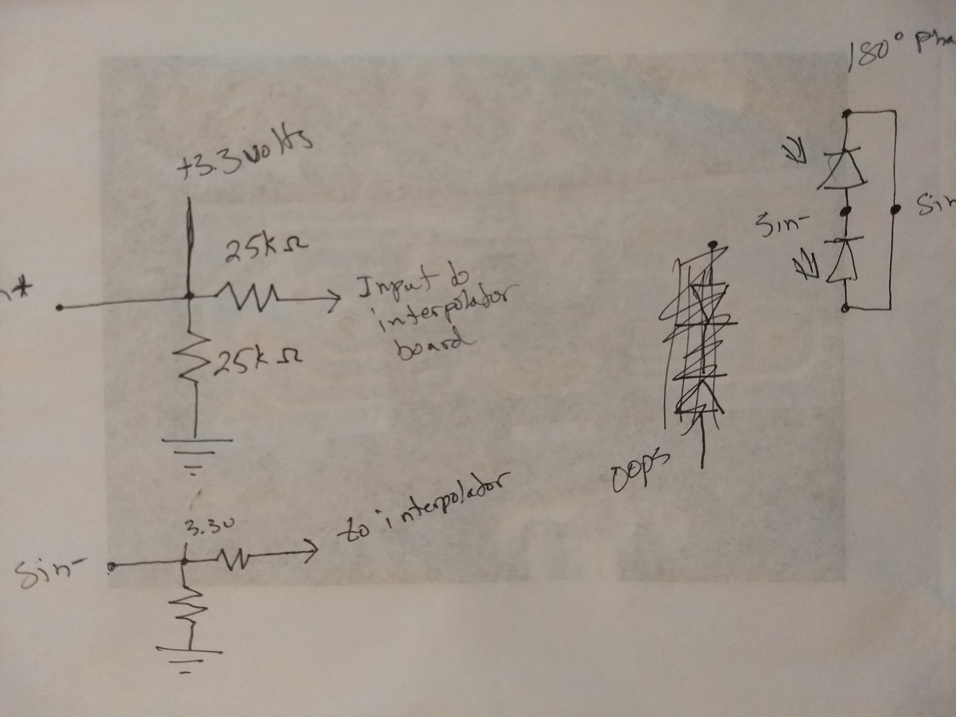

Finally have a chance to get back to the linear scale integration project. The suggestion for the 15 micro amp output is to:
'But a simple current-to-voltage converter will do it, for instance biasing each input with a voltage divider (e.g. 2x 25k) between 3.3V to GND.
This terminates the 11 µA current output and delivers 437 mVpeak (by 12.5 kOhm). As the level does not undershoot 1V, I think it's not a problem for the sensor's output.
Is the following sketch what is being described above?
Thanks.
Thanks.

02 Nov 2018 17:56 - 05 Nov 2018 12:25 #119839
by RotarySMP
Replied by RotarySMP on topic Deckel Maho NC Integration FP5NC Ideas
Are these Heidenhain encoders? How did Deckel interface them? MAHO used Heidenhain EXE's, and I would suggest you do the same. I just got one off eaby for €64, and it has the correct connector for the Heidenhain cable, and worked perfectly once connected with the MESA 7i77.
Mark
Mark
