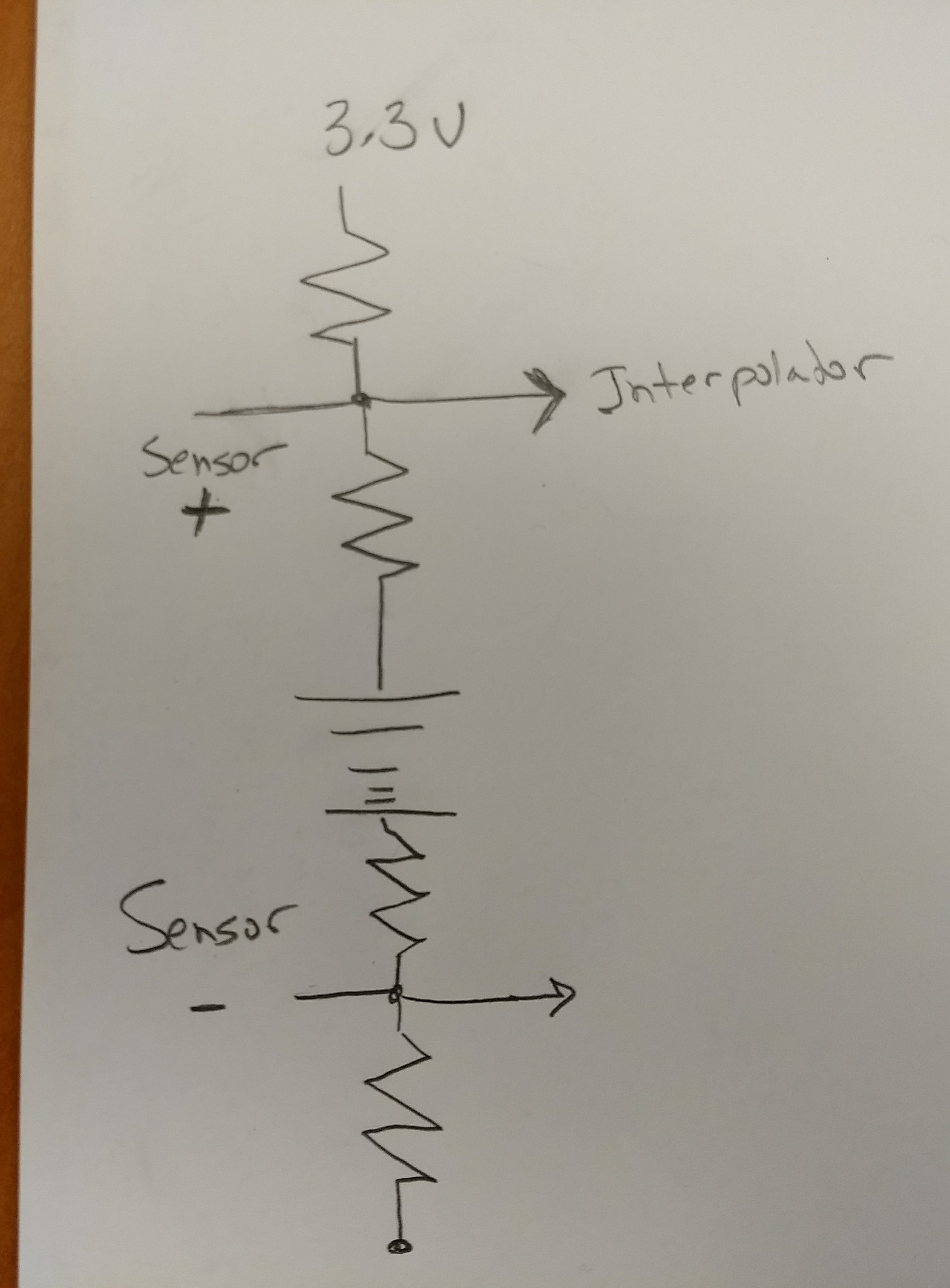

Will the attached sketch do what is described here:
'...... bias each input with a voltage divider (e.g. 2x 25k) between 3.3V to GND.
This terminates the 11 µA current output and delivers 437 mVpeak (by 12.5 kOhm). As the level does not undershoot 1V, I think it's not a problem for the sensor's output.'
Noticed the pic cut off the left side of the sketch. I have my sin+ and sin- inputs there.
Last edit: 05 Nov 2018 19:52 by gernoff.

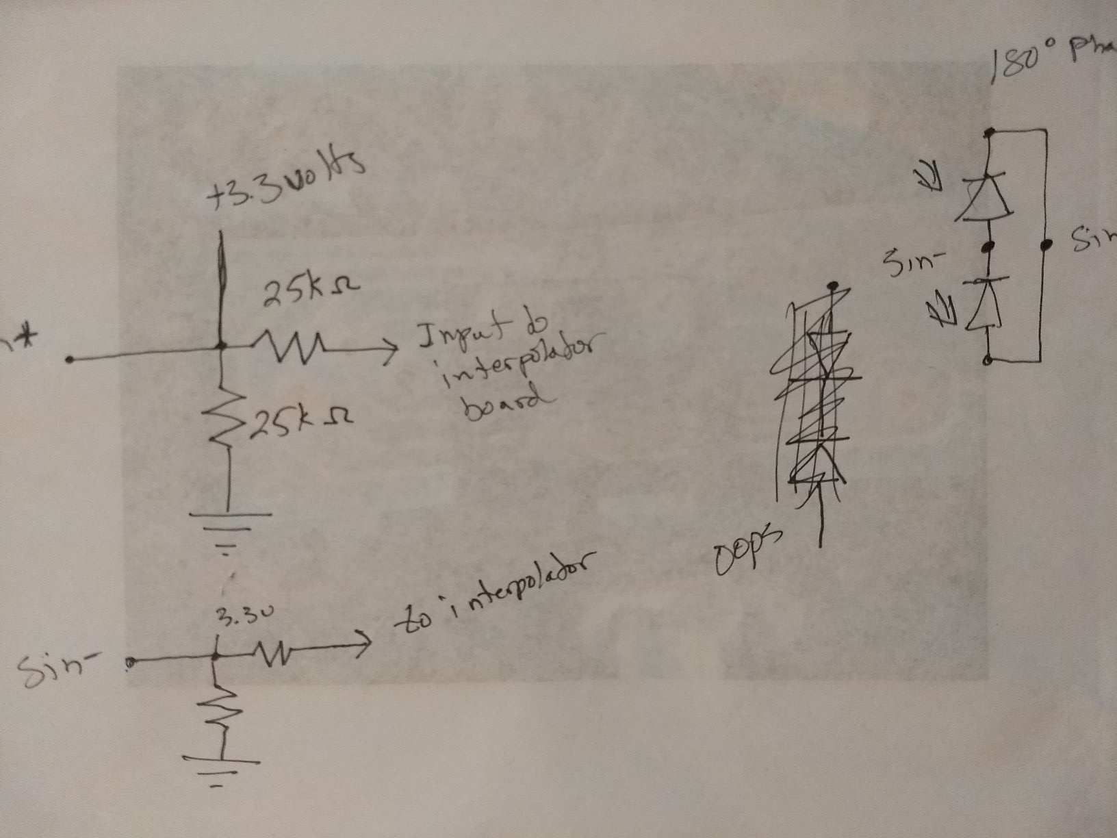

05 Nov 2018 19:54 - 05 Nov 2018 19:55 #120029
by gernoff
Replied by gernoff on topic Deckel Maho NC Integration FP5NC Ideas
Added a sketch in the post above of what I think the guy is describing.
Last edit: 05 Nov 2018 19:55 by gernoff.

07 Nov 2018 14:37 #120169
Replied by andypugh on topic Deckel Maho NC Integration FP5NC Ideas
That's not how I would interpret the words into a circuit diagram.
Can you link to the original post? I can't find it.

07 Nov 2018 20:13 #120197
Do that for both inputs ( total 4 resistors ).
I did not do the math, but it should be ok.
Replied by tommylight on topic Deckel Maho NC Integration FP5NC Ideas
That in the sketch is not what he is describing. It says to have 2 resistors in series between +3.3V and GND, use the middle of them as input/output.Added a sketch in the post above of what I think the guy is describing.

08 Nov 2018 22:52 - 08 Nov 2018 22:52 #120296
by gernoff
Last edit: 08 Nov 2018 22:52 by gernoff.
- Posts: 21831
- Thank you received: 7454
09 Nov 2018 06:45 #120311
Yup, that should do it.
- gernoff
- Posts: 43
20 Nov 2018 18:52 #121081
by gernoff
And yep; you are correct! The circuit as show above is working fine.
Thanks for the help people.
