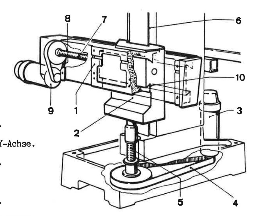

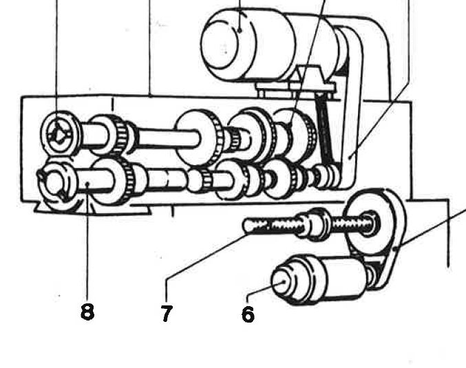

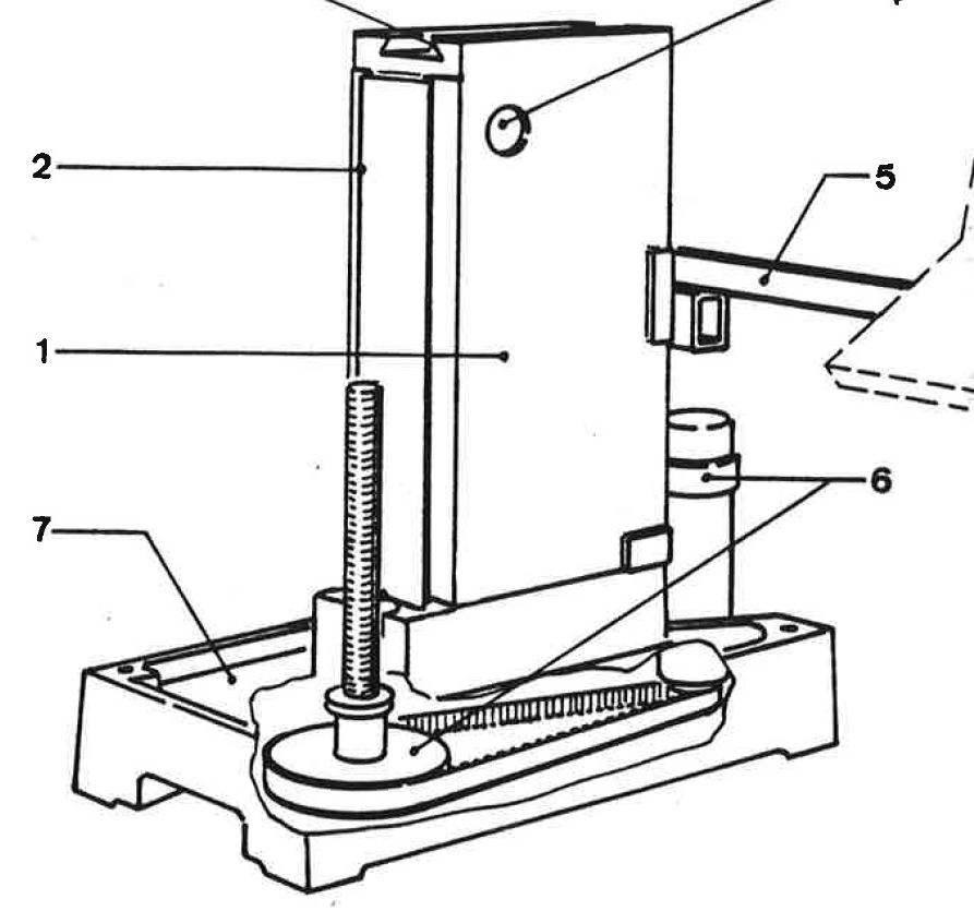

The ballscrews on the 400E are very simple and conventional. 32x4 mm on the head traverse Y axis (MAHO's Z), and 40x5mm on the X and Z (vertical) axis. Each axis is belt driven with HTD 8Mx30 belts. You can see the difference in stiffness of a professionally engineered system verses the compromises we normally make as hobbiest. The screw support bearings are simple bolted and pined end plates, castings. Only the X axis is supported at both ends.
Here are the diagrams from my owners manual. The only axis with a brake is the vertical (lets call it Z) axis. It's drive belt is underneath the foot. Given this simplest possible layout was good enough for Maho I wouldn't complicate it. Belt reductions make for simple alignment, and at least on X you probably wont have space for a rotating nut.

Last edit: 17 Oct 2019 17:34 by RotarySMP. Reason: Added picture of Y axis drive
