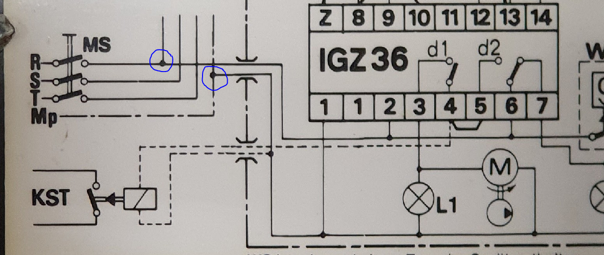

Placeholder to upload the central lube pump info...
Edit: TOT contacted me over Youtube comments with a couple of questions to regarding the Lube unit and the spindle brake. I'll answer here as I can embed diagrams...

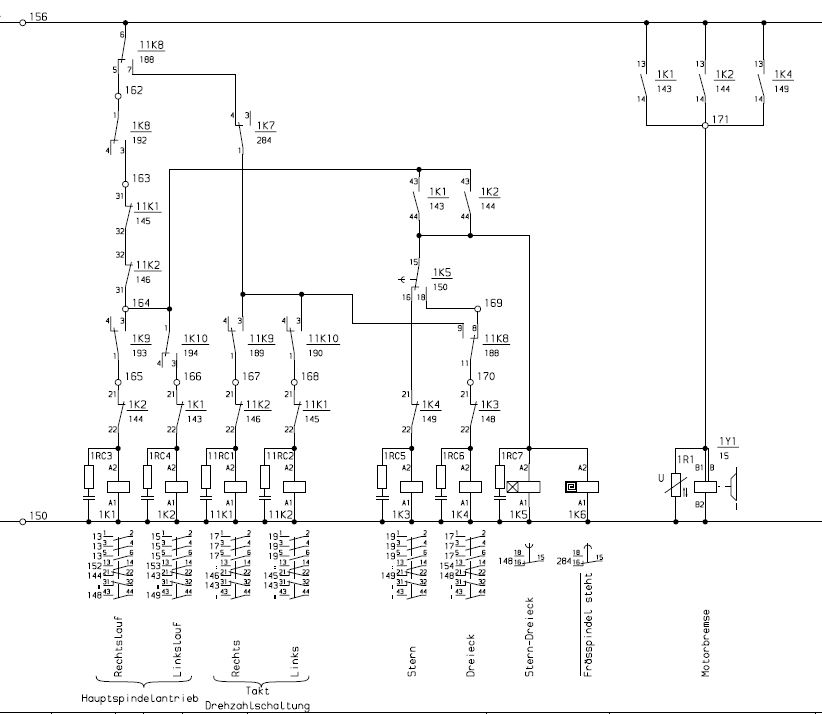

Hi Tony,
I am guessing they put a brake on the main spindle motor, to save time in production. No waiting for the spindle to run down from 4000 rpm.
My Maho's main spindle control is surprisingly complex.
CW or CCW is controlled by 1K1 and 1K2
11K1 and 11K2 bring in the 90V 3Ph to twitch the spindle during gear changes
1K3 and 1K4 are on a timer to start in Star before switching to delta for a softer start.
Of more interest to your project...
Maho used secondary contact on any one of 1K1/1K2 or 1K4 to open the brake (Motorbremse) any time rotation was commanded. The brake itself is 110VAC so it will be easy enough for you to control it. Your VFD probably has a output which changes state whenever rotation is commanded, so that could drive your brake release relay. If you ripped everything out of your control cabinet, you should have an assortment of quality relays to choose between

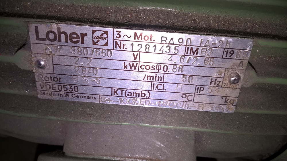

Èdit:This is the dataplate for my spinde motor.
If yours is different, it might be prudant to first try 24VDC onto that spindle brake just in case it is not designed for 110VAC on your model.

For the lubrication system of the maho "Vogel" it´s very important to know that the Pump is impulse controlled.
If you set the Relay for the pump in it´s active state, the pump will start running and push ONCE some oil into the system. If you keep the relay high the pump will only heat up.
So you have to pulse the pump every 5 minutes or something like that.
I´ve done that with some easy classic ladder.

Thanks, but there are different pumps with different control logic. Mine runs for 15sec ever 20 minutes, so it receives no control logic, just power.
