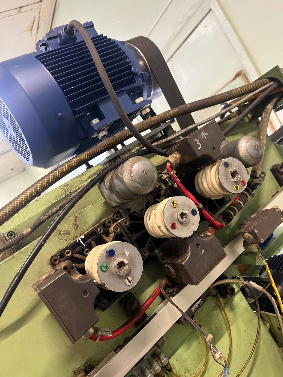

- Tserakhau
- Posts: 4
07 Apr 2026 06:36 #345252
by Tserakhau
Replied by Tserakhau on topic Retrofitting a 1986 Maho MH400E
Good afternoon.My name is Victor, and I'm restoring a MAHO 600E milling machine and converting it to Linux (the original Philips operating system).Thank you so much for this thread; many questions were resolved using the forum.I received the machine without a spindle motor, coolant system, and most relays.I've already done almost everything; the machine moves and finds its home position.I installed and tested the speed control box; all speeds shift perfectly! (The box is completely identical to yours, although the motors are installed slightly differently.)I've also already configured the lubrication system, hydraulic clamp, and MPG control panel.My question is: what needs to be done next after setting up the simulator? How do I implement this into the .ini or .hal files?I apologize for any inaccuracies in the text of this message; I'm using Google Translate because my English is poor.

07 Apr 2026 14:00 #345268
by RotarySMP
Have you already compiled the gearbox comp? I have attached my HAL and Ini files, so you can see the pins you need to connect.
Cheers;
Mark
