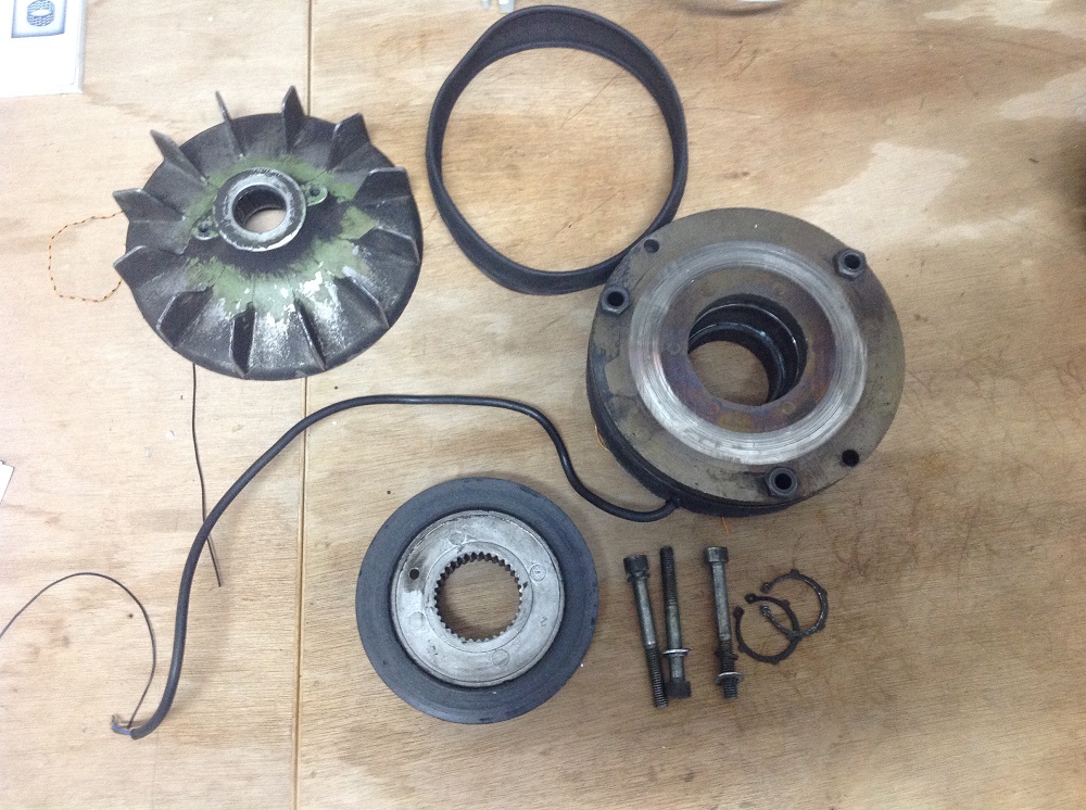

04 Oct 2017 20:06 #99938
by drimaropoylos
The best is to keep the break for safety reasons, but the perfect place for the encoder is in breaks position. I have already removed the break to measure the space between motor and cooling fan.
John

Please post photos of the removed brake and the motor shaft.

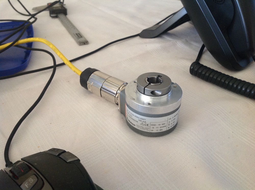

I have feed the spindle-vel-cmd-rps-abs to ladder and with comparison items i have managed to start the sequence for select the appropriate gear, at the same time I am feeding from ladder the spindle-at-speed so the motion on all the axes pauses until the gear change is complete. I need to put some timers to delay the gear change until the brake of the motor stops the spindle completely, and make some careful examination of the ladder file for bugs and I will post the files.
This is the encoder I will put on the spindle motor at the end of the shaft so I can keep the brake for safety reasons.
I was planning to post some pictures of the brake but the usb stick has fall on the elevators holeā¦lol
John
John

Whn you talk of "Spindle at speed" signal, was this signal generated from that encoder, or frm the VFD, or is it just an assumed value based on the worst case time for the spindle to accelerate. The MAHO set up can't generate that signal as built can it?
Mark
Mark
