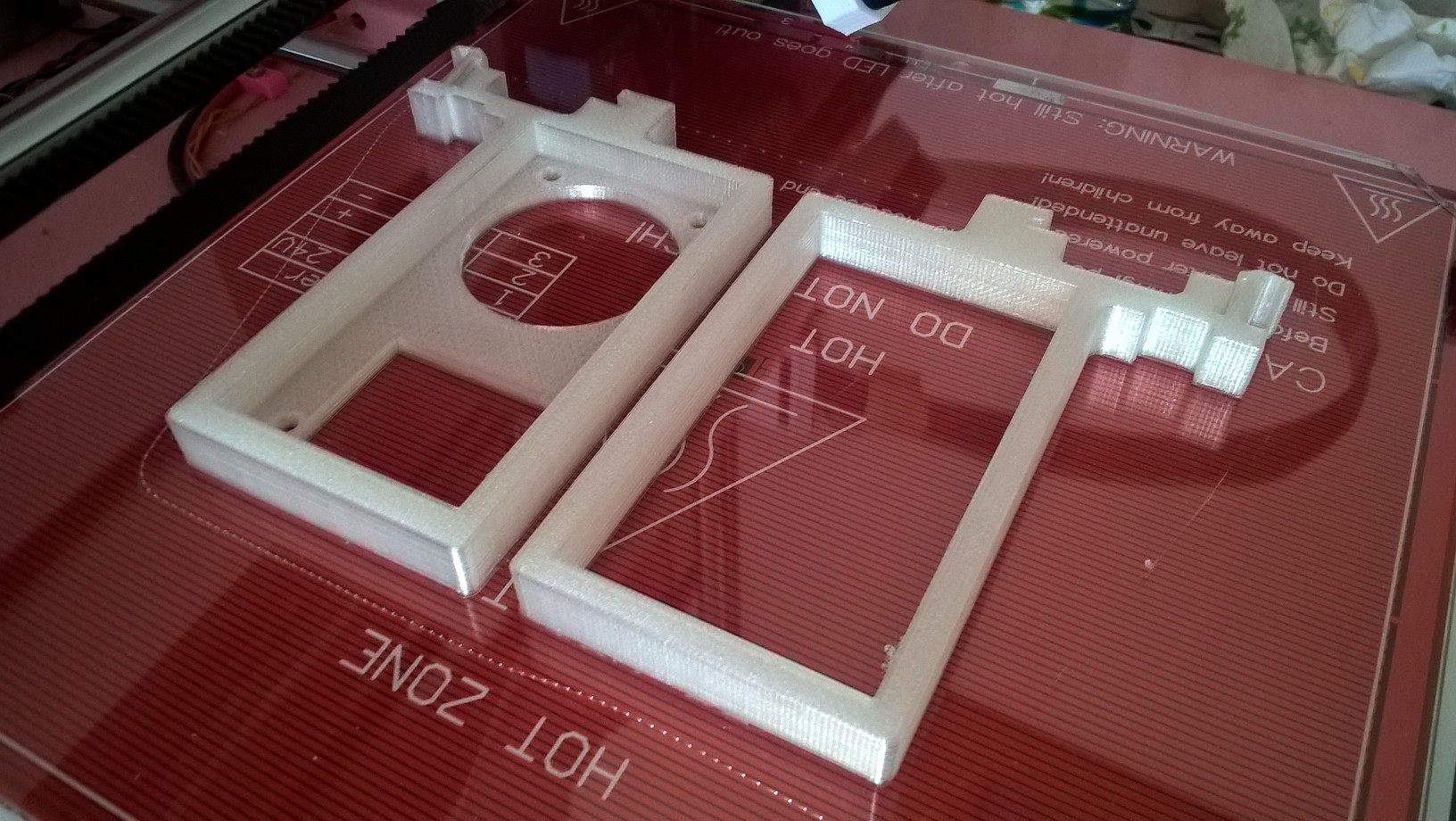

I printed out some brackets to mount the ITX PSU to DIN rail, but screwed up a couple of measurements and will have to print them again.

07 Oct 2017 17:23 #100053
by drimaropoylos
3d printer… nice thing to have.
John
