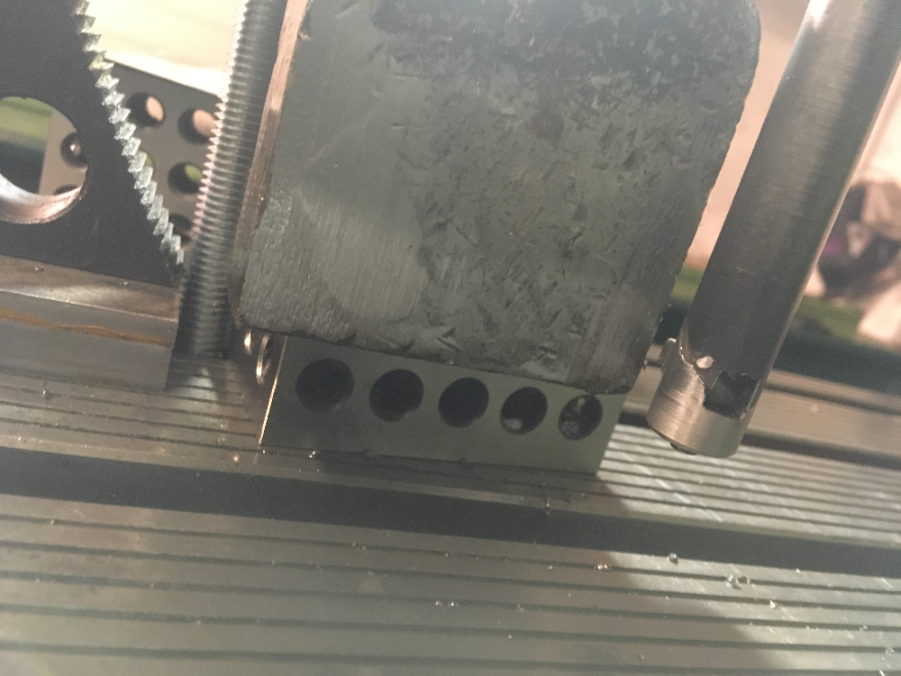

08 Jan 2019 01:35 - 08 Jan 2019 01:42 #123756
by RotarySMP
I need to surface this old anvil, but clamped to the table it is not high enough to reach it with the horizontal spindle. Good excuse to have a play with the slotting head. I ground up a cutting tool with quite positive rake to keep the cutting forces low. The stoke on the slotting head needed adjustment to the maximum of 80mm, which limits the stroke rate to 50, so I used 40 rpm / 40 strokes/min here. 0.1 Ap- depth of cut, and 10mm/min feed rate.
Only got the first pass done yesterday, and it looks like there might be hard spots in the surface, so I might have to give up on shaping it. I'll do a couple more passes and see. Sorry about the crappy photo, but I had to reach behind it with the phone.
Mark
Mark

Also Mark, I haven't the faintest clue on how to use a shaper but it's really cool you can do that setup! Prior to your mentioning it, I've never seen anybody use that attachment before.
- Posts: 19908
- Thank you received: 4660
08 Jan 2019 06:56 - 08 Jan 2019 06:57 #123774
They are often called a "slotting head" as they convert the mill to a slotter.
www.lathes.co.uk/rothley/
Typically used for keyways and splines.
There is a slotting head for my Harrison mill, but I let one escape on eBay last year and haven't seen another since.
But I have been giving seriois consideration to making my own from scratch, with the added feature of a CNC rotation for the cutter.
This would allow for the generation of internal gears like this:
However I don't think that there is any need for the 5th axis, circular interpolation ought to work just fine.
I think that to re face that anvil I would have used the lathe and 4-jaw chuck, though.
