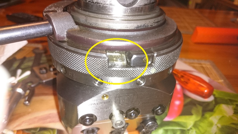

I have one UPA-4 that has been in storage for a while and now I have issues with the 12 push buttons that will not release.
These buttons have been pushed in and been so for some years (I have never used this head yet!)
Have been following manual but I get no response at all, does anybody here have a UPA-4 that might have tips and tricks for the boring head?
Grateful for any assistance I can get.
Cheers
Bengt
Cheers
Bengt

Have you tried giving it a good cleaning and soaking it in penetrating oil?

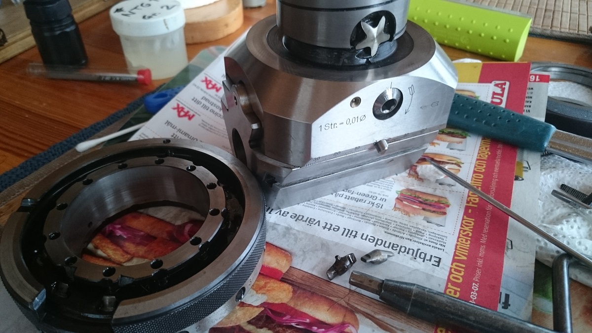

Ongoing soaking, was a bit *stiff* but all parts moving except the release ring for the buttons.

06 Feb 2018 12:24 - 06 Feb 2018 12:25 #105500
by tecno
Replied by tecno on topic Wohlhaupter UPA-4 push button issues
Last edit: 06 Feb 2018 12:25 by tecno.

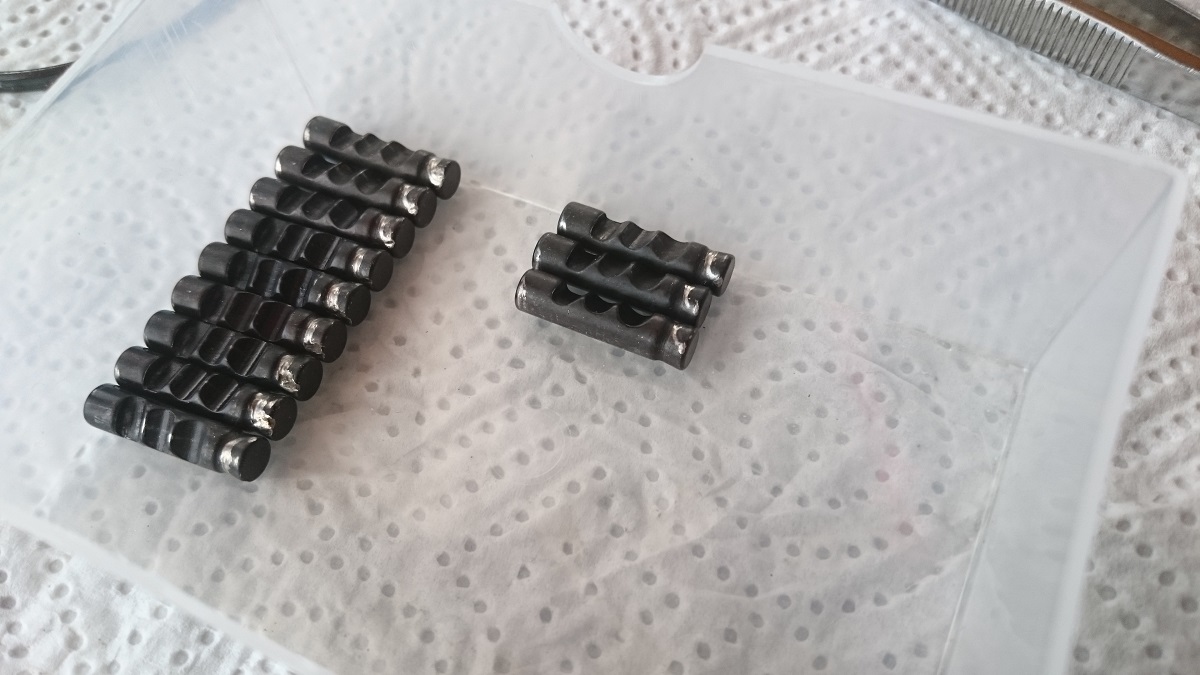

Here are the pins, they are badly worn in the end that connects to the star wheel.
Have contacted Wohlhaupter in Germany to hear if they have spare parts to reasonable price.
3-4 out of 12 are OK.
Now all parts cleaned and greased/oiled awaiting final assembly with new pins.
As I see it the main reason to the faulty behavior is lack of grease and oil.
