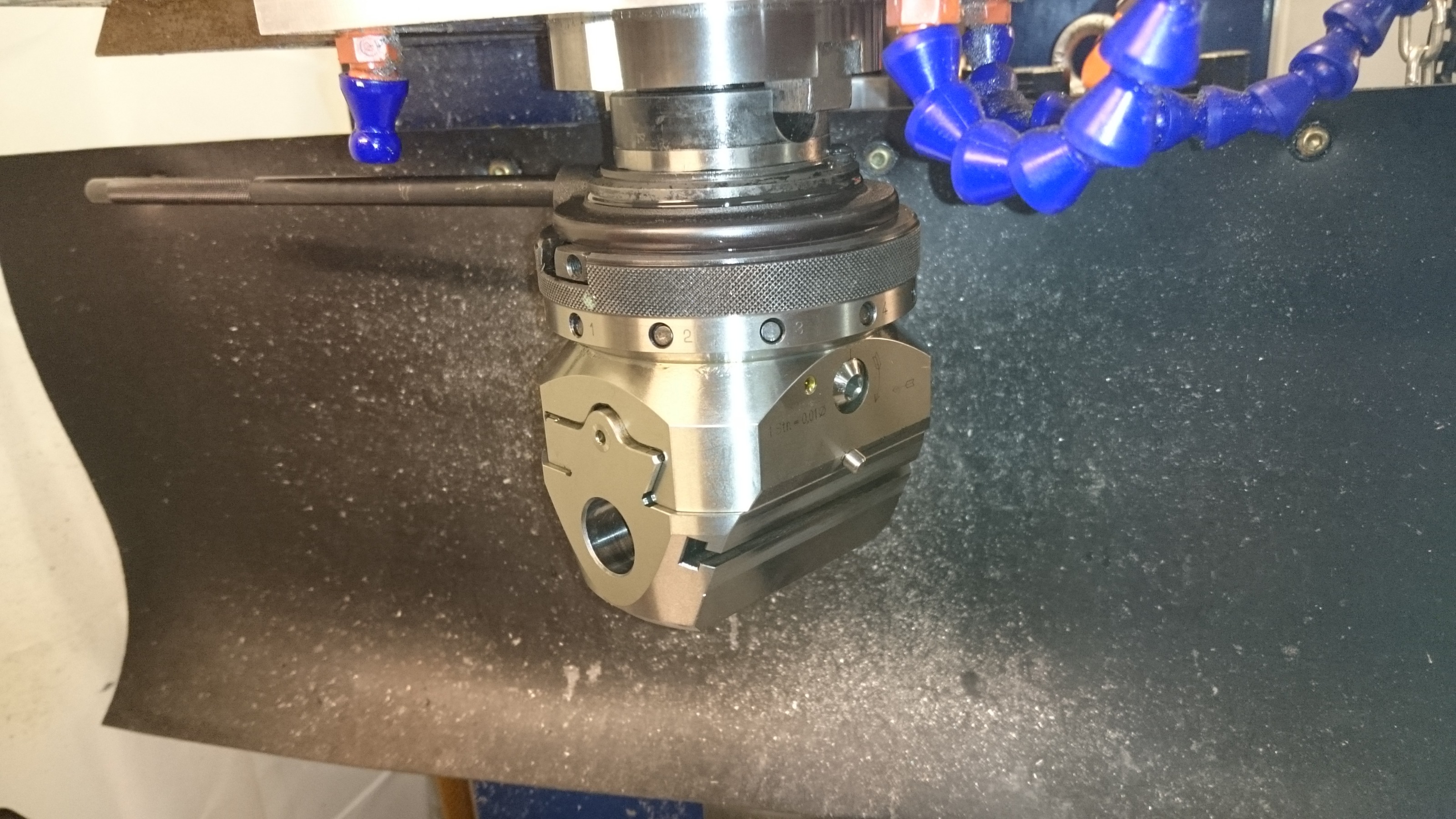

19 Feb 2018 19:03 #106180
Replied by andypugh on topic Wohlhaupter UPA-4 push button issues
With a spindle-synched Z-feed you can bore tapered holes.
Nice for a tool tightening fixture.
www.cnczone.com/forums/uncategorised-met...ered-holes-mill.html
- tecno
- Posts: 1850
- Thank you received: 127
19 Feb 2018 19:12 #106181
by tecno
Replied by tecno on topic Wohlhaupter UPA-4 push button issues
Hmm I can not wrap my head around this.
Say you only have 1 pin engaged = that will only move the head 0.04mm once/rev and not a continuous feed.
All 12 gives 0.48mm in 12 steps/rev.
So how will the sync be and how smooth surface can one get?
19 Feb 2018 19:18 #106182
I agree that you would expect a little step every revolution but in practice I haven’t been able to spot it.
- tecno
- Posts: 1850
19 Feb 2018 19:22 #106183
by tecno
OK
Nothing to worry about then
