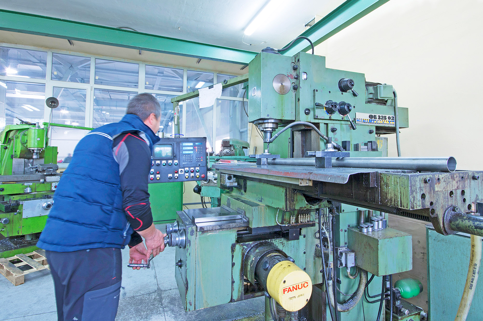

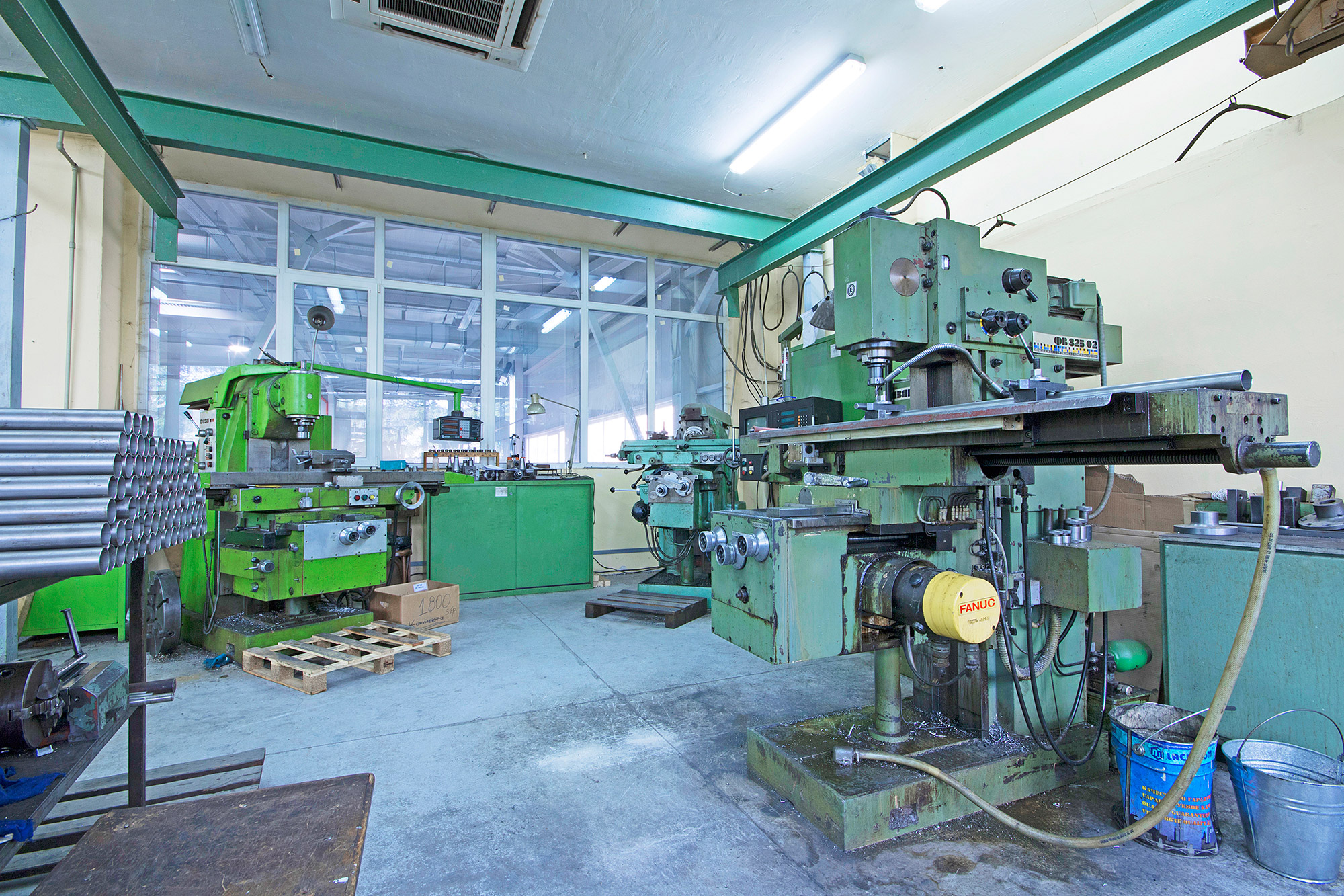

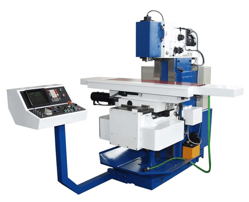

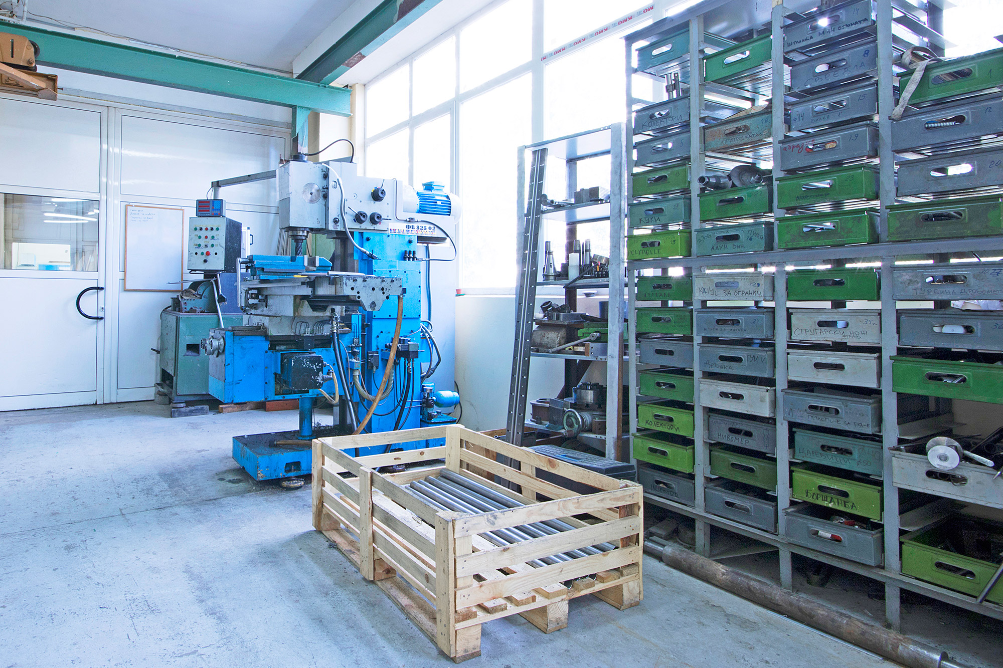

16 Jul 2018 17:42 - 16 Jul 2018 20:35 #114320
by vre
Replied by vre on topic Retrofiting an old big milling machine
The machine i got is the same as these. FV325.02
Is about 3tons 1600rpm 5.5kw spindle iso50
one fanuc big servo for all axis movement
heidenhein tnc 135 control
last photo is this machine converted to full cnc.
There are here photos of the same machine without electronics
www.chipmaker.ru/topic/85182/
Last edit: 16 Jul 2018 20:35 by vre.
