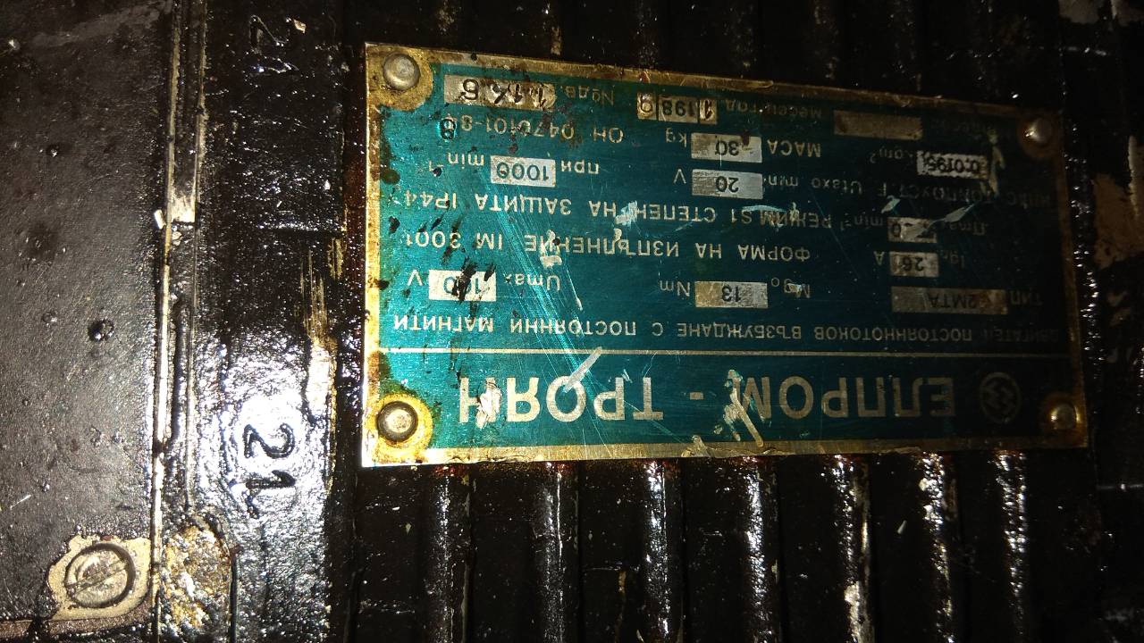

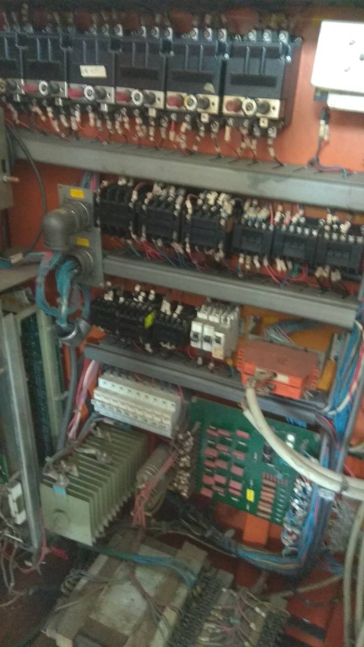

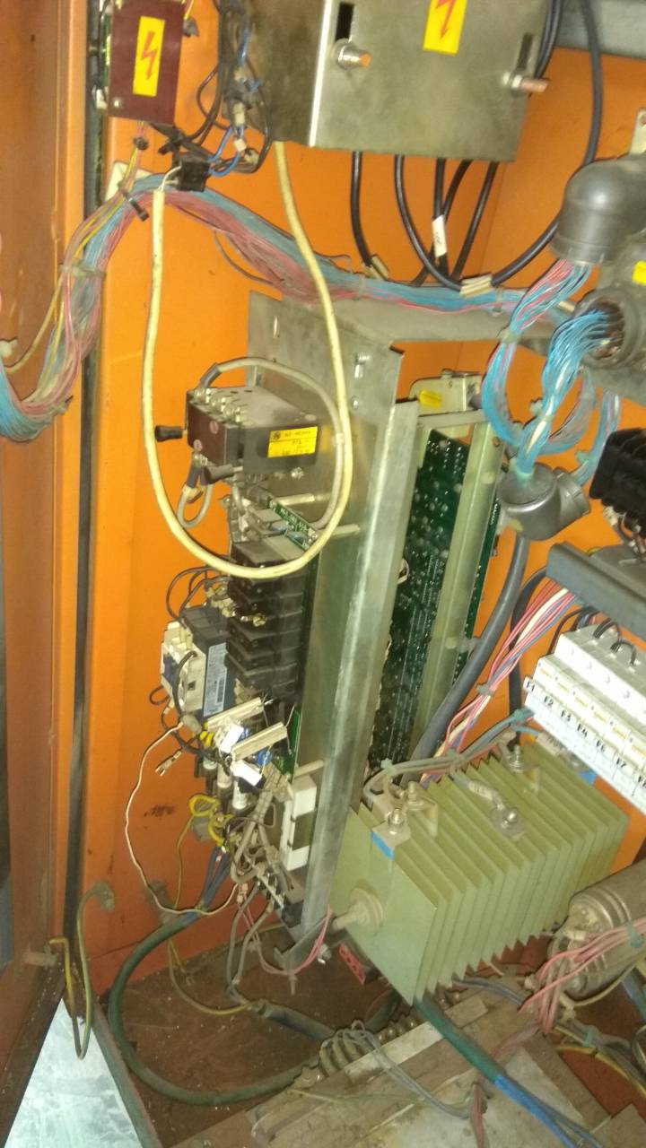

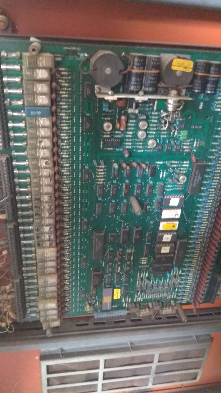

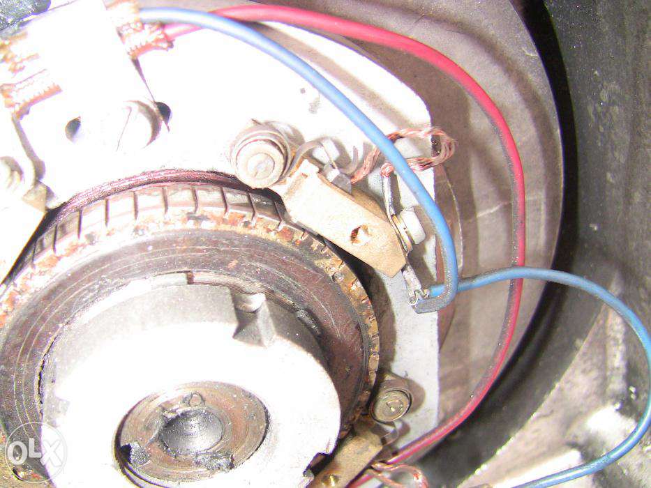

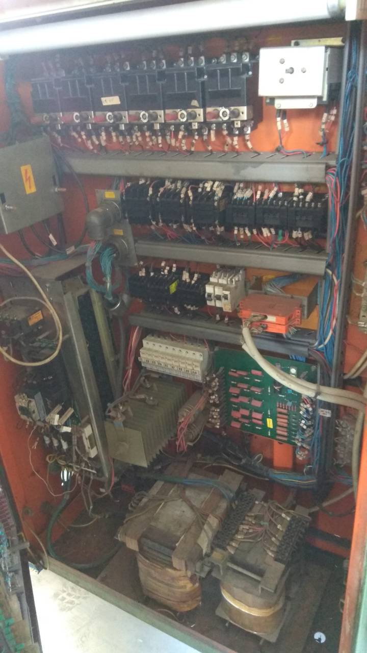

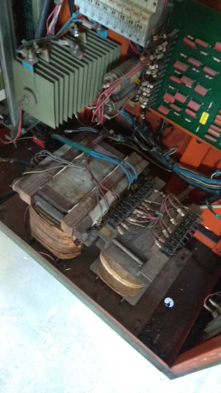

Here is the machines motor that moves XYZ / controller / electric cabinet
What motor is that?
Also what are the components in the cabinet (except relays/transformers)?
What motor is that?
Last edit: 20 Jul 2018 23:28 by vre.
- Posts: 19902
27 Jul 2018 15:04 #114952
A Russian one?
It looks like probably a DC servo. How many power cables go to it?
Replied by andypugh on topic Retrofiting an old big milling machine
What motor is that?
A Russian one?

Motor is
ЕЛПРОМ ТРОЯН
2МТА
here is the datasheet but i don't know russian
elektro-dvigateli.ru/postoyannogo-toka/d...odstva-bolgarii.html
I think is a simple brushed DC motor so i can drive it with pwm from linuxcnc
and take position feedback from linear scales(sin cos 1Vpp) that each axis has.

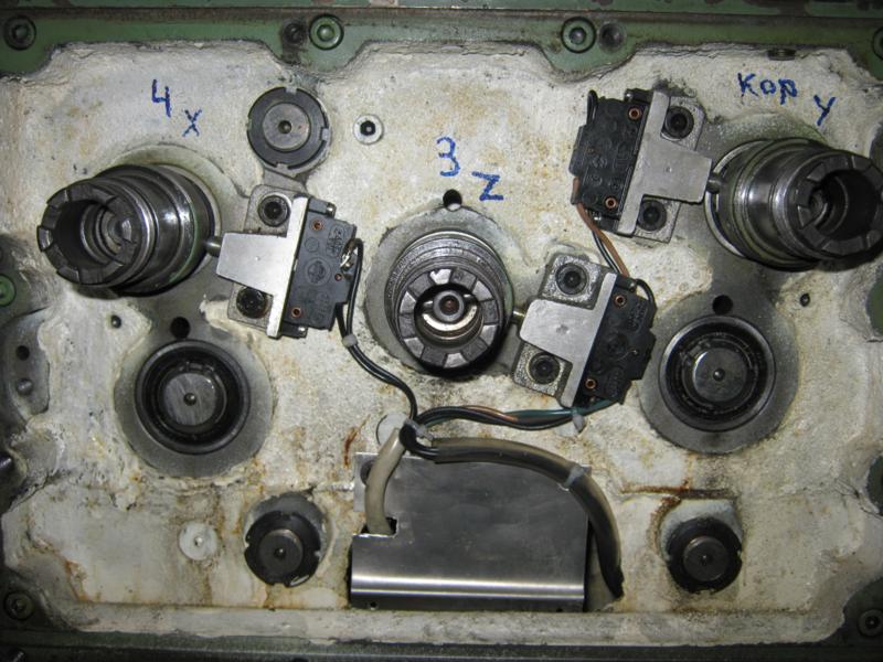

This motor moves all axis 1 axis each time

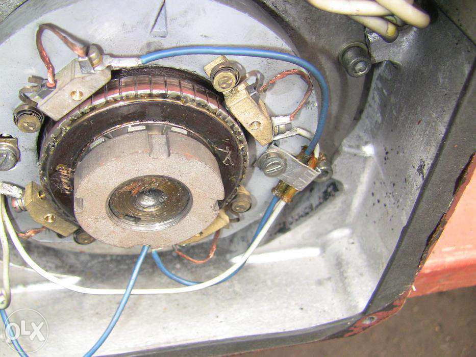

each time the axis will be moved engaged with the mechanism shown in the attachment photo.
So what you think can this converted to linuxcnc as is without mechanical modifications ?
Each time 1 axis will be moved so no arcs only linear moves.
Is that possible with linuxcnc ?
Or must attach 1 motor per axis and make a full cnc ?
Or make a pseudocontroler with arduino with 3 buttons XYZ for each axis engagement 6 buttons for movement direction
pwm with a potensiometer for the feed speed
and 3 x 7 segment LED displays that will show the position of each axis reading the scales ?

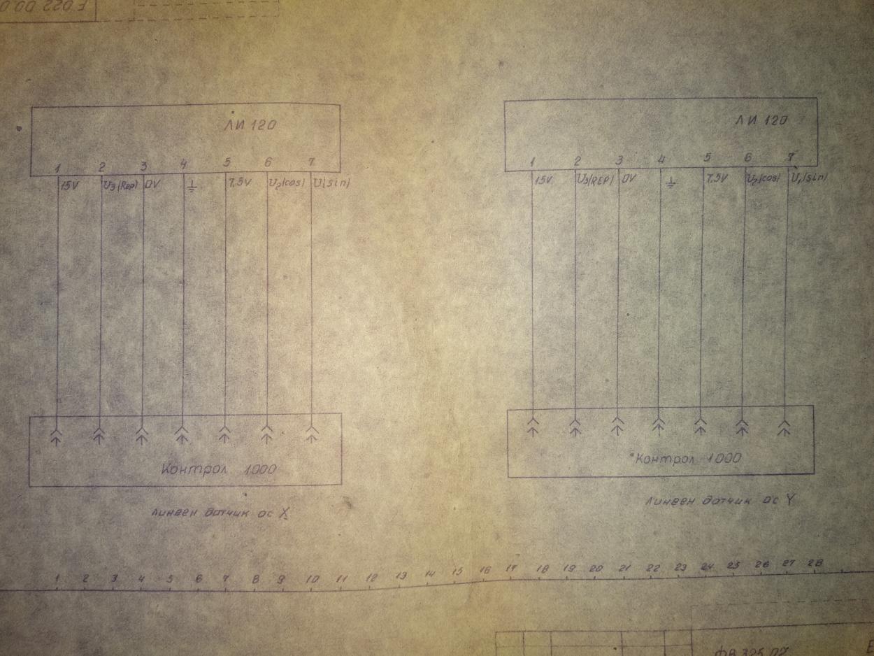

Ok i got it how to find VCC & GND wires.
I also have this schematic if helps for the signals..
What is the 7.5V & U3 rep shown in schematic?
Is this scale 1Vpp ?
Last edit: 12 Sep 2018 13:23 by vre.
- Posts: 19902
12 Sep 2018 13:46 - 12 Sep 2018 13:47 #117398
It looks like sin/cos voltage on U1 and U2 and possibly an index on U3.
It also seems that you might need to supply both 15V and 7.5V.
That said, Uref Usin and Ucos looks a lot like a resolver. Does the scale appear to be optical, or is is like the Accupin system?
