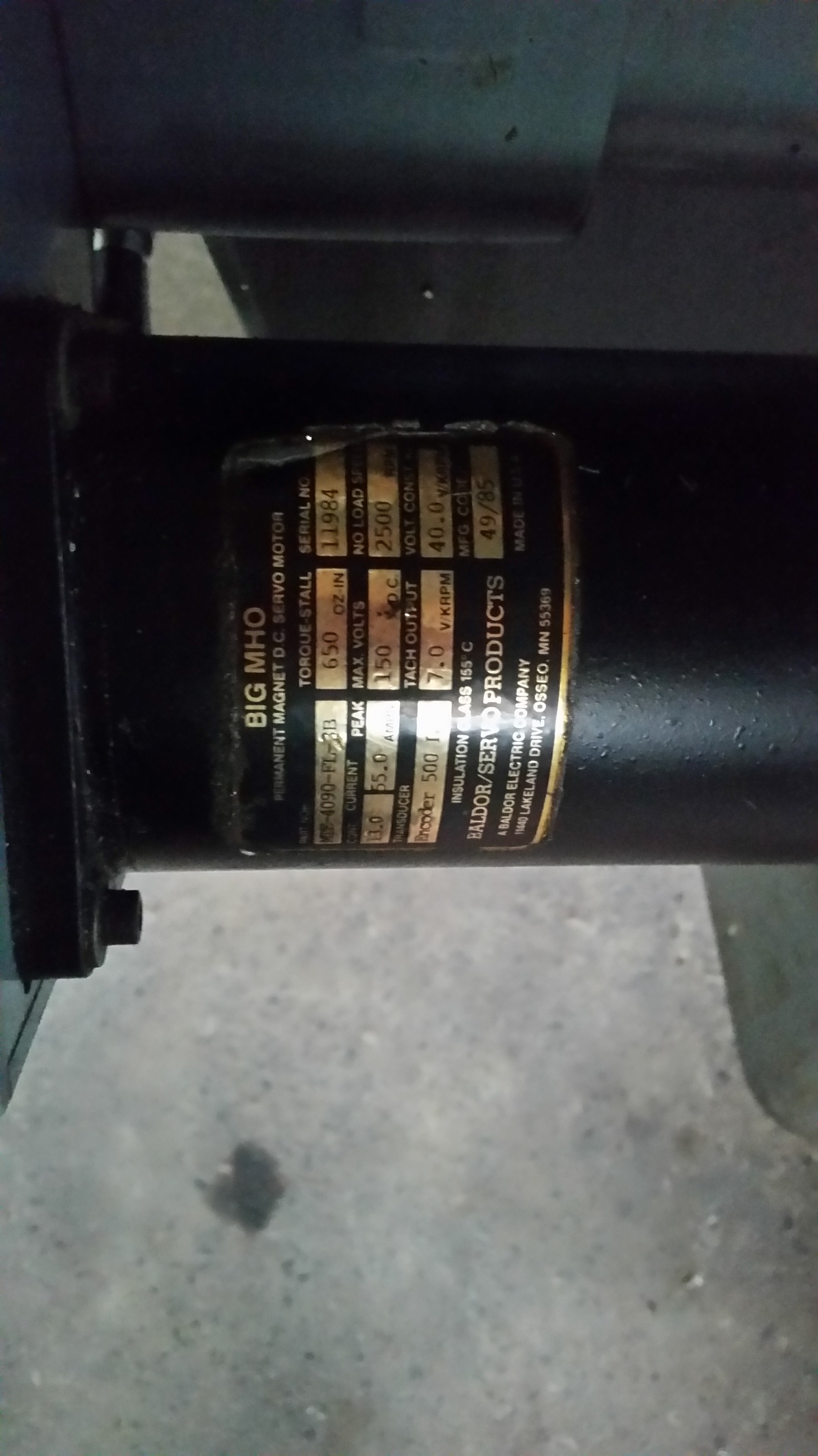

Does your machine have DC brushed motors (likely SEM or clones)? Most of the US machines seemed to use large steppers, so my machine appeared to be a little unusual. I'm in the UK and my machine system was installed by Matchmaker. The base machines were shipped from Japan for CNC use but came without electronics, hence the various different control systems found on them.
The cncdrives DG4S drives have been absolutely fine. I've never had an issue with them and they fly long with modern HSM toolpaths in a way the original system could never have performed. Reusing the original motors and encoders avoided mechanical modifications and the original components used were top notch (HSK mostly). I did crash a couple of times in the early days and the ballscrews survived, which is perhaps a reason not to have stupid big motors. If you work out what the stall torque would do in terms of linear forces at the table, it's pretty big and dwarves any realistic transient inertial loads.

I will definitely check out the youtube this evening when I get the chance! My machine does have DC servo motors I will attach a picture of one of the motor tags. You don't happen to have any documents on the milling machine do you? My machine came pretty well disassembled as far as electronics go and it would much easier to identify what's what with some guidance. Also out of curiosity do you have any links or idea of the price difference if I wanted to step up to a more industrial driver? I don't I will want to spend the money but is nice to know. Thanks so much for your time it is exciting to find someone with real world experience with a nearly identical machine!
