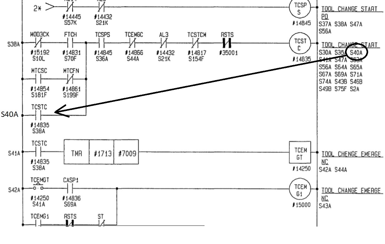

I am trying to reverse engineer the tool changer arm on this Kitamura Mycenter 0 I have been retrofitting with Linuxcnc. The factory proximity sensors (trip locations) are not making much sense to me. The ATC Arm is powered via a VFD. All the motions are performed by a CAM. It does however have original inputs for CW, CCW, Speed 1, Speed 2 and Reset. The slow speed is for maintenance only. I am trying to figure out how the events are triggered for tool clamp / unclamp. It does not look straight forward to me (Could be lack of sleep). I am hoping someone can help me decipher the original ladder logic? I would like to write a component to handle this but I am having trouble understanding the sequencing. The ability for the arm to go both CW and CCW is really stumping me as well. I shot some slow motion video of the arm in low speed with the sensor activity displayed on the screen. This is just running continuous in CW or CCW directions. From every video I have seen on Youtube it appears it should be moving in the CCW direction. Any help on this is appreciated. I am including docs and videos below.

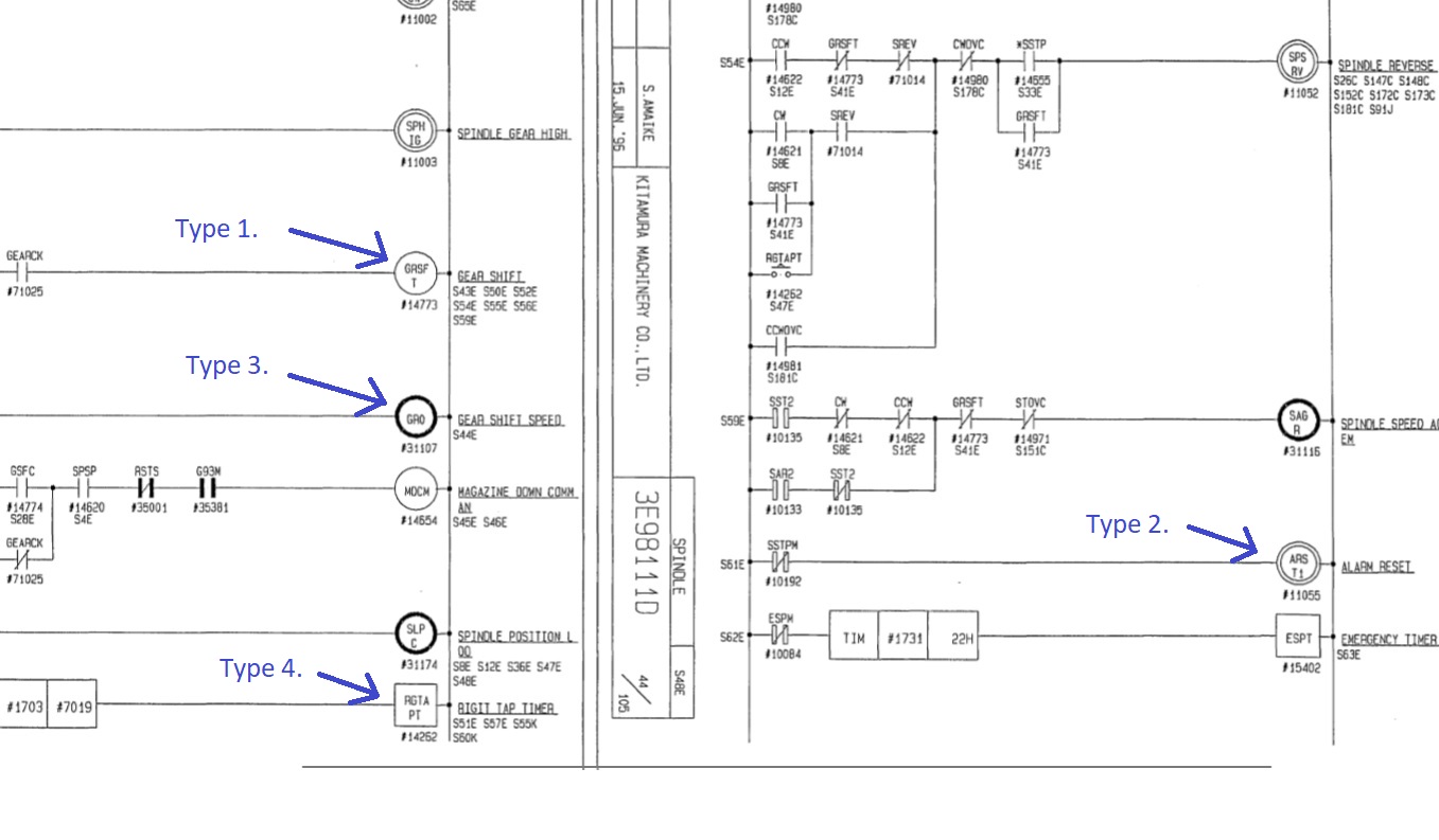

John, thank you! For the most part I figured out the way to read the ladder logic. (Just hard for my mind to follow it) I do need to figure out the timer blocks however. I am thinking I might just start putting this whole thing into classic ladder and watch how its working. I am worried that timing is super critical. The actual tool change on this machine is super fast. Under .8 of a second.
Things I am still trying to figure out...
*Does it only go in one direction or does it change direction in some point of the cycle? Trying to understand why there is a CW and a CCW?
*Does it use the timers in the later logic as delays for the proximity sensors?
*The timer blocks.. What does the first and 2nd value actually mean? I have the values but no idea what the represent. On delay off delay?
*In classic ladder fast enough to handle timings like this if thats whats required?
