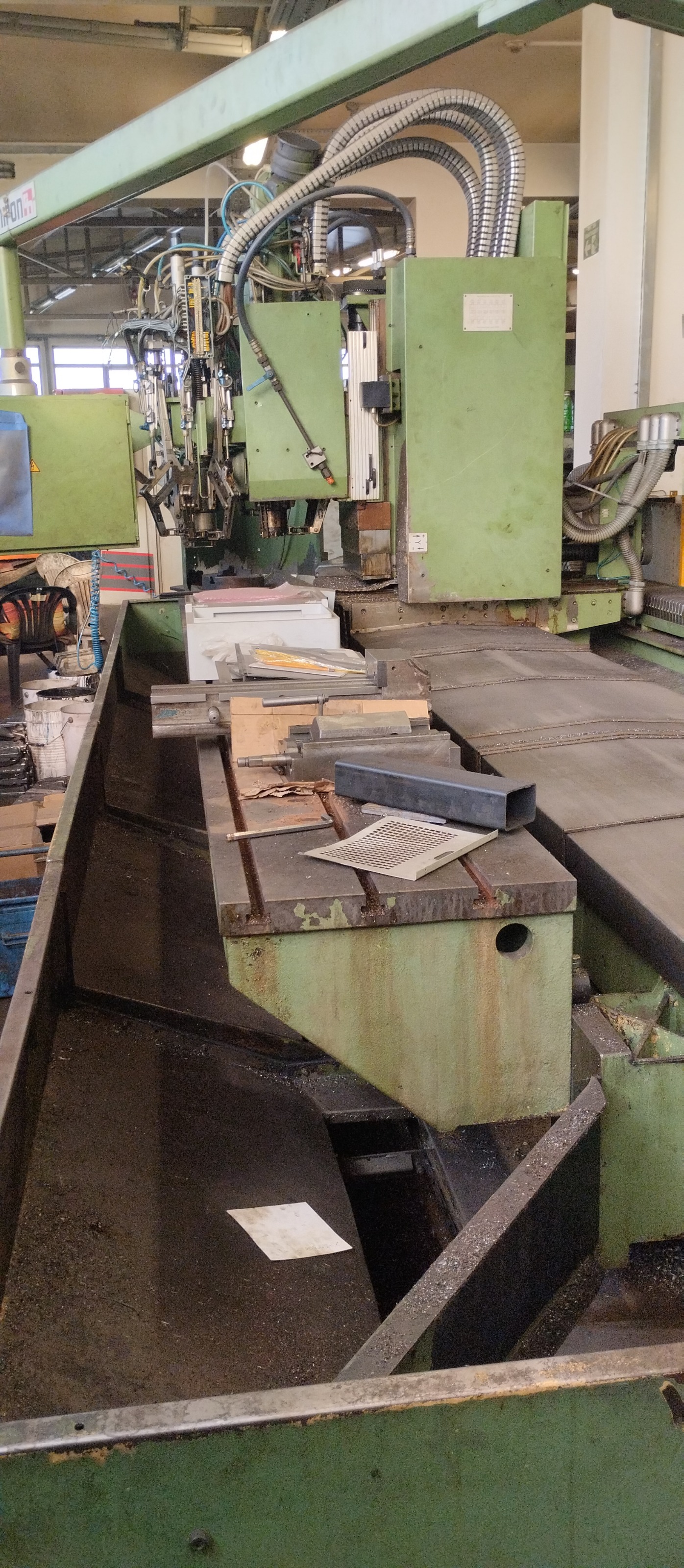

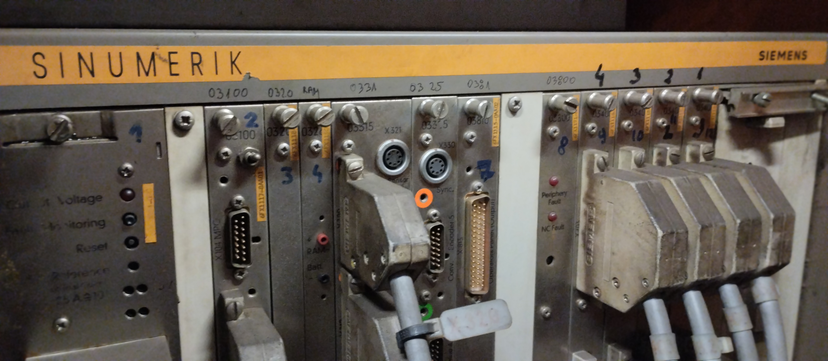

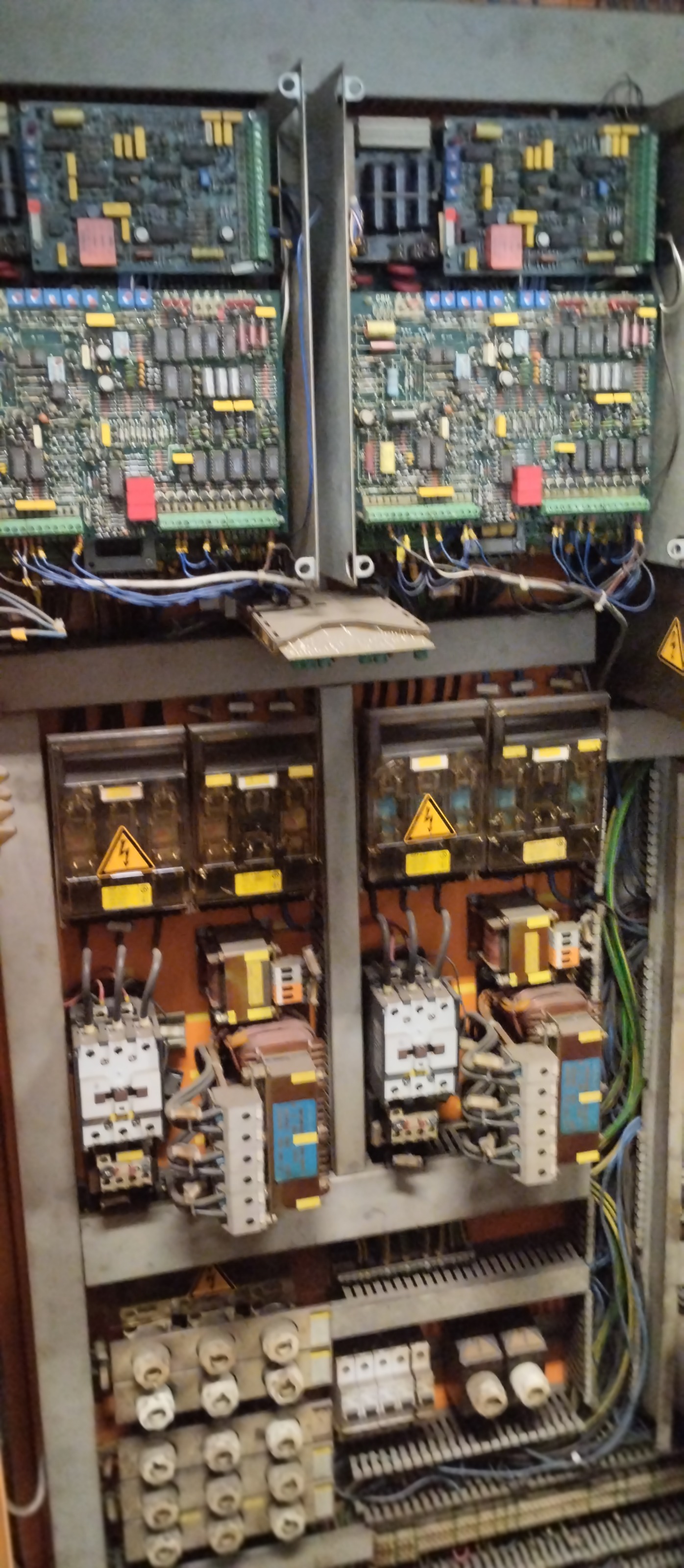

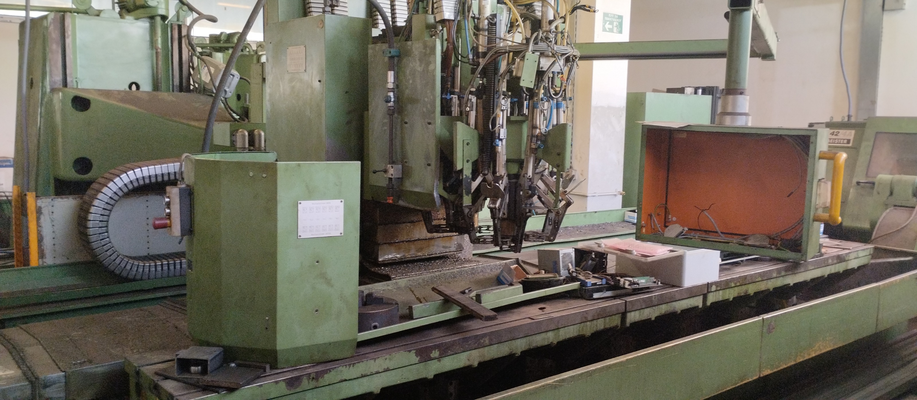

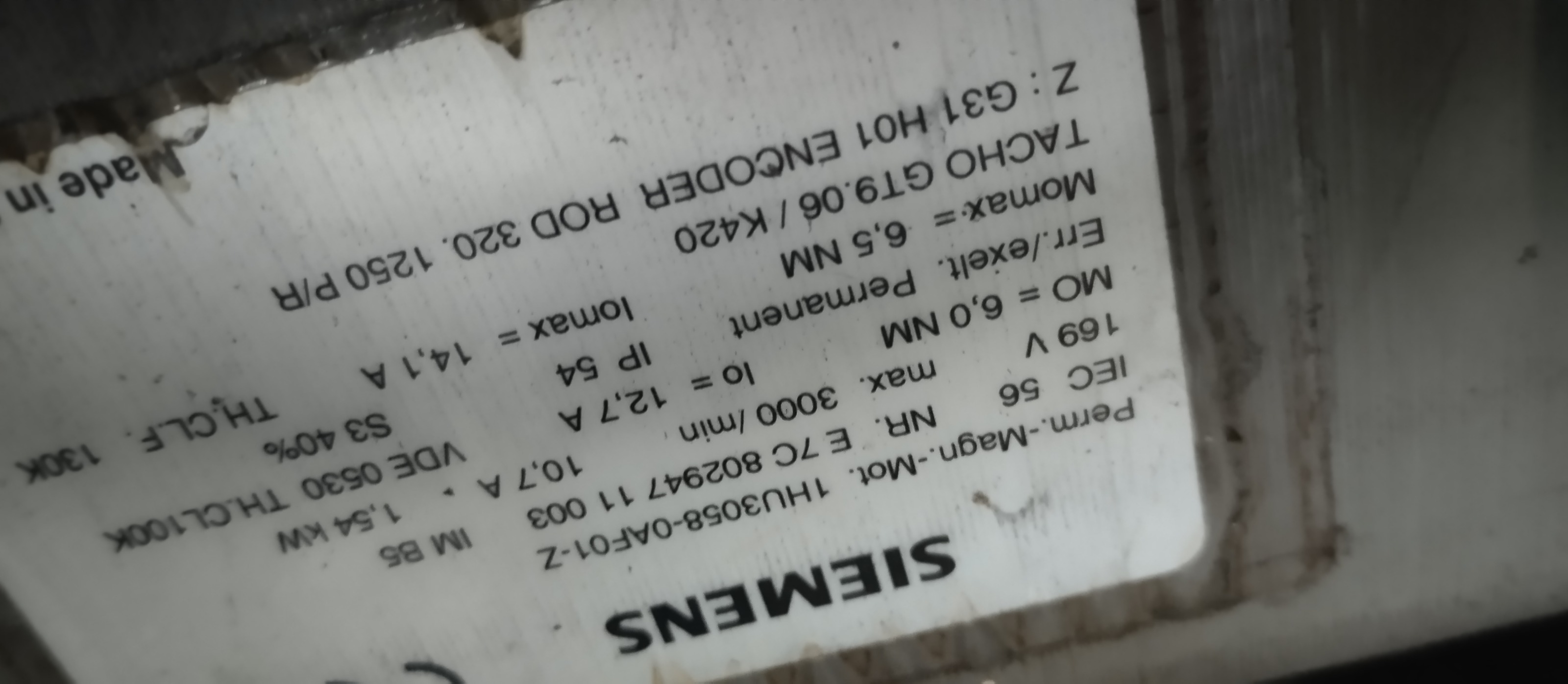

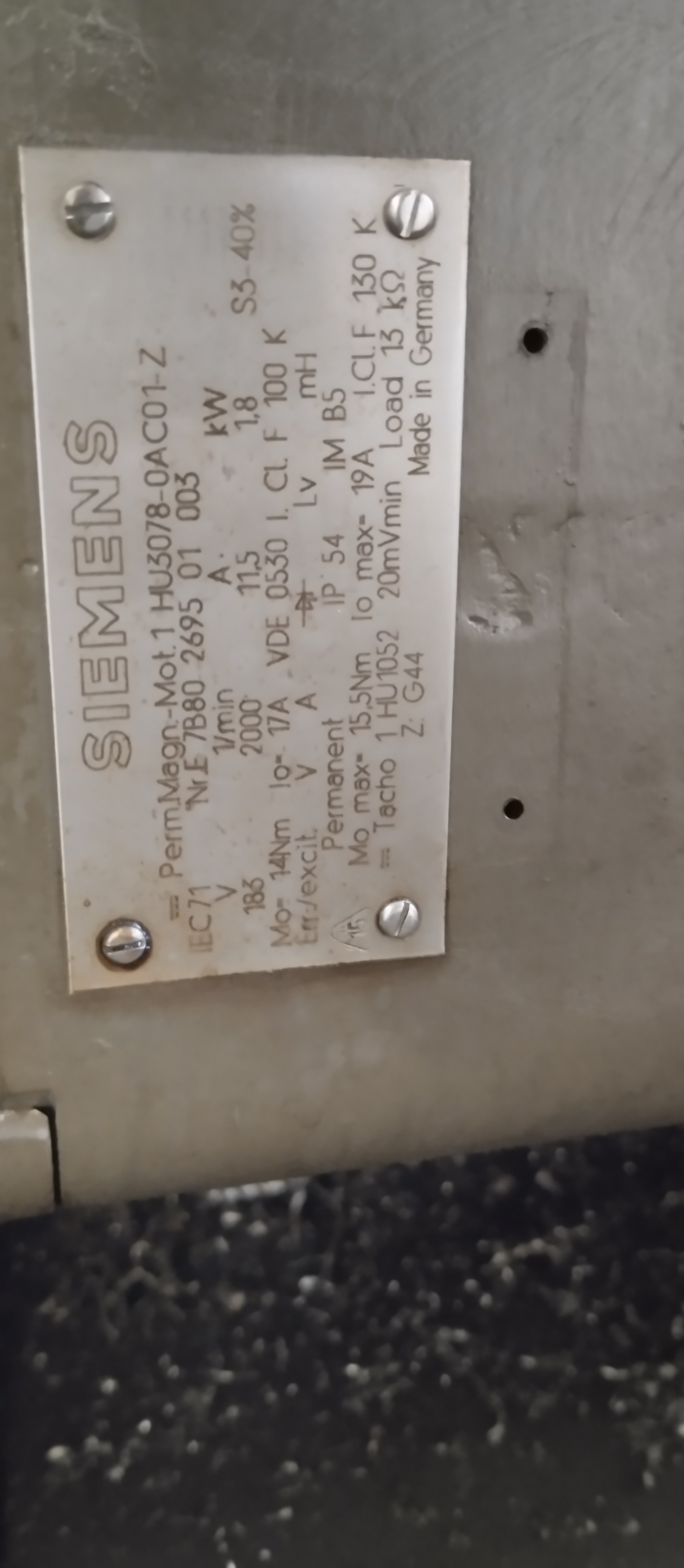

Hello Anfänger I neeeeeed your help
I have the same machine as you Chiron Fz16 and the only difference is that mine does not have a fourth axis, but the X axis is 4 meters
on which there is a linear encoder with a signal converter + 2 spindles.
I removed one so there remains one spindle with 6 atc-s its practically implies the same scenario as on your machine.
1. I need exact models mesa cards,terminals,cables---links to buy
2. If you have some I/O schematic for connecting ATC, SPINDLE, ANALOG SIMO DRIVERS+ENCODERS, LIMIT SWITCHES... to MESA
4. Configuration files for linuxcnc/hall and ATC Screen files
Thanks in advance
Thanks in advance

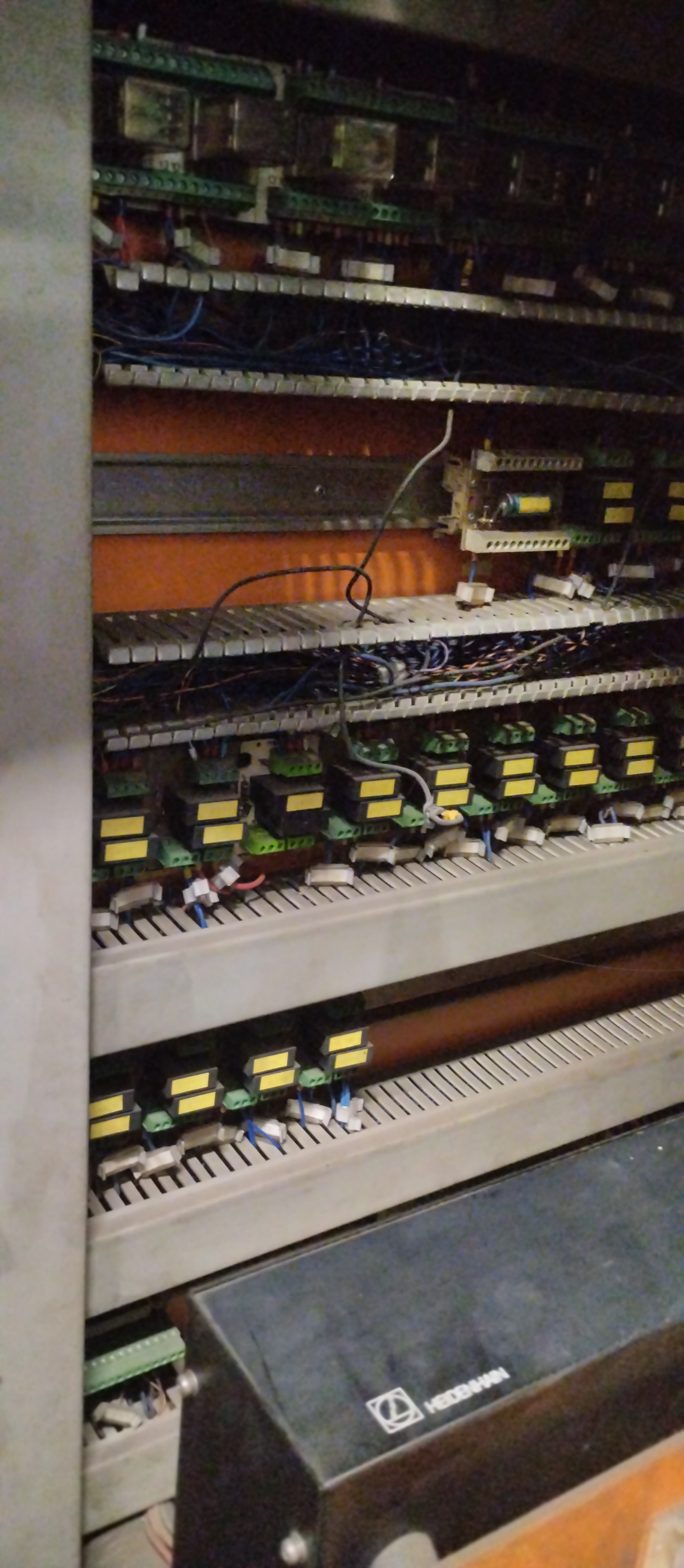

14 Nov 2022 13:45 #256687
by dinamik
Replied by dinamik on topic Retrofitting an 89 Chiron FZ12W aka Igor
No!!
Complete equipment is Siemens:
dc motor, driver, reg. and dead control---sinumeric system 3
only the linear scale is Hidenhain.

14 Nov 2022 13:54 #256689
by dinamik
Siemens system 3

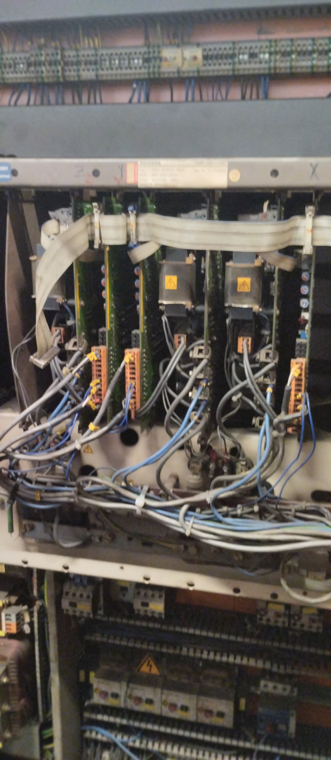

14 Nov 2022 14:07 - 14 Nov 2022 14:08 #256690
by anfänger
Replied by anfänger on topic Retrofitting an 89 Chiron FZ12W aka Igor
Ok, mistake from my side, I can share my data if yo give a mail address.
BUT I mine has a sinumerik 810 with simudrive 610 three phase 400V Servo and spindle.
But I would do a lot more rewiring today than in the past.
And not everything was wired as in the schematics. Took me quite a while to figure it out. And of course documented it baldy
