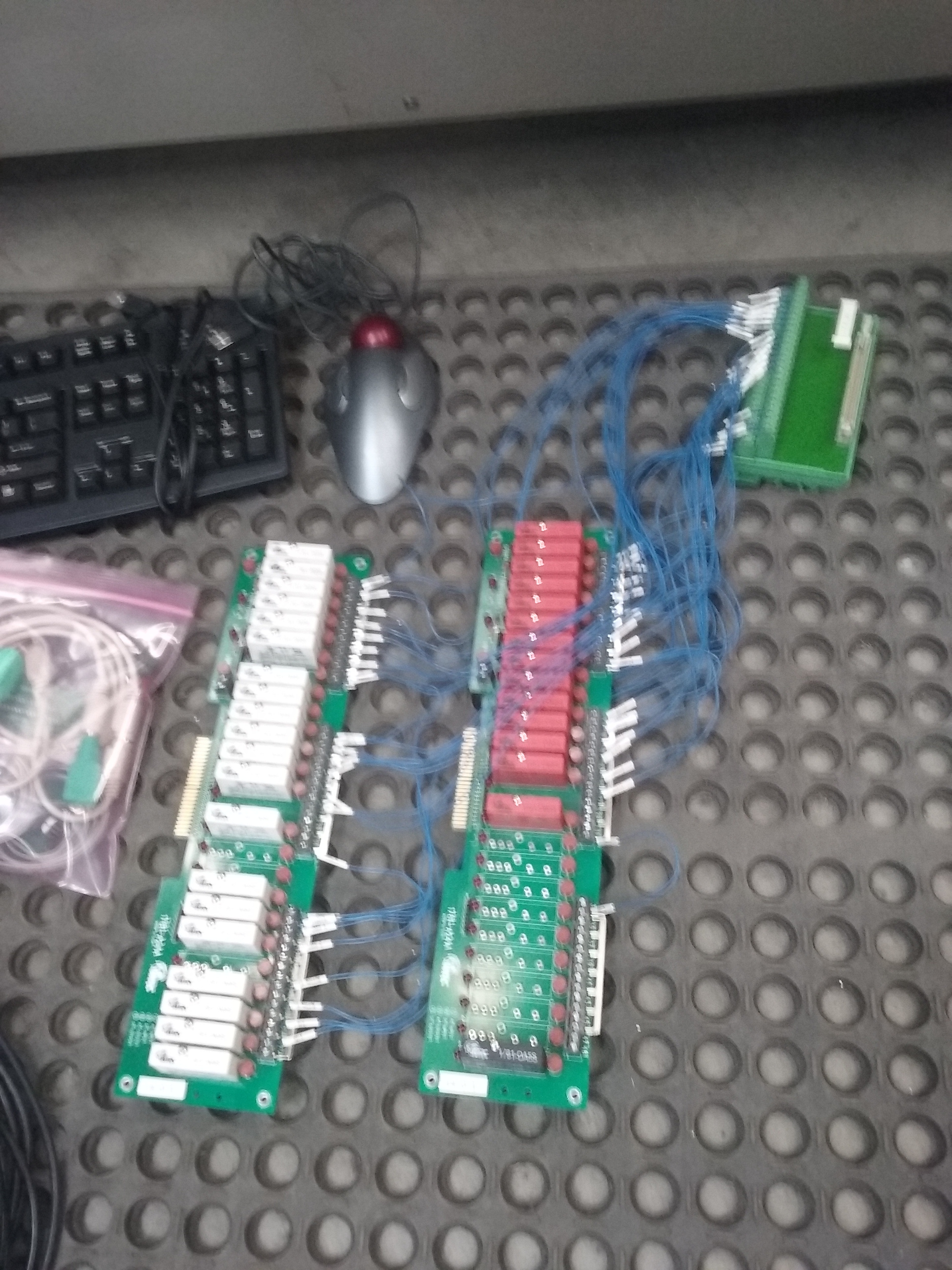

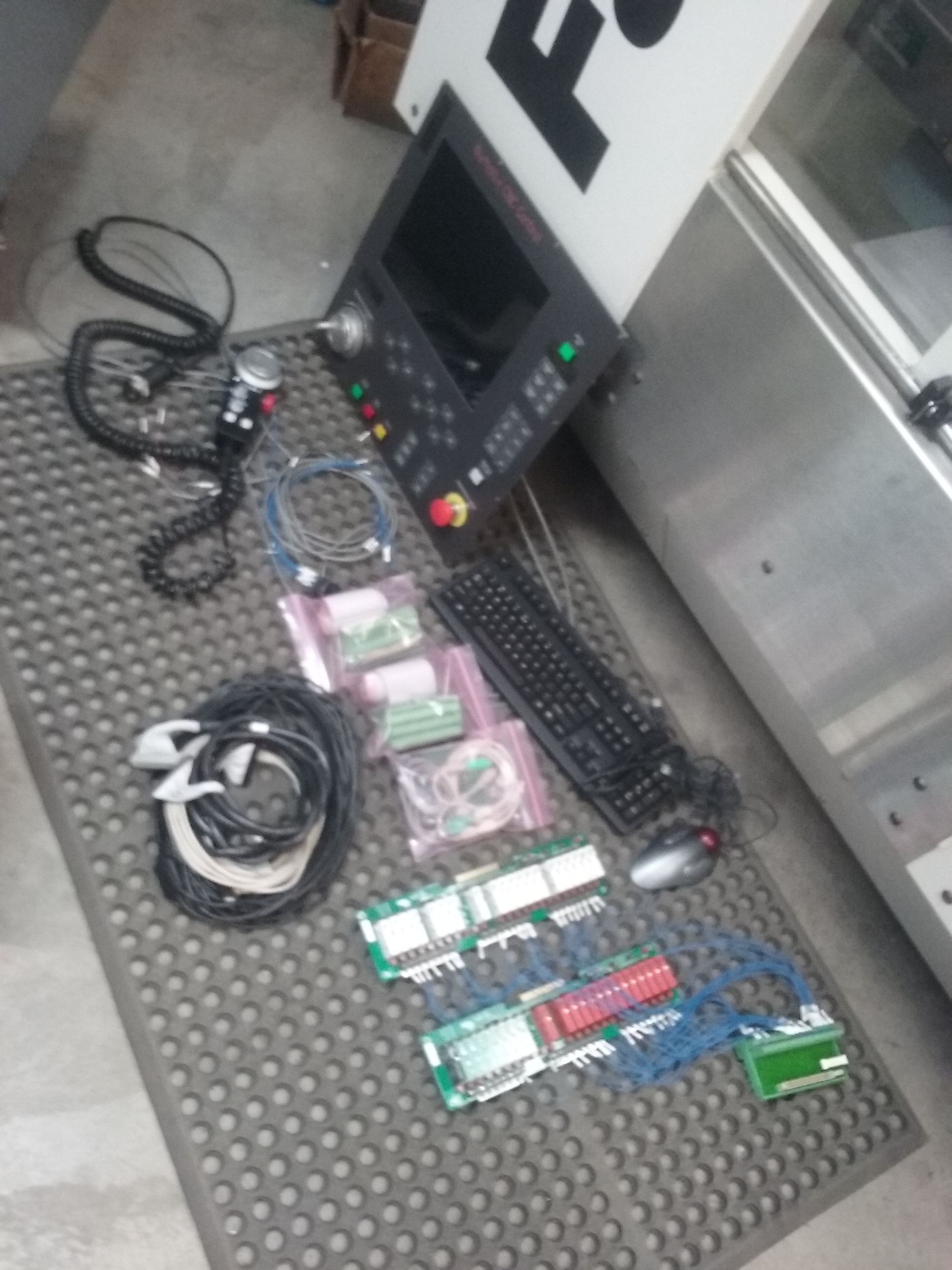

12 Dec 2020 21:57 - 12 Dec 2020 22:38 #191784
by msrdiesel
Replied by msrdiesel on topic Re-Retrofit Fadal VMC20 from Numatix to LinuxCNC 7i77D/5i25???
So to show I am not wasting anyone's time, this is the state of the machine today. I am seriously going to follow through with this.
According to the Delta Tau jumpers, it was all setup to sink the IO's .
What should I keep? I would like to keep the panel but it uses a Vectra Systems converter to dual PS2, back to dual USB, for all the axis buttons (dual DB9 connectors at the panel). The keyboard and the mouse all tie into it. Its like a triple 'Y' arrangement. The other panel buttons are a ribbon cable, may be easy enough to just pull something low with a button press? Like the coolant, not sure how the spindle speed change output works, resistor?
I have 3 IO boards with ribbon cables, that I would think I can reuse.

*MESA has I/O cards that connect directedly to opto22 cards. Check with mesa for part number. It looks like you are going to put those opto22 cards back into the panel and rewire them as before (hopefully you have the wiring diagram).
*Linuxcnc does have USB driver for pendants and like.
*For the hard-wired panel, you might need a mesa 7i73 i/o module, it can connect to 4 MPG's and 8x8 keypad.

My order shipped today a 5i25/7i77D and the 7i73, hopefully I have enough pins. I may not need as much as I thought as I also bought a touch screen monitor as I plan to try probe basic for the UI.
I don't have the wiring diagram, but it looks like many of the opto 22's were for the panel buttons and controls. One is in the cabinet still already wired up to the tool changer and spindle gear change, lube pump and such (I hope).
