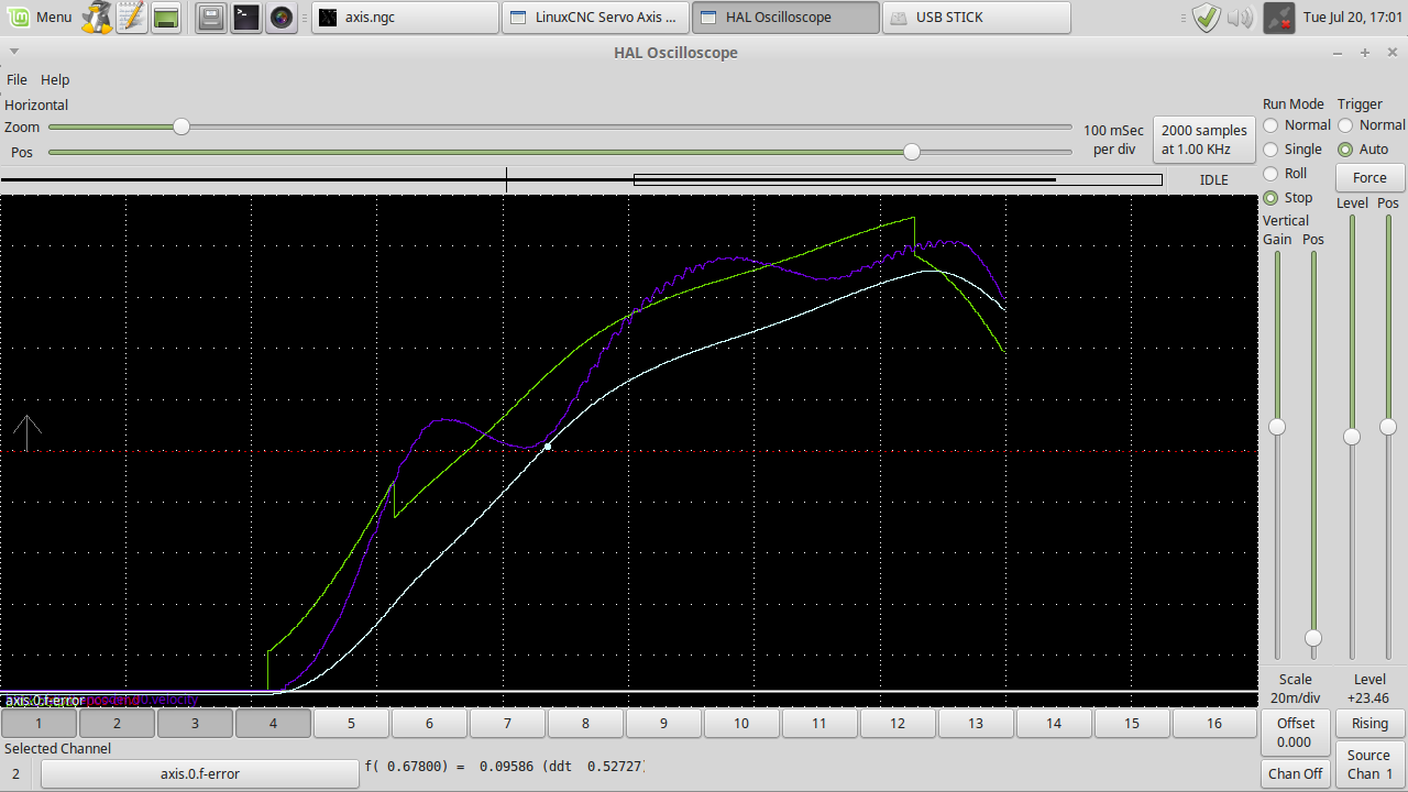

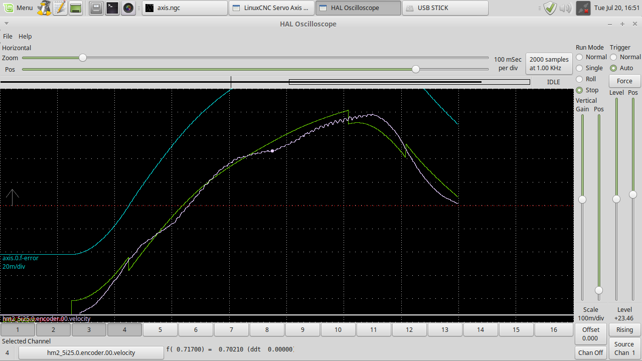

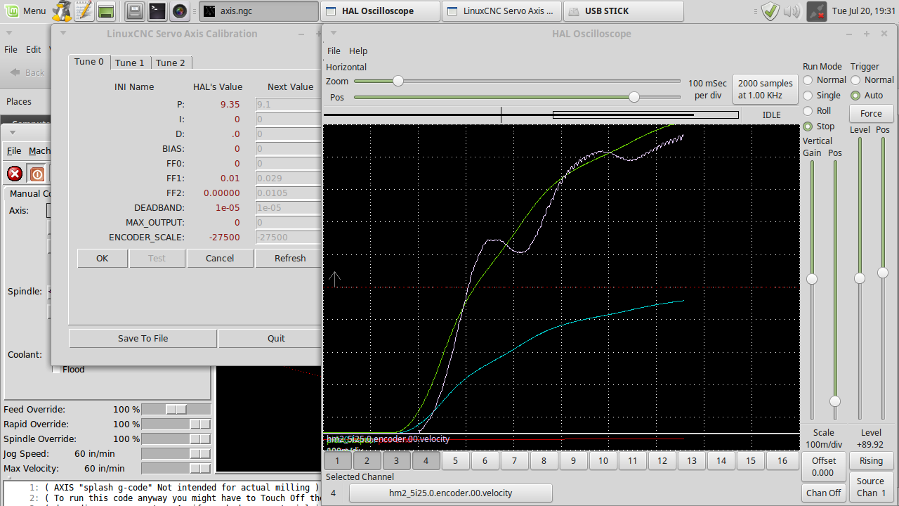

Many thanks for all the great help. The following pics show the ".hal traces" reflecting the adjusting of Pot 3 CCW (this is what I believe is needed, not CW) to change the "velocity gain". I have many more pics, but read the name of file for settings, some say "same" this means the only change is POT3.Many thanks!
Edit: The velocity gain (Pot 3) turns, is part of the name of file. Feed 60 in most all traces.
Do I need more velocity gain?
Many thanks.
Many thanks.

Can you show us a trace with FF1=1, and all other P=0, I=0, D=0, and FF2=0? This should show a smooth symmetrical trapezoidal command for the PID output (your green trace).
What are your settings on the drive for SW2 (1-4) and SW3 (1-10)? Have you made any adjustments to Pot 1?

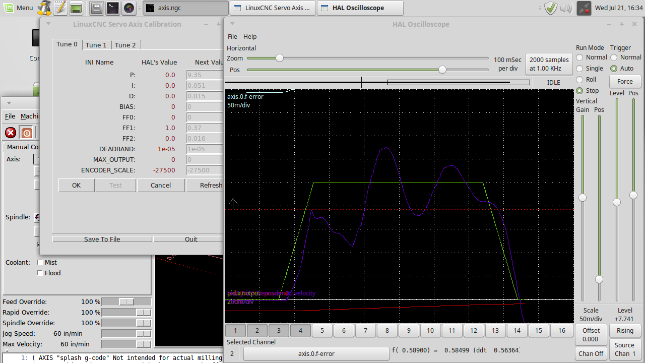

13 Jun 2022 16:13 - 14 Jun 2022 14:01 #245079
by new2linux
Replied by new2linux on topic Set up using AMC AB15A100 drives, brushed DC motor Prototrak Plus with Encoders

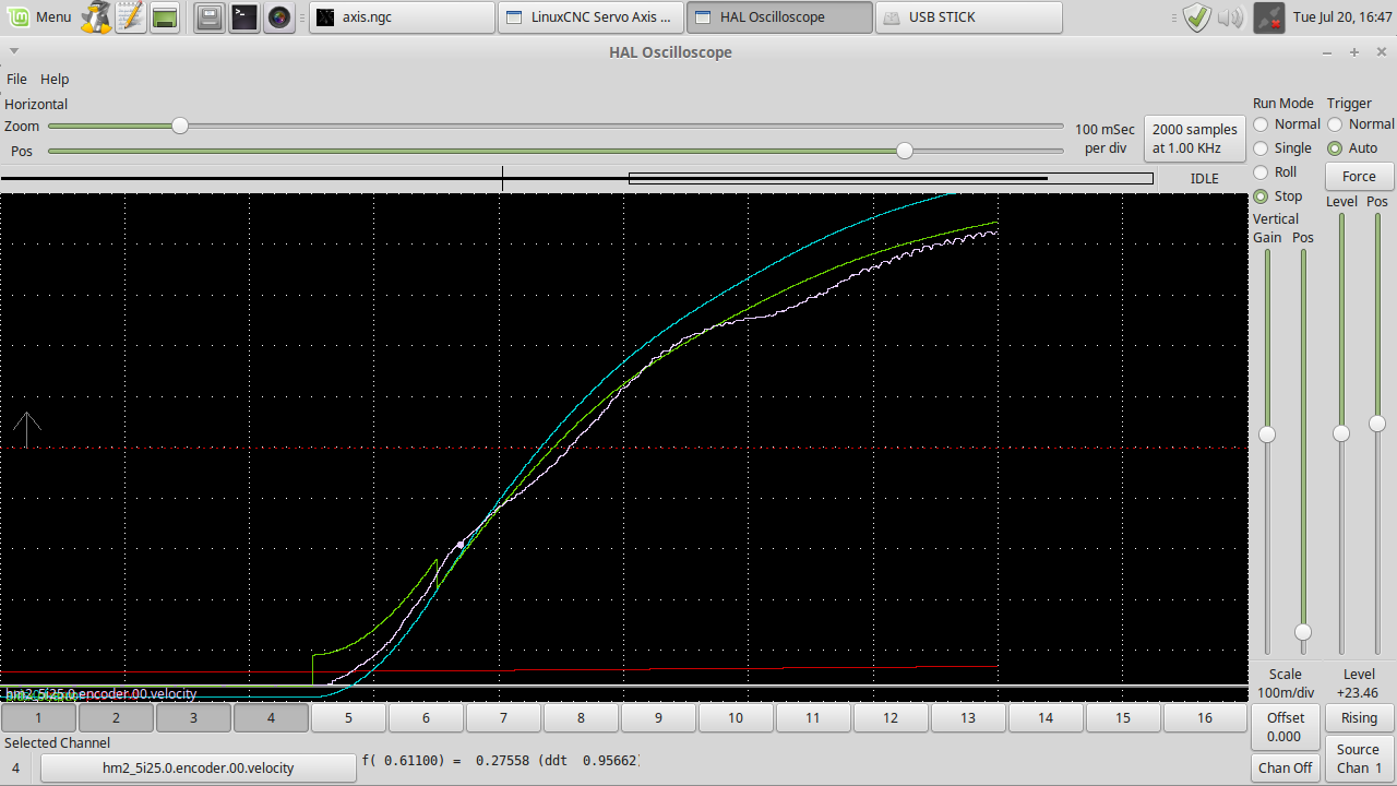

Todd, Many thanks! The cover has never been off, so factory settings inside, the outside setting were set back to as factory (or as required for this application). This
includes POT 1=FullCCW. The trace as you requested is below with FF1=1 All others =0.0 (see pic), this is highest resolution (200m/div), next units you can't see the top.

14 Jun 2022 13:32 - 14 Jun 2022 13:40 #245117
Replied by Todd Zuercher on topic Set up using AMC AB15A100 drives, brushed DC motor Prototrak Plus with Encoders
Ok that move and traces are probably what you should use to tune the velocity loop in the drive. If you are still in contact with the AMC tech, that trace would probably be very helpful for him to suggest the next tuning steps you should take. That should be outputting a steady constant voltage signal to the drive of 1volt (I think.) Your goal is to get the purple line to follow the green line as closely as possible with minimal oscillations.
I'm guessing that pot1 will need turned clock wise some amount. You may or may not need to adjust some of the jumpers, to reduce the oscillations seen there. But I really don't know what their affect will be.
Also what is the setting you have for SW1-3? (I think all of the first 4 switches on SW1 (1,2,3,4) should all be in the off positions.)

14 Jun 2022 13:47 #245121
You must keep all of the other PID settings in Linuxcnc at zero while you are tuning the drive's velocity loop. Otherwise you are trying to hit a moving target and you will never accomplish anything.
Similarly as long as the drive's velocity loop is untuned it will be impossible to tune the PID loop in Linuxcnc. (It would be like trying to control the position of a bowling ball on the end of a bungee cord.)

14 Jun 2022 16:12 - 14 Jun 2022 17:41 #245133
by new2linux

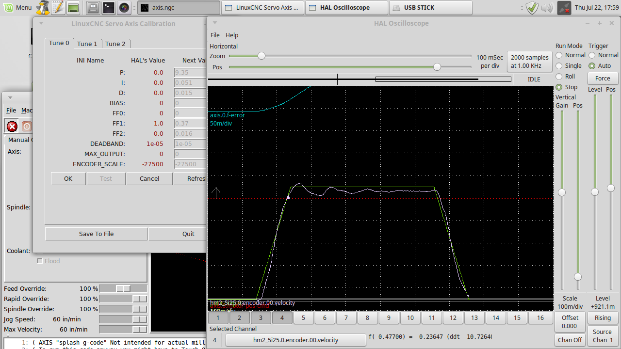

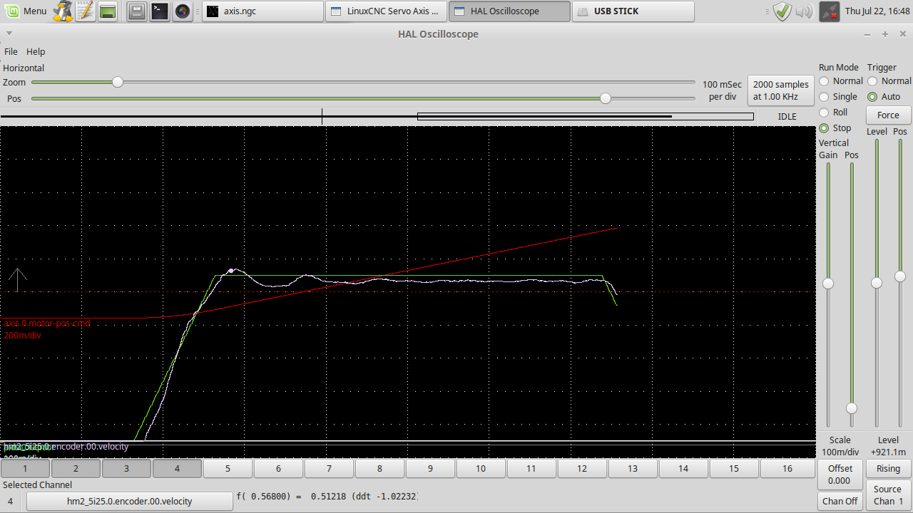

Attached are pic of the hal trace with only the POT 1 CW; as per the file name. Last pic is at CW 6.0 in full screen. If I try to increase (more CW) the motor will start to make noise, with the F2 down the motor as very faint vibrations, very stiff to turn by hand. The traces start at 0.0 by 1/2 turn, until get to 6.0. This pic I used the "test" each time, makes the differrance. I can go all the way back to 0.0 turns of POT 1 if this is needed. The trace looks best yet!! This is FF1=1; 60"/Min Feed.
Edit: 2ND PIC Shows trace with FF1=1, POT1=5.5TurnsCW; POT3=6.5TurnsCCW
Last edit: 14 Jun 2022 17:41 by new2linux.

14 Jun 2022 17:30 #245139
That is looking much much better. (I don't see the other images you mention)
If you can get rid of the little bit of overshoot and wobble at the beginning of the cruise phase of the move that would be better, maybe 5 or 5.5 turns. It should be quiet with no changes of input voltage. But if that is as good as you can get it, you might be ready to try tuning the PID loop in Linuxcnc.

14 Jun 2022 17:47 #245140
One thing I don't like in your last image is the delay between the start of the signal and the response of movement. Looks like it is nearly 20msec.
It may be worth asking the AMC tech if there is a way to improve that response without increasing instability. (making it buzz)
