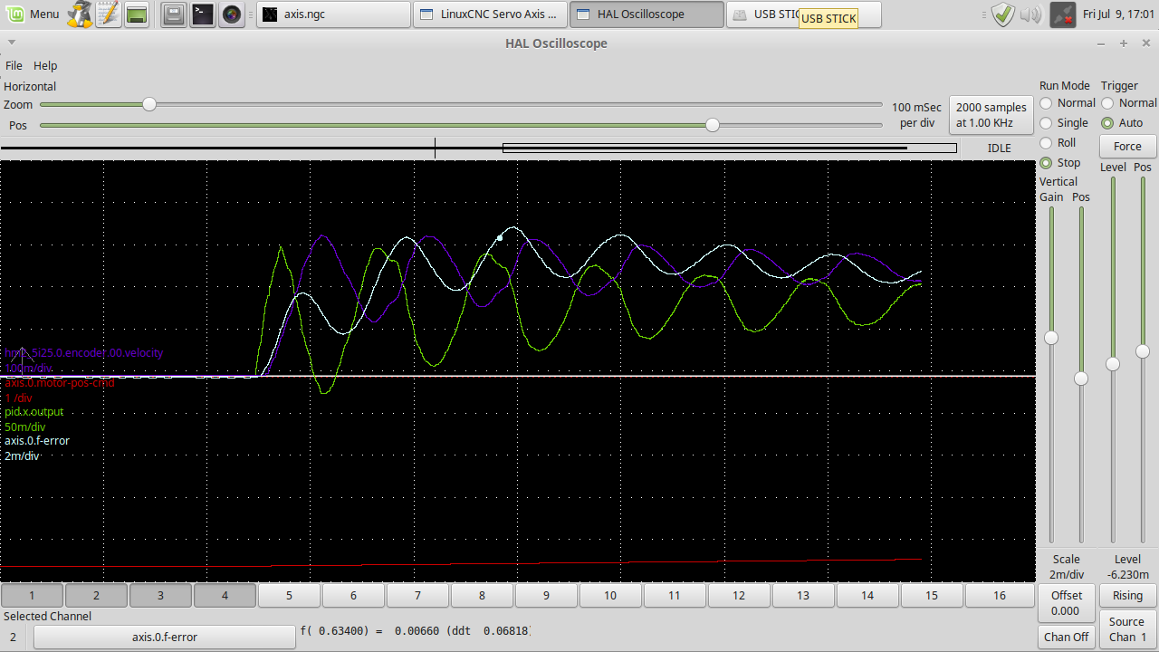

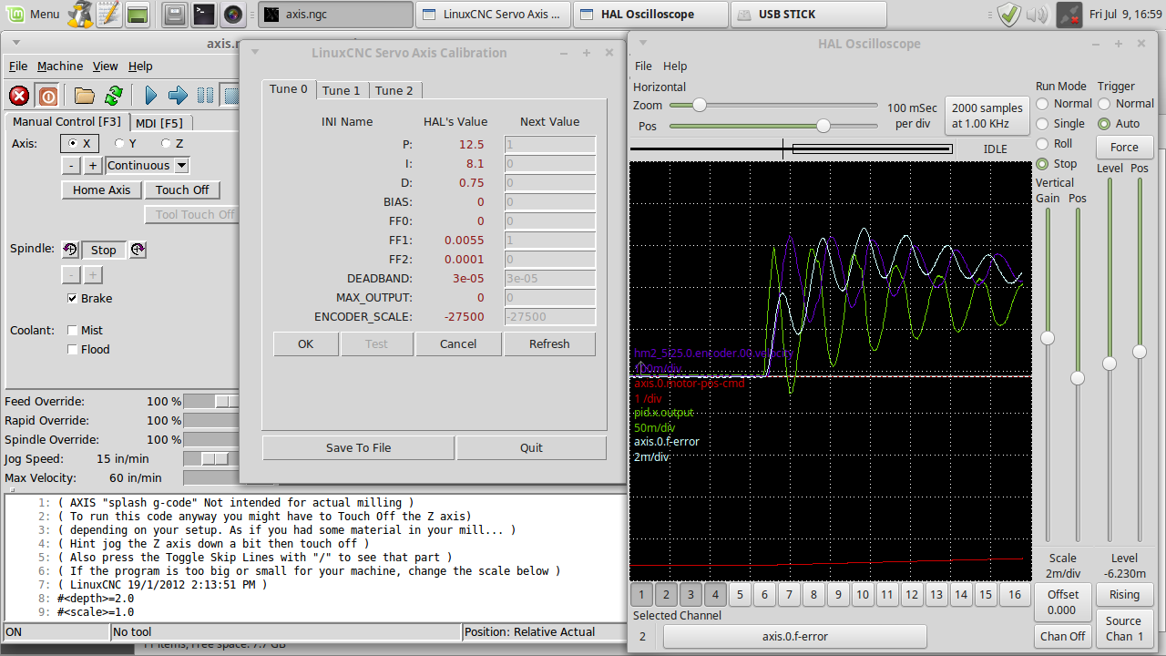

01 Jun 2022 16:39 #244384
by new2linux
Replied by new2linux on topic Set up using AMC AB15A100 drives, brushed DC motor Prototrak Plus with Encoders
Attached are 2 pic of the tuning, so far. I am using jointnmotor_pos_cmd as the "source chan" but only 15 "/min feed. I am having some issue getting the feed faster than 15"/min.
Many thanks!
Many thanks!
- Posts: 18105
- Thank you received: 5328
01 Jun 2022 17:28 #244387
Replied by PCW on topic Set up using AMC AB15A100 drives, brushed DC motor Prototrak Plus with Encoders
I would start again with all PID terms other than P and FF1 set to 0
as a start, Set P = 1 and FF1 to say .5 and plot the results
Never use any D or I on velocity mode drives until you get to the very last
stages of tuning. From the plots I would say the either P as way too high
or you don't actually have the drives running in velocity mode, so
1. Are there drives running velocity mode and have the tachometers connected?
2. If they are running in velocity mode, have you tuned the drives reference gain and loop gain?
