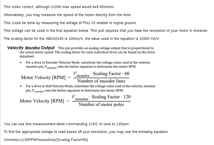

Todd, many thanks! I have not reach out to A-M-C today, but will before the end of today. I have a model 500 (Amprobe brand) volt-amp tester. This has alligator clips (I think that is volts only) or jaws to go around wire in question. It says accuracy: within 3% of full scale. I will try the amp meter if it sounds like it is the correct meter to answer this question. I do not have access to oscilloscope.
Todd this is from your post earlier: "I'm guessing you don't have any good way to look at the amps being applied to the motor then either."
The equation used is attached pic, this shows how, I will need to find all the actual numbers used & edit this post.
Thanks!
Thanks!

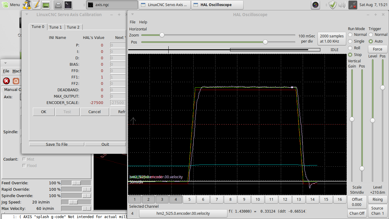

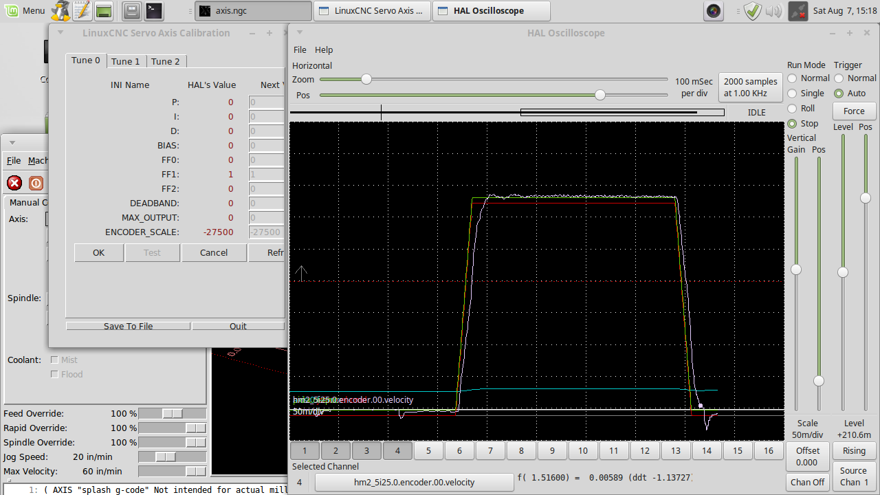

Todd, thank you!!! I reset pot2 to factory & counted 3 turns CCW as per your suggestion. Attached is pic, this is the best & nothing to wright home about.
Thanks!

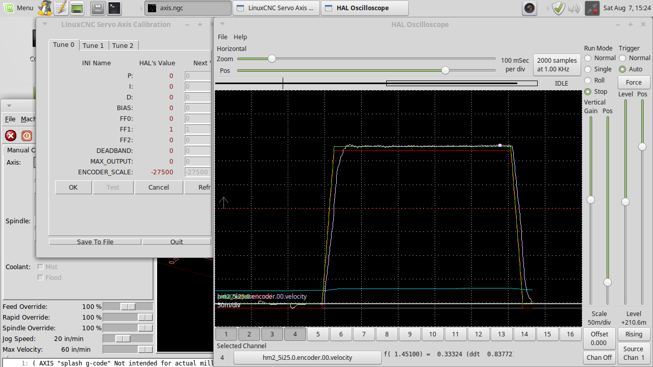

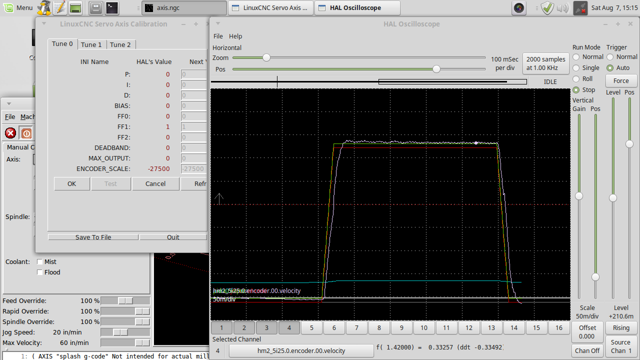

Todd, thanks. Factory setting for pot 2 is full CW. This is several pic starting at 2.5 going to 1.0 for pot2. One of the file names says cw, all are ccw & 2.0 ccw is missing.
Many thanks!

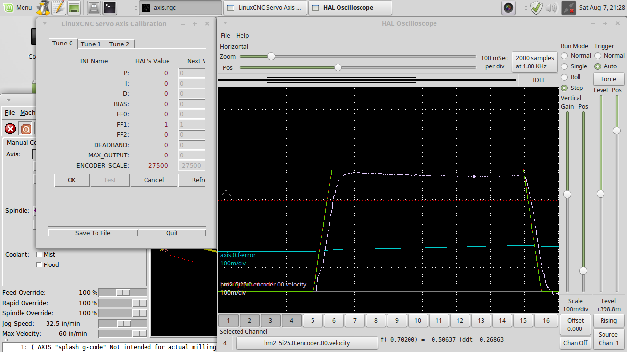

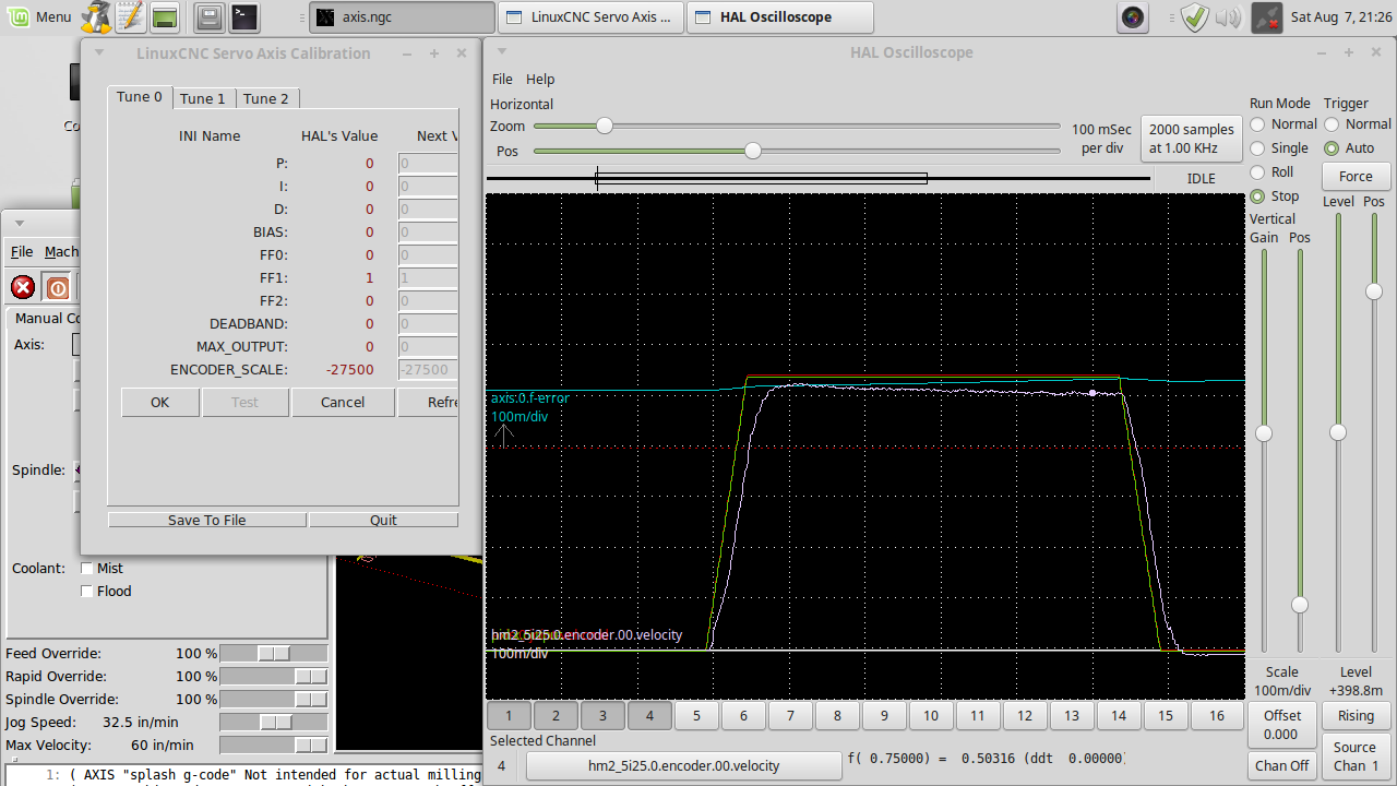

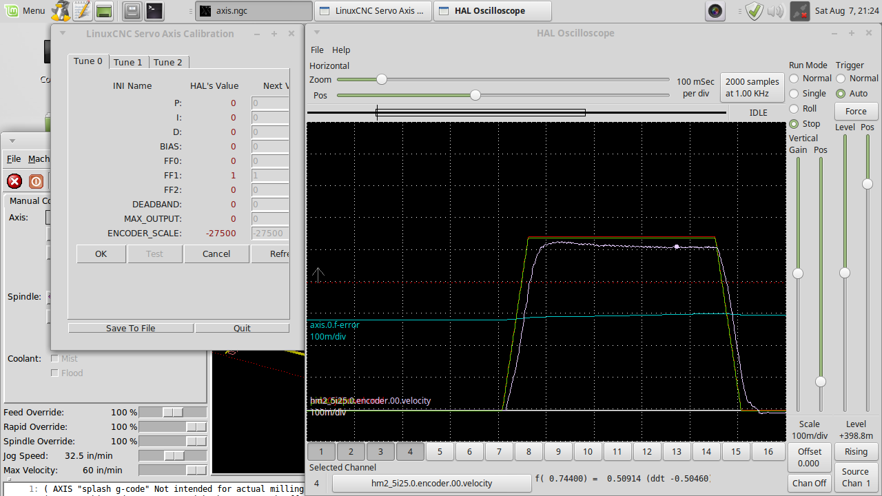

Todd, Many thanks for the great help. The weekend is here and I have pondered if I may not of picked the best trace when I was selecting. My selection has the end of the file name (the sw2 setting are the beginning part of file name) 1.517 (this is the mf, the capacitance of settings from SW2 chart in the A-M-C manual) for drive AB15A100. Attached are what I had to pick from. What trace looks best to you or other members? I have 1 more pic at 1.737 mf.
My thinking is that if I have no luck with the current mf, settings, start fresh with a backup plan. a new setting and move forward?
Many thanks
Many thanks
