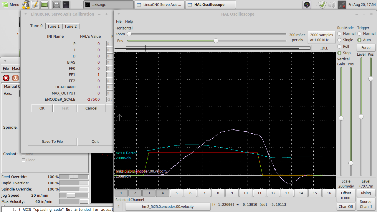

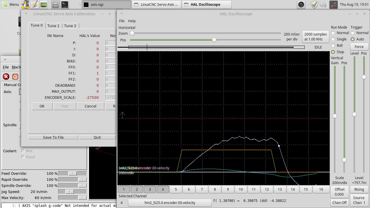

12 Jul 2022 14:35 - 12 Jul 2022 19:45 #247149
by new2linux
Replied by new2linux on topic Set up using AMC AB15A100 drives, brushed DC motor Prototrak Plus with Encoders

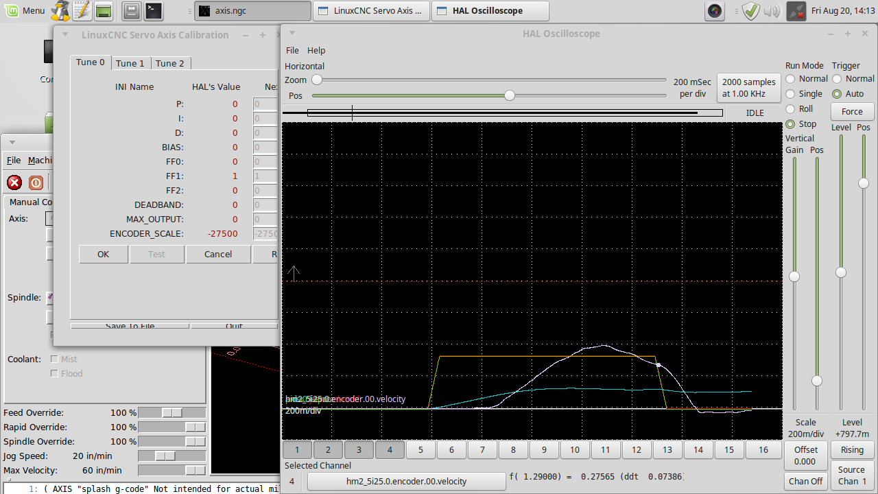

Todd, I found a single wire that looked like not fully under screw, this is where 2 wires are under a single screw. The traces are better. All units are same. This is best yet. settings are SW2=.047; SW3(1TO5)=320; SW3)6TO10)=.0047; POT1= 11.25; POT3= 7.375 FEED 20.0"/MIN.
This trace is not so good, I have tried every other SW3 (1TO5) (example:started at 10 go to 320 (k omega). I tried only (.0047) in SW3 (6to10). Non of the traces are close to earlier traces like on pages 17 to 18.
Many thanks, suggestions welcomed.
Last edit: 12 Jul 2022 19:45 by new2linux. Reason: new pic

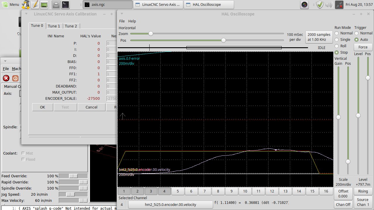

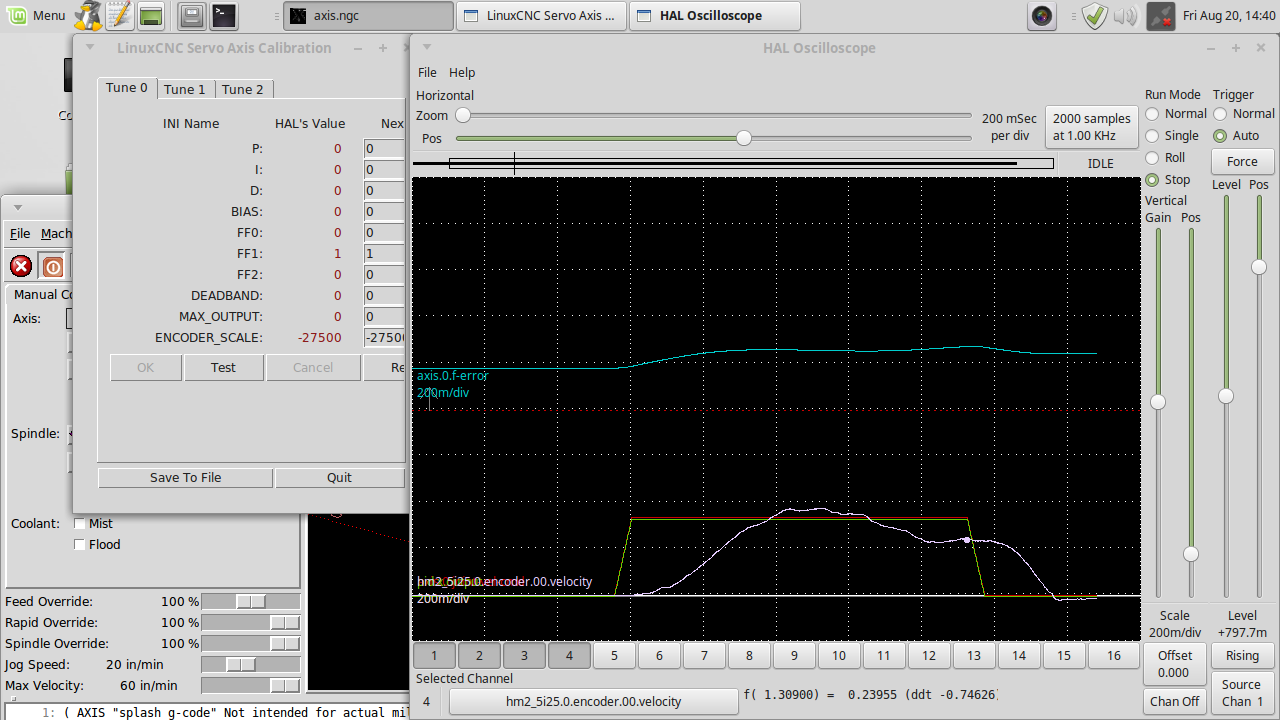

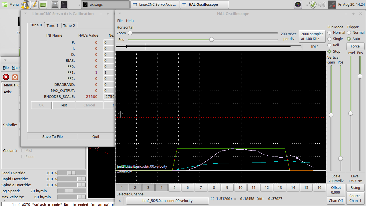

13 Jul 2022 14:46 #247238
by new2linux
Todd, thanks! This morning I have started with factory settings on SW2 & SW3, then only changed SW3, 1 switch at at time ,going from "on" to "off", so just this change. The file name are the settings, example: p1 8.5 p3 5.0 s2 f s3 f fd 20.0 is Pot1=8.5, Pot3=5.0, SW2=factory (.047), SW3=factory (.0147), feed 20.0"/min. The traces show purple (shows as white) trace as close to red trace using Pot3 (CCW makes trace go lower on screen) and still have motor move when commanded. The setting for Pot3 shows the lowest setting, but also as close to red trace and have motor move. The motor is slow to move on start, go up on pot3 & motor more responsive, but trace goes away from red trace.
The pics are just sw3-6 to 10, 1 switch at a time.
Suggestions are welcome.
Many thanks
Many thanks

13 Jul 2022 19:25 #247246
Replied by Todd Zuercher on topic Set up using AMC AB15A100 drives, brushed DC motor Prototrak Plus with Encoders
The last one is by far the best one but it is still pretty awful. I'm not sure we are learning much blindly flipping the SW3 switches.
What I'm seeing there is a very slow response, then a long slow over shoot period, then that bump on the end is the drive finally settling for a moment before decelerating.
I think you need to concentrate on tuning with SW2 and pots 1 and 3. I'm not sure I've seen your results of trying to do this with the new power supply.
Are you sure SW1 switch 1 and 3 are in the off positions?
