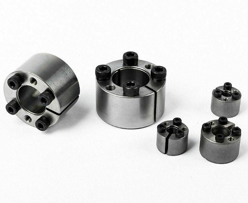

Is the lack of taper-lock or QD bushing AT5 availability due to location?
Do you have a lathe available? If so, there are some fairly easy options available way better than a set screw.
And yes, AT5 is significantly better for positioning than HTD.
