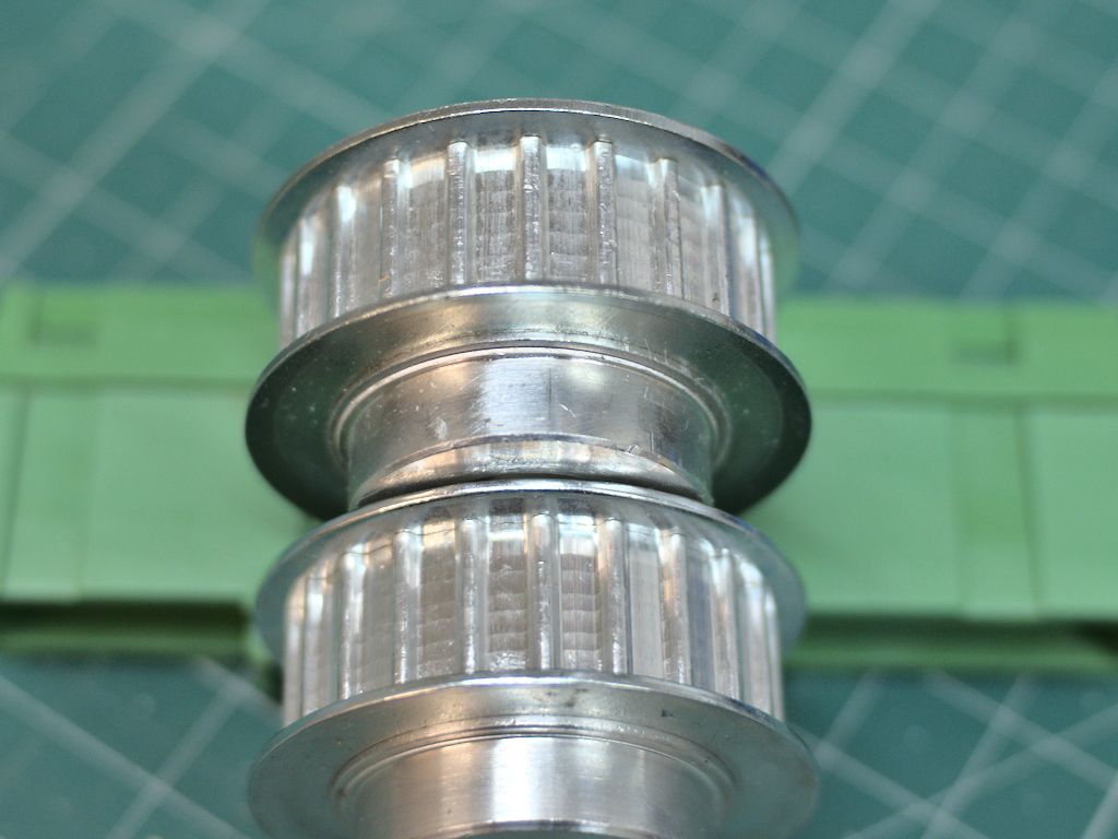

02 Feb 2022 16:30 - 02 Jul 2022 01:31 #233812 by arvidb
Replied by arvidb on topic Taperlock HTD -vs- AT5 with setscrew
I got the new pulleys a while ago and have now had time to do some experimentation. Here are the two 22-AT5 pulleys; the closest one is the one from Agrolager and the further the one from Technobots:
The teeth are pretty much indistinguishable by eye. But the Agrolager one has much less backlash than the Technobots one! (This is with the same Technobots belt; I forgot to buy a new one from Agrolager...) There's still the tiniest amount of backlash with the Agrolager pulley + the Technobots belt: not enough to be felt, but I can just about see a little bit of motion of the belt on the pulley.
TL;DR: Not all AT5 pulleys are made equal and some's got a lot of backlash! Buy a single set and test for backlash before going all in from any particular seller.

03 Feb 2022 17:44 #233894 by Muzzer
Replied by Muzzer on topic Taperlock HTD -vs- AT5 with setscrew
If you look at the dimensioned drawings for the pulley tooth profile and measure what you are being supplied, I think you will find they are quite different - they certainly look it from here. You could measure and compare the matching belt and pulley features to get an idea.
Most of these pullies are machined from long lengths of Chinese pulley stock, so it seems you will find the same issue no matter where you look. Sorry I don't have the drawings to hand but I ended up making my own pullies in the end, as it seemed to be the only sensible solution in my situation.
An HTD5 pulley can take a massive torque and I suspect many applications are way overspecified. Also, on my systems, the MoI of the ballscrews far outweigh the MoI of the pullies.
