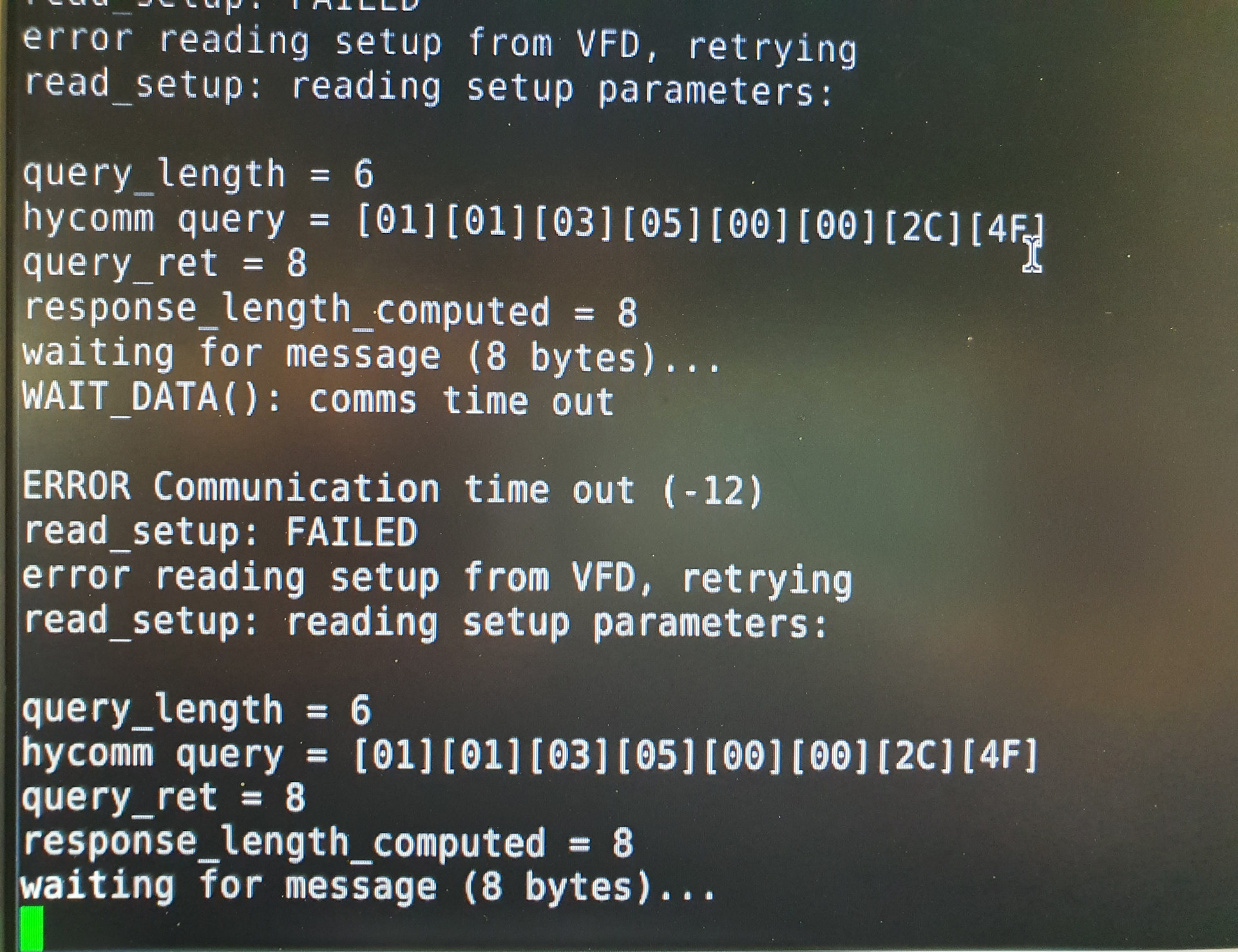

07 Mar 2022 13:36 - 07 Mar 2022 20:53 #236578 by Manu663
Replied by Manu663 on topic failure Huanyang VFD HY01D523B
I'm finally back at home.
Following Andy's (good) advice I've started LinuxCNC with the command line and here's the result:
ERROR Communication time out (-12)
error reading setup from VFD, retrying
WAIT DATA (): comms time out
I've checked the the COM port was the right one  (ttyUSB0) with the Custom HAL file (involved line shown below )
loadusr -wn vfd hy_vfd -n vfd -d /dev/ttyUSB0 -p none -r 9600
but I have no real doubt about that because I did not change anything since that bloody failure appeared.
So I've applied a factory reset to the VFD and entered again all the data to be sure not to miss something (I have fiddled with the settings so much during troubleshooting that I preferred to start with a clean config!)
I made sure that the serial baud rate was set to 9600 baud on the VFD but no improvement
Last edit: 07 Mar 2022 20:53 by Manu663.

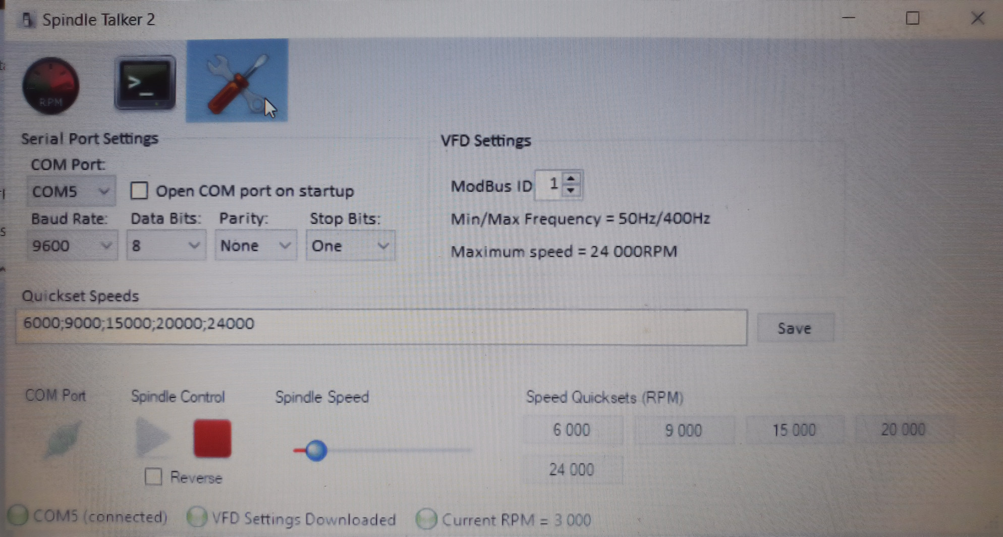

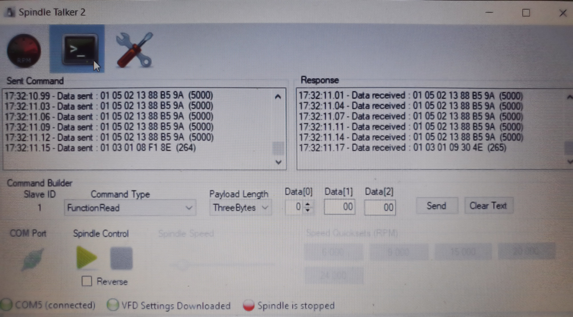

10 Mar 2022 18:33 - 10 Mar 2022 18:35 #236872 by Manu663
Thank you again Andy for the follow up!
Well, today I wanted to know more about the VFD and its ability to communicate on the serial port.
So I downloaded a little software on a window laptop :    github.com/GilchristT/SpindleTalker2/releases  and after a few adjustments, I was finally able to start the spindle and vary its speed with my USB - RS232 dongle.
a little more reassured, I took the opportunity to check the baud rate: 9600
I read carefully the topic you quoted in which you had to adapt the driver to the VFD and I can't think of anything else to try:
Linuxcnc config identical to before the failure
VFD and its identical config
the only things that have changed:
the computer and the USB-RS232 adapter
I don't understand all the arguments you use in :
loadusr -Wn spindle-vfd hy_vfd -S 24000 -F 400 -n spindle-vfd -t 1 -d /dev/ttyUSB0 -p none -r 19200 -s 1 -g
and so I'll just copy the line over and replace my actual one which is
with one change, I'll replace 19200 with 9600 (baud rate)
Does this make sense to you or am I wrong again?
Last edit: 10 Mar 2022 18:35 by Manu663.

12 Mar 2022 16:59 - 13 Mar 2022 20:34 #237007 by Manu663
Well after a bit of adaptation to fit with my config (shown below)
loadusr -Wn vfd hy_vfd -S 24000 -F 400 -n vfd -t 1 -d /dev/ttyUSB0 -p none -r 9600 -s 1 -g
I get this result:
Any idea ?
I played with baudrate, parity, bit stop, no change .
Last edit: 13 Mar 2022 20:34 by Manu663.
