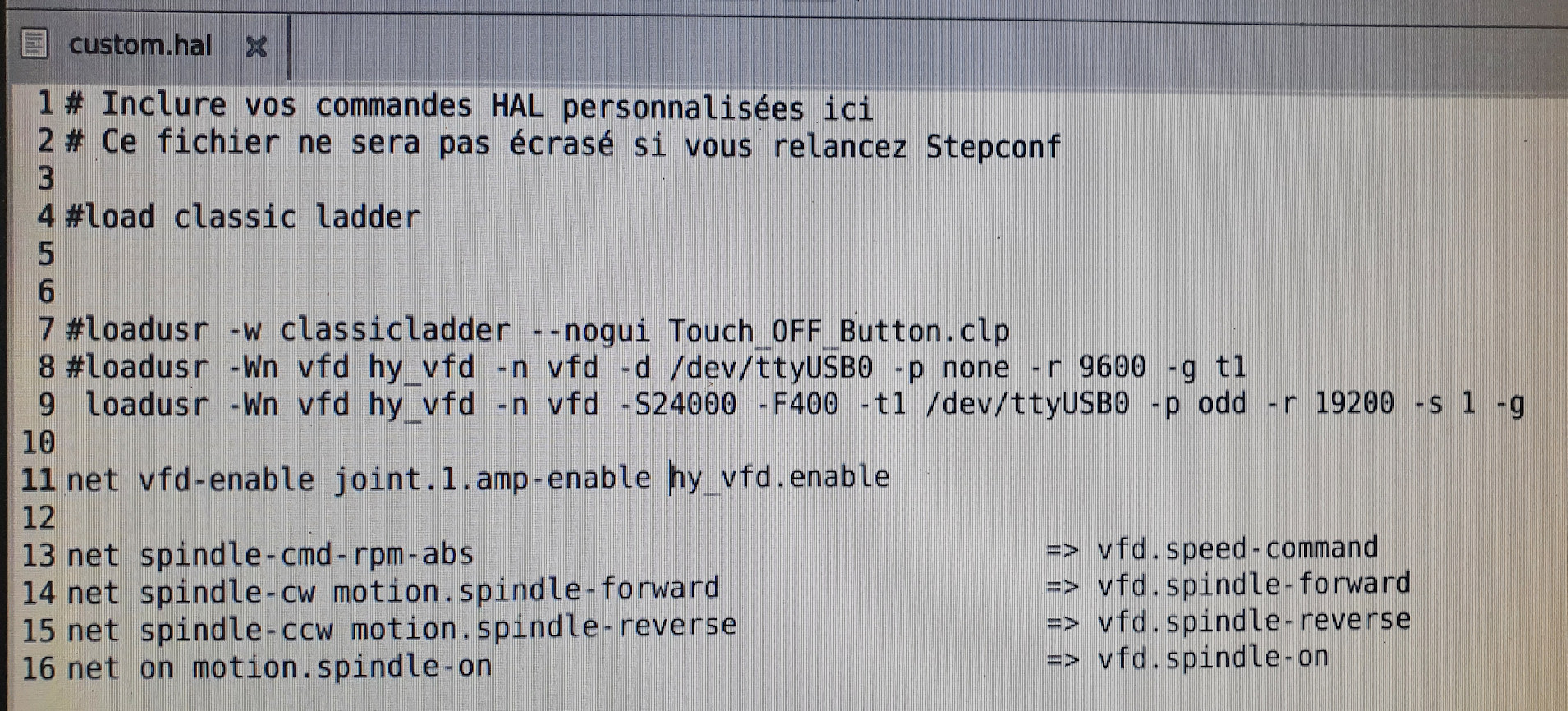

17 Mar 2022 16:49 - 17 Mar 2022 16:50 #237539
by Manu663
Replied by Manu663 on topic failure Huanyang VFD HY01D523B
Parity set to none and setp hy_vfd.enable 1 added in Custom hal file
I have the below message before closure:
./custom.hal:11: parameter or pin 'hy_vfd.enable' not found
I've attched the .ini, .hal & custom.hal files
Last edit: 17 Mar 2022 16:50 by Manu663.
- Posts: 19899
17 Mar 2022 16:53 #237540
Replied by andypugh on topic failure Huanyang VFD HY01D523B
OK. So you have decided to change the name of the VFD with the -n option.
use vfd.enable instead.

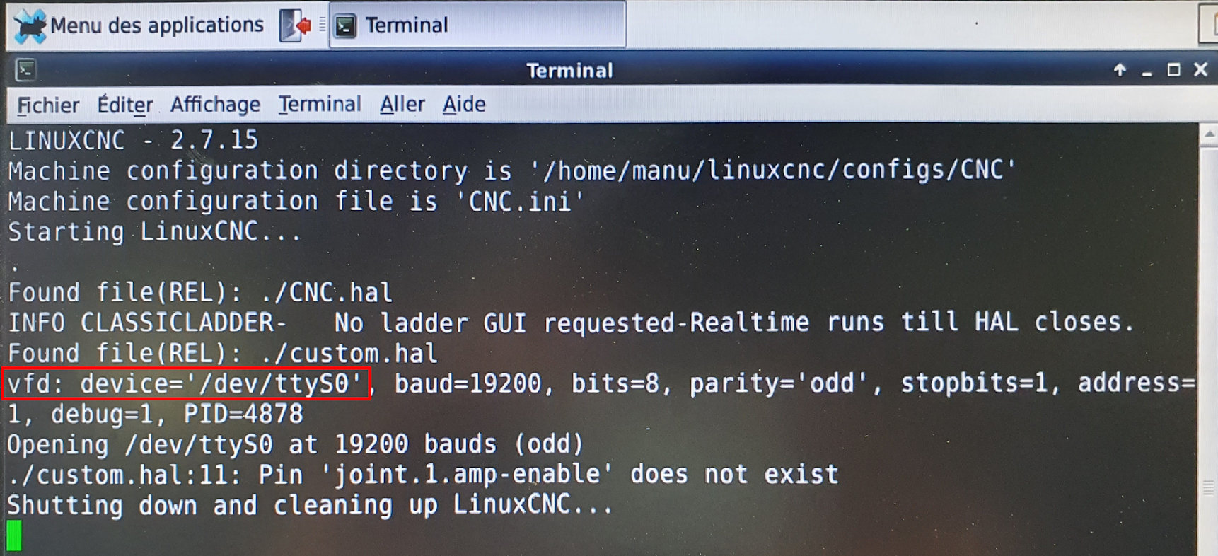

- Manu663
- Posts: 26
17 Mar 2022 17:17 #237543
by Manu663
Ok, i've set it as follows:
setp vfd.enable 1
But i got the same message as at the beginning .
Read setup failed
Error reading setup from vfd retrying
Coms time out
setp vfd.enable 1
Read setup failed
Coms time out
- Posts: 19899
17 Mar 2022 17:38 #237545
And parity?

- Posts: 19899
17 Mar 2022 22:43 #237581
I am at a loss. Though I have just noticed that you are _still_ not using the command line that I suggested; you have dropped the -b8
Does it definitely not work, (ie, ignore the messages and carry on regardless)
Note that it is often easier to debug in a live HAL session. With Linuxcnc _not_ running, open a terminal and:
halrun
loadusr -W hy_vfd -d /dev/ttyUSB0 -r 19200 -b8 -pnone -s1 -t1
show pin
setp hy_vfd.spindle-forward 1
setp hy_vfd.spindle-on 1
setp hy_vfd.speed-command 10000Please Log in or Create an account to join the conversation.
