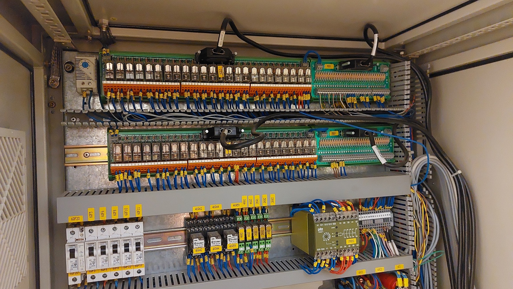

I have a Morbidelli Author 400 machine which has got a NUM 1020 control today that I wish to convert. I have issues with the control PC has not failed and I have wanted to change the control system for something modern anyway for quite some time. I have been using it to mill a lot of aluminium and have done some modifications to it. I could possibly use the NUM 1020 controller but I feel it would be too much of a headache compared to just going with linuxcnc.
The mill uses Yaskawa 1xSGDB-15VD and 2xSGDB-10VD servo drives thus I am leaning towards using Mesa 7I97 for this. I think they should directly interface without problems. Thoughts?
The Control cabinet has got all I/O going to relay or an I/O board so doing the conversion should be rather easy. See picture,
So my idea is to make an own PCB with all connectors that exist on the current NUM 1020 controller and have this board as a interface towards the mesa boards. I will put any drivers needed for relays etc on my own board. There are 48 relays that need to be driven and there are 64 inputs. However not a lot of inputs are used, so I could probably skip having that much inputs. I think I will chose an 7I80HD-25 for this control thus just using a ribbon cable over to my own PCB.

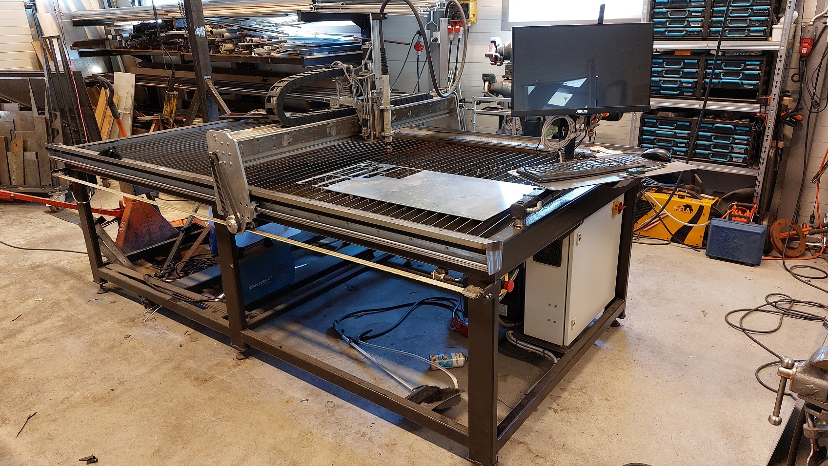

I will be using a 22" touch screen as on the CNC plasma table shown below and also probably have mechanical buttons plus an MPG.

VFD and servo drives

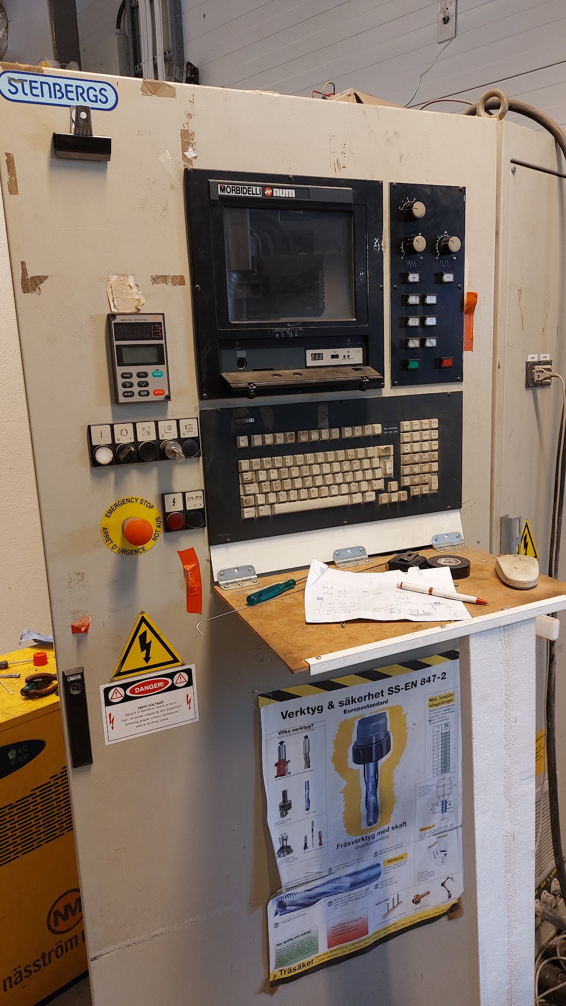

Control panel

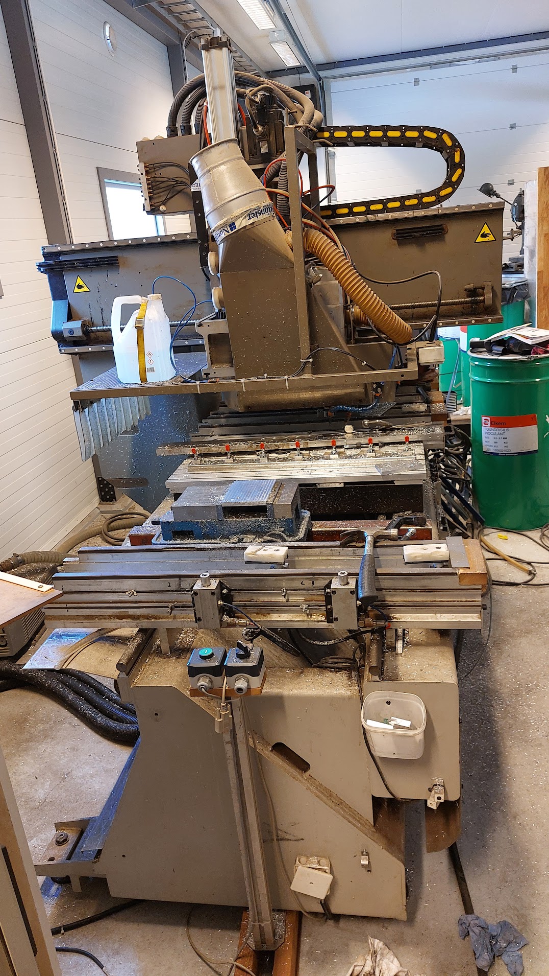

The mill standing as when it quit working
Bonus picture of the Plasma CNC also running linuxcnc

You wouldn't use a 7i97 _and_ a 7i80. It would generally be one or the other, and then suitable daughter cards.
The 7i64 might be an option to replace the relays (48V / 2.5A drivers)

I don't really want to replace the relay boards because the voltages those relays switch varies, some is switching mains voltages. Also for simplicity it is quite easy to just attach the cables today directly to the mesa driver board without much effort.
