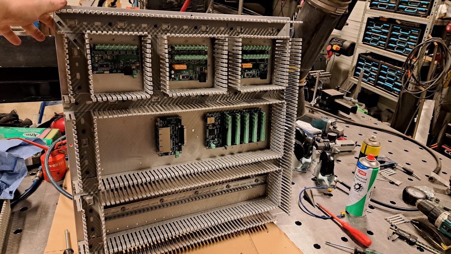

I have gotten around to working on this machine again. I have assembled all the devices on a sheet of aluminum that I will now start to work on configuring.
I have a question, when starting to configure a new machine, should I start using Axis and then go over to for example Probe basic or should I start with probe basic at once? I just ordered a VT229H touch screen for it as well.

Replied by Unlogic on topic Retrofitting Morbidelli Author 400
I'd start with Axis based on my recent experiences.
When everything is tested and working in Axis you have a good baseline config for the migration to probe basic making that step a bit simpler.
