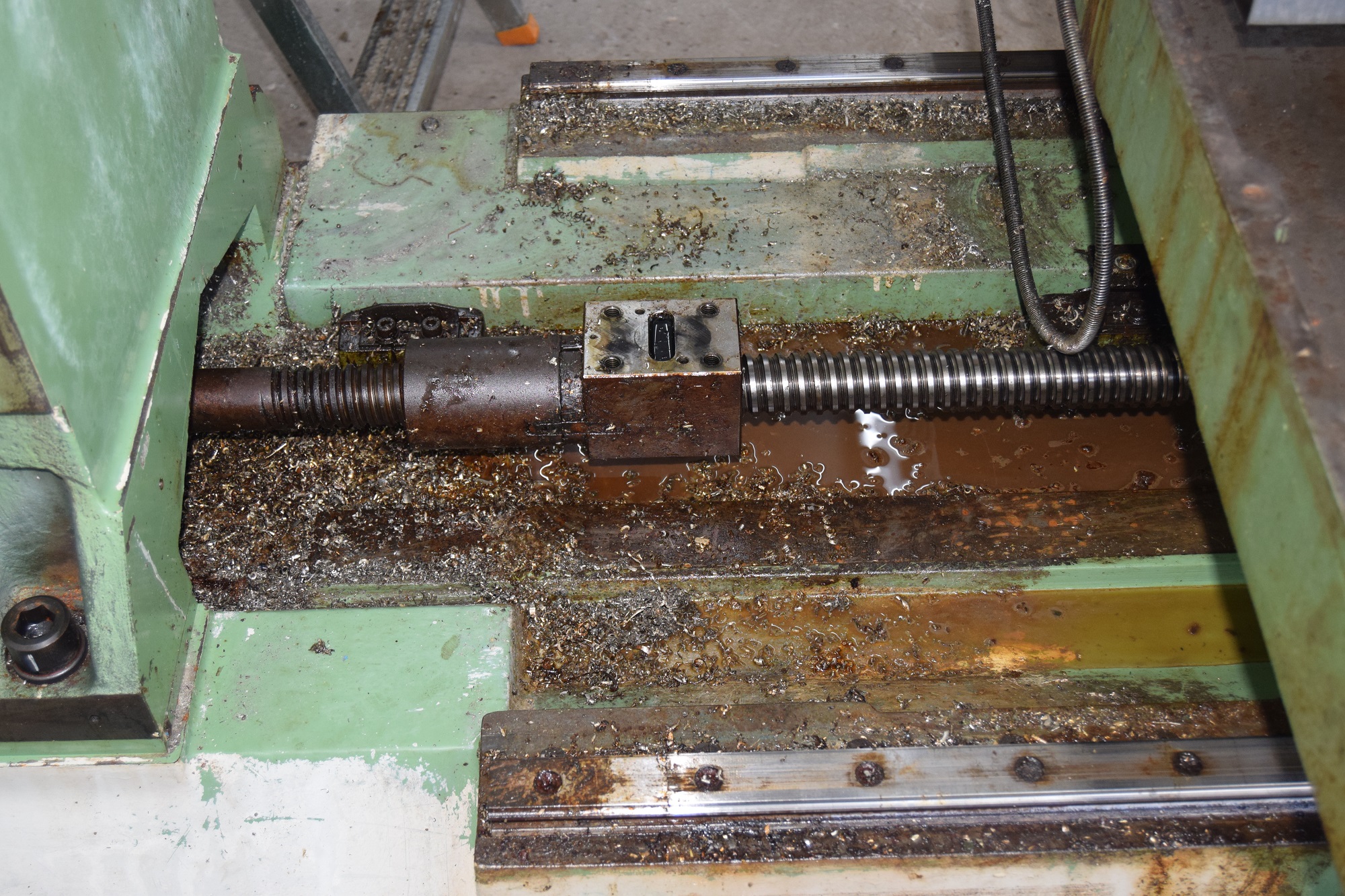

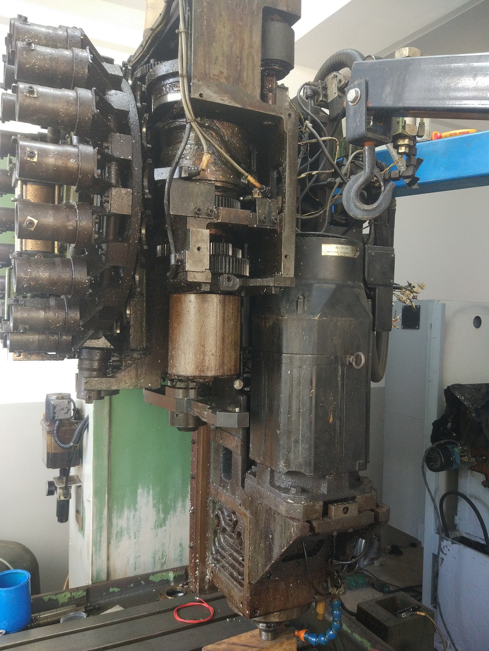

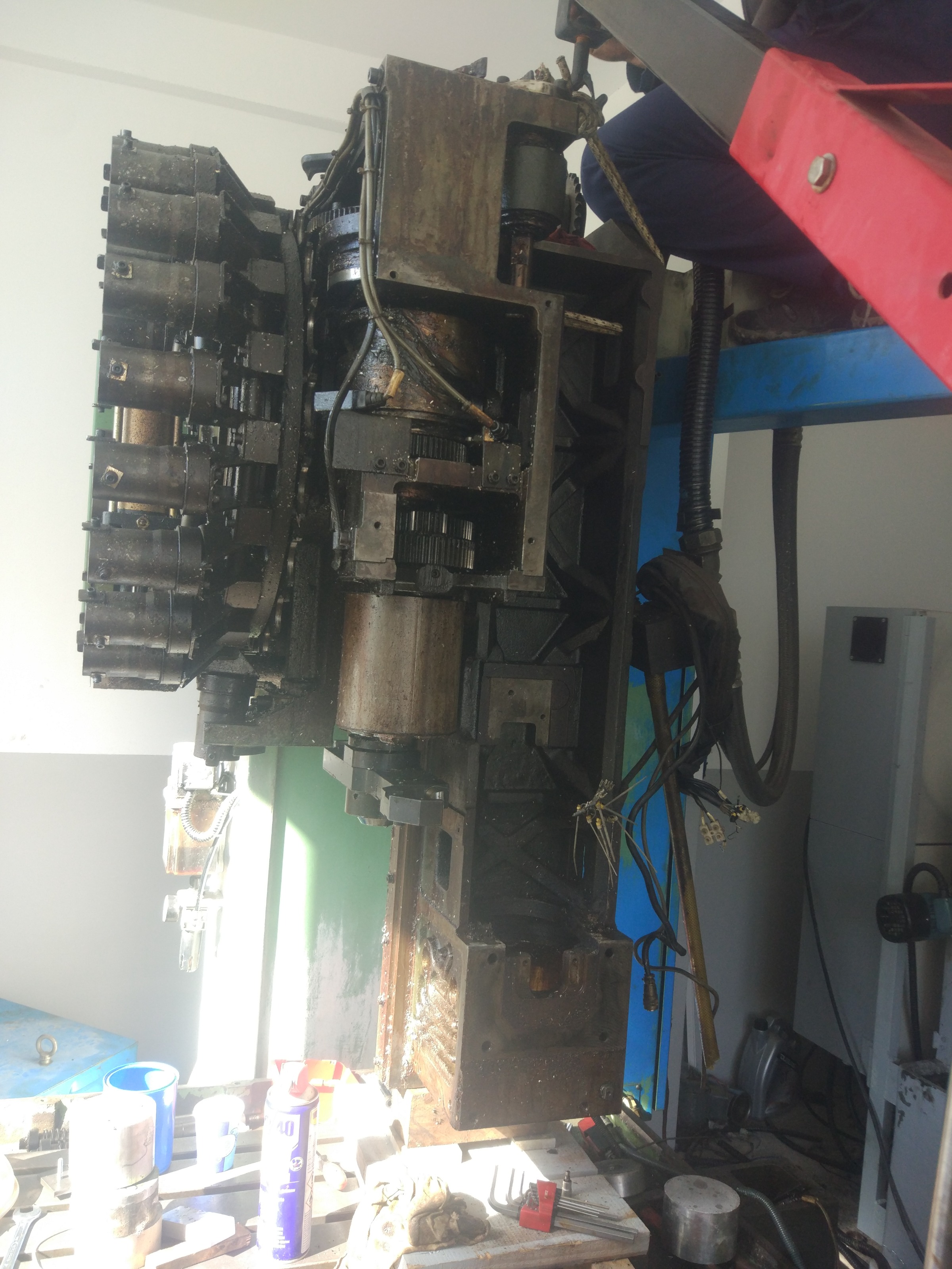

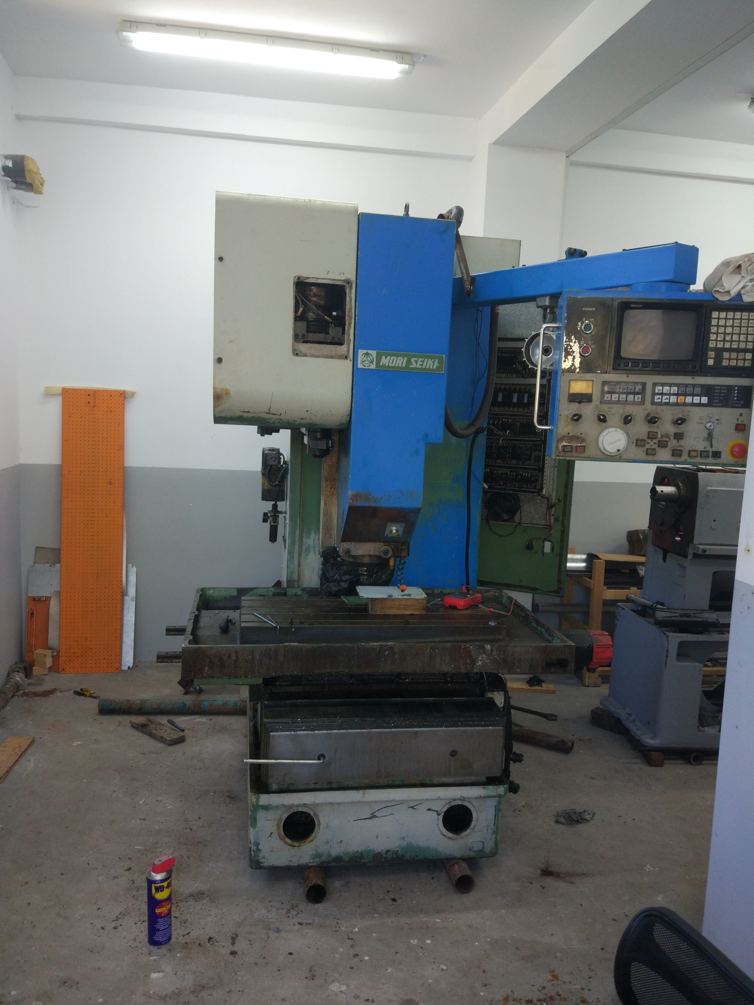

The project is in progress!

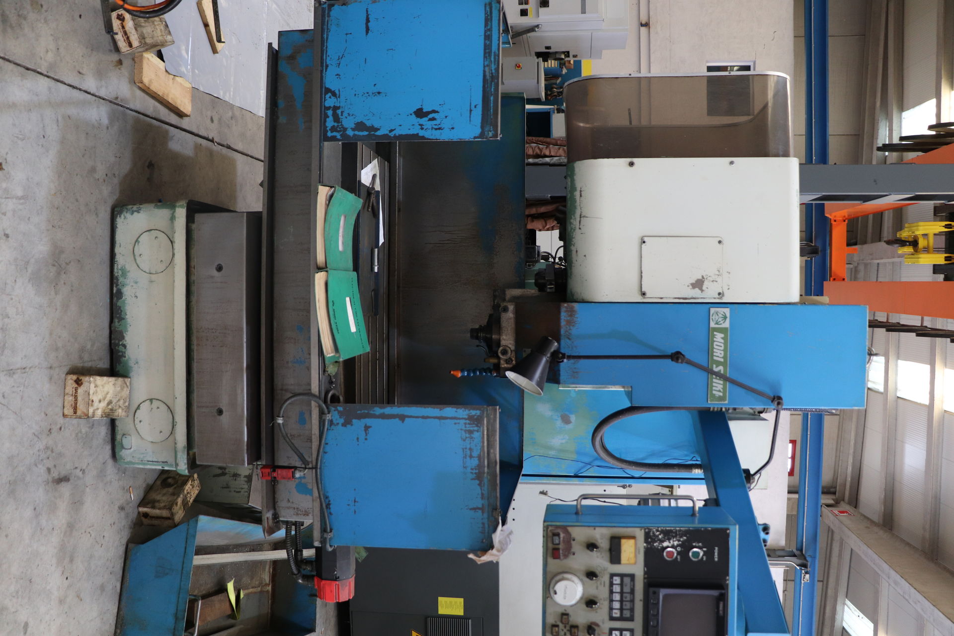

I am buying an old machine with a good reputation.
Specification:
Table dimensions 900mm x 410mm
Travel X560 ; Y410 ; Z460
Rapid feed rate X and Y 15m/min ; Z 12m/min
Ball screw dimensions 40x10mmP (X , Y and Z)
Main motor 3.7kw/5.5kw Max RPM 6000
Max Load on table 300kg
Weight 3.5T
Arrived at the new home

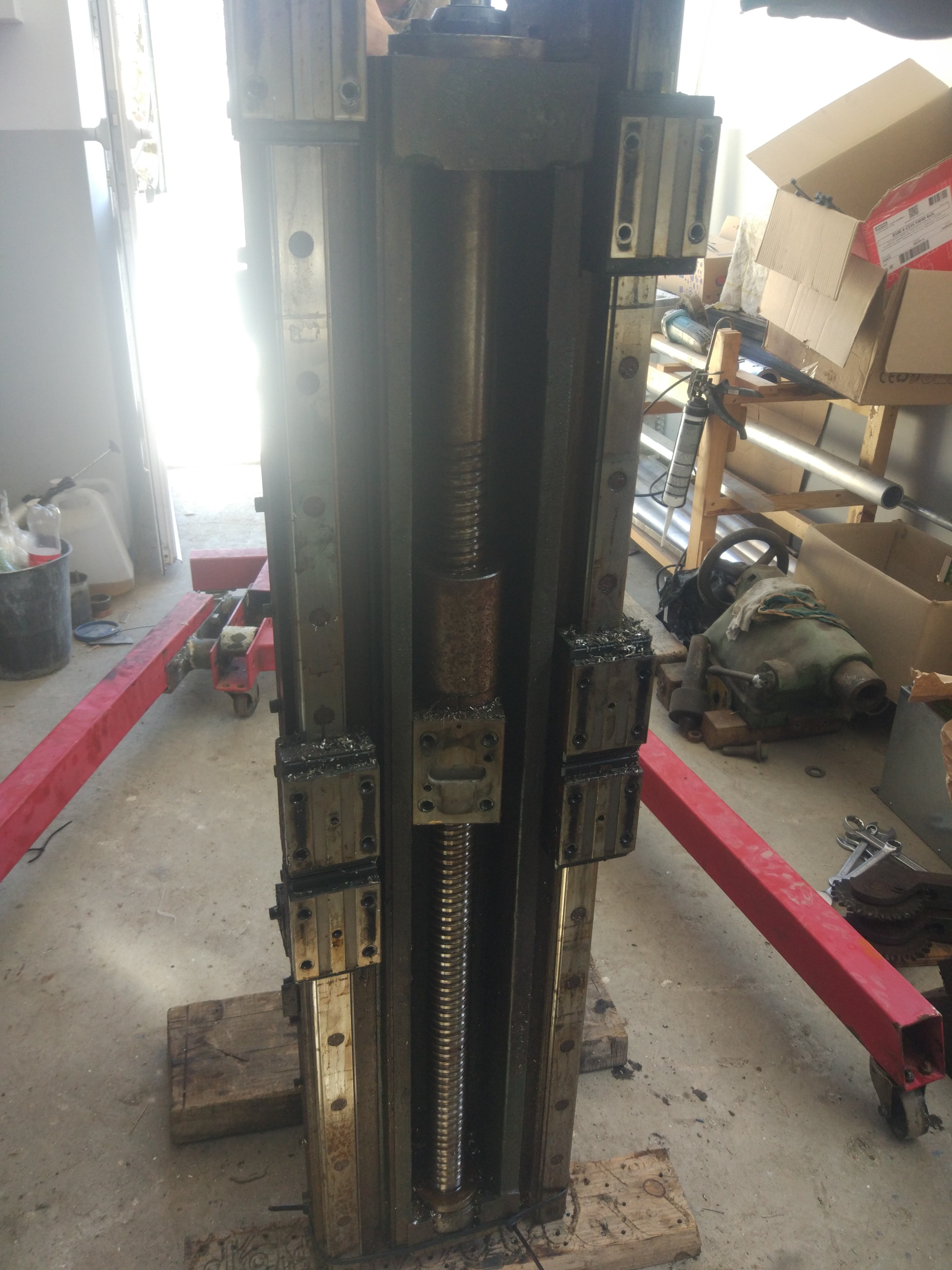

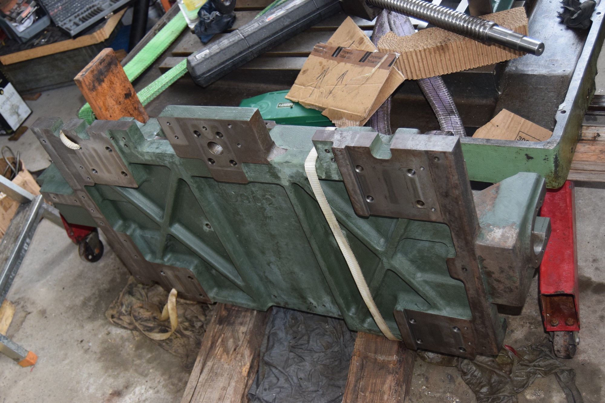

Dismantling of the Z axis:
Specification:
Weight 3.5T

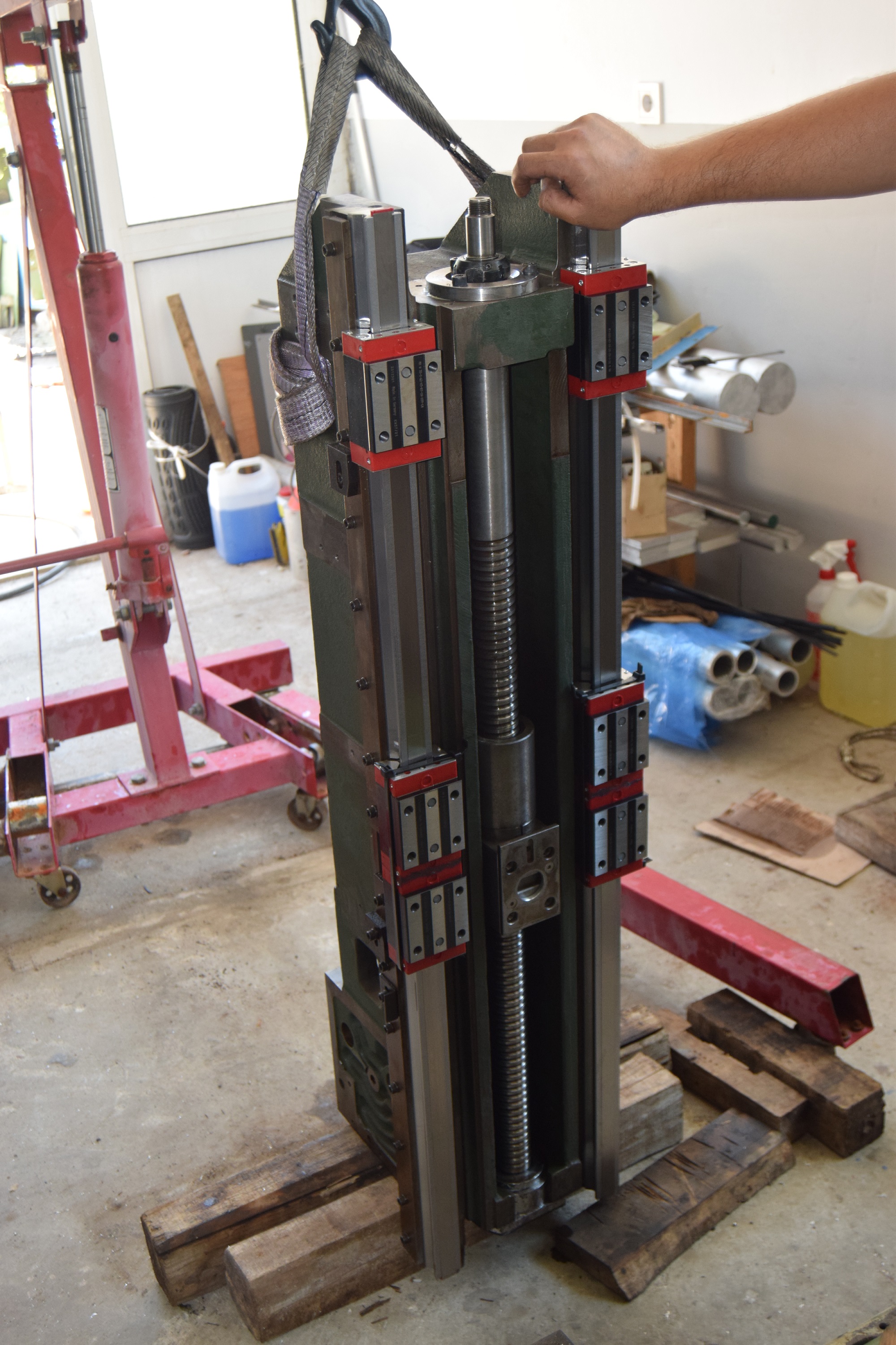

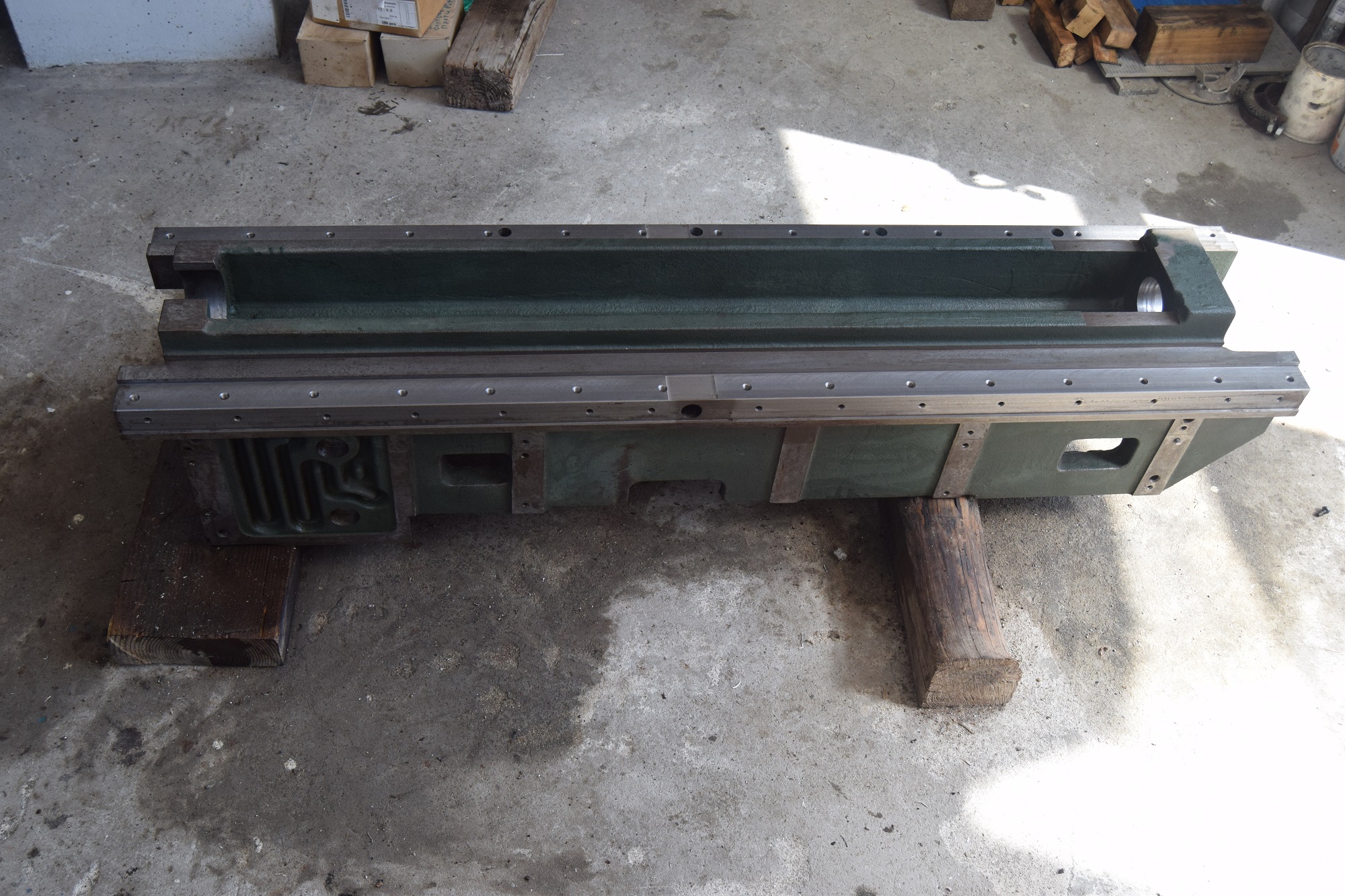

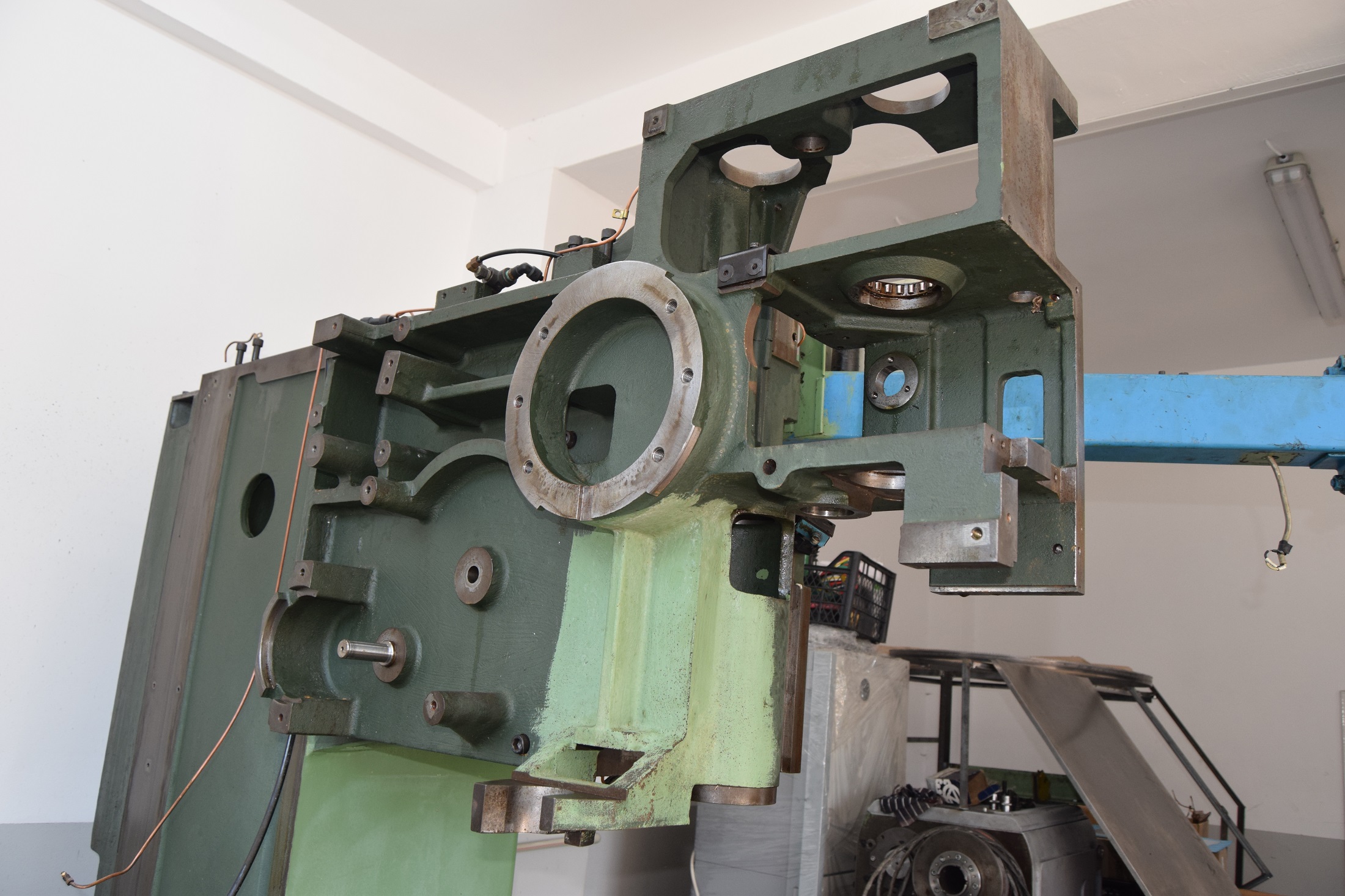

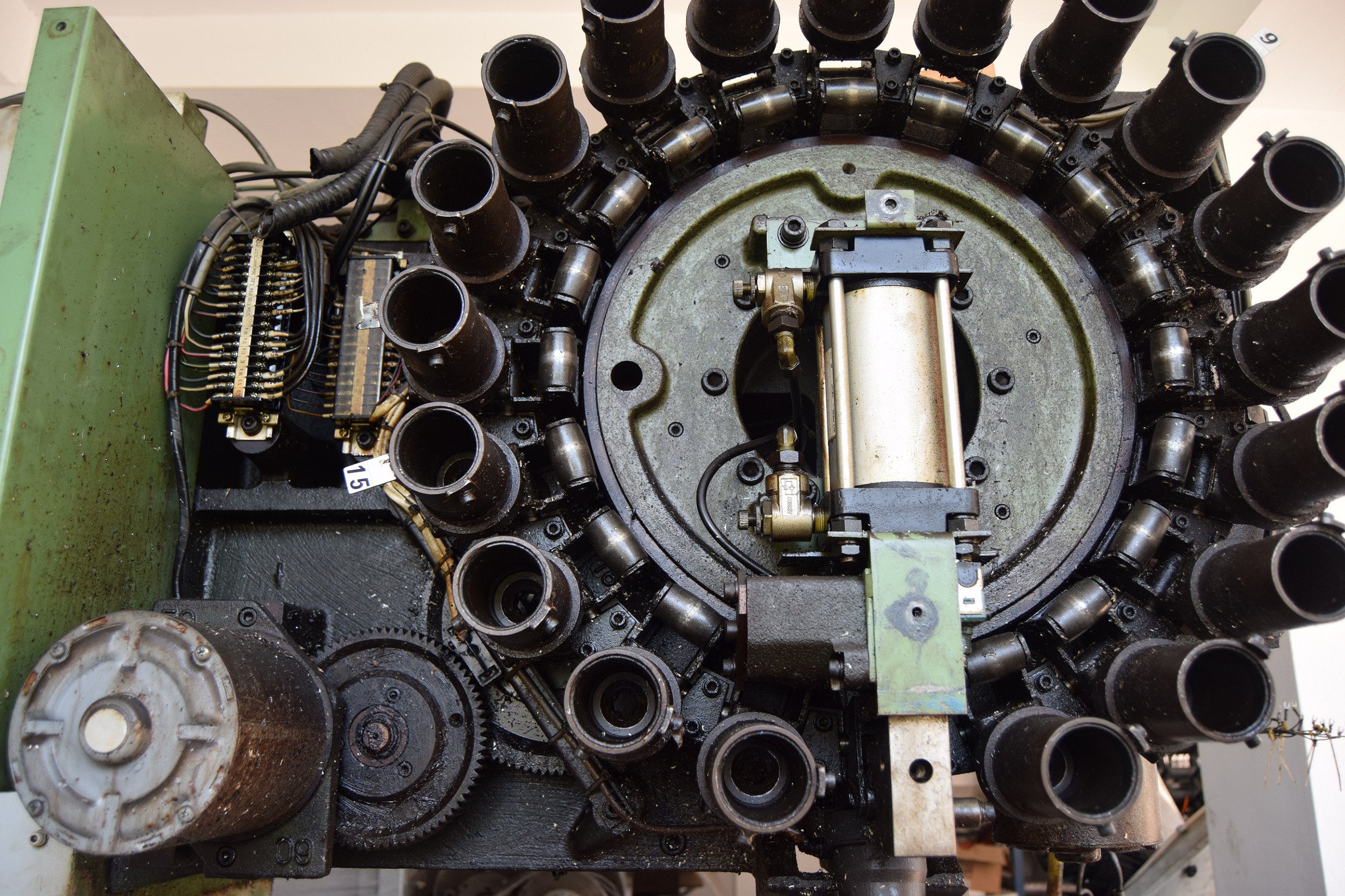

I will continue with photos .
Cleaning from the old oil.

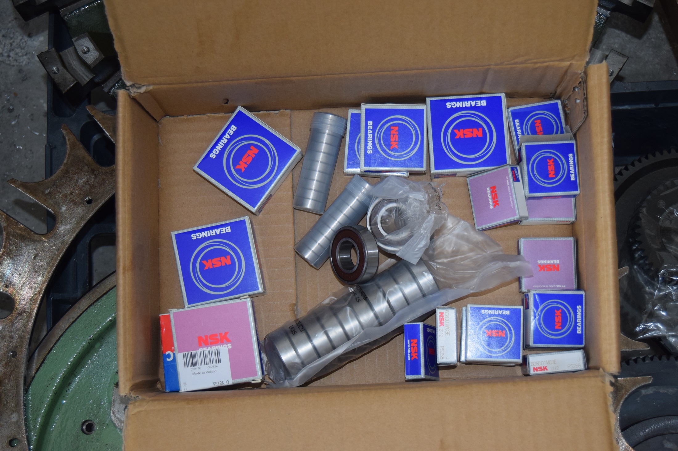

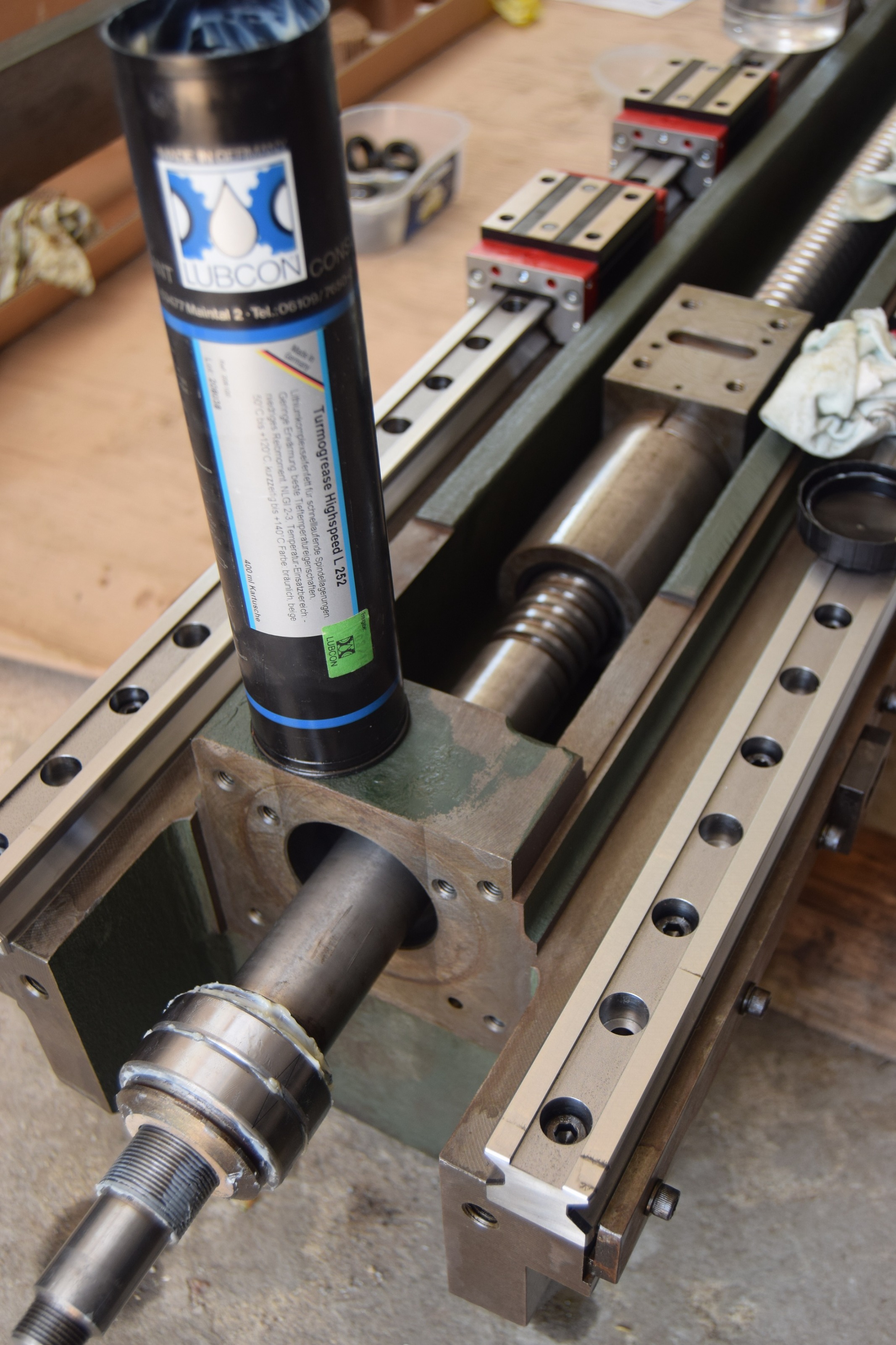

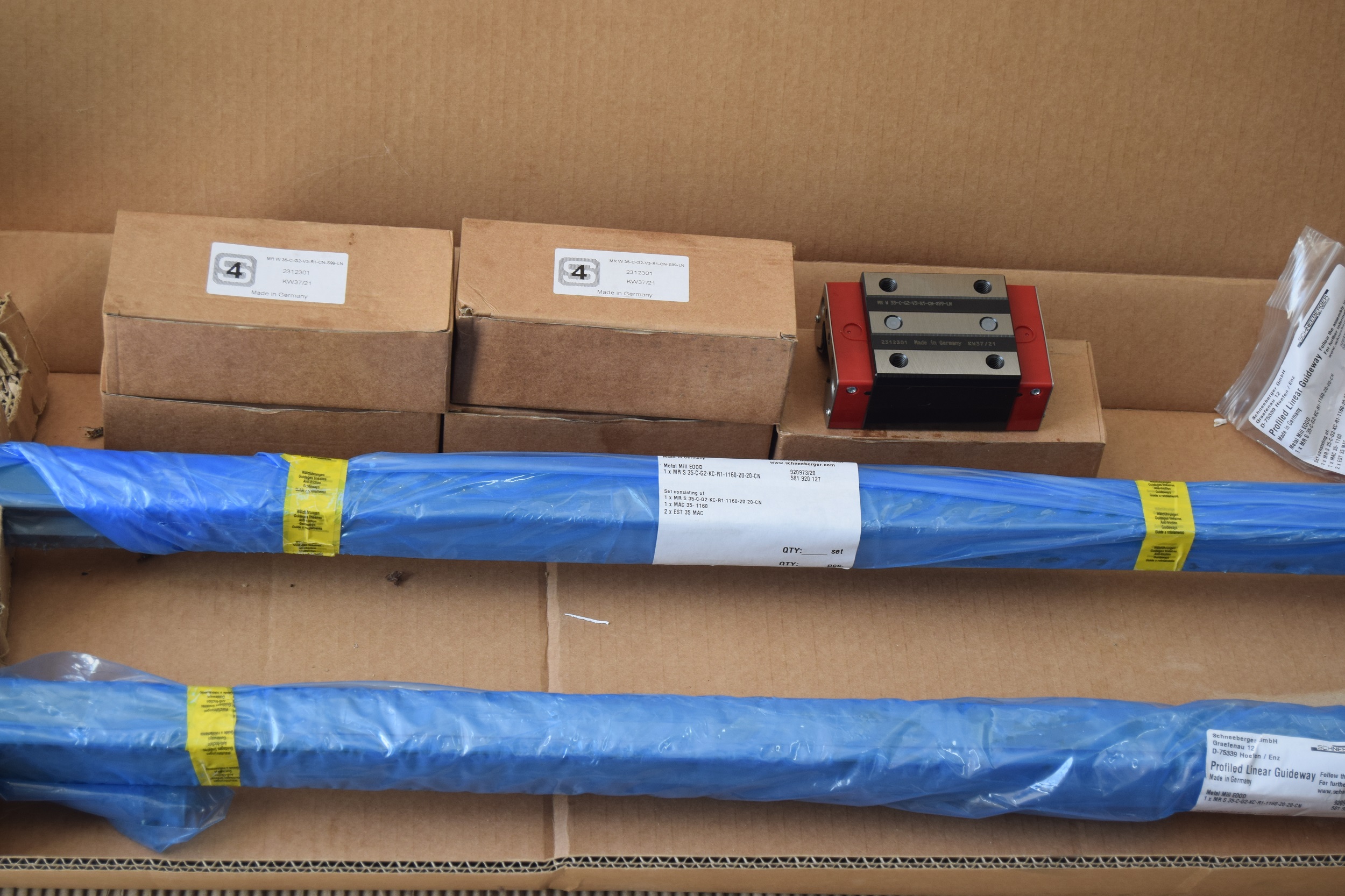

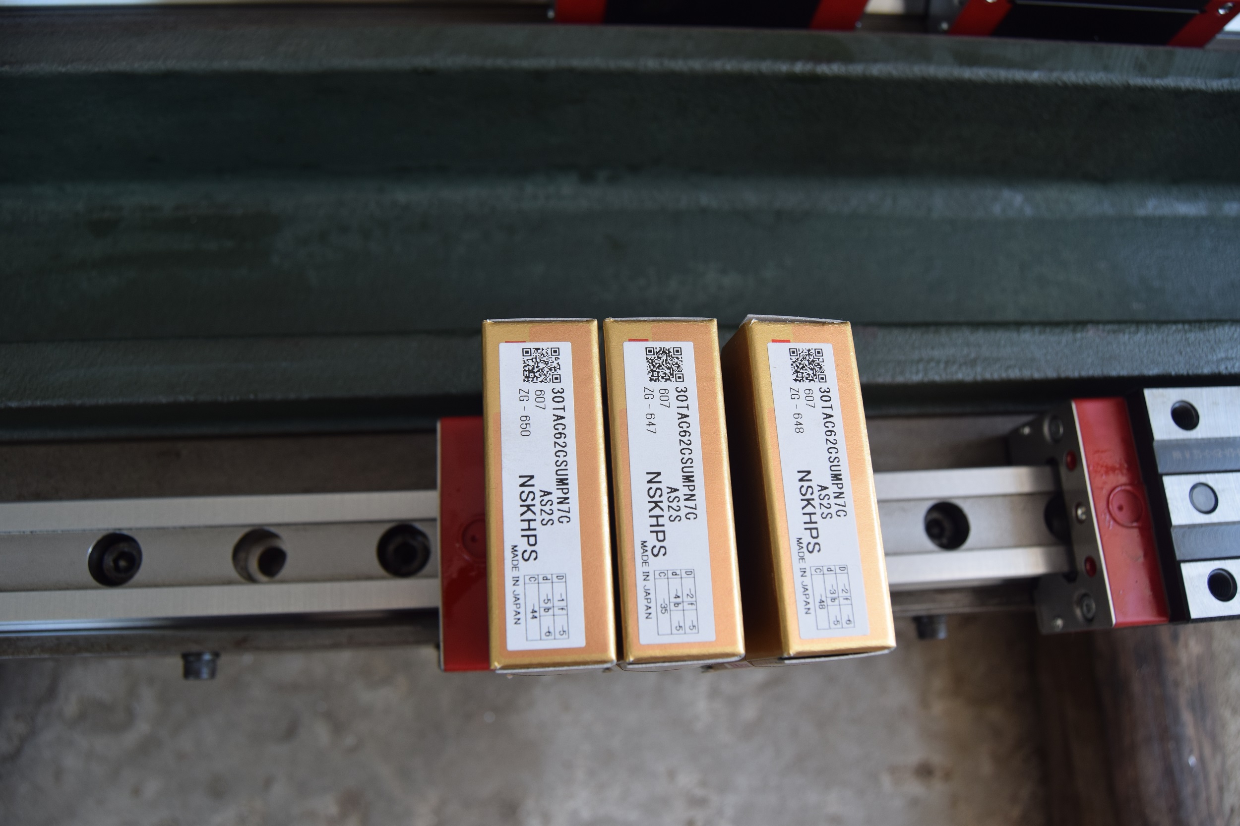

Replacing the guides with new roller SCHNEEBERGER. Replace the ball screws with the suitable size and replace all support bearings 12pcs (for z , x and y)- 30TAC62 .

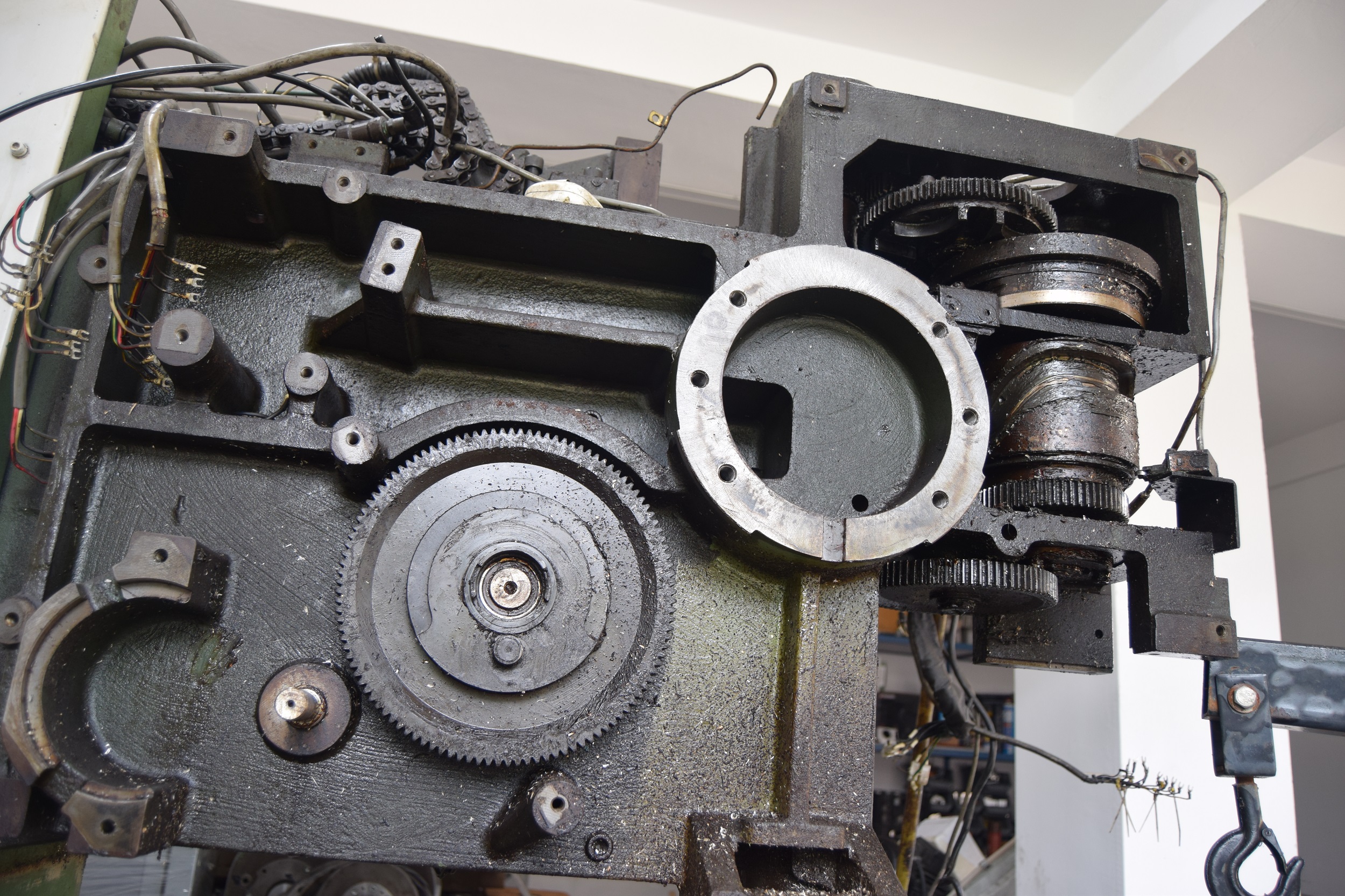

Dismantling, cleaning and replacement of bearings in the ATC. A few photos of the process

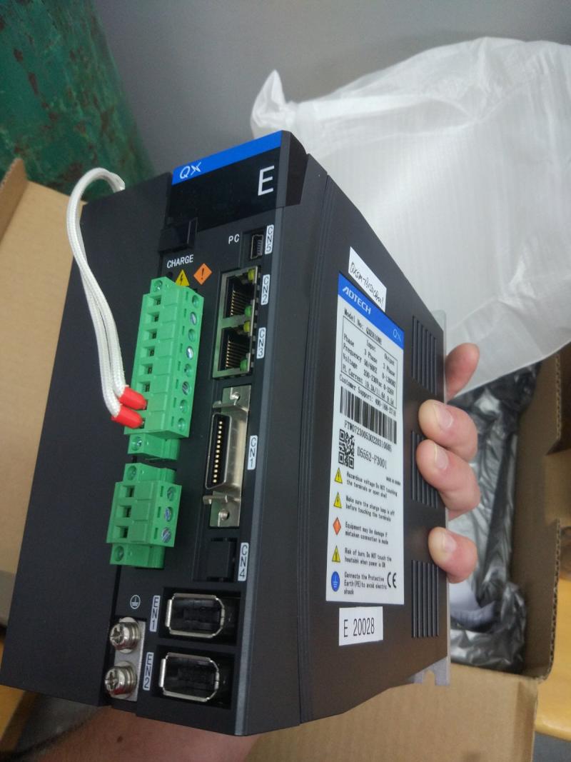

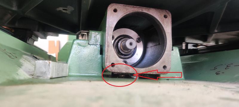

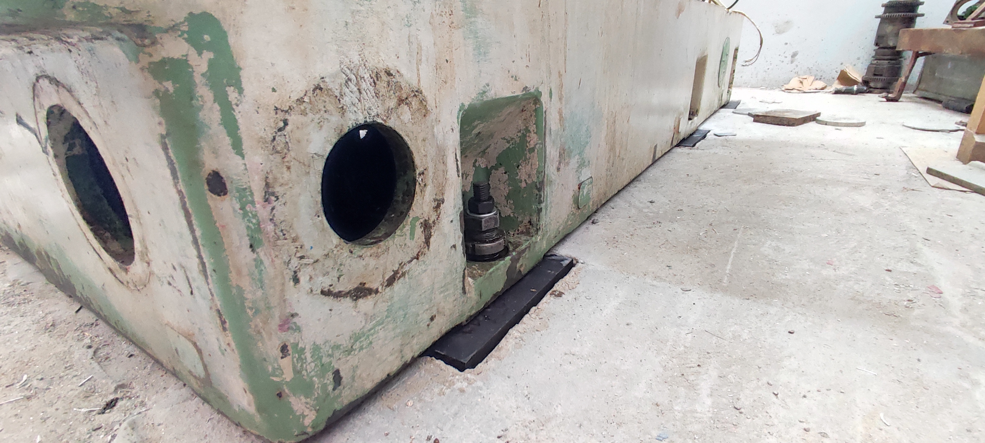

Each ball screw has 3 bearings 30TAC62 , the screw is secured with an additional body (grinding cylinder with dimensions of 40-60mm ).

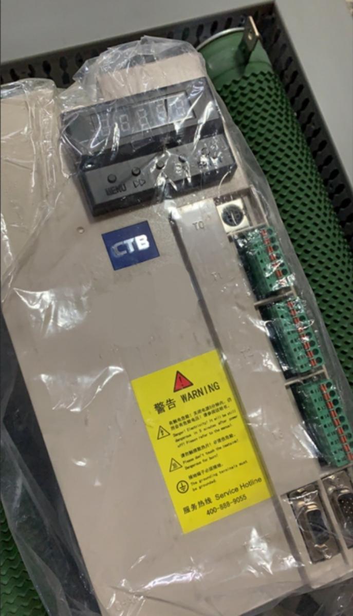

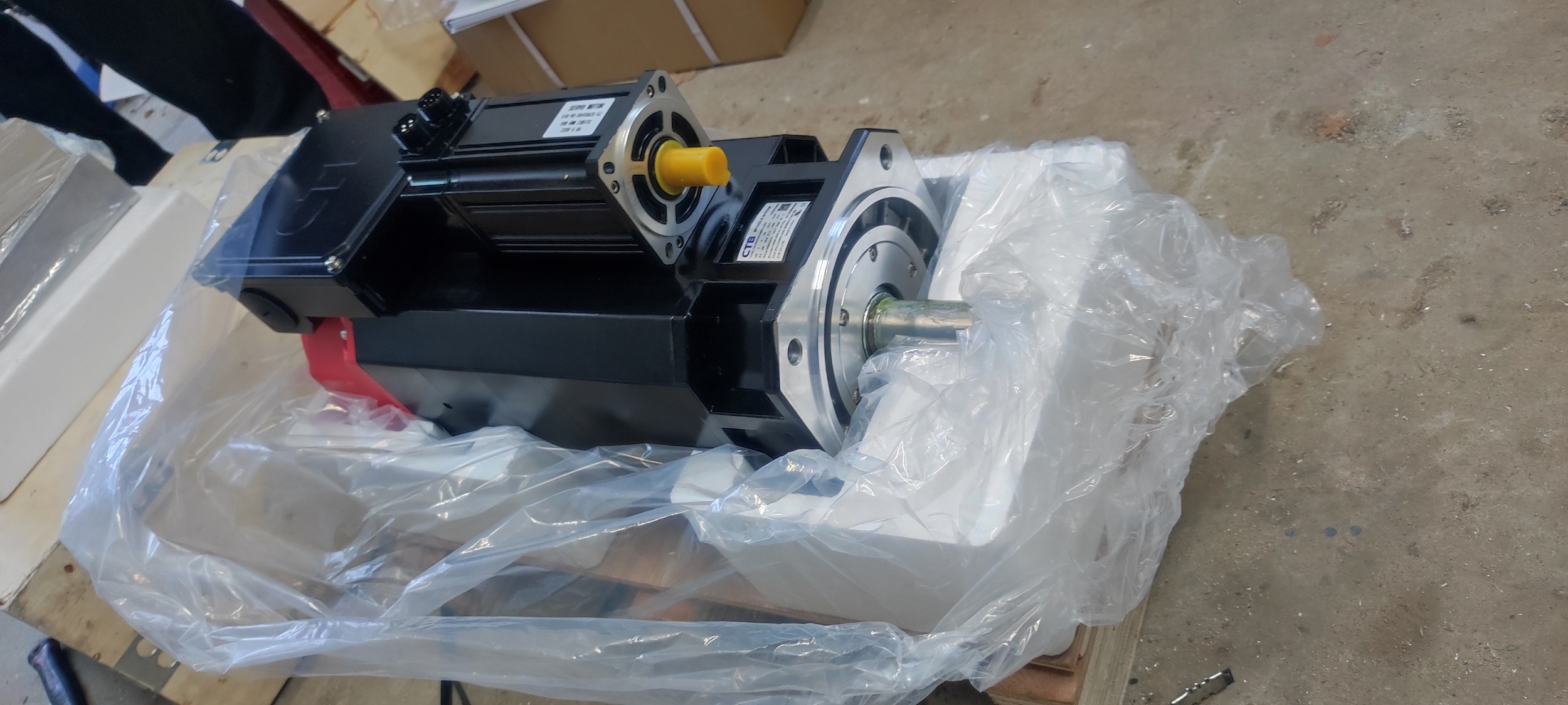

New servo motors for spindle and axis
The drive is with Etercat and mesa cards for spindle and I/o port.

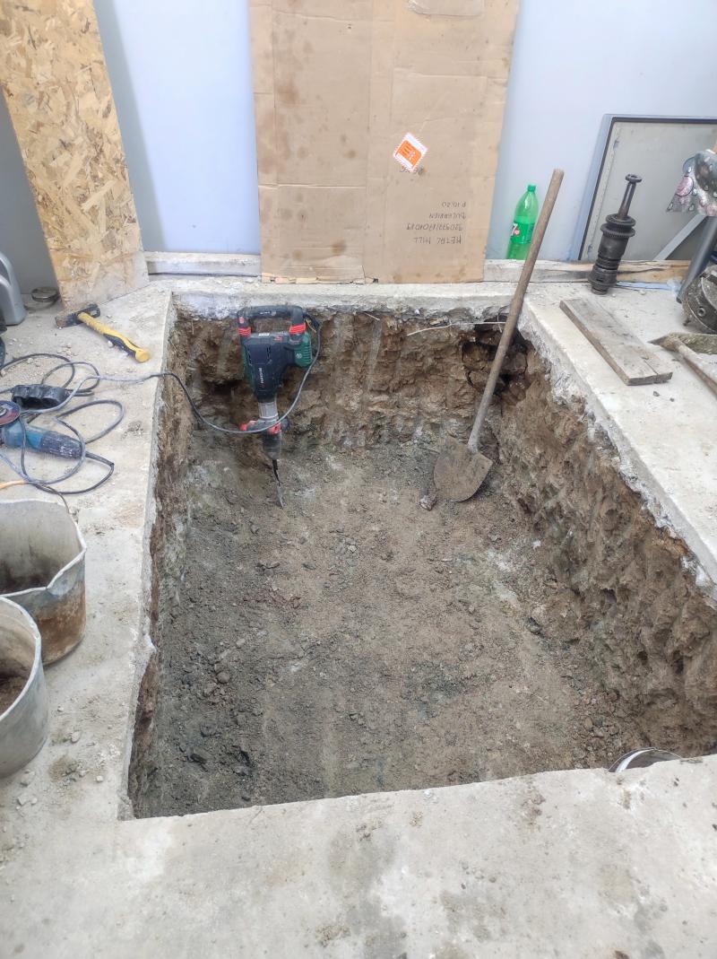

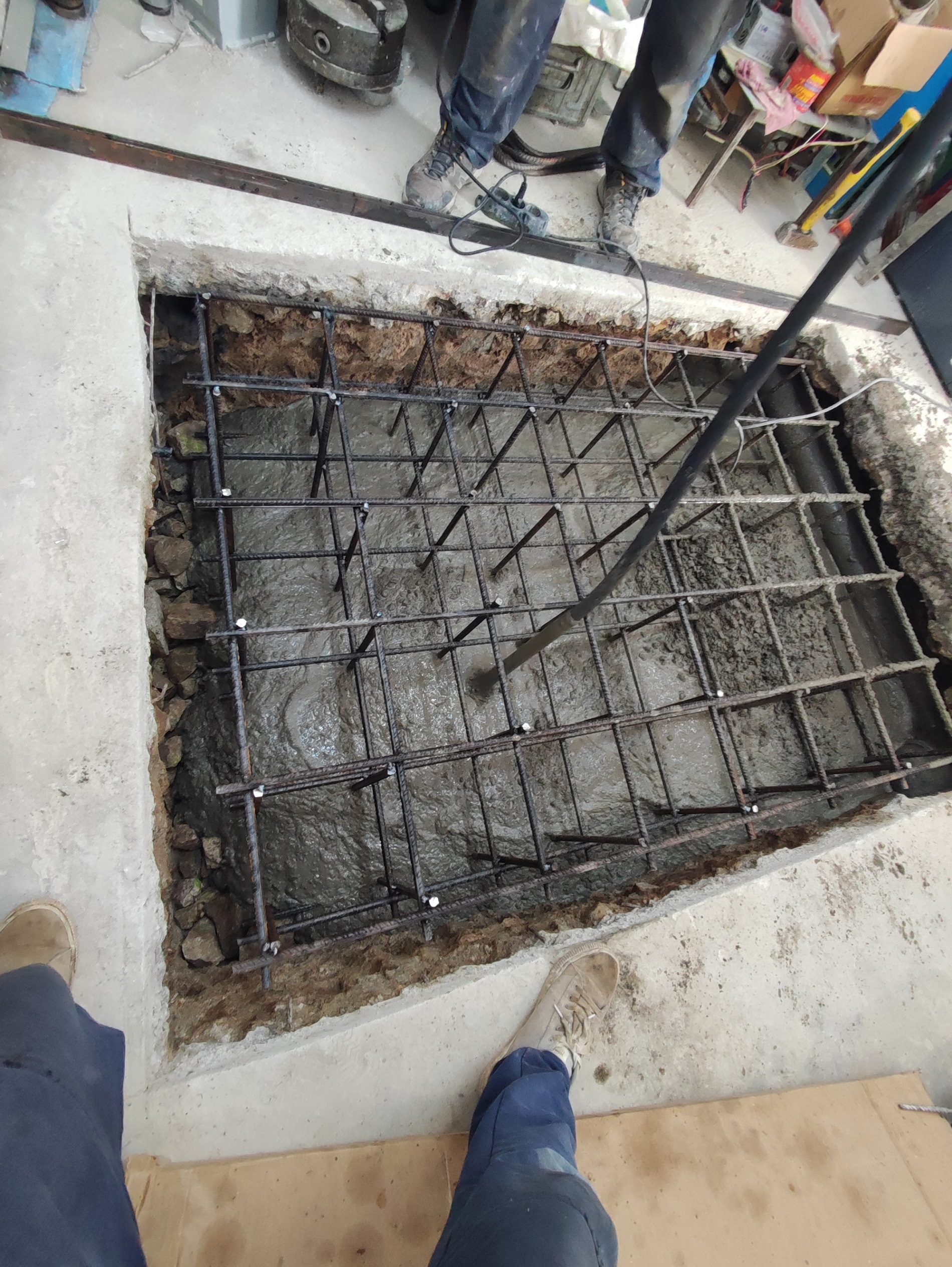

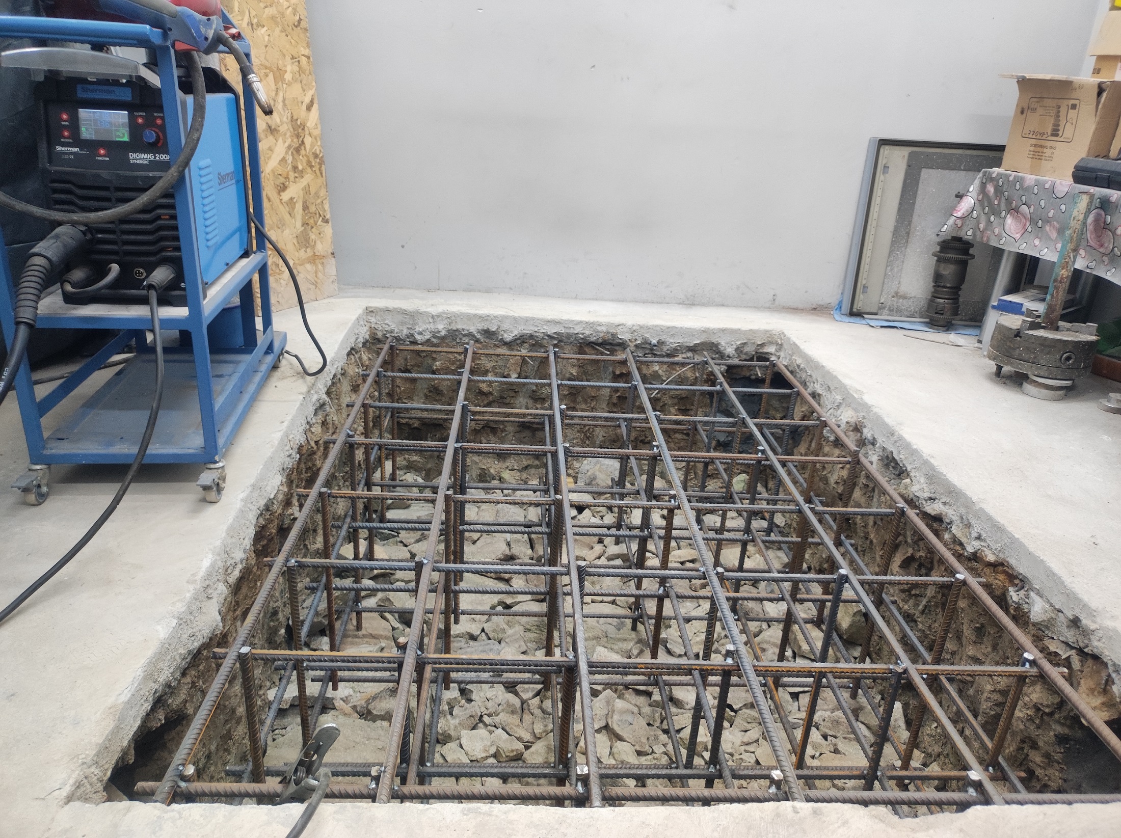

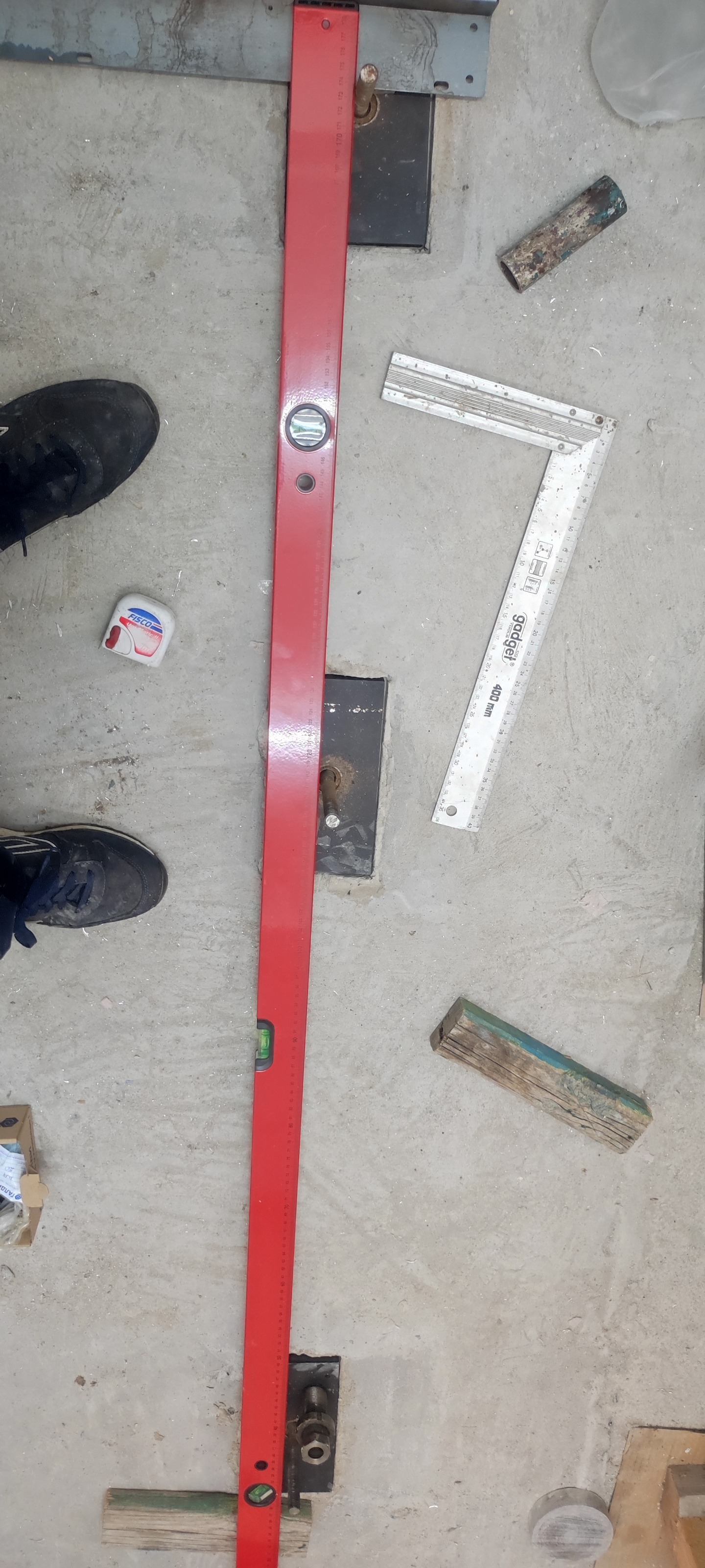

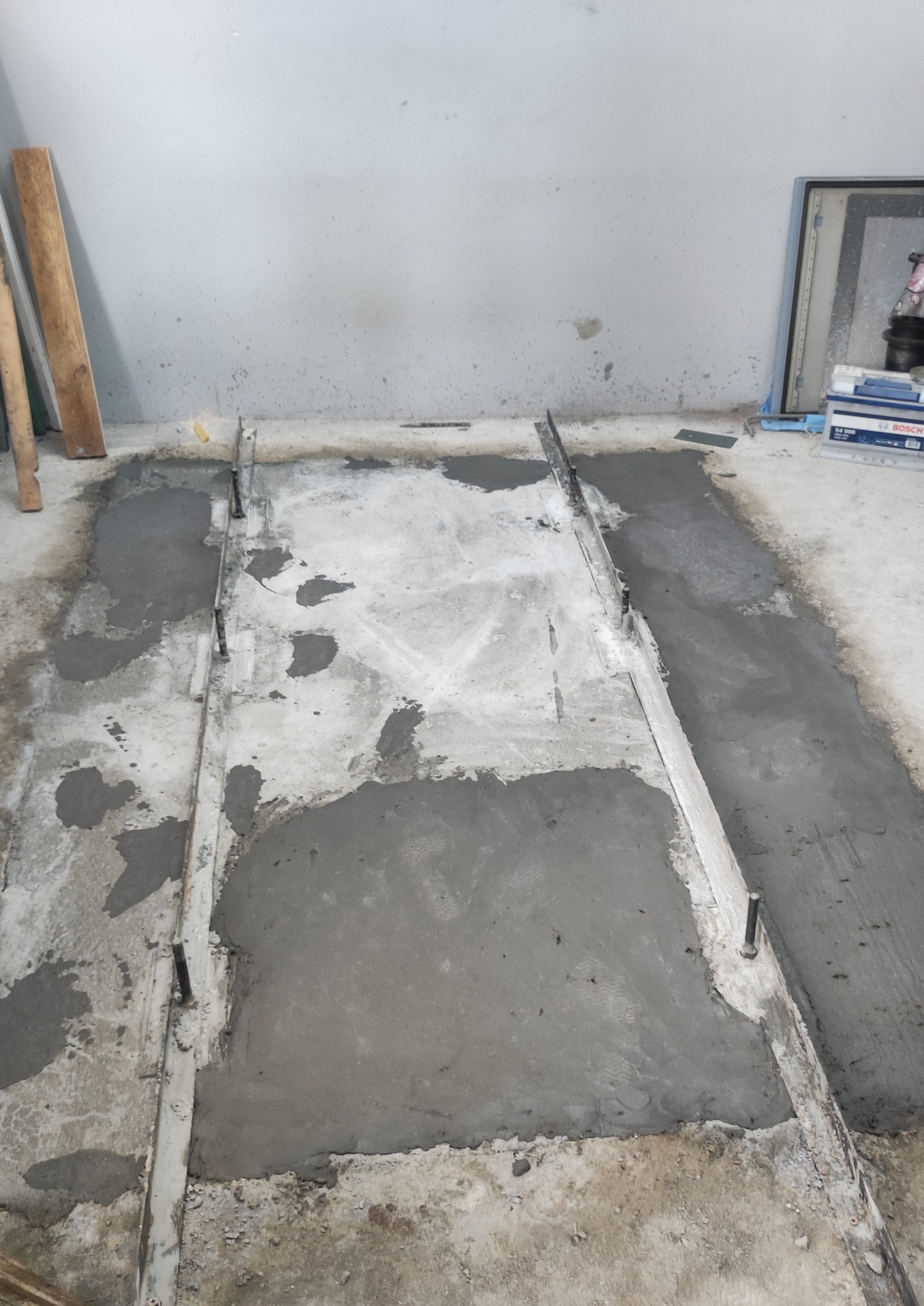

I decided to make a foundation as shown in the machine documentation.Because my foundation was too bad…
20 cm of gravel and 60 cm of concrete.

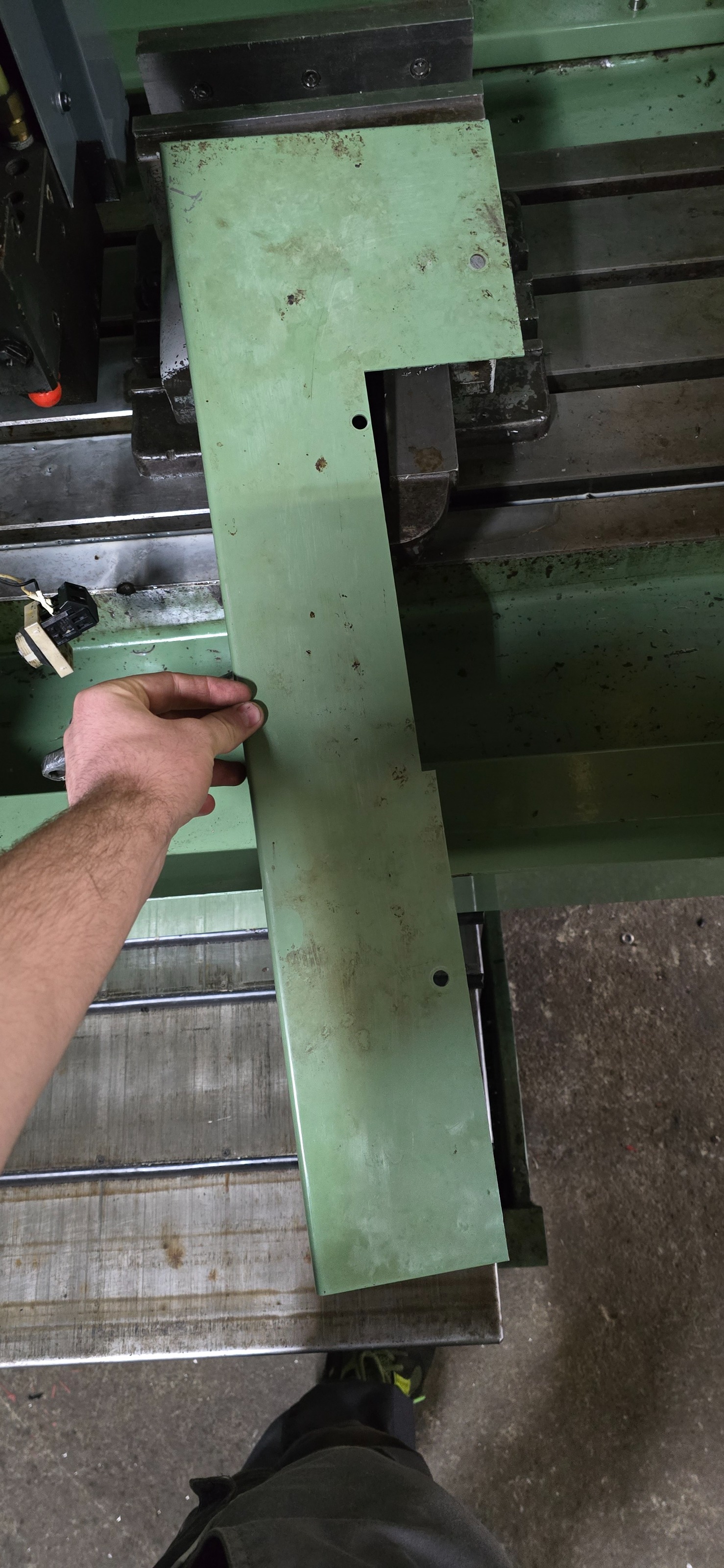

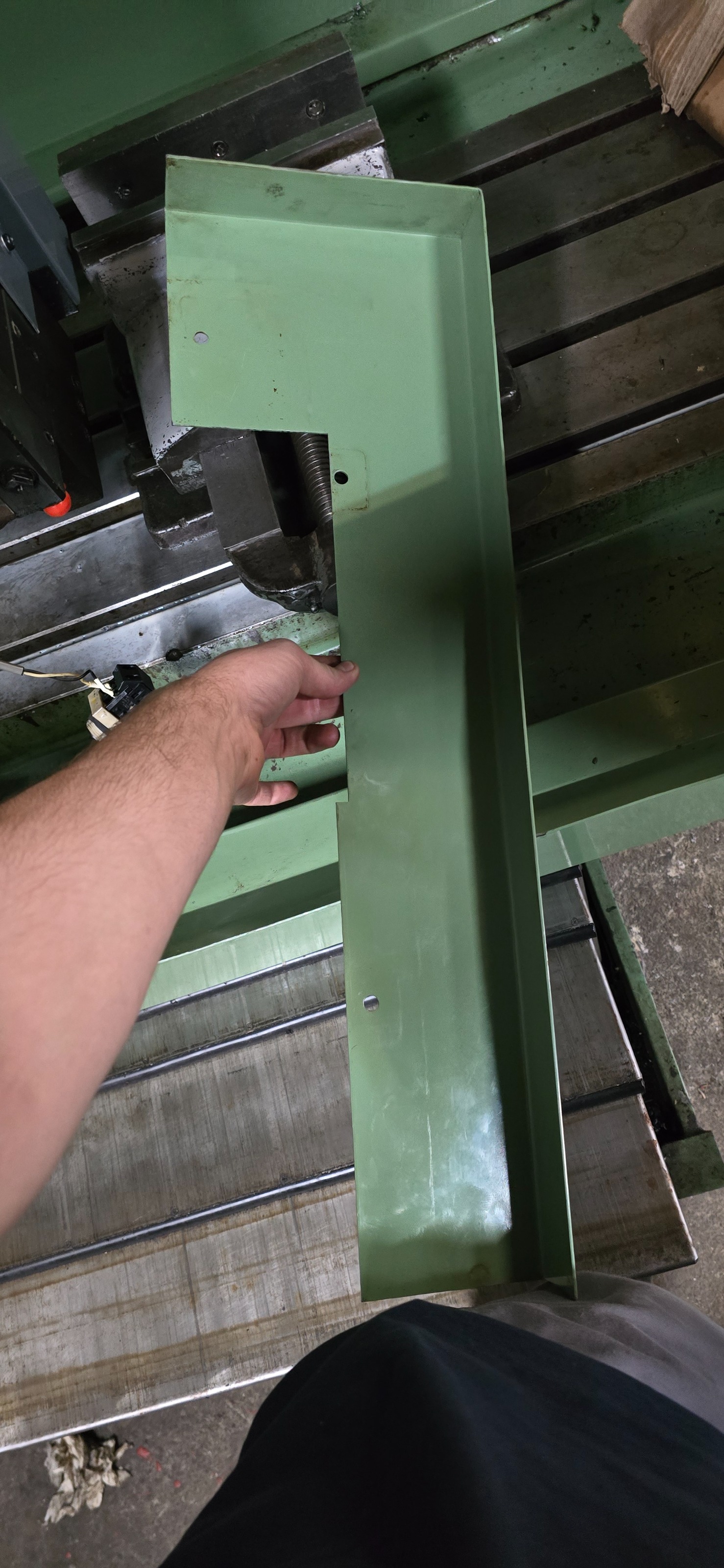

This might sound stupid. Ive just done a similar job as you although I didn't bother with any mechanical parts as my jr has been used in a school and is still like new, only problem I have is I have one pice of metal I can't find out where goes.
Do you have any idea where this goes.
Thanks in advance for any help!
