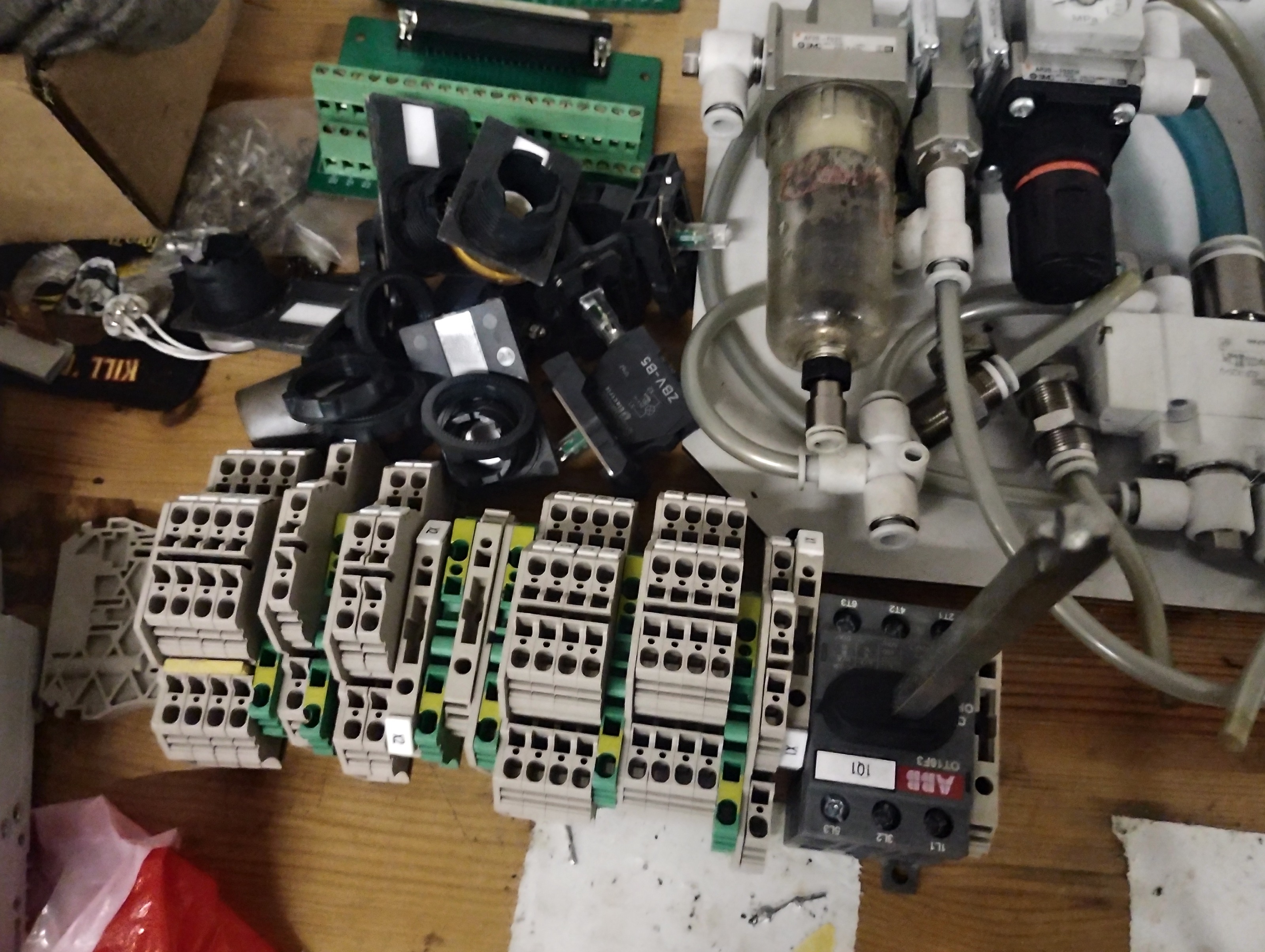

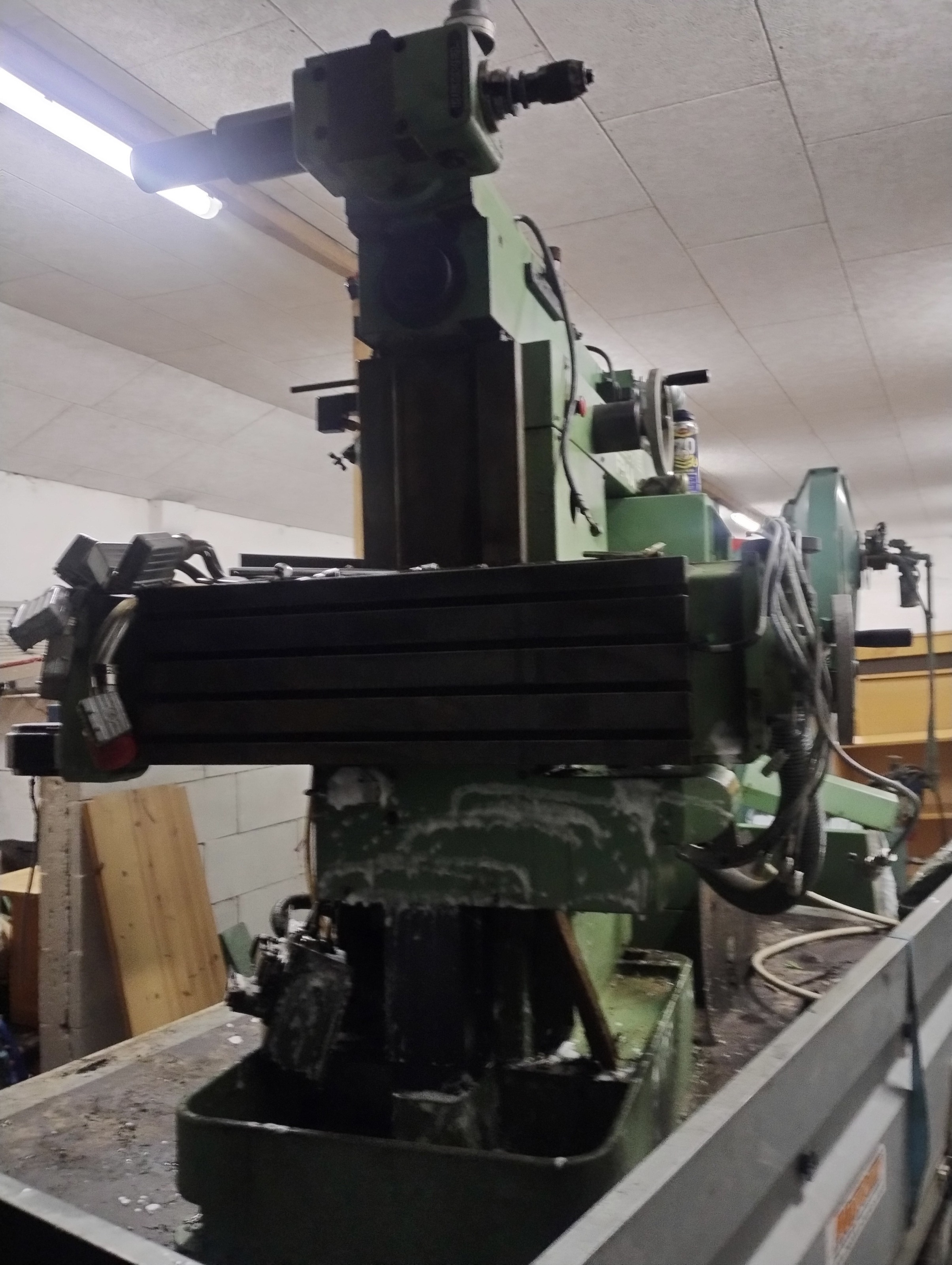

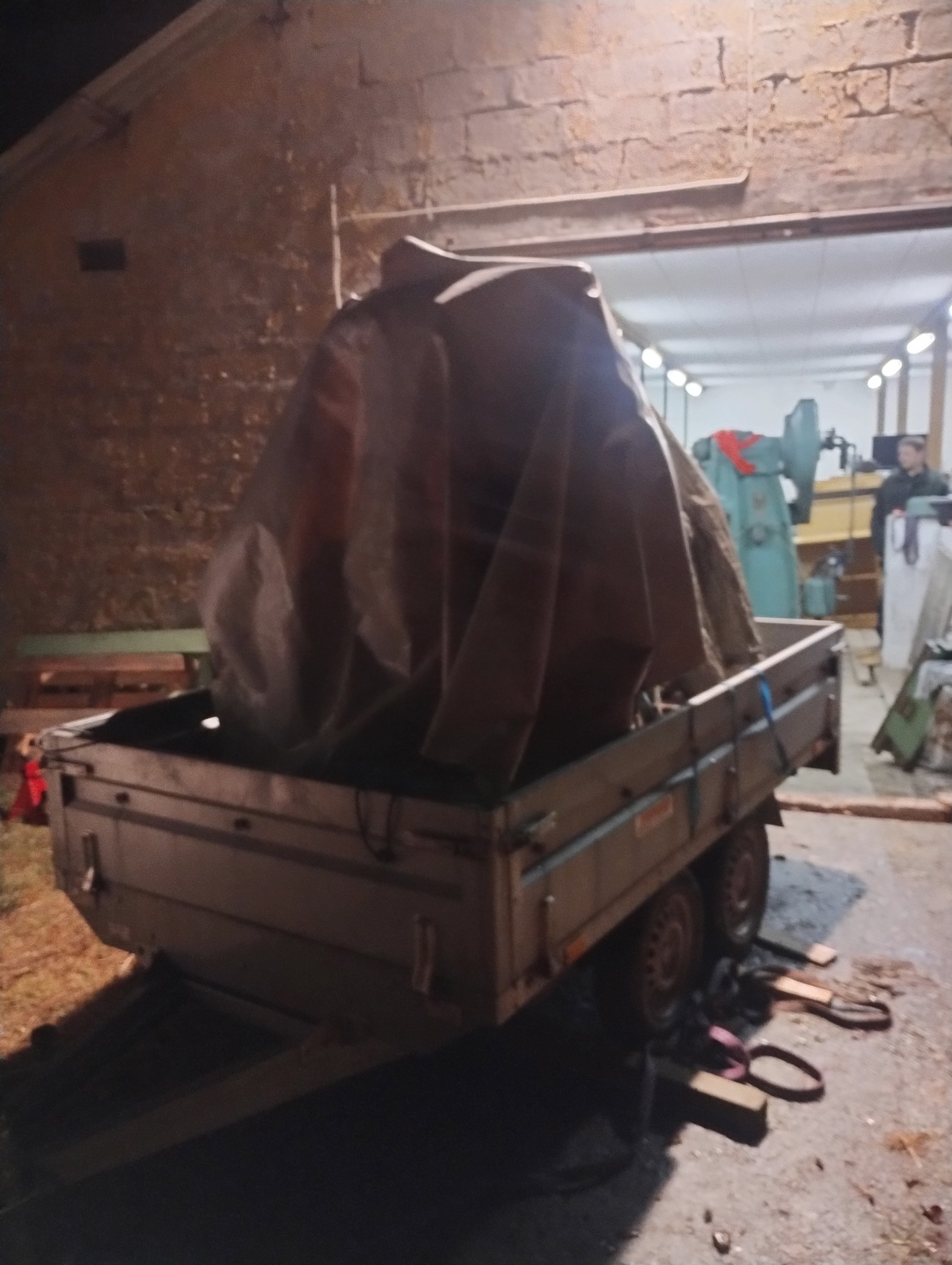

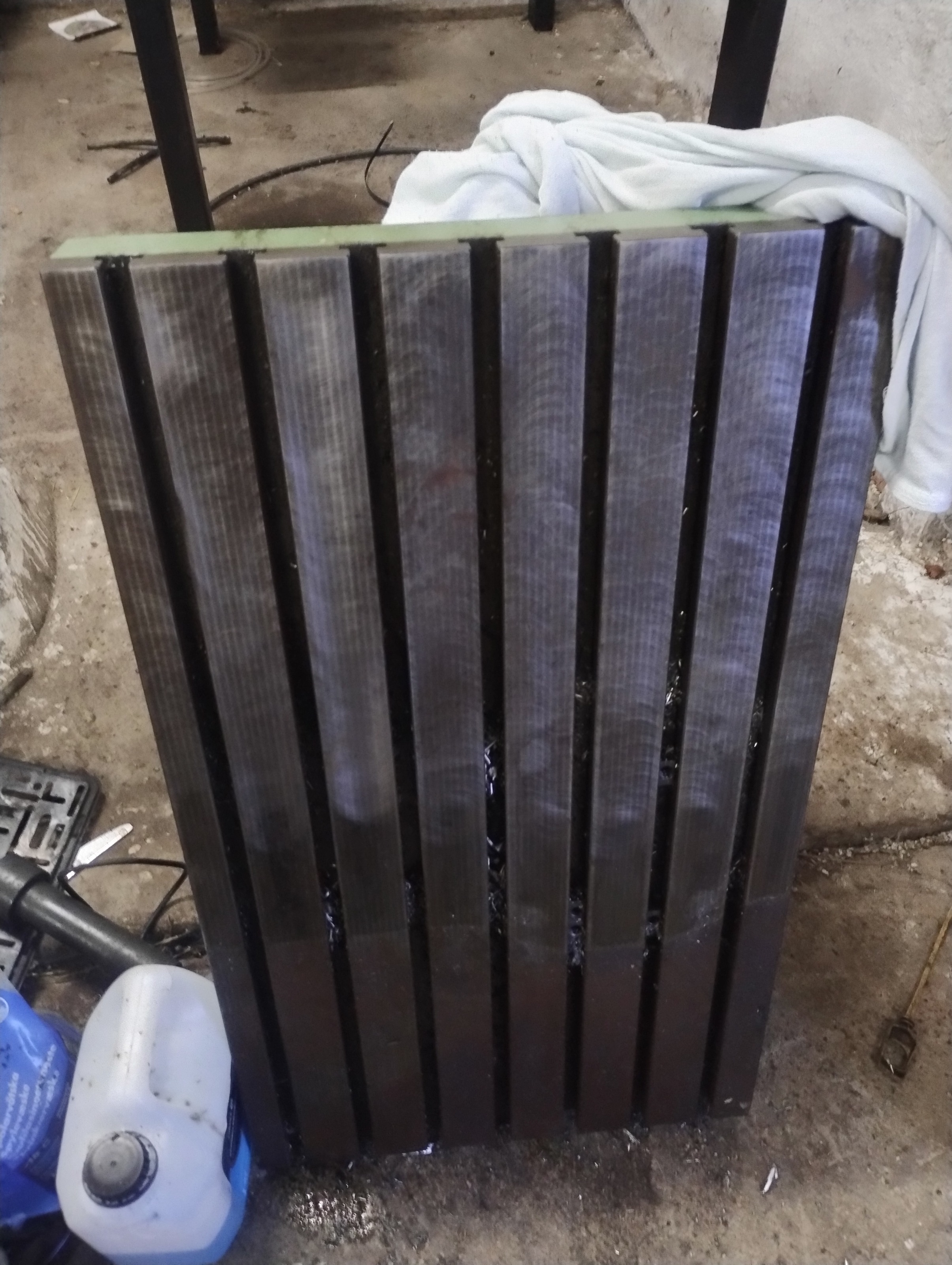

I just bought a used mill for 330 Euro and now the fun begins
I have planned to do a full EtherCAT Servo build, with the Bechhoff moduls or similar.
More will be posted soon when the unit is placed on the floor and cleaned. I have already stripped some of the guards, panels away to get more room for cleaning. Also the control unit and the "electrical cabinet" are removed.
Best regards and Happy New Year From Denmark.

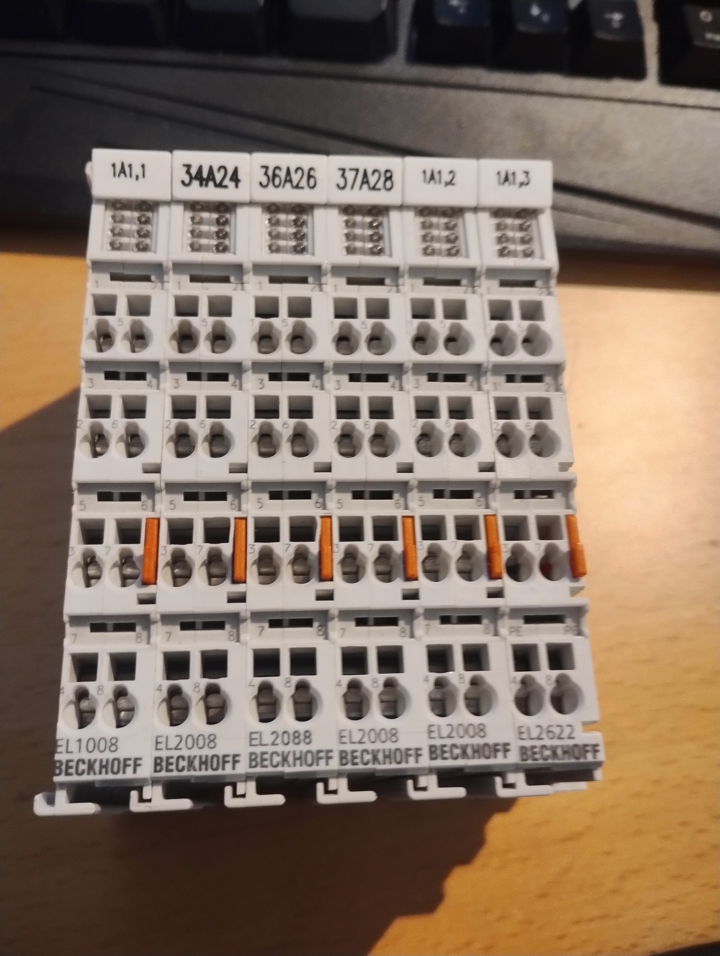

05 Jan 2025 00:54 #318137
by Beovoxo
Replied by Beovoxo on topic Deckel FP4A Retrofit
The following user(s) said Thank You: tommylight, besriworld

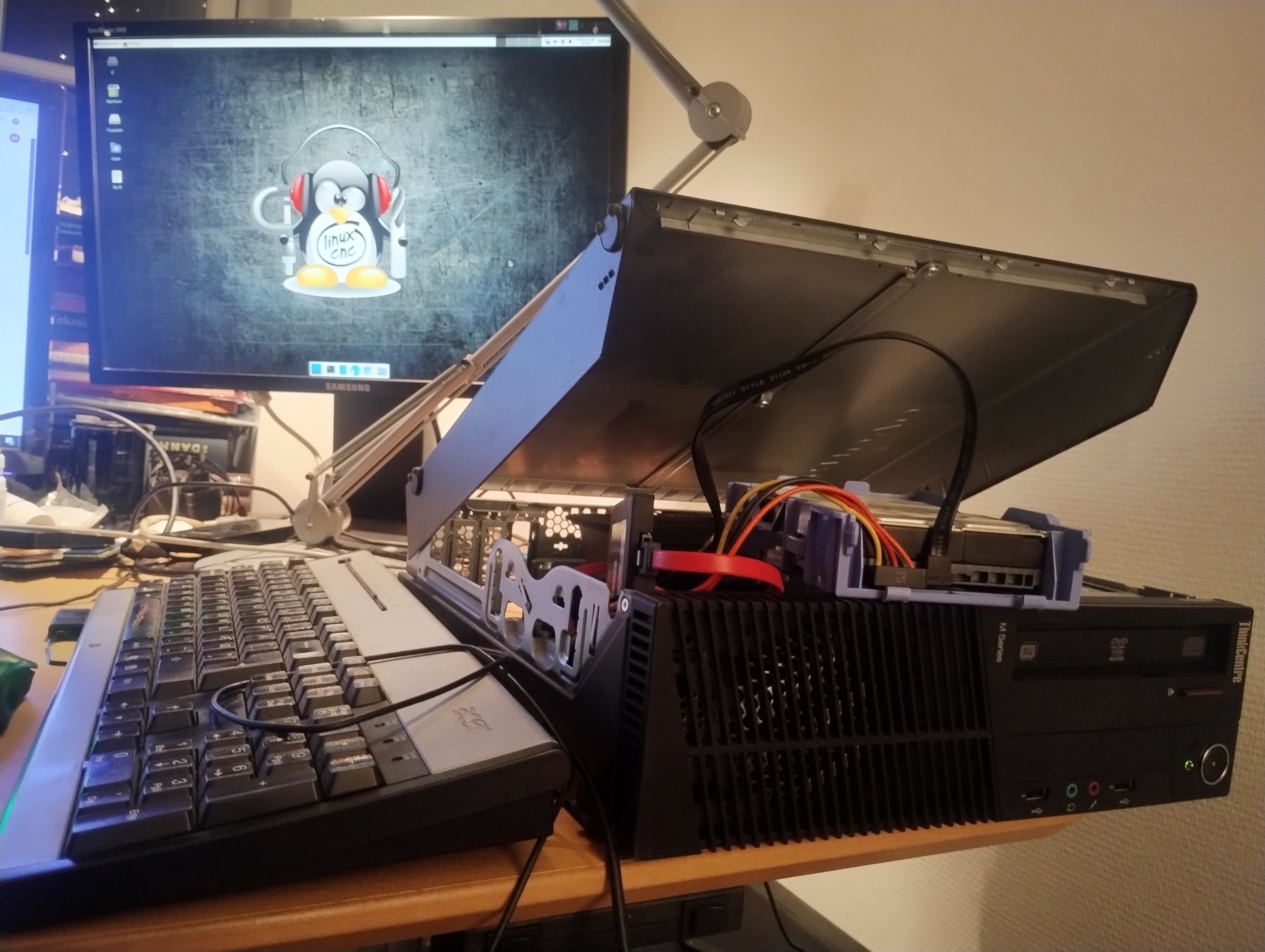

08 Jan 2025 13:22 #318402
by Beovoxo

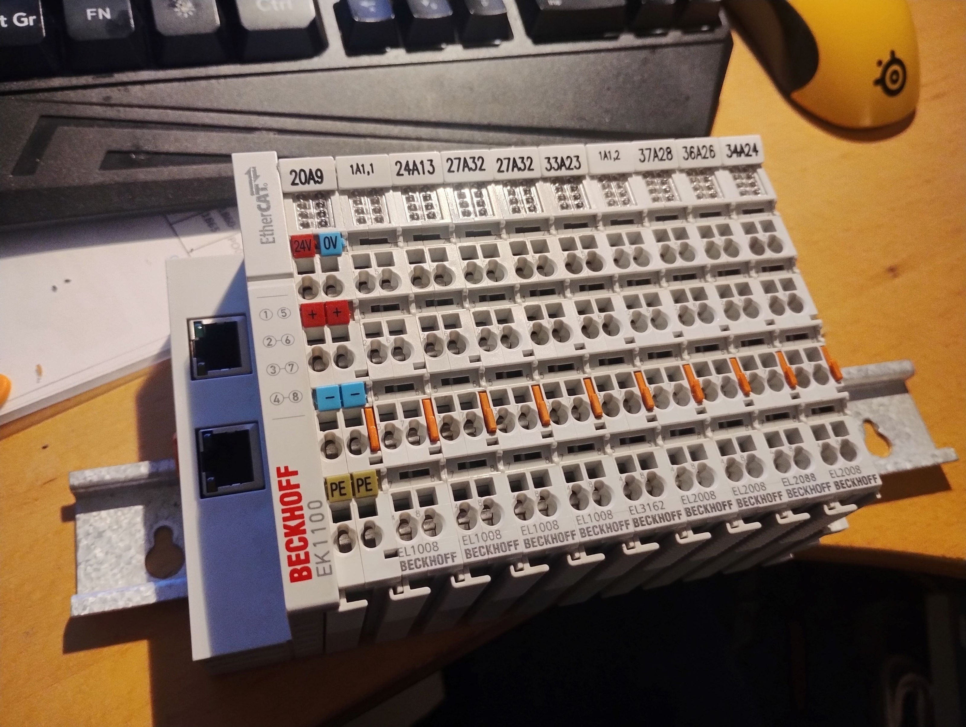

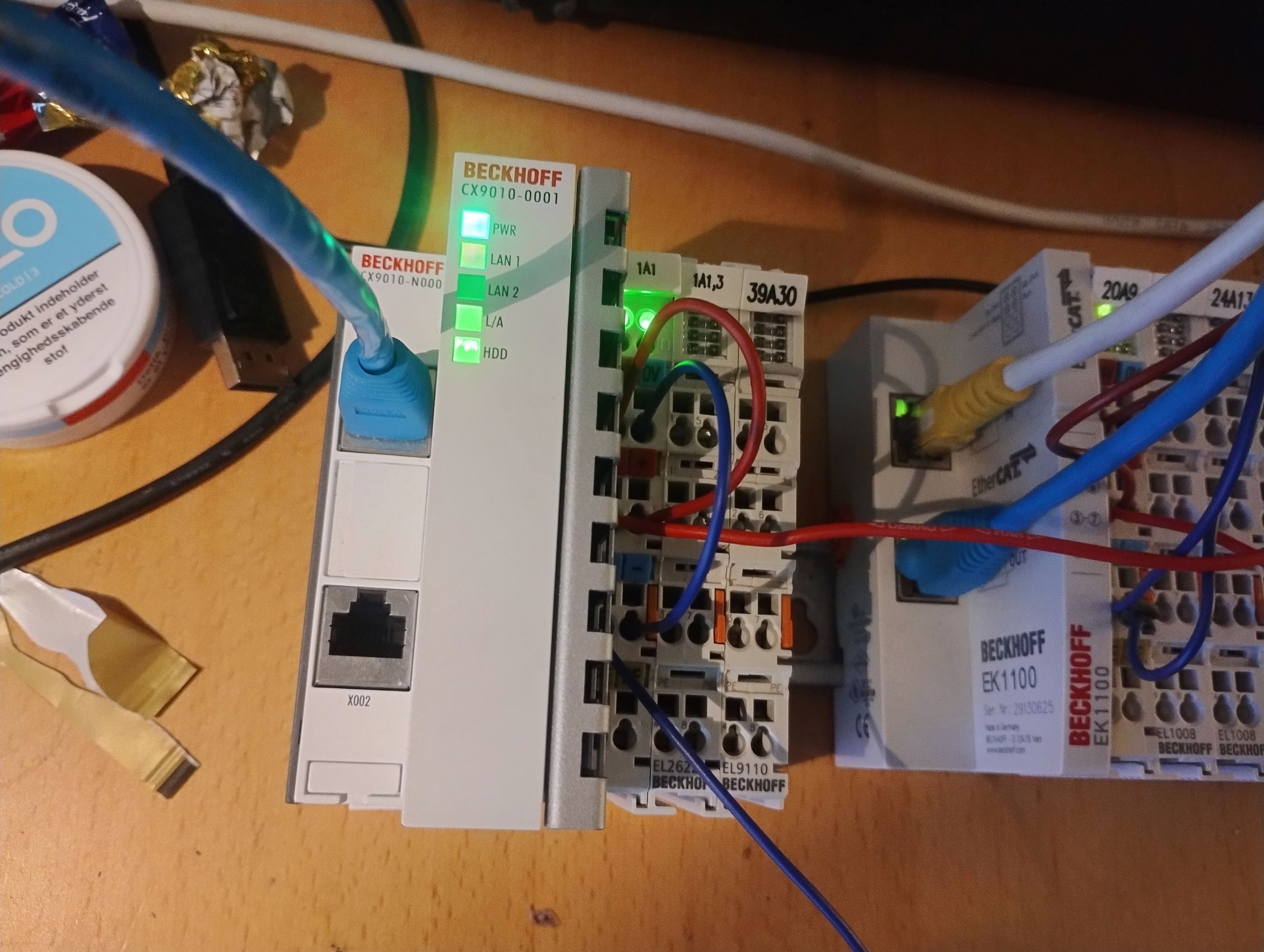

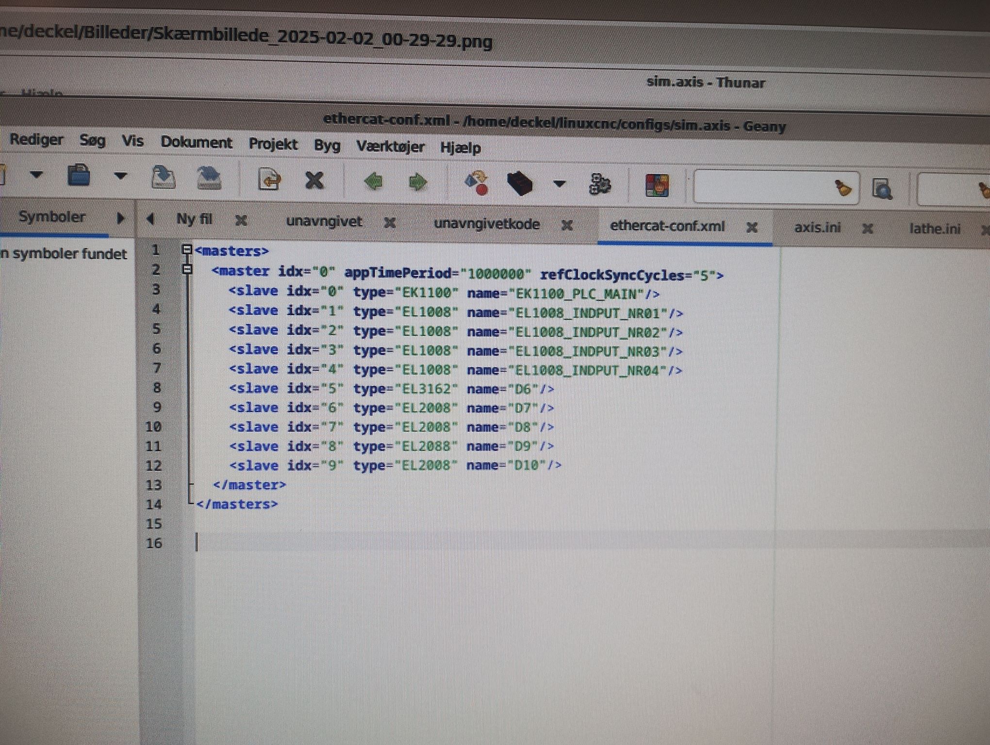

02 Feb 2025 01:37 - 02 Feb 2025 01:45 #320379
by Beovoxo

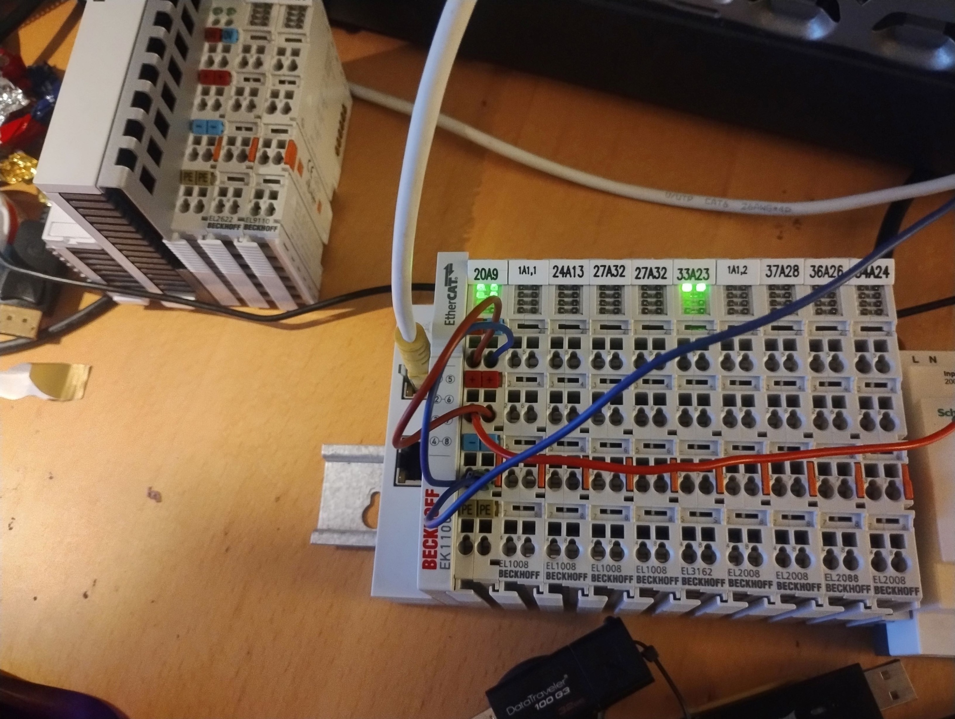

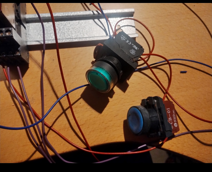

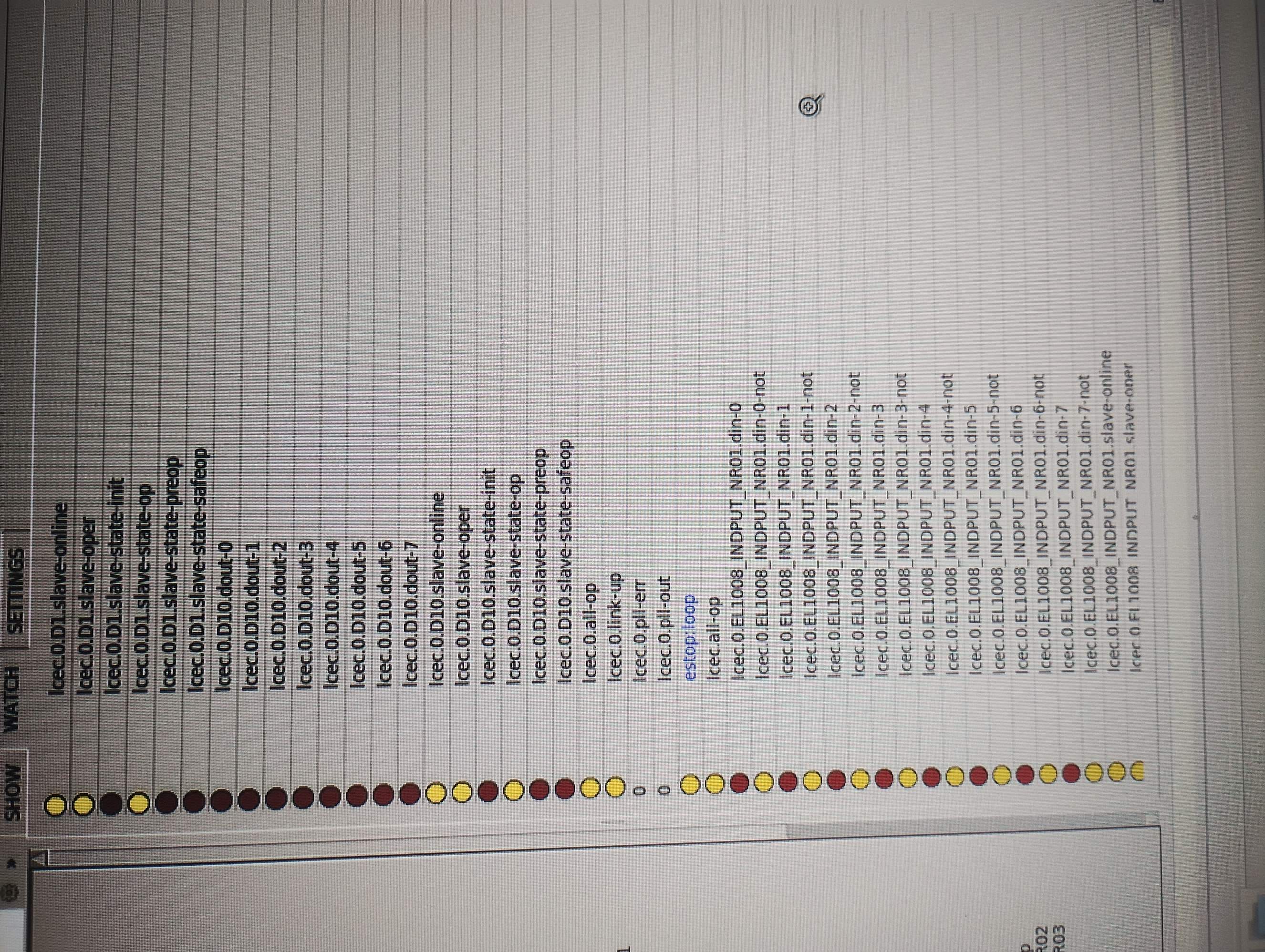

Today I finally got the Beckhoff Ek1100 running under linuxcnc with ethercat
. It was a steep sloop to go on, but I finally got it . I had a lot of troubles with broken links and such under installation, so it ended up with like 15 reinstalls. and then, like a grenade hit the new image was uploaded and most of the things worked a lot smoother:)btw if any out there knows how to send commands from the ek1100 to the cx unit plz write some info:) or else it will just be controlled via outputs.. if its a lost course i am planning to run the cx unit as a normal plc instead. it will run transmission/gears and spindle, lights and such.
Have a nice day all
Have a nice day all
Last edit: 02 Feb 2025 01:45 by Beovoxo.

02 Feb 2025 12:21 #320407
Replied by rodw on topic Deckel FP4A Retrofit
The cx9010 is normally set up an Ethercat master. Linuxcnc uses a different Ethercat master (and a whole lot more) too.
It would only be useful if you could install Debian and Linuxcnc on it, it could be used but I suspect that will not be possible due to lack of resources

02 Feb 2025 21:57 #320454
by Beovoxo
Ok thx
then i will just run it as a "normal" plc with I/O outputs from the ek1100 to control the transmission
thx
