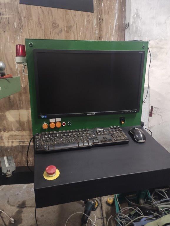

02 Apr 2025 17:28 #325556 by Beovoxo

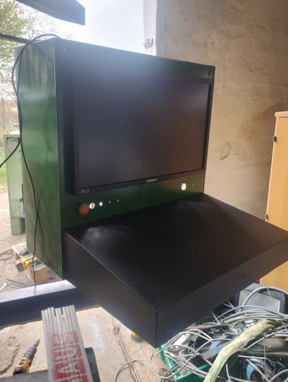

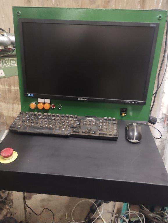

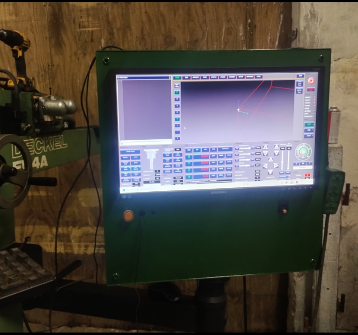

Replied by Beovoxo on topic Deckel FP4A Retrofit

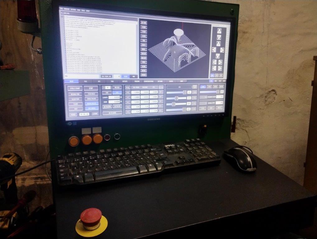

The big screen turned out really nice :) so next step is to make the keyboard shelf ready and alot of push bottoms:)

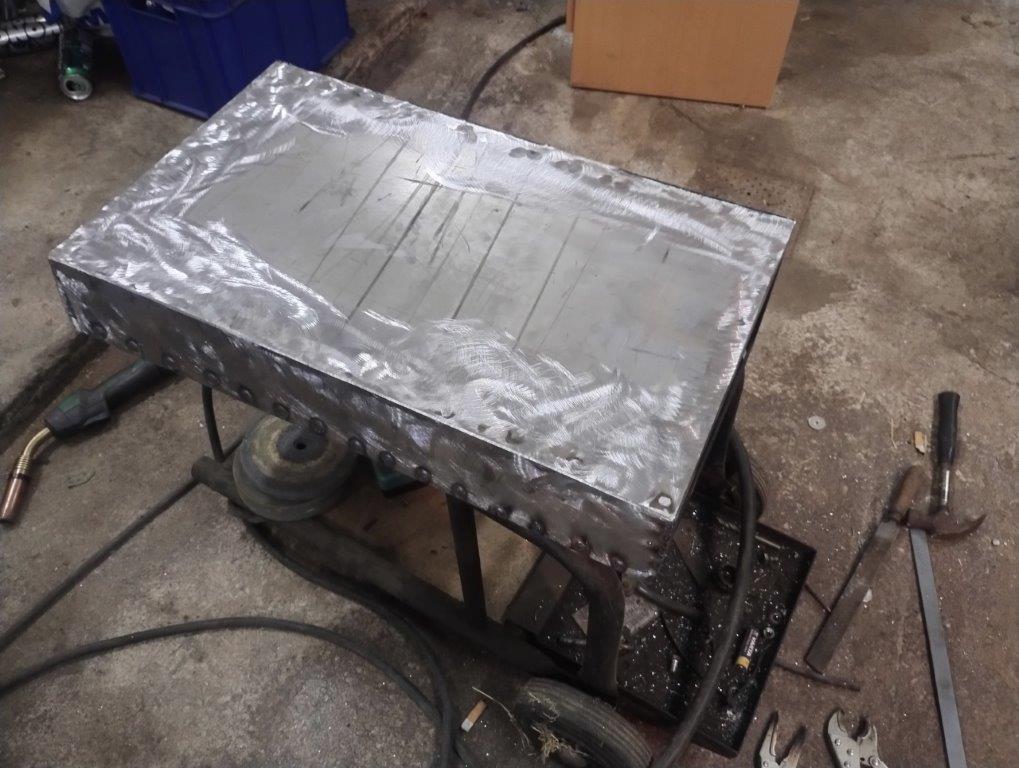

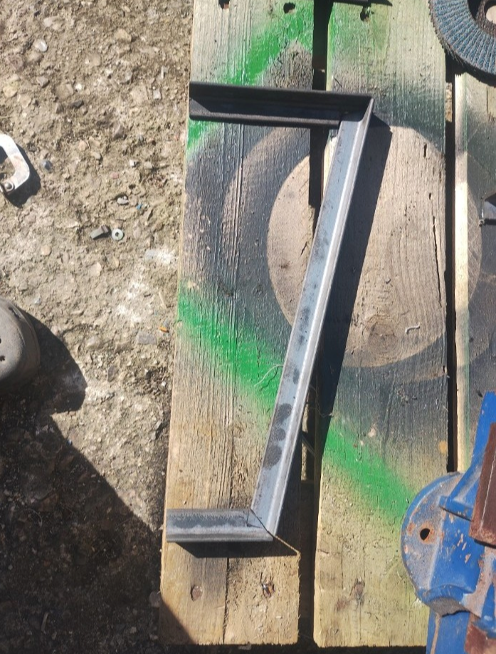

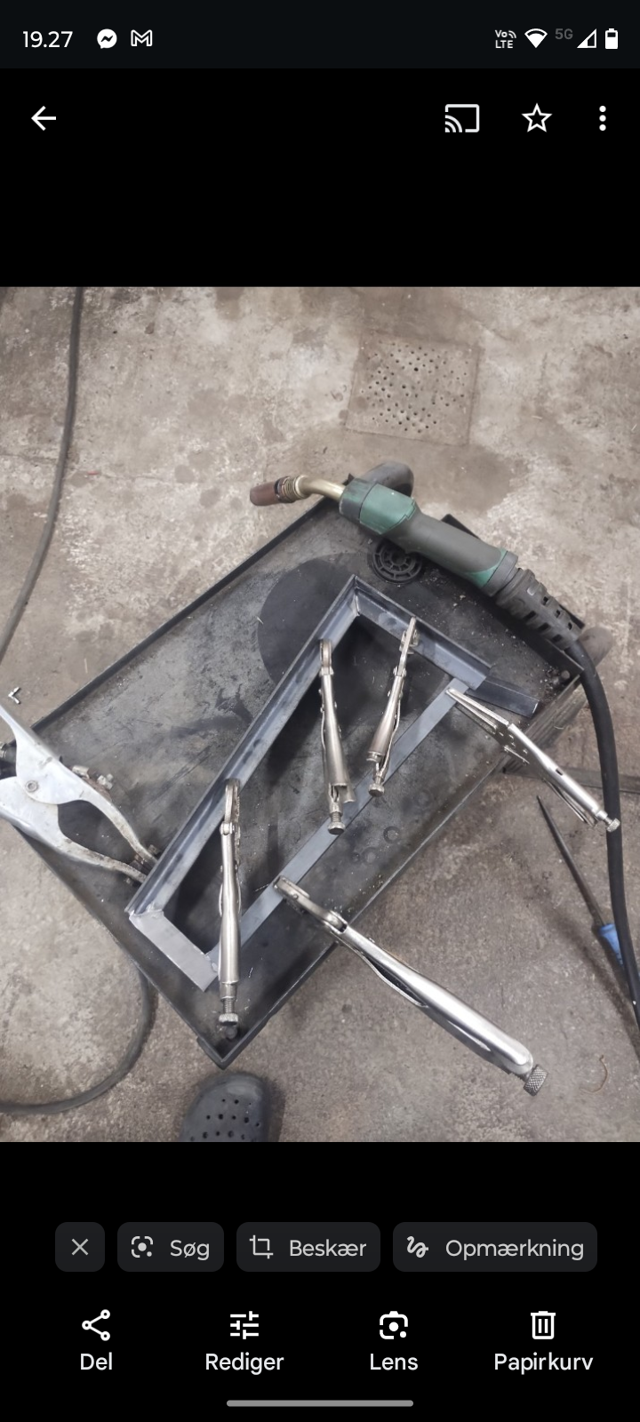

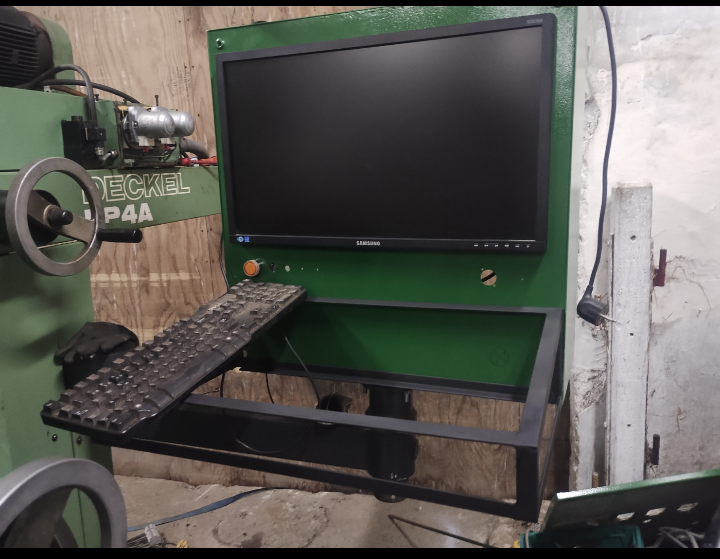

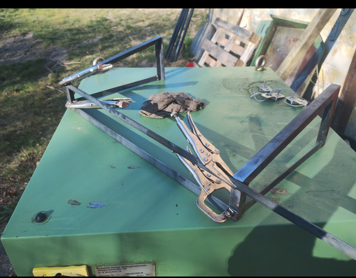

03 Apr 2025 12:30 #325632 by Beovoxo

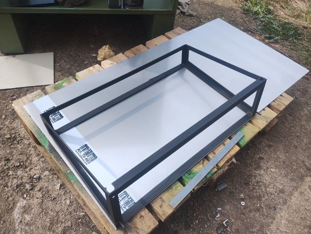

Keyboard frame almost ready for surface plates.

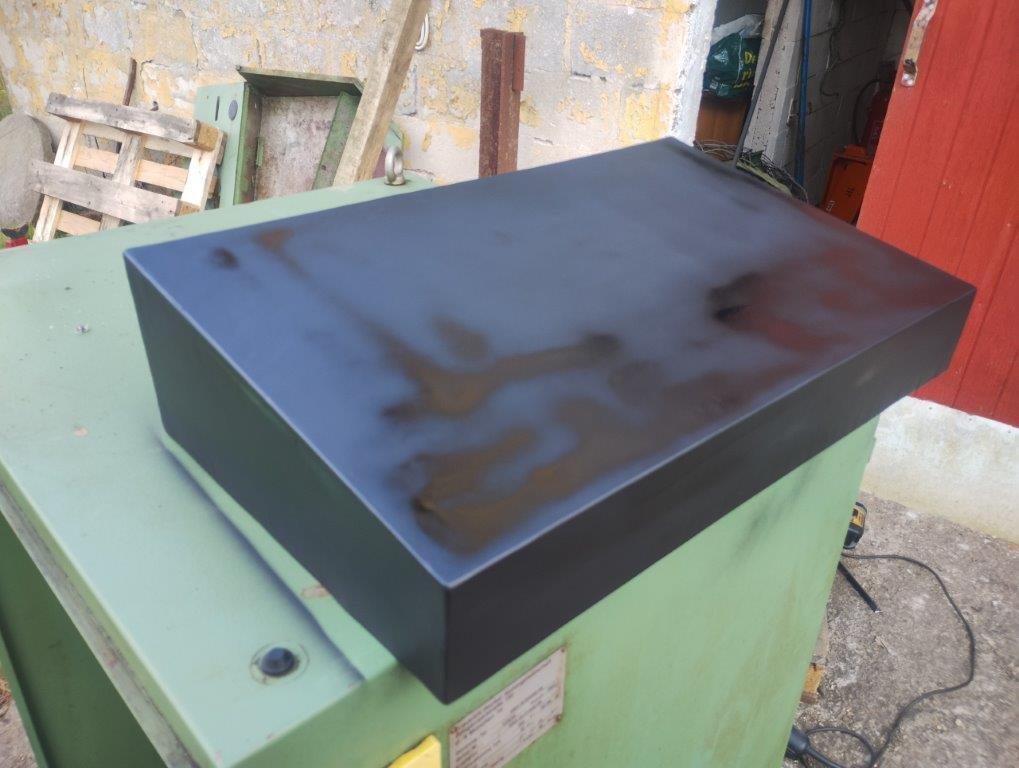

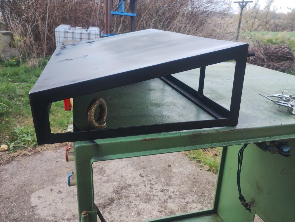

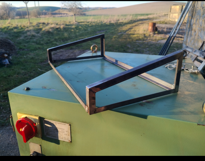

05 Apr 2025 11:50 #325768 by Beovoxo
Frame ready for a steel sheet

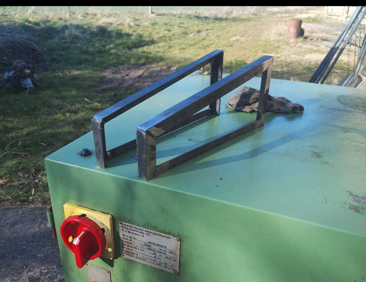

14 Apr 2025 09:31 #326283 by Beovoxo
Keyboard bracket finished with room for extra bottoms and trackpad.

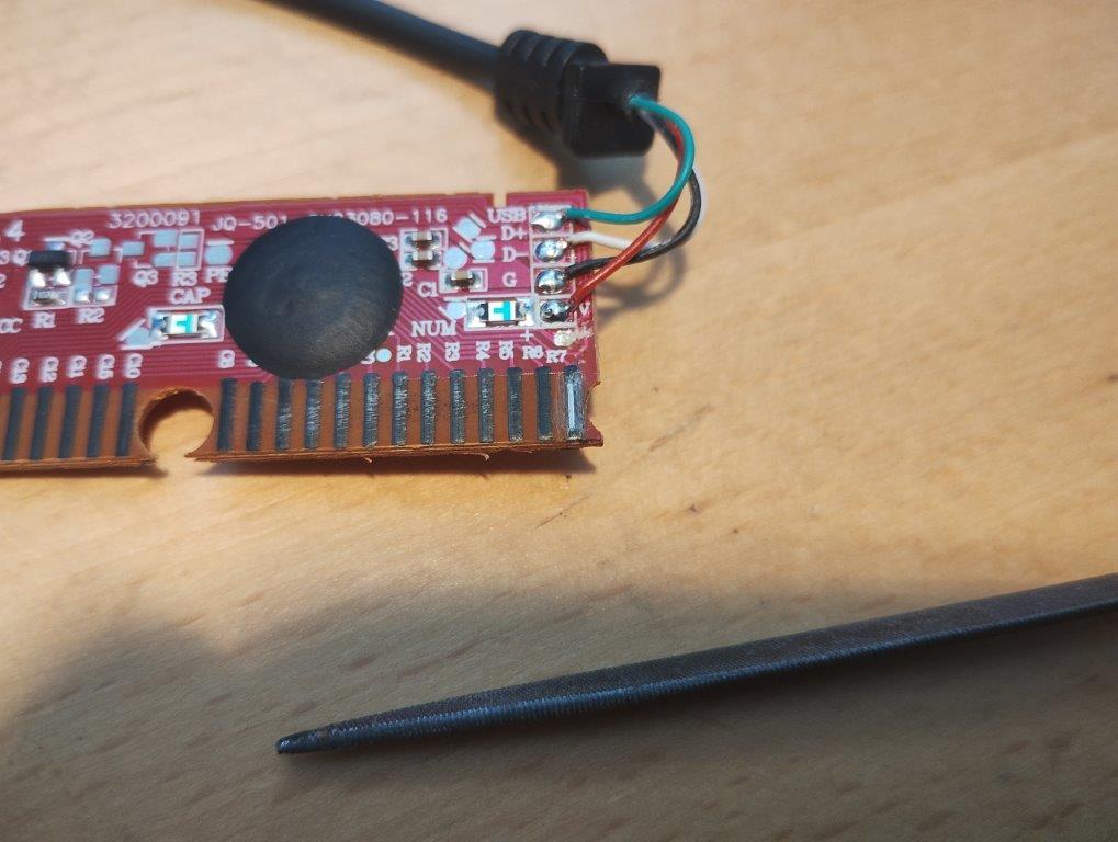

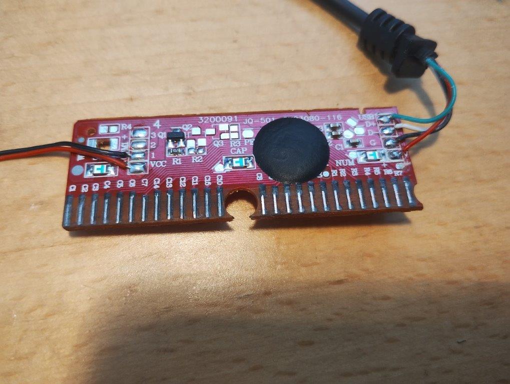

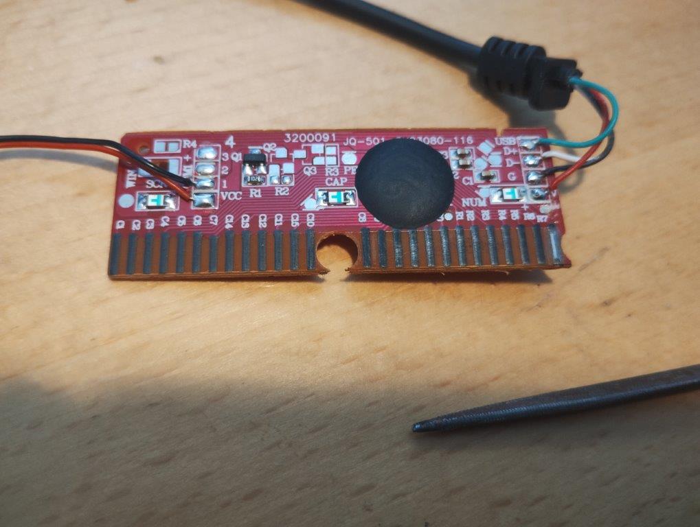

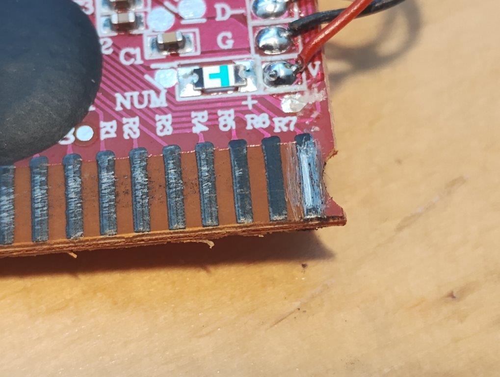

14 Apr 2025 09:36 #326284 by Beovoxo

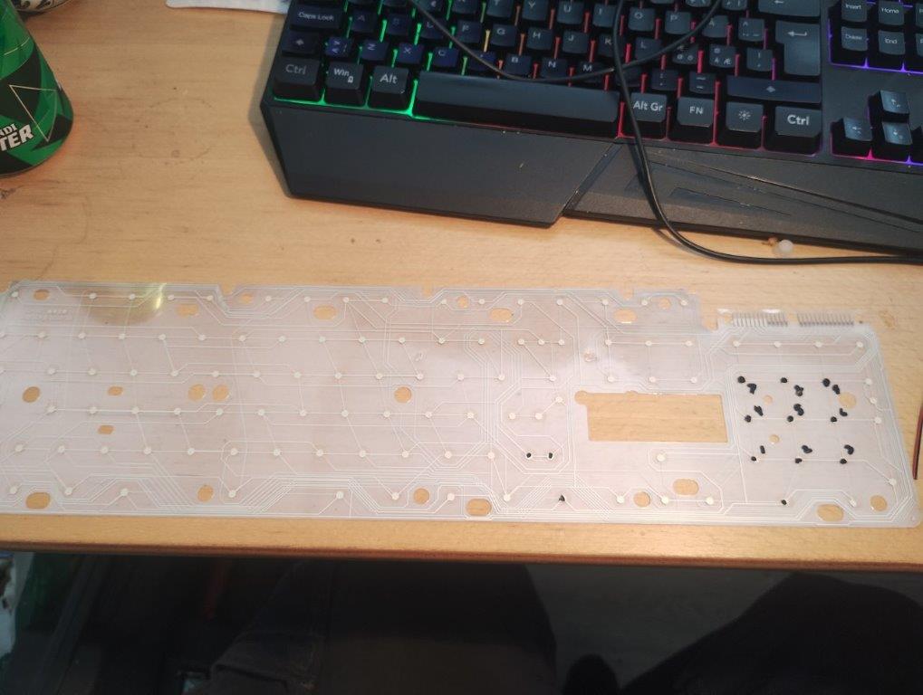

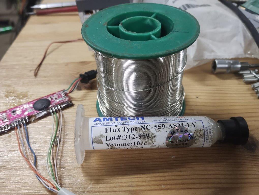

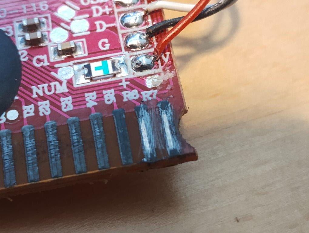

Used keyboard matrix controller for bottoms on the controller cabinet.
I disassemble a old keyboard and salvage the controller. the connection points has to be cleaned before soldering wires on it. "the black stuff" on the contact points are graphite with normal traces under.

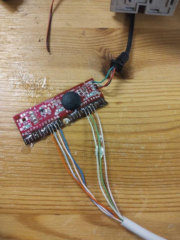

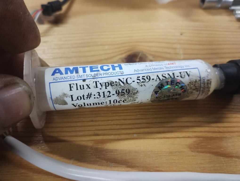

14 Apr 2025 16:38 #326318 by Beovoxo
Usb keyboard controller soldered with a RJ45 cable. I just used a lot of flux and let the soldering iron moved over all the contact points to start with. After this i pre tinned the wires and soldered them on. There is a bit of cleaning with isopropyl alcohol and sealing left, before its finished.
17 Apr 2025 07:24 - 17 Apr 2025 07:24 #326517 by Beovoxo
Control cabinet almost finished. I just need to install 20 push buttons and connect them to the usb matrix board. I will mount a new keyboard with a trackball also.

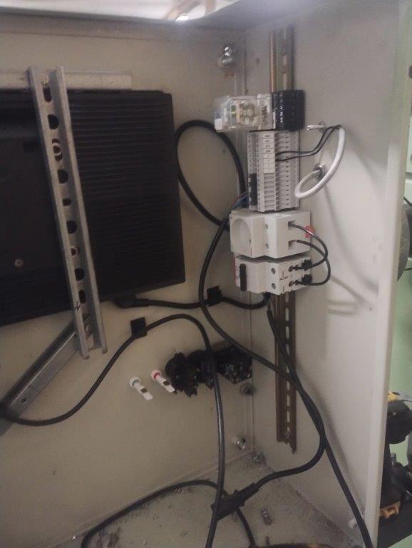

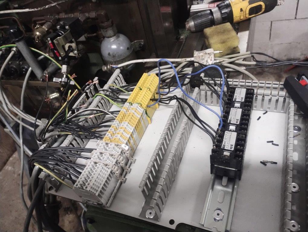

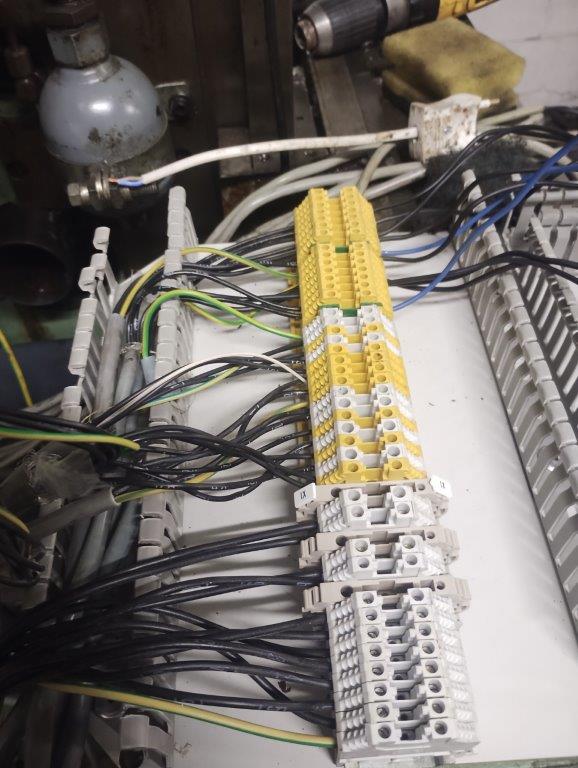

20 Apr 2025 08:44 #326763 by Beovoxo

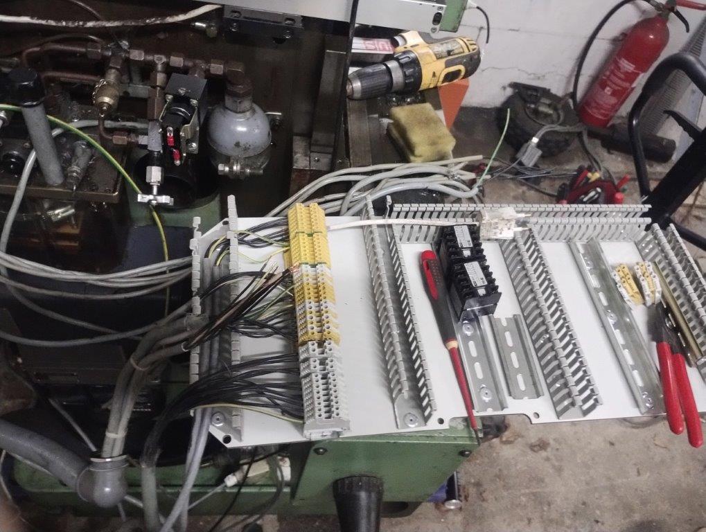

Got the lube pump, hydraulic pump, coolant pump testes and tempeary wired up. And got most of the wires from the spindle motor, transmission,  lube pump, hydraulic pump, coolant pump and the spindle brake wired to DIN terminal.
Also i made a DIN rail in the control cabinet.
I did also some test on the software.

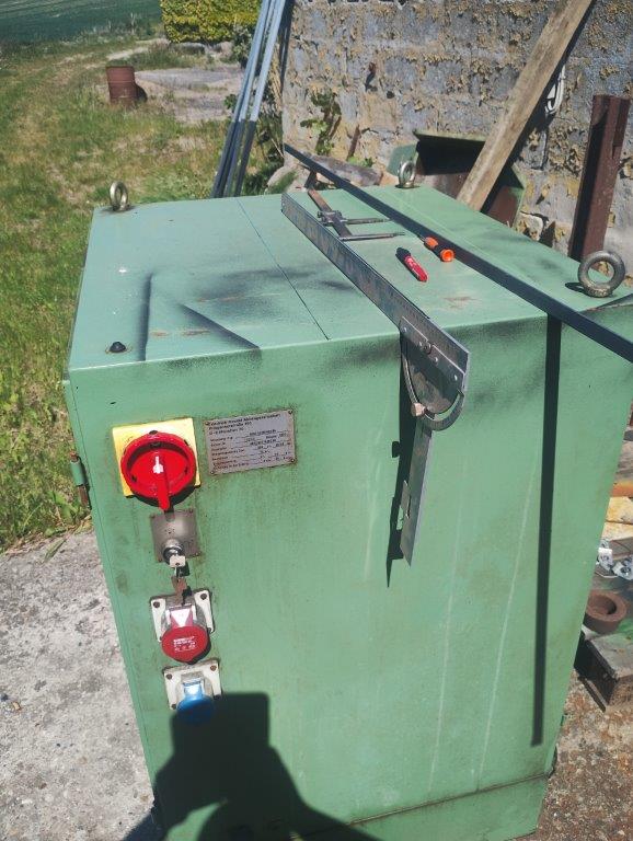

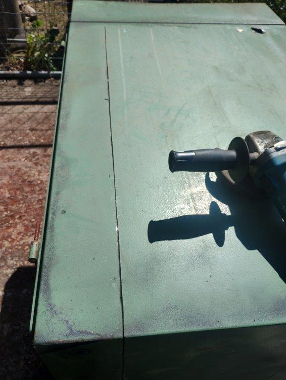

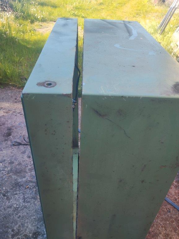

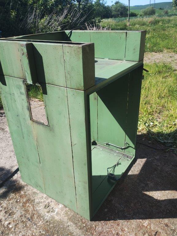

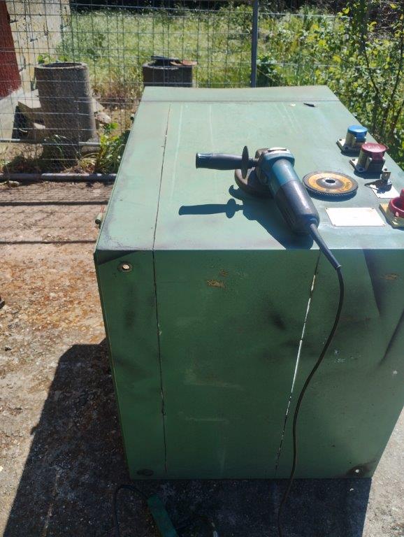

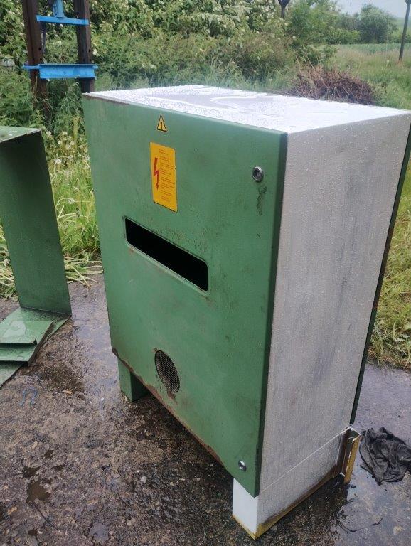

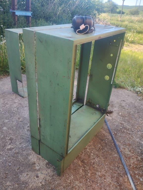

20 May 2025 10:47 #328814 by Beovoxo

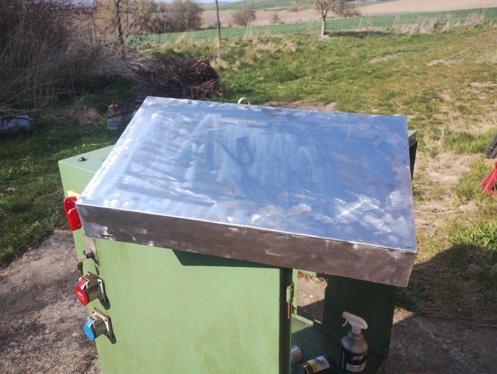

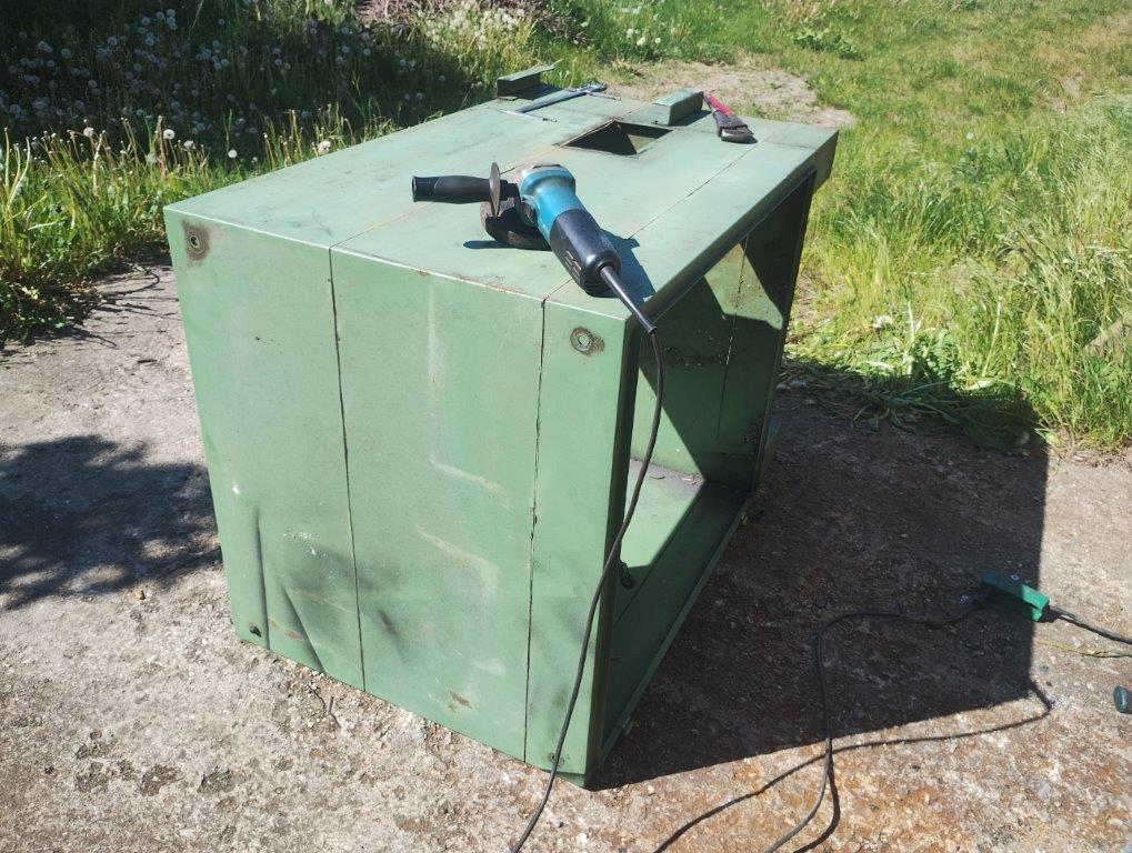

Electrical Cabinet makeover.

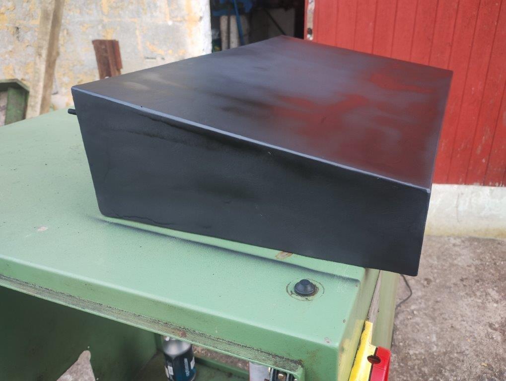

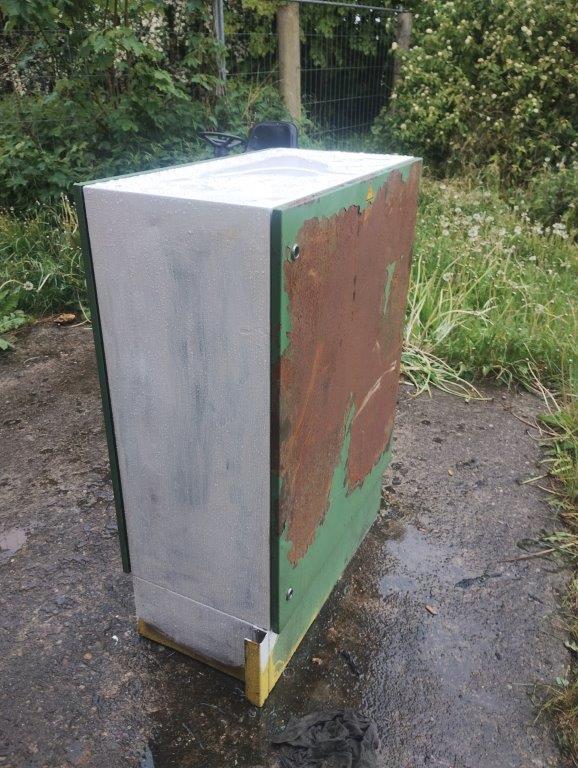

25 May 2025 04:47 - 25 May 2025 04:48 #329100 by Beovoxo
Cabinet almost ready for sand blasting and paint.
Last edit: 25 May 2025 04:48 by Beovoxo.
