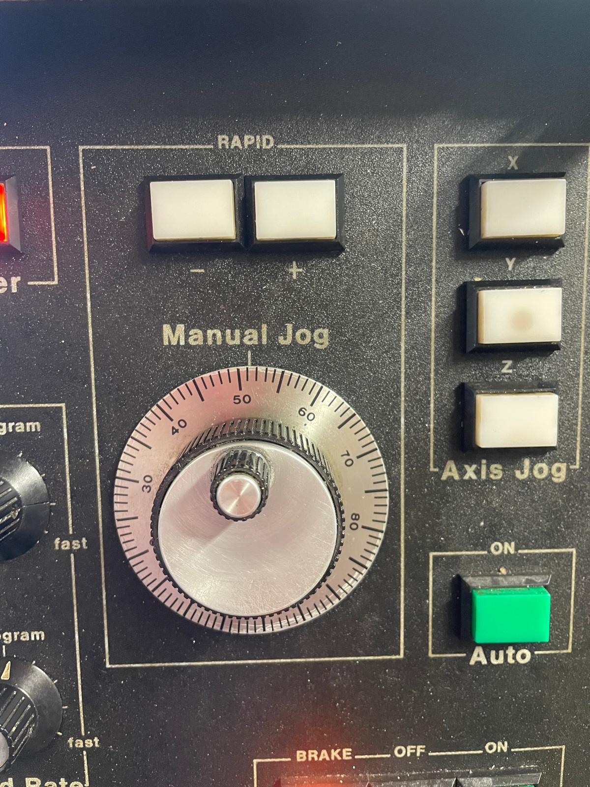

02 Mar 2025 12:39 - 02 Mar 2025 12:41 #323010
by NT4Boy
Replied by NT4Boy on topic HURCO KMB-1 Control Update
Last bit of the puzzle?
I've now got my feed override pots, kind of working, in that I can twiddle them, and the axis gui sliders update.The full scale voltage swing is 0-3.3v. Need to tune the scaling as the gui seems to think my pots only have three steps, rather than being continuously variable, a task for later.
More importantly to me is the Jog wheel.
I'd like to duplicate the original machine button functions, as they are ingrained...but, for the moment, I'm happy just to get the wheel to move an axis.
The attached hal file is nominally as published and is called in my system by the custom.hal.
In hal show, I can see counts rising and falling with the wheel being turned, and the 5 button all light up relevant pins when they are pressed.
As the buttons are momentary contact, I reasoned that if I pressed and held down say X and span the wheel, that the X axis would move, but nothing does.
As ever missing some vital part of the plot. Thanks
