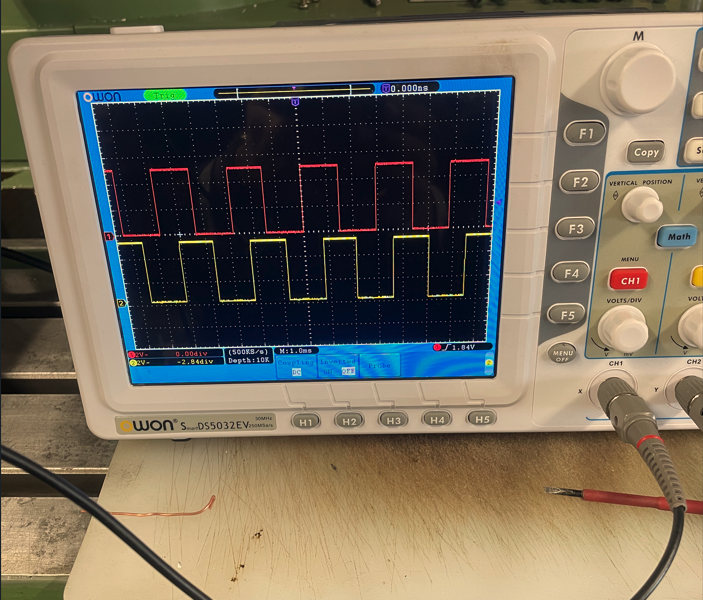

Have looked at the trace with a scope now. The 0.1uF smooths out the sawtooth, but I still have this variable voltage flicker that's not caught on the meter, so something adrift with that power supply I think.

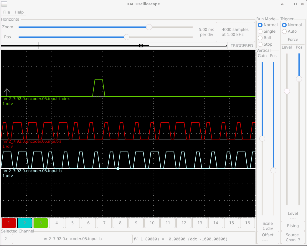

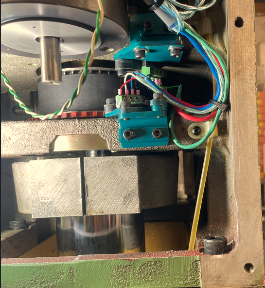

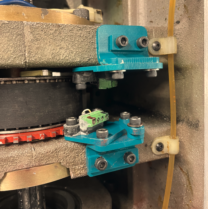

What I hope will be the last part of my adventure, is to add a spindle encoder for rigid tapping etc.Mission now achieved. 48 teeth on the lower side of the drive pully as well as an index tooth on the upper side, (complete with counterbalance weight).Have used ATS616LSG hall effects, with 10k biasing resistors which produce at the 7i77 encoder 05 inputs, good clean 5volt signals.I have yet to get properly to grips with the hal side of things, but at first sight, the hal scope doesn’t look right.

I think this is a raspberry PI issue as there is no fast sample rate option in the halscope.
Hopefully won't affect what I am doing, other than spoil my pictures.
