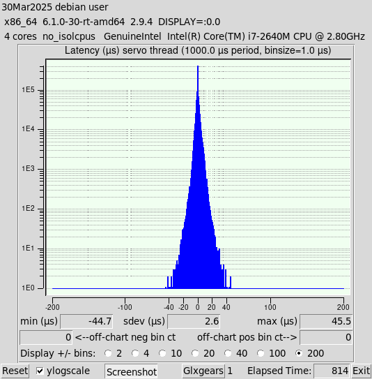

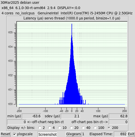

- mclien
- Posts: 28
30 Mar 2025 13:50 #325325
by mclien
Replied by mclien on topic How to build a CNC Router?
Will do the tests later, here is what I have available:
TP x200 tablet (the one which turns the screen 180°
TP T43
TP T420s
ThinkCentre M625q
One other thought was perhaps to get one of those used Getac outdoor Notebooks (but that was mainly because of the dust and water protection features)
TP T43
TP T420s
ThinkCentre M625q
- mclien
- Posts: 28
30 Mar 2025 18:24 #325339
by mclien
OK, T43 is i686
screenshot from latency attached for the 2 others.
I did run glxgears and a youtube video. The max. µs Value was half until I resized the glxgears window.
Well there is my favored refurbished dealer, offering T470 with touchscreen and 8GB RAM for 137,- EUR right now. might be the best idea..

30 Mar 2025 21:00 #325346
Replied by tommylight on topic How to build a CNC Router?
Looking really good so far, although without actually testing with Mesa attached is much safer for deciding, but it is a go for sure from those tests.
I had several T40/T41/T42/T43, they all worked fine with Ubuntu 10.04 and LinuxCNC 2.5/2.7 using parallel port.
I had Lenovo T420S it was not usable, now it seems with new kernels it is quite good.
I had Lenovo X220 it was unusable, now it seems with new kernel it is quite good.
I have X240 in use on a production machine it works fine with Mesa
I have T470 with touchscreen was used on production machine for over a year or two, works fine with Mesa
And so do X1 Yoga and Yoga 370.
There is a topic on laptops, so if it ends up working with Mesa you should add those there.
Thank you.
