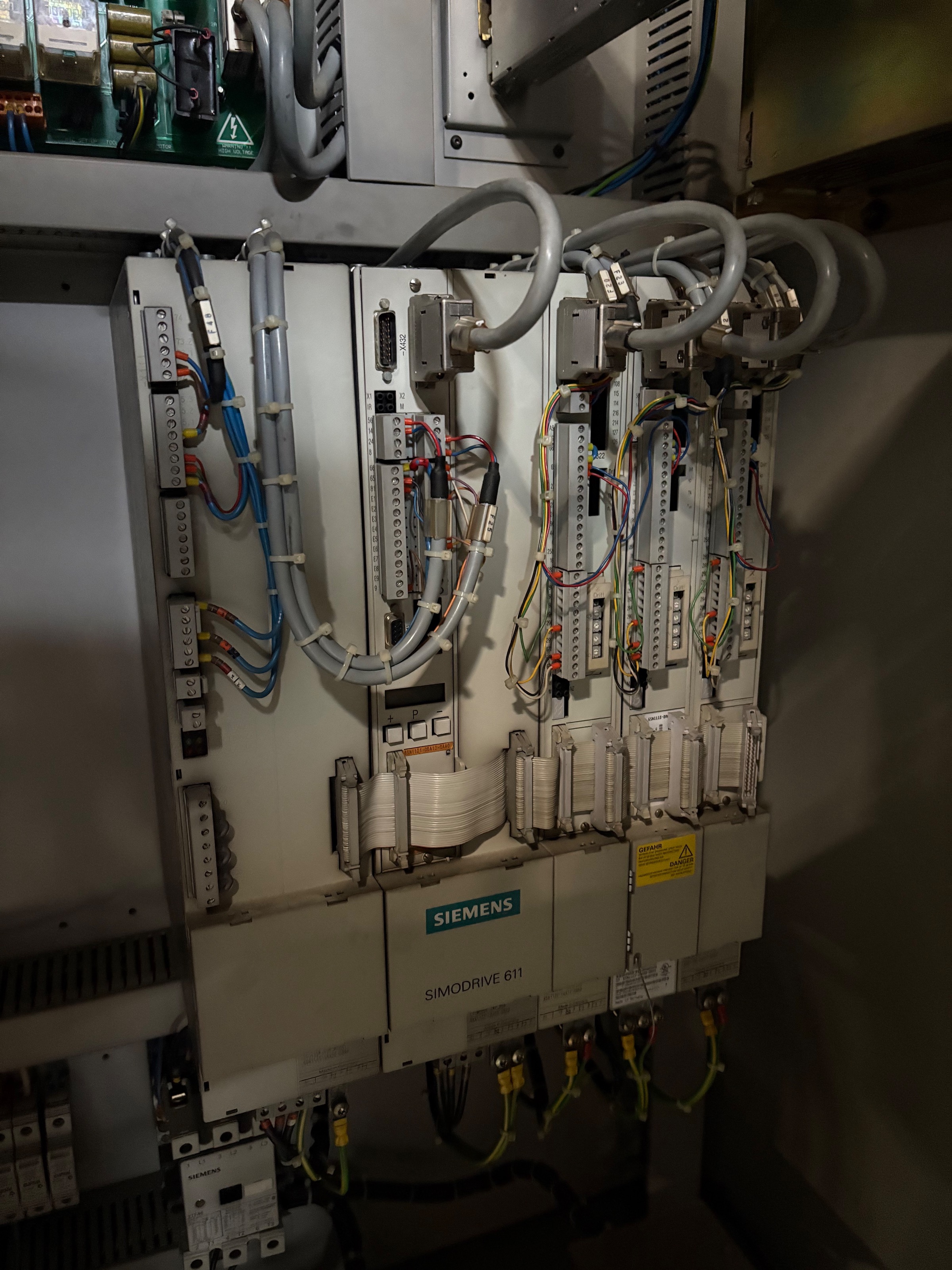

I've owned a Bridgeport VMC760 for the last 4 years. It's been used in my prototyping/fabrication shop here in Australia. The Heidenhain 370 control and Siemens drives have served me well in this time, up until yesterday, when one of the servo drives went bang.

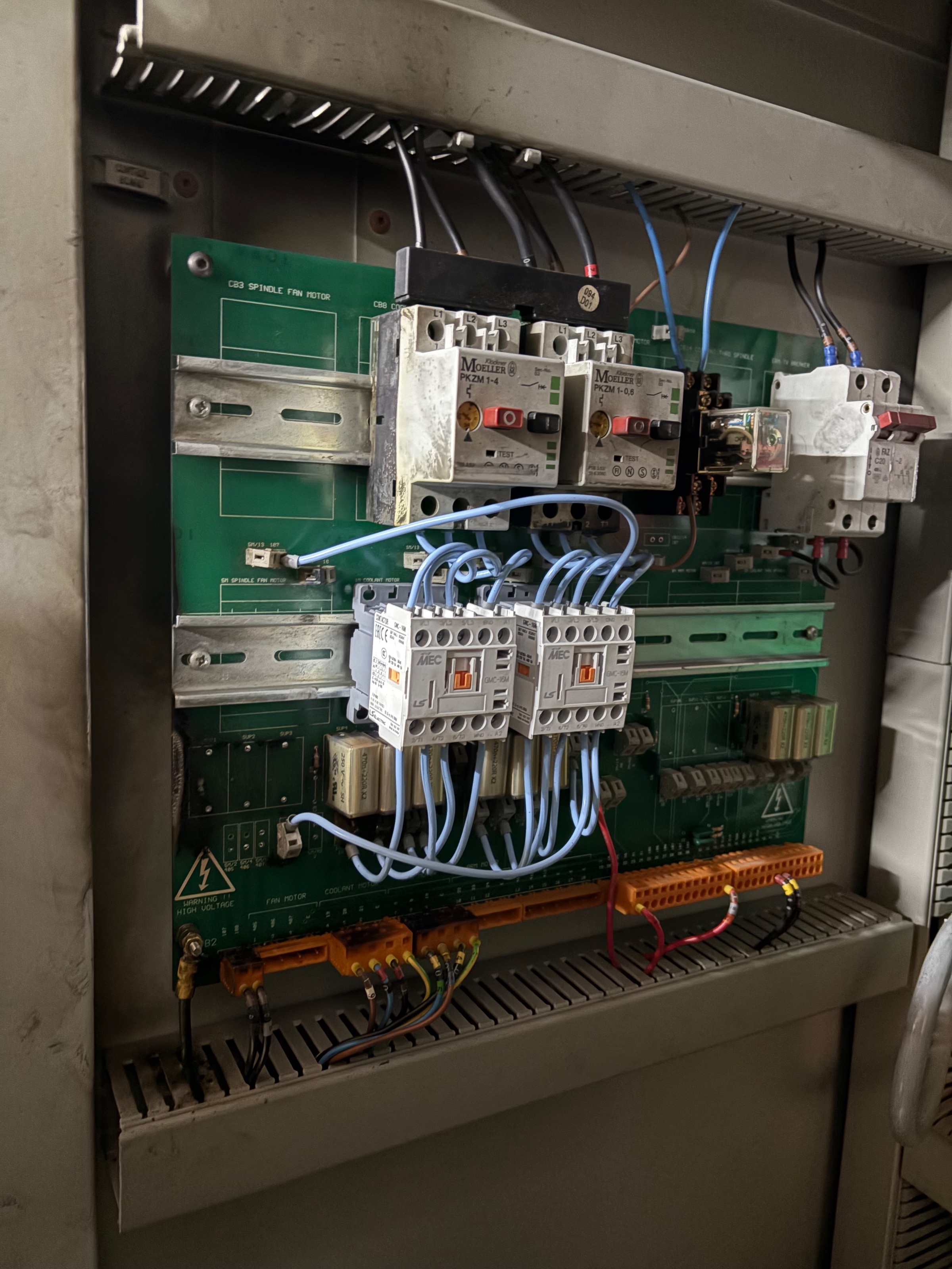

Ideally retain the original auxiliary control boards (the boards running the contactors for lube, coolant, tool change etc)
These boards look like the take simple logic signals from the Heidenhain.

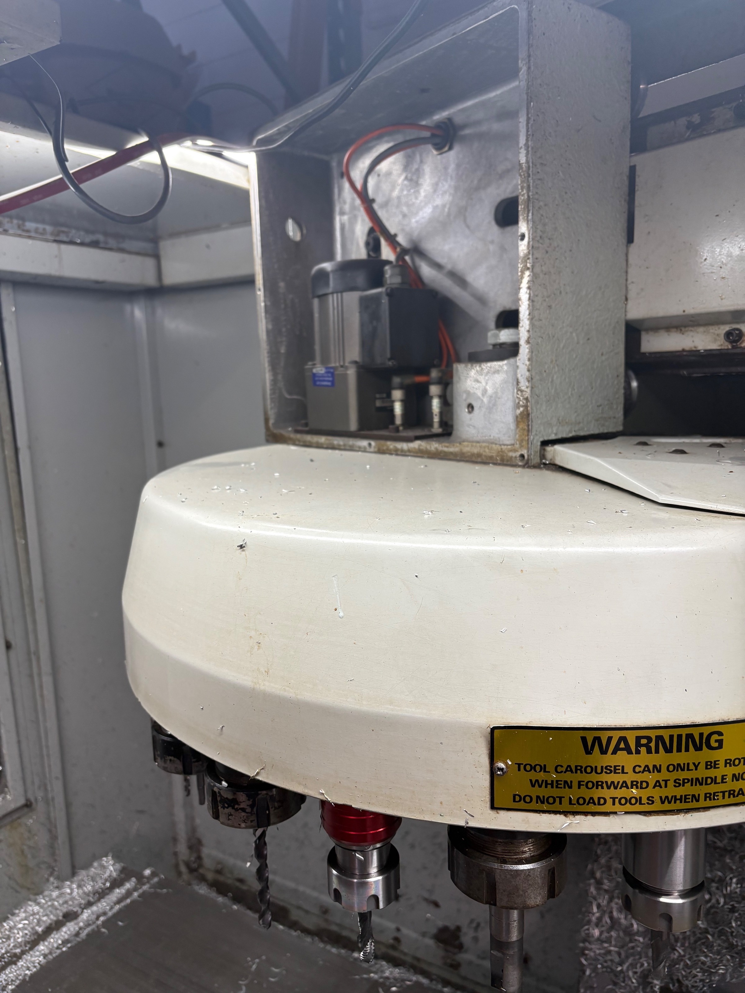

Retain full operation of the carousel tool changer. Fairly typical Geneva drive style of the time with AC motors and inductive sensors.

The thought did cross my mind to keep the motors and replace drivers. I would assume I'd need to get drivers that work with the Siemens encoders or replace the encoders with ones that match the drives.
Does anyone have any experience with this?

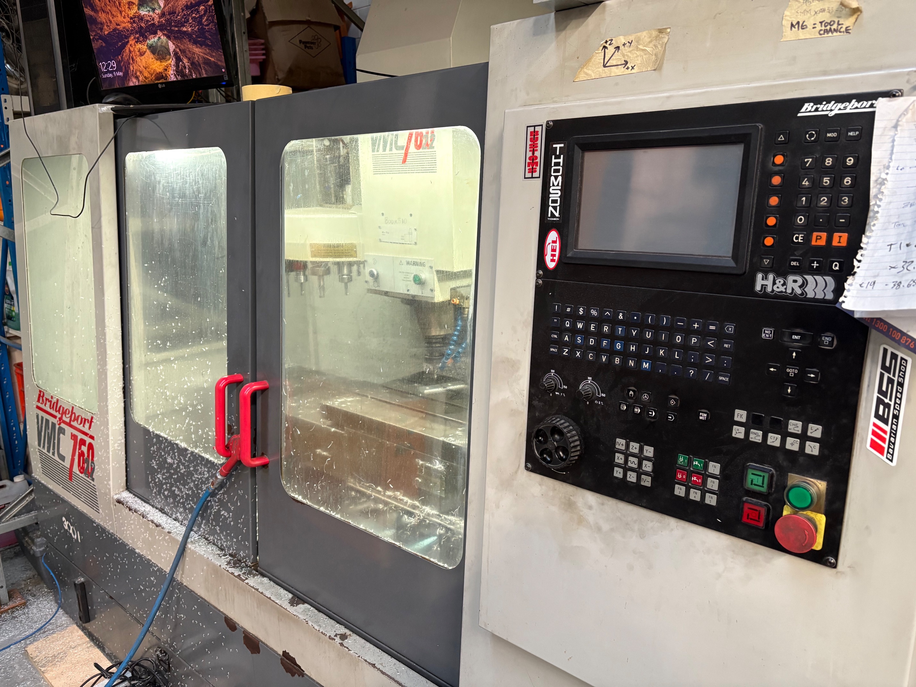

Some pictures of the old beast.

I'm a little apprehensive about cheap drivers as I've struggled with the manuals and particularly tuning in the past.
How was your experience setting up and tuning the servos?

Replied by spincycle on topic Bridgeport VMC760 retrofit
I refurbished a 30-year-old CNC router machine at my school.
The original drivers were E-waste.
The original motors are great.
The original transformer (that powers the drivers) is also great (though it's terrifyingly powerful).
The original rectifer bridge + capacitor were also E-waste.
But most of the original switches are still good (one switch got welded contacts due to overcurrent).
Mechanical things outlive electrical things.
Yep! I'm keen to reuse the majority of the control contractors, breakers and transformers. I've got the full schematics for the machine, so ideally I would splice the original contractor boards into Linux control.
Thanks for the input!
