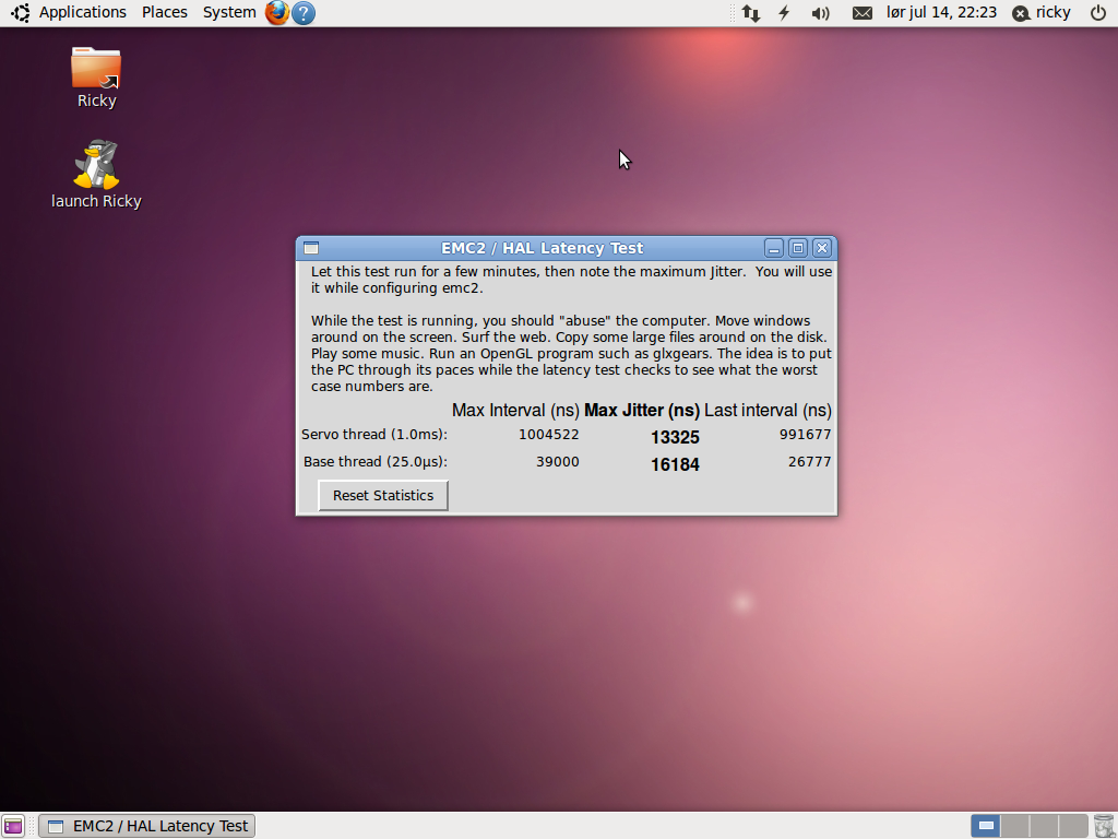

RTAPI: ERROR: Unexpected realtime delay on task 1
This message will only display once per session
Run the latency test and resolve before continuing

14 Jul 2012 19:13 #21944 by andypugh
Replied by andypugh on topic Re:Need Help
What does the latency test say? (It is in the CNC menu)
14 Jul 2012 20:28 #21945 by ricky_a
Replied by ricky_a on topic Re:Need Help
14 Jul 2012 20:40 #21946 by andypugh
That looks OK. But did you do as it says and "abuse the computer"? You probably want to at least run glxgears for a while and browse the web a bit.
Also, how long did you run the test for? You should run it for about 20 minutes.
One thing you should look for is a glitch every 64 seconds or so.

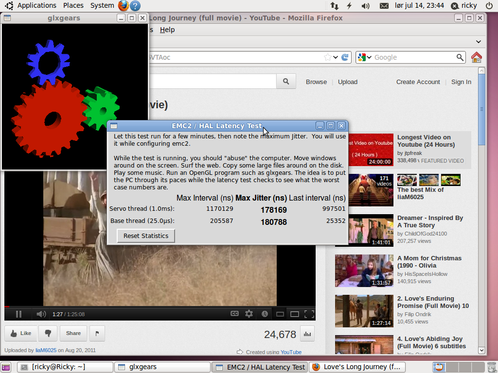

14 Jul 2012 21:00 #21947 by ricky_a
what is a glitch
14 Jul 2012 21:59 #21948 by ricky_a
NEW TEST

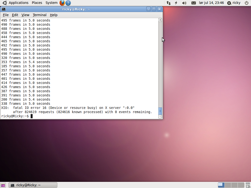

14 Jul 2012 21:59 #21950 by ricky_a
GLXGEARS
14 Jul 2012 22:00 #21951 by cmorley
Replied by cmorley on topic Re:Need Help
a large latency spike.
It's not a bad idea to let it run over night too.
the longer the better but the most serious problem show up pretty quickly.
