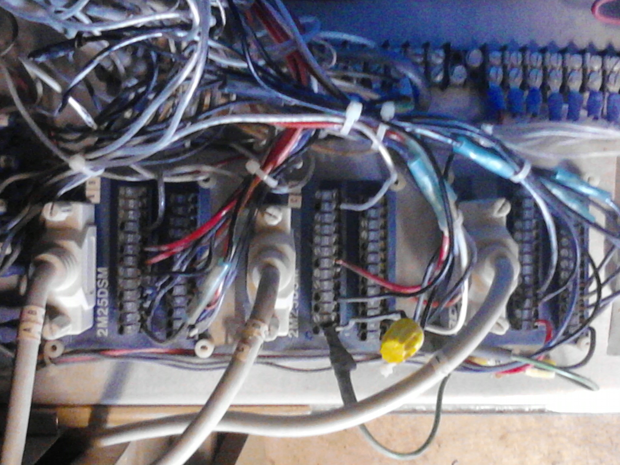

Todd,
After taking a deep breath and clearing my mind a bit I realized just what you stated.
I am going to have to dig in here and deal with this no matter what, Linuxcnc is worth it.
(Anything to avoid Windows for that matter).
I went ahead and busted some of the wiring loom apart and I now see that one of the three parports is for a joy stick. This is already starting to make more sense.
I will continue to dig and use your suggestions to get to the bottom of this and make it work.
I think this photo should be better.
Thanks again, Allen

Todd, my machine is set up just like yours with one exception, I have low and high limits on
22,23,24, and 25. This is in addition to the limits on 1,14,16 and 17.
This brings me to my next question:
Why would a machine have four proximity pick-ups on X, three on Y, and three on Z??????????
I am trying to wrap my mind around X mod and I'm afraid I'll hose something up, but I will open a terminal and roll the dice. Not being that well versed in Linux, and not knowing the nomenclature leaves me at a disadvantage.

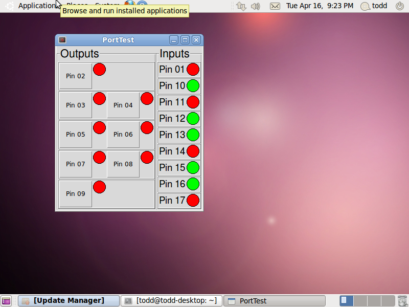

17 Apr 2013 08:39 - 17 Apr 2013 08:40 #32820
Pins 18-25 are just grounds on a parallel port. If you check more carefully I think you will probably find that they are the returning from the switches connected to pins 1,14,16 and 17.
from terminal in the directory containing the two files issue the command
That should pop up a window that looks somthing like this.
You also need to be sure that the ptestx.hal is using the right address for the port you want to test.
If you then connect the one of the input pins to ground with a 470 ohm resistor and watch to see if one of the input LEDs on the test screen changes color.
halrun -I -f ptestx.hal

17 Apr 2013 19:24 #32835
Replied by Todd Zuercher on topic Please help, I need some addvise
Did you install LinunxCNC?
If you havn't yet, the easiesty way is to boot from the live CD.
Also you have to remember to rename the file ptestx.txt to ptestx.xml. (It had to be renamed because the forum wouldn't let me upoad an xml)
You also need to remember that LinuxCNC requires a kernal modified for real time to run properly. If you are using something else you had before it won't work.
