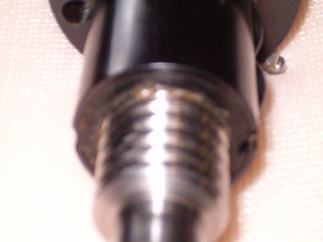

I got to thinking about your point Todd, what if I have a physical or mechanical problem.
Looking at the Z axis earlier I noticed there was a rather large amount of grease around the screw and nut.
It was a difficult place to clean as compared to X & Y so I attributed it to that.
(Denial, not just a river in Egypt anymore).
I went ahead and pulled down the Z axis, I have not one but two problems with it!
First a lineal rail pillow block is toast and in need of replacement, not a problem and expected to some degree.
But second, the Precision Nut is in some way fouled, it turns with a great deal of resistance.
The screw looks to be in excellent condition, I'm guessing it's internal.
Can I rebuild one of these?
Or can I get someone on the West coast to rebuild it?
Or should I find a comfortable place to sit down and get a price on replacing it?
- Todd Zuercher

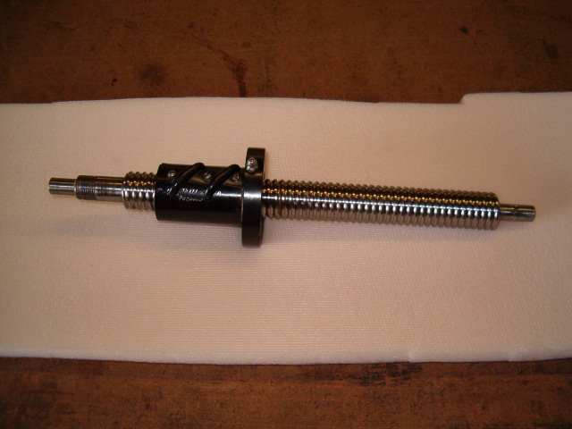

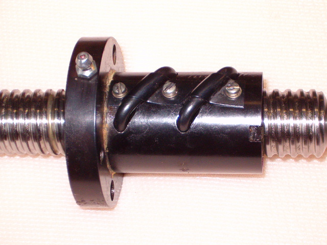

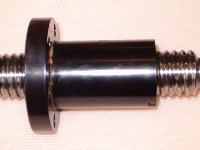

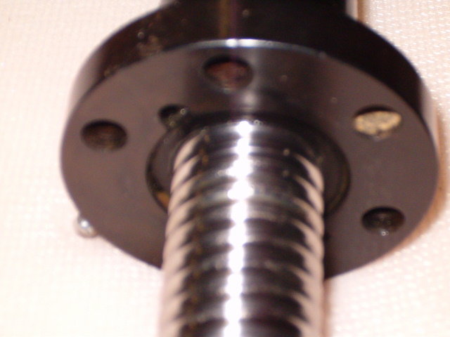

01 Jun 2013 02:23 #35057
by allenwg2005
Replied by allenwg2005 on topic Help with "Step Timing Calculator"
Sorry I should have mentioned what I have here.
This is a Rockford R-45 Precision Ball & Screw assembly, it is a recirculating bearing style, and is fitted with a grease fitting from the factory. There seems to be just enough drag on it to keep it from travel when not under power.
Or someone set it up to be loaded as to not let it fall when not under power, no way to know.
The only thing that spokes me about is it is the “preloaded”, I'm not sure I can address that.
I called Rockford and they just want you to buy a new one. (Not cheap)!
I'm sure I can take it apart (I'm good at that), some direction on assembling it properly and where to find parts would be helpful. I wonder what parts could be in there??? (I know a way to find out).
If I can ever get this machine going and make some cash with it, I would like to increase the Z axis envelop as much as possible, so spending a lot of money on this axis would be money wasted.

01 Jun 2013 03:02 #35058
Replied by Todd Zuercher on topic Help with "Step Timing Calculator"
If a ball screw is so tight that it is hard to turn, something is messed up, probably badly. I have never heard of one preloaded that tightly (at least not on purpose). A ball screws load rating is decreased by the amount of preload put on it.
Clean up the outside of it the best you can and snap some pictures of it. maybe we can offer some advise how best to attack this.
Some ball screw nuts can be very tricky to reassemble. Especially if you don't know what you are doing or have the right tools. (It took me half a day to put one back together once.)

01 Jun 2013 04:32 #35066
by allenwg2005
I wouldn't mind spending two days messing with it, it's nearly $2000.00 to replace it!
An Acme screw and nut are $700.00, and I have to cut the rod down and machine the bearing journals.
(So you say you want to get into motion control do you).
Here's some photos.
Thanks for looking and any advice.
