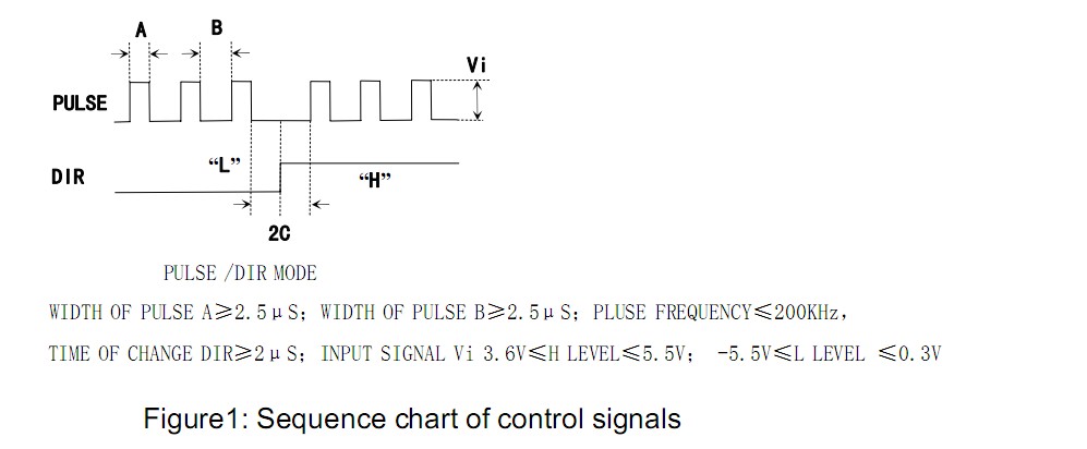

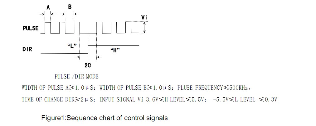

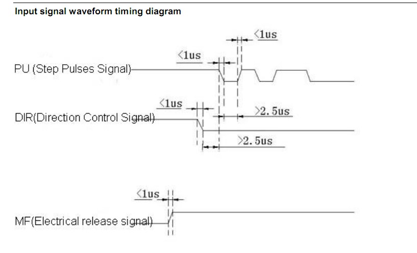

Hi there,
I have gotten from Longs-Motor on some helpful WAVE-diagram to help setup stepConf wiz.
Step Time
Step Space
Dir. Hold
Dir. Setup
unfortunately, I do not know how to use these for setup, so if anyone has ideas on converting the time, please update for us all to share =)
and perhaps put it on the wiki, so new users will not have to go through all these just to get their machine setup for use.

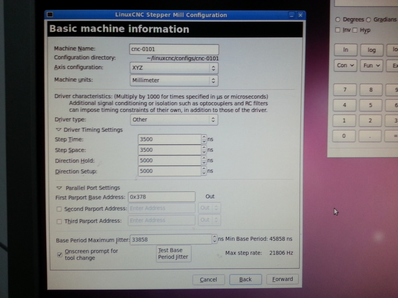

26 Sep 2013 14:51 - 26 Sep 2013 14:59 #39203
by cncbasher

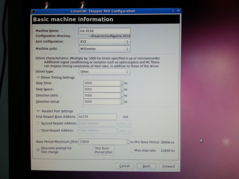

Replied by cncbasher on topic Longs-Motor - Nema 23, 34, 42, Step Time/space/dir
these are generic drivers sold under many names such as leadshine for example
steplen & stepspace 3500
dirsetup & dirhold 5000
is a good mid point as these have opto isolated inputs
as sw 5, 6 ,7,8 give you 2000 steps per rev this converts to ( 400 steps = 2 or 1/2 step ( minimum for these drives as they do not do full step ) , 800 steps = 4 or 1/4 step )
driver microstepping for this in stepconf is 10
or directly set stepscale in ini file to the number of steps per mm i.e ( 2000 steps per rev / leadscrew pitch ) 2000/7 = 285.714285714

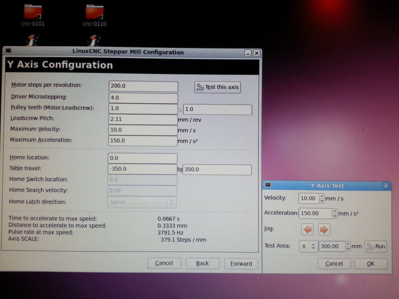

27 Sep 2013 02:04 #39236
by fannlow
Replied by fannlow on topic Longs-Motor - Nema 23, 34, 42, Step Time/space/dir
I have tried to reply to this post with images... but unable to post...
is this due to image size 1.7mb @ 5 images? = 8.5mb?
i downloaded pixresizer to resize and try again...
I am attaching my morning tests for this run, and will attach evening tests tomorrow.
hope to shed some light as to what went wrong, and how I can overcome my mistakes and not make them again
appreciate any kind help.

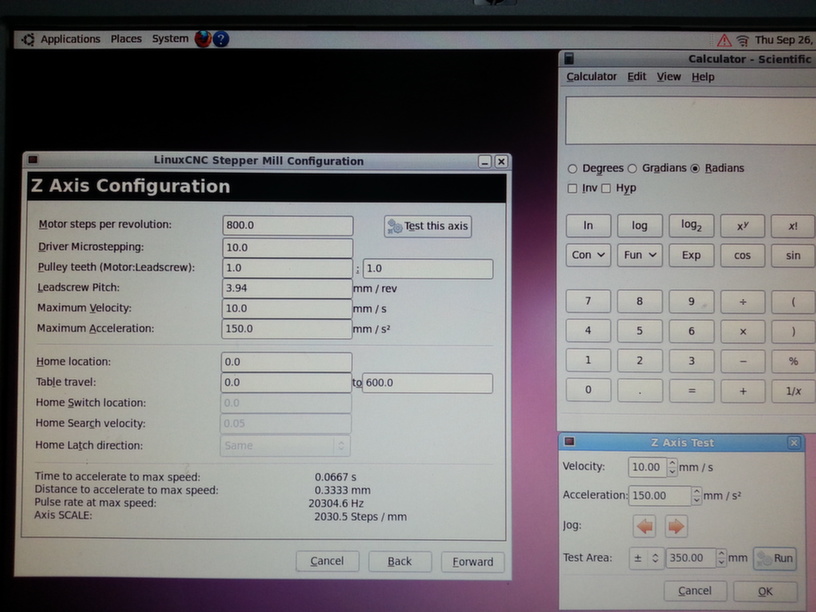

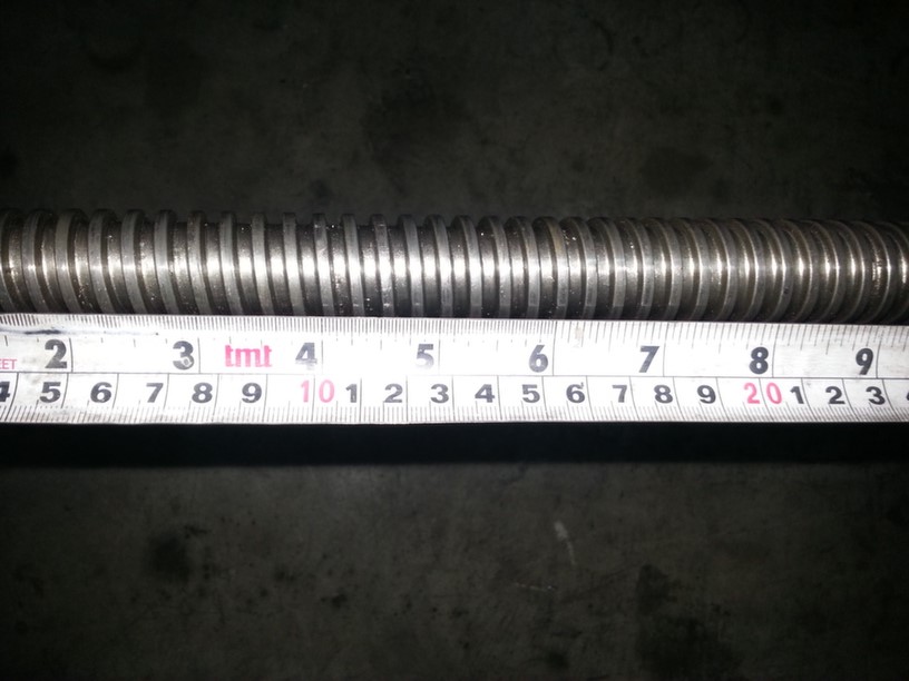

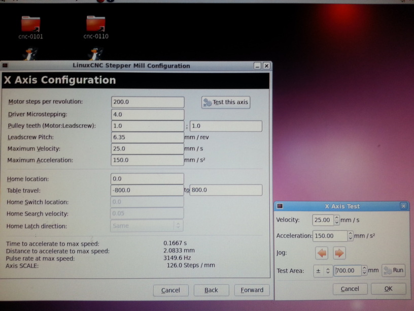

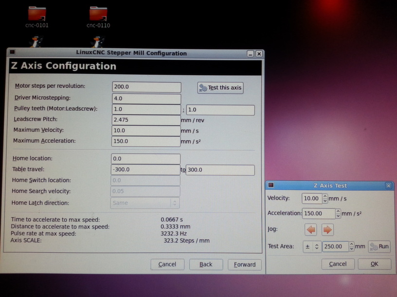

27 Sep 2013 17:10 #39263
by fannlow
1. I am unsure if the distance travel by the nut in 1 rev of screw is the leadpitch linuxcnc needed.
2. When I entered 7mm of leadpitch and test 700mm of +/- area, it runs short of 700mm...maybe ard 635mm.
3. I have changed the
stepTime from 3000ns to 5050ns,
StepSpace from 3000ns to 5050ns,
Dir. Hold is 5000ns,
Dir. Setup is 5000ns.
Data from DM542A driver board wave timing diagram.
4. Still not getting results that tally to 7mm/rev @ 700mm +/- tests.
Any ideas whatvwent wrong?
Velocity is 25mm/s @ accel 150mm/s2
Motor Steps is 200 per rev
Micro step is 4
The same is set on the driver DM542A board 800pulse/rev
DIP @ 5, 7, 8 = ON
DIP @ 1, 2, 3, 4, 6 = OFF
Any help?

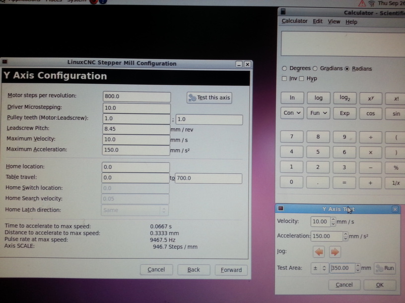

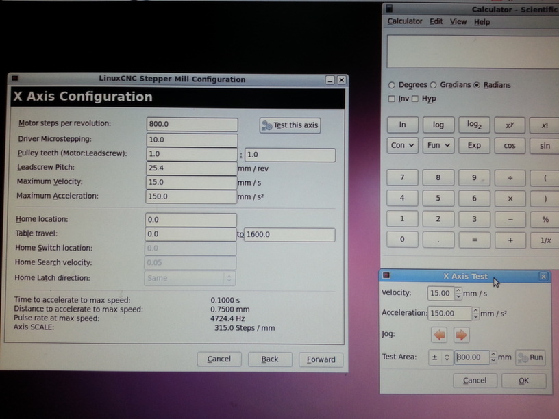

28 Sep 2013 00:15 #39279
by fannlow
this is the evening tests in images...
slightly closer to 7mm per rev now...
but not getting to 7mm accuracy for 700mm tests, IF 7mm is used...
so i used the one in the images...
X & Z axis is a little closer, to the per/rev travel.
since X & Z uses the same type of 17mm dia screw, i get around 2.3mm per rev.
but like the Y axis, I used the one I had in these images to get the test accuracy.
would like to know what went wrong and how I can correct it, so the next time I start another machine, I can resolve these differences =)
- Posts: 23315
- Thank you received: 4944
28 Sep 2013 01:56 #39283
That seems to show that the leadscrew pitch is exactly 4 threads per inch (6.35mm pitch).
Replied by andypugh on topic Longs-Motor - Nema 23, 34, 42, Step Time/space/dir
The following user(s) said Thank You: fannlow, slese
- cncbasher
- Posts: 1744
- Thank you received: 288
28 Sep 2013 15:23 - 28 Sep 2013 15:32 #39302
by cncbasher
As Andy says , it looks as if your using Imperial size ballscrews and not Metric , so the calculation required changing to suit hence 6.35mm (1/4")tpi
as a note , you can directly go into the INI file and change the Scale value for that axis manualy to give the same result , all stepconf does is produce values based on calculations and places them in your config file
it is good practice in Linuxcnc to use stepconf to produce a start point, and then manualy edit the files Hal and INI thereafter . you will learn a lot more in the process .
