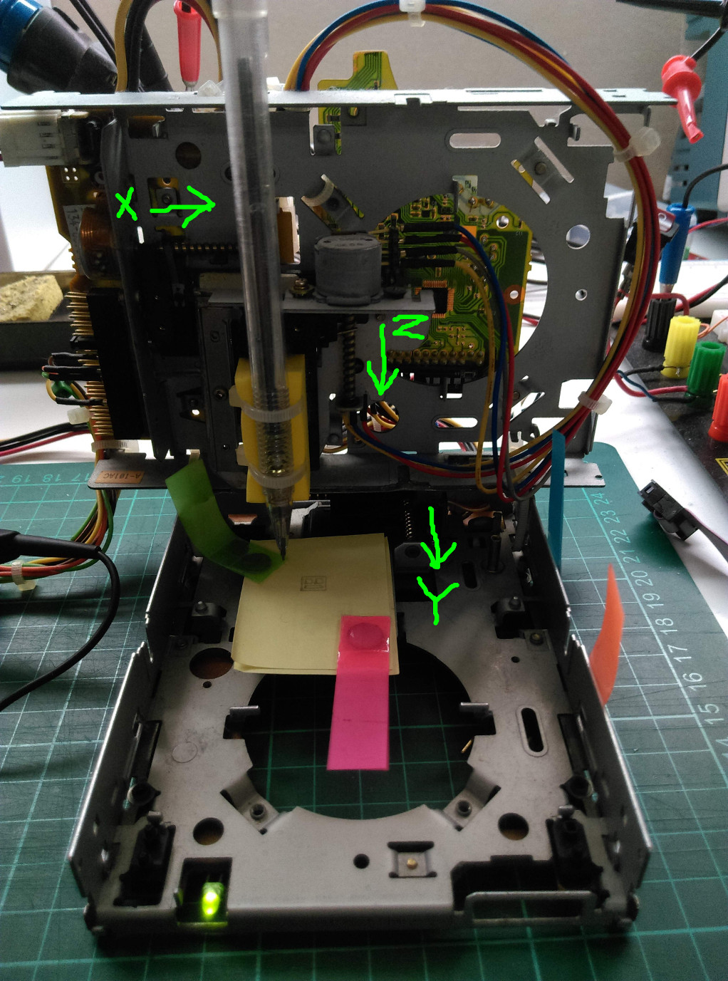

Here is the picture of my floppyCNC, FYI.
The Z axis is reversed, that's why I invert the PIN 6 (Z-Direction)
