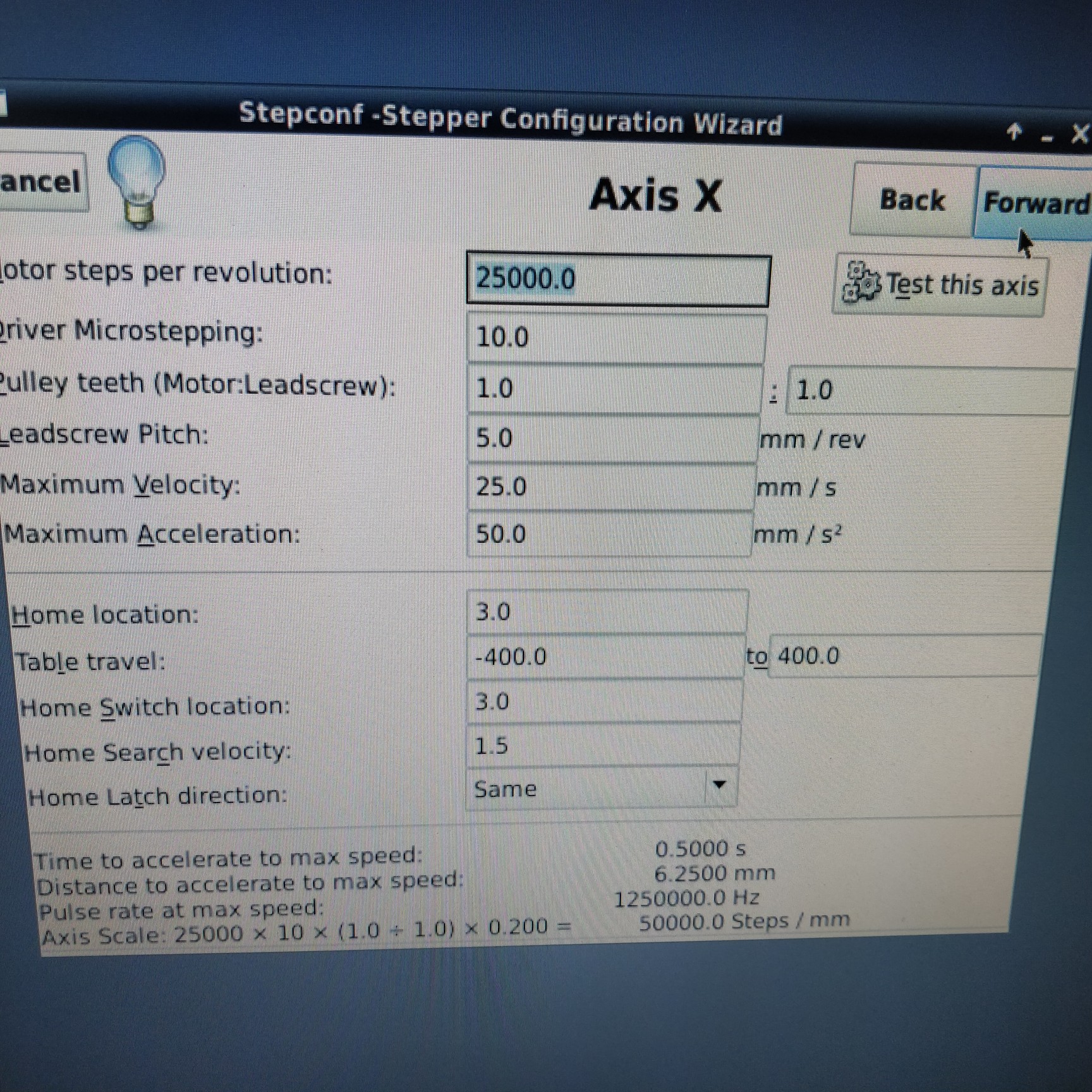

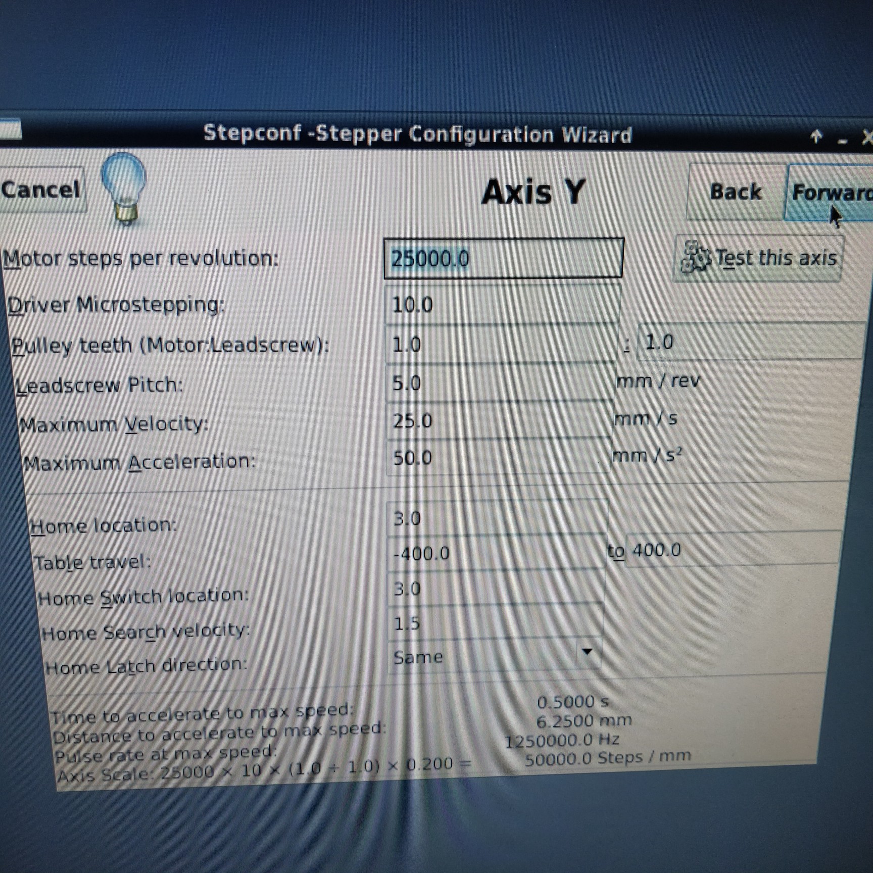

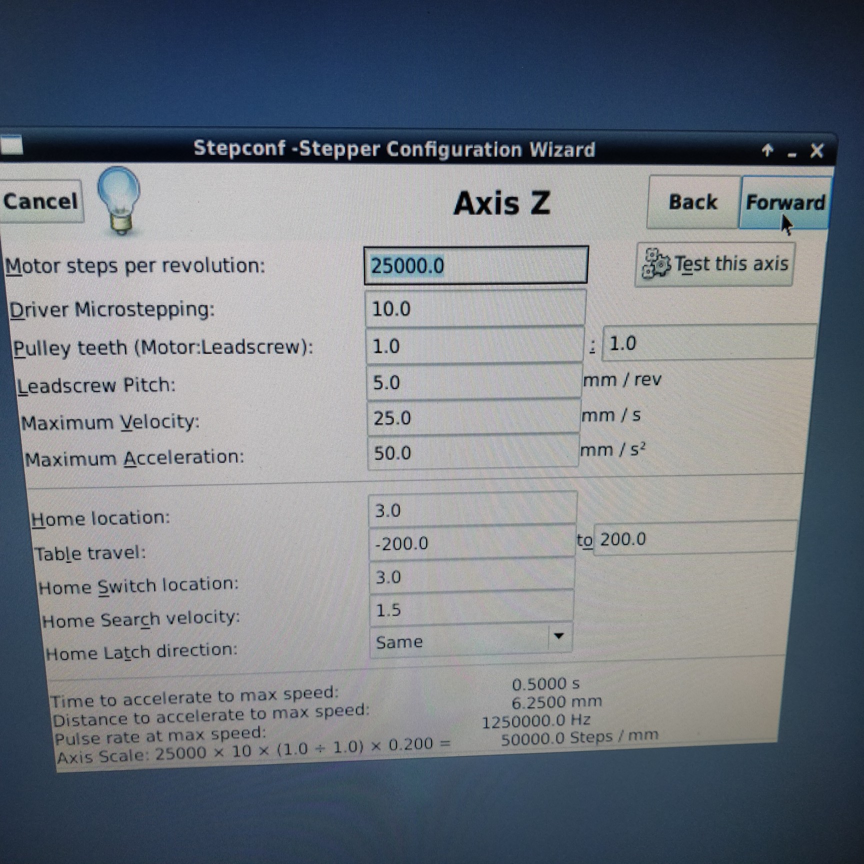

Hi all,
I'm just setting up my home-built CNC machine. I had the stepper motors turning a few months ago on the bench via a PC running LinuxCNC and a DB25-1205 breakout board.
However, now I've put everything together properly the X and Y axis won't turn via the LinuxCNC software.
This is how far I've got.....
My machine has 'manual' functionality built-in via an Arduino board.
I can 'manually' turn the X, Y and Z in both directions fine.
If I start up LinuxCNC I can operate the Z axis through the software fine.
If I try and operate the X or Y axis the values change on the PC screen but the actual motors don't turn.
If I connect the X axis direction/pulse wires into the Z axis connectors on the breakout board and then manually operate Z in the LinuxCNC software then X works fine (which proves all the wiring from the breakout board to the motor).
So... I'm looking at either a setting or a problem with my breakout board?
I am an absolute beginner with all this. I mean it is ALL new to me so if you can give me any advice I would be very grateful. I've attached my StepConf settings for you to cast an experienced eye over.
Many thanks
John

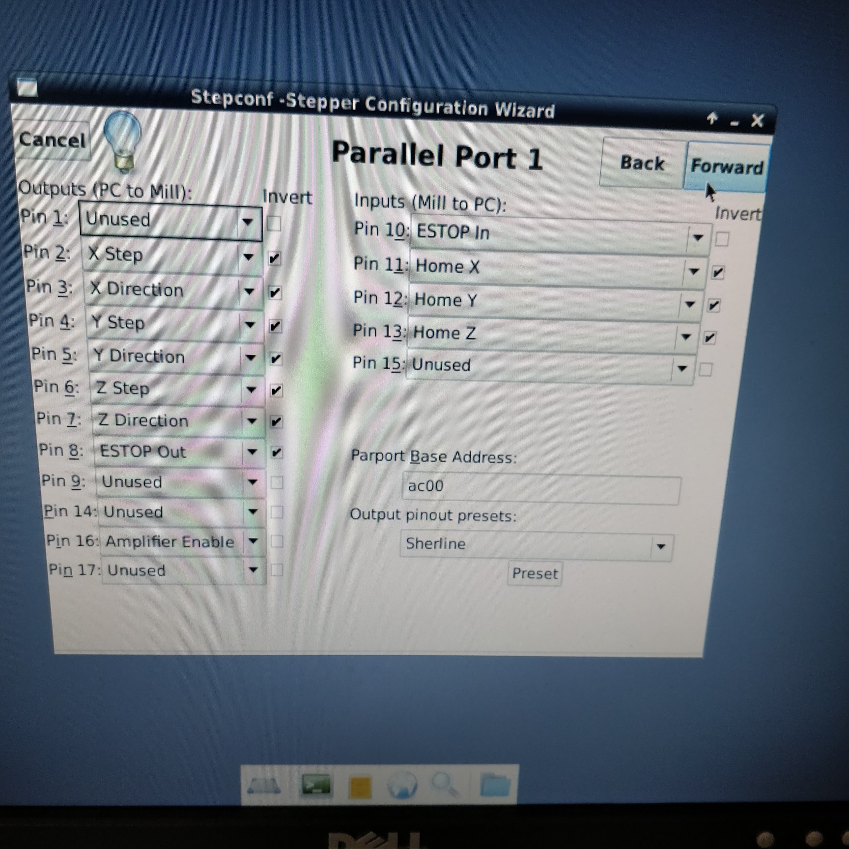

This is often a problem with the "enable" pin on the drives
Are the not-moving motors locked or free to rotate?
free = no enable signal (or positive disable signal)
locked = no STEP pulses or STEP pulses too short (or wrong polarity)
turning only one way = no DIR signal.
Having enable, dir and step switched around can have a variety of effects, sometimes even almost working.

if nothing else, the stepconf settings look fishy
If your drive has 10 usteps/step , steps per revolution with a normal step motor should be 2000 not 25000

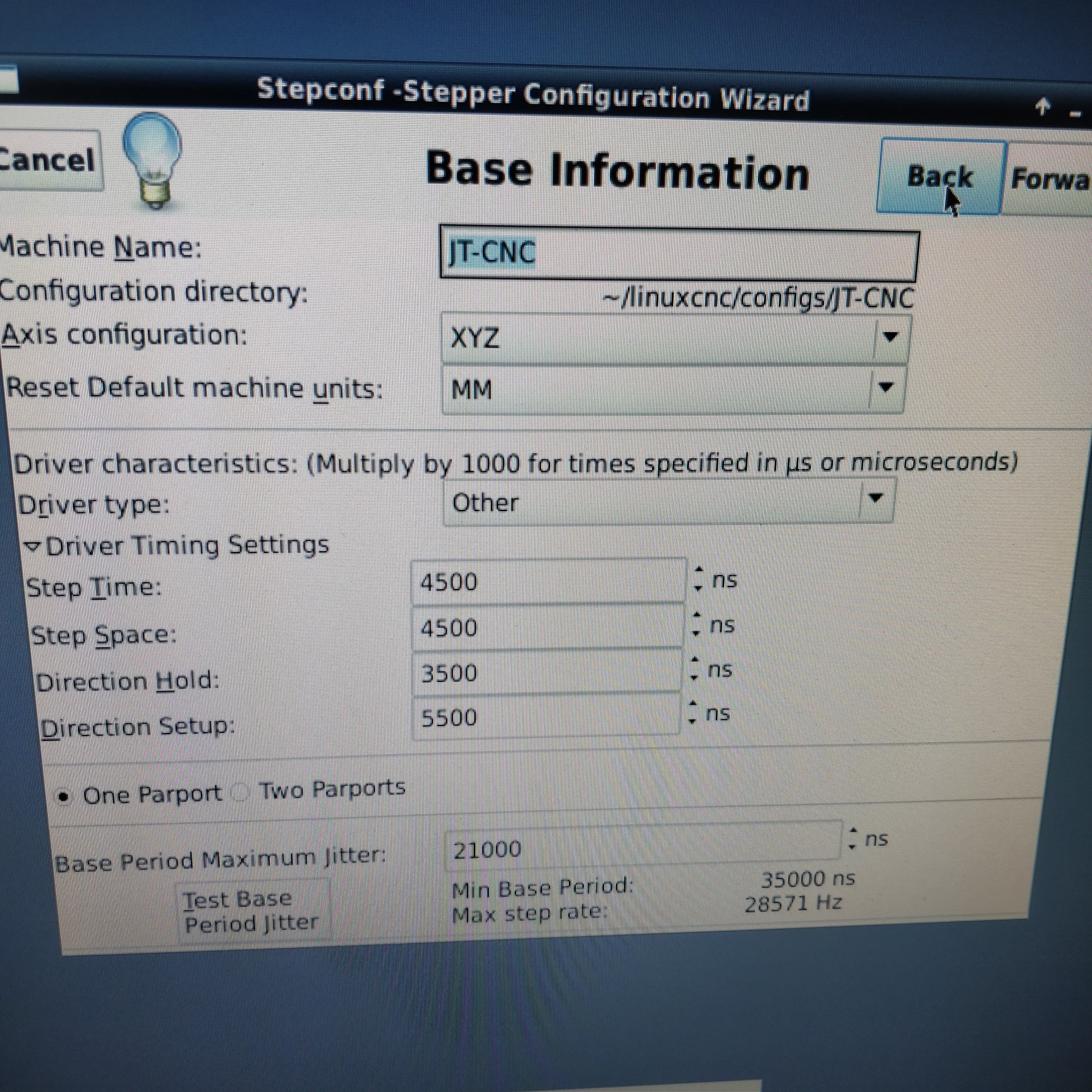

Another possible issue is the slowness of the DB25-1205 outputs. These are known to be marginal for step outputs. You might try increasing the step time.

To be honest I can't remember where I got those figures from. I think I took them from a YouTube video many moons ago.
The history to this is that I started building the machine January 2017. I managed to get the control board etc finished around May '17. But then, due to other stuff, I didn't get the actual frame finished until a few weeks ago. So this is me just trying to find my way again through it all.
I'm not from a CNC background at all. I've never used Linux before (let alone LinuxCNC). I've never used a CNC machine before.
I'm a PLC software/electrical guy so I'm really a monkey on a new tree with all this.
The drivers are DQ860MA
www.wantmotor.com/product/dq860ma.html
The motors are Stepper Motor 8.7Nm Nema34
www.cnc4you.co.uk/Stepper-Motor-8.7Nm-86HS115-4208-Nema34
So, any advice on correct settings would be very much appreciated. Thanks

I did try putting my meter on the 'dir' output of the board and it just sat at 5V (4.89VDC to be exact).
The Z axis changed from 0 -> 5 V depending on direction but the X didn't change when I manually tried to move it in the software.
That's what was leading me to settings or the board (or something else???). But I'll try adjusting the 'step time' just to see if it changes anything. Thanks for your continued help

Yeah if direction does not work that suggests a software setup (wrong pins in stepconf?)
hardware setup (breakout board options), wiring or hardware fault

Is there a hardware setup for those breakout boards do you know? I don't remember setting it up?
I'll have a mess around with changing the step/dir outputs and see what happens.
Thanks for all your help
