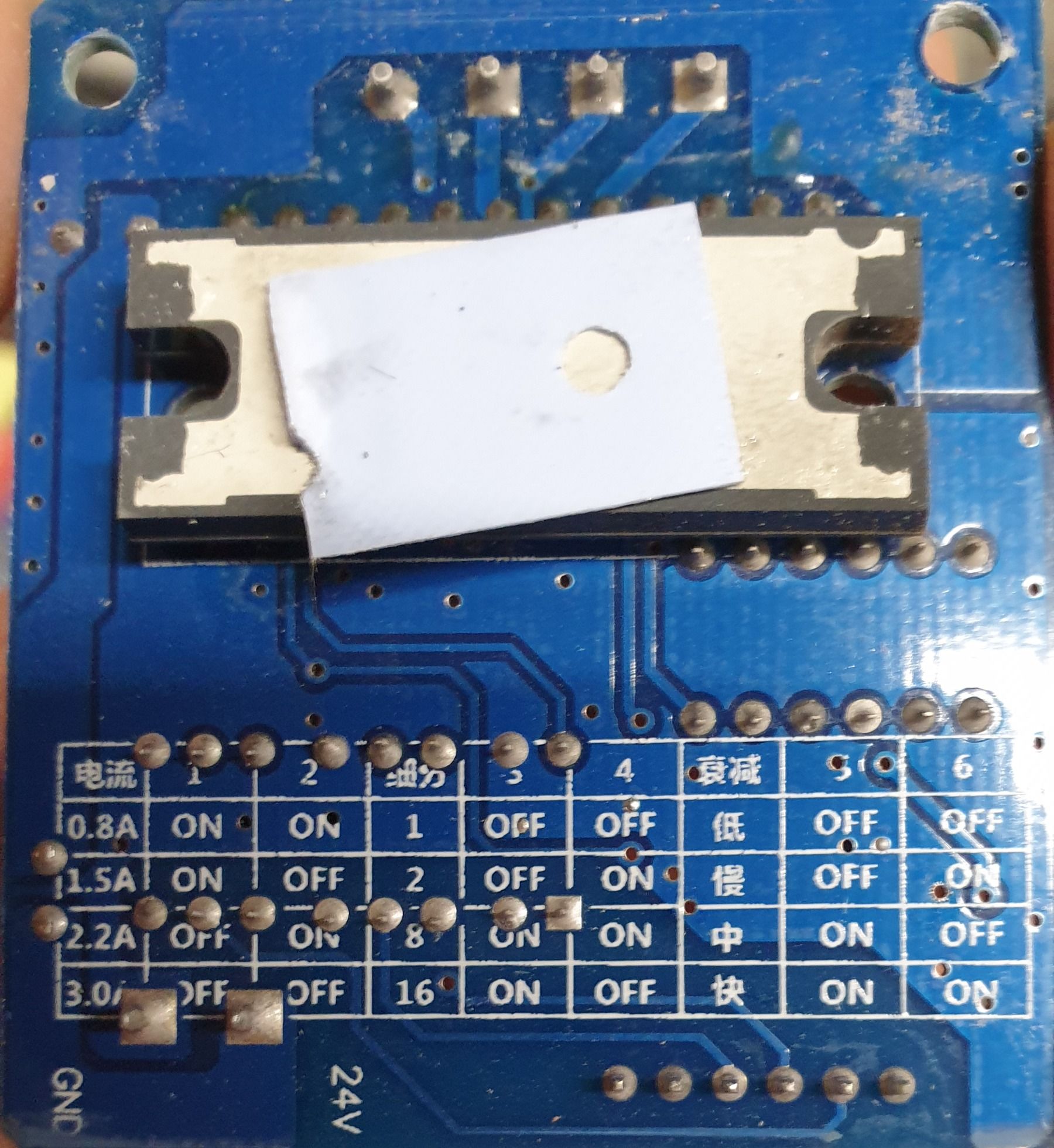

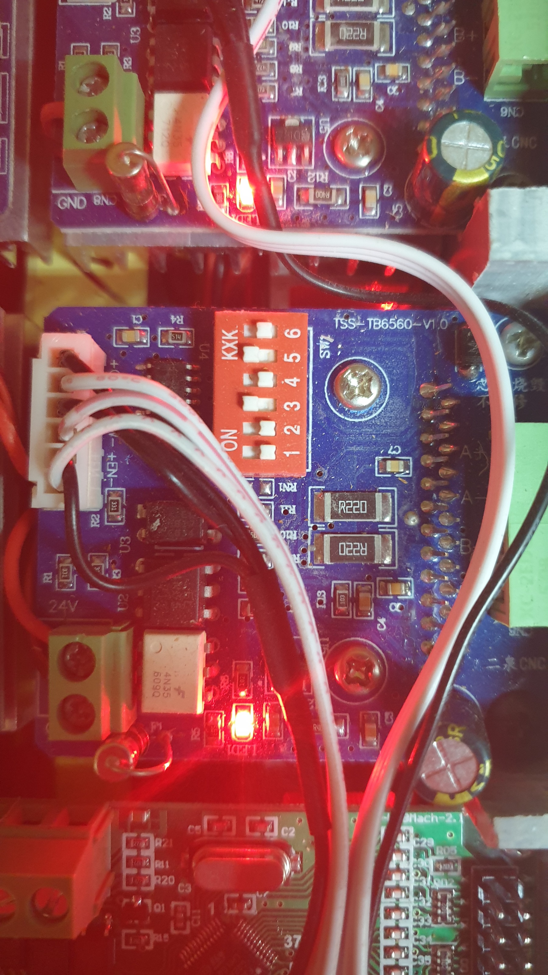

06 Sep 2021 20:01 - 06 Sep 2021 21:07 #219806
by rbuckland
Replied by rbuckland on topic Basic Parallel BOB + TSS-TB6560 single axis (x4) + NEMA23 (x3) - No mvmnt
I now have a handle on a few things and have the motors stepping .. ever so slowly.
Before , the motors didn't move, but I set the DIP switch for each driver to 3Amperes and they now move.
issue 1
Using stepconf/test axis, the motors move too slowly.
I have the microstep at 2, and the steps per resolution at 200 (NEMA23).
I have tried the attenuation in a number of positions but to no avail.
if I lower the stepping, 8, 16 the drives rotate less of course.
I get the most movement when its at microstepping of 1. Of course, but even then it is super slow and doesn't move to the configured test distance of 10 or 15mm. It overshoots, if I wait the 5 to 10 minutes for it to get there.
Issue 2:
If I load the same configuration into linuxcnc, the motors don't move at all.
(Emergency Off, Machine On).
I can see the BOB board LED Relay turn on, and the relay clicks.
But the drives don't move at all, and no noises.
Unlike stepconf testing.
My dip switch settings are currently set at
- 3A
- microstep 2
- attentuation low. (possible attentuation values are,: low, slow, medium and fast.)
issue 1
Issue 2:
- 3A
- microstep 2

09 Sep 2021 16:38 #220084
Replied by tommylight on topic Basic Parallel BOB + TSS-TB6560 single axis (x4) + NEMA23 (x3) - No mvmnt
Ah the joy ...
