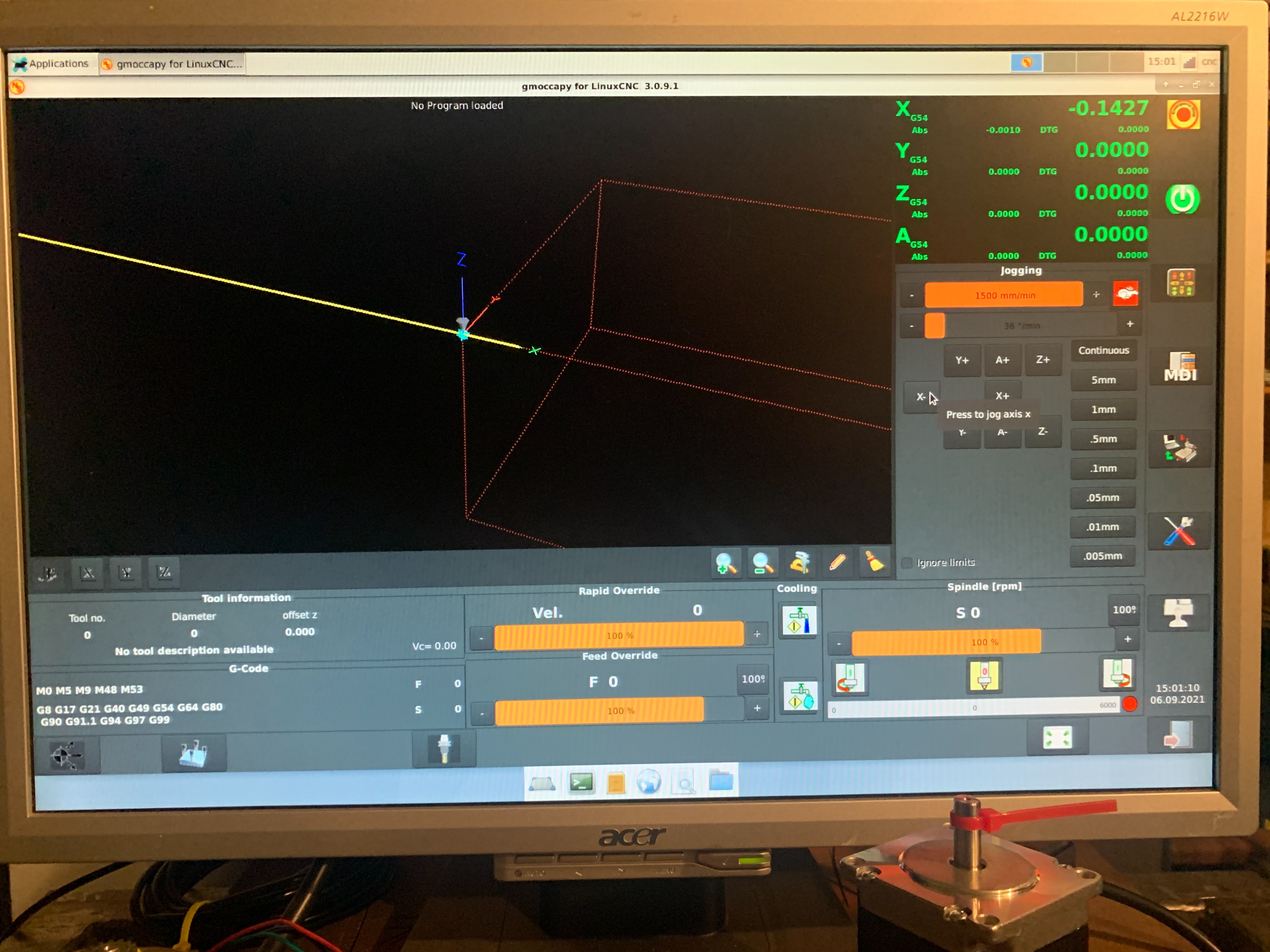

New user here, when jogging does that go as fast when jogging as it does when making a cut? Just got my X Axis working and was expecting the movement to be quicker, they are both in time and going the correct distance when in linuxcnc, say do a 5mm jog, both do move 5mm and sound smooth on the leadscrew (took alot of time getting these screws straight and true), when selecting the tortoise it goes so slow you can hardly see mounts move but looking at the motors you can see they are indeed moving.
Maybe I'm not describing very well, if not i'll see if I can drop a video, everything might just be fine and when running gcode it maybe quicker, is there any gcode examples that would test this? I'm running all StepperOnline, drivers are DM542T configured for RMS 1.69A as my motors are rated at 1.8A and they are 23HS41-1804S which are 1.8 angle and 2.4nm
Might be worrying about nothing but just concerned about these getting out of sync and damaging them when bolting on the Y gantry so need to make sure they are spot on.

Have you tried increasing the JOG speed slider in the GUI? I presume you are using gmoccapy as your GUI.
To test gcode speed go to MDI mode and type something like G01 X100 F250
or G0 X100 for a rapid move.
Speed will depend on the speed settings you set in the ini file. If you are still unsure please attach your .ini file.

Hi Aciera, thanks so much for taking the trouble reply, the G0 runs at the same speed as the manual jogging and the slider is all of the way up, the G01 X100 F250 goes really slow but does travel the distance and takes 25 seconds to travel the distance if that helps.

What speed (mm/min) does the slider indicate in the gui?

1500mm/min
Last edit: 06 Sep 2021 02:04 by Killer. Reason: Added picture of gui

Hi Ottodidact, not exactly, the machine doesn't even have its y axis made yet and I'm just jogging stuff around and I didn't think it was moving quick enough, for example when do a G01 command it takes 25 secs to travel 100mm, does that sound slow or fast to you?
Guess that's what I'm asking. Havent even tried the cam side of things yet lol

If you jog at 1500mm/min that should get you 25mm in a second or 100mm in 4 seconds.
So, if you jog say 300mm how long does it take?
Replied by Aciera on topic Jogging
Ok that sounds reasonable. F250 means it should travel at 250mm/min so for 100mm that is 60/250*100=24s.G01 X100 F250 goes really slow but does travel the distance and takes 25 seconds

12.74 secs ish

Ok, 3*4s=12s.
Looks like your machine is doing just fine
