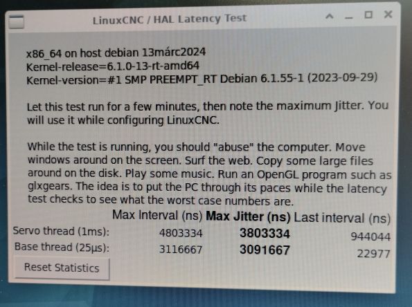

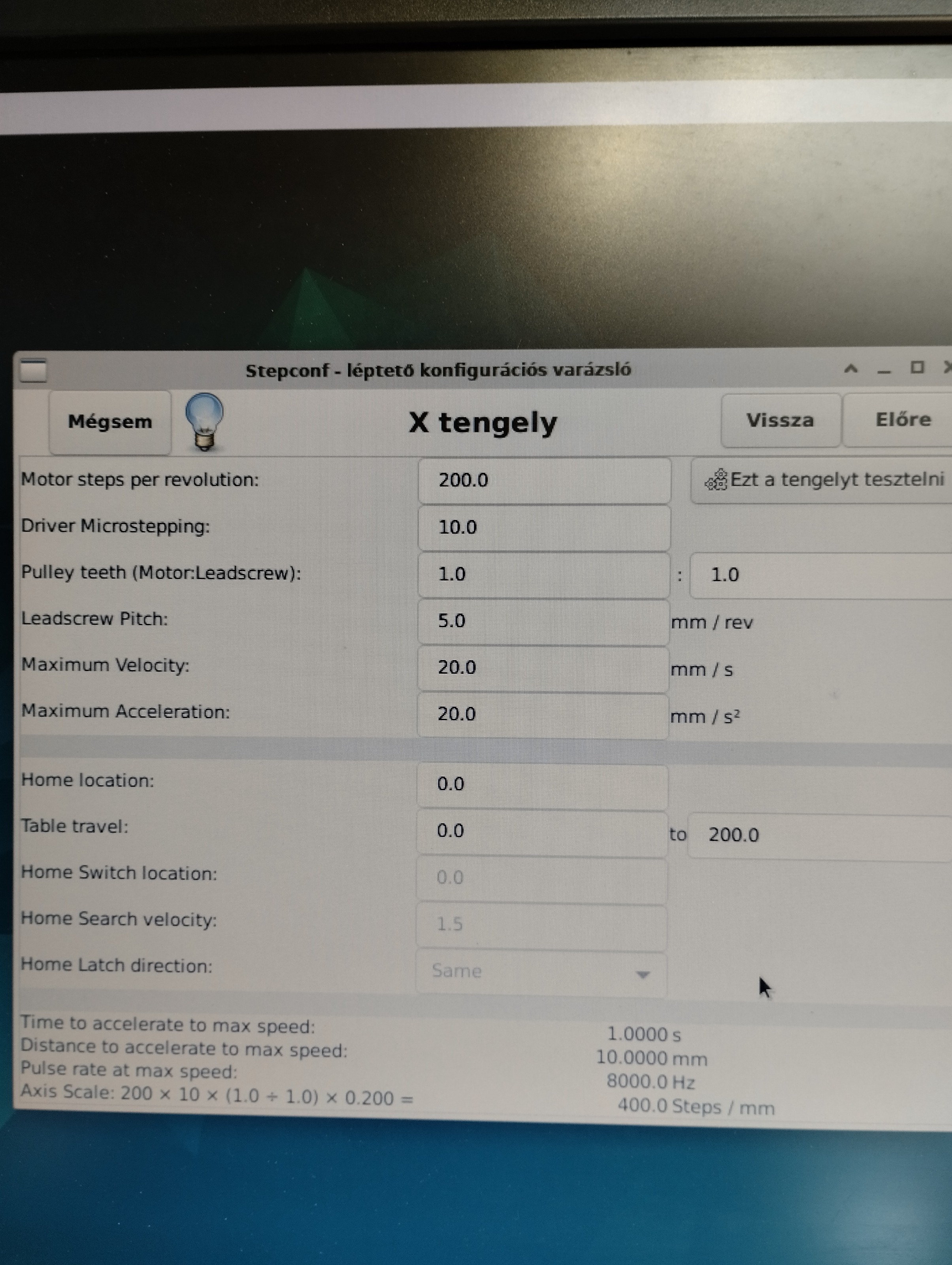

Hello everyone,
I guess this Latency Test below very-very bad!!!
Under stepper config axis test the motor lost step if mouse move...
Please recommend me right PC configuration.
Thank You!
Thank You!

Replied by PCW on topic Latency Test is weak...
What hardware are you running?
Do you have all power management/cstates>1/Turbo modes/EIST/hyperthreading
disabled in the BIOS?

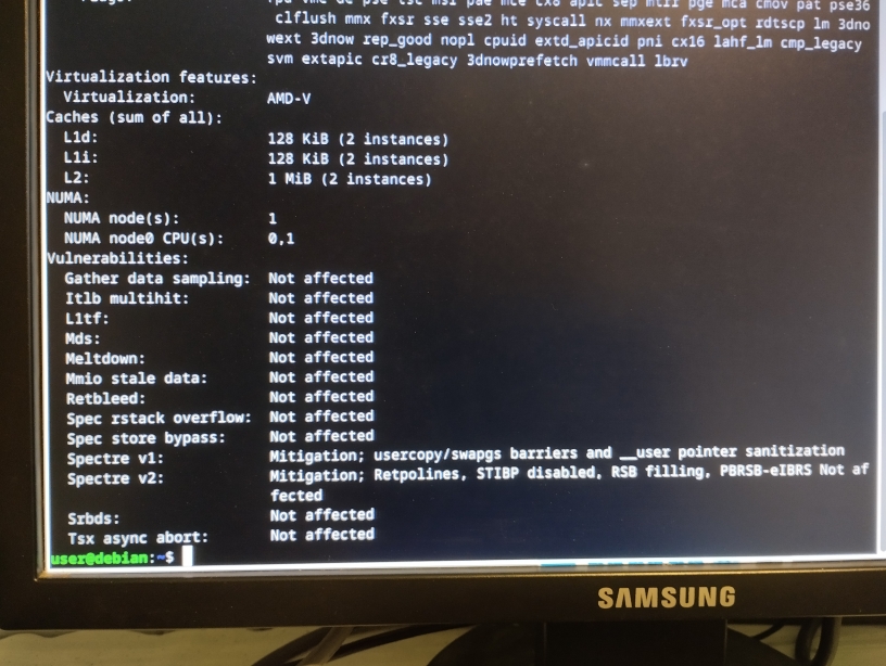

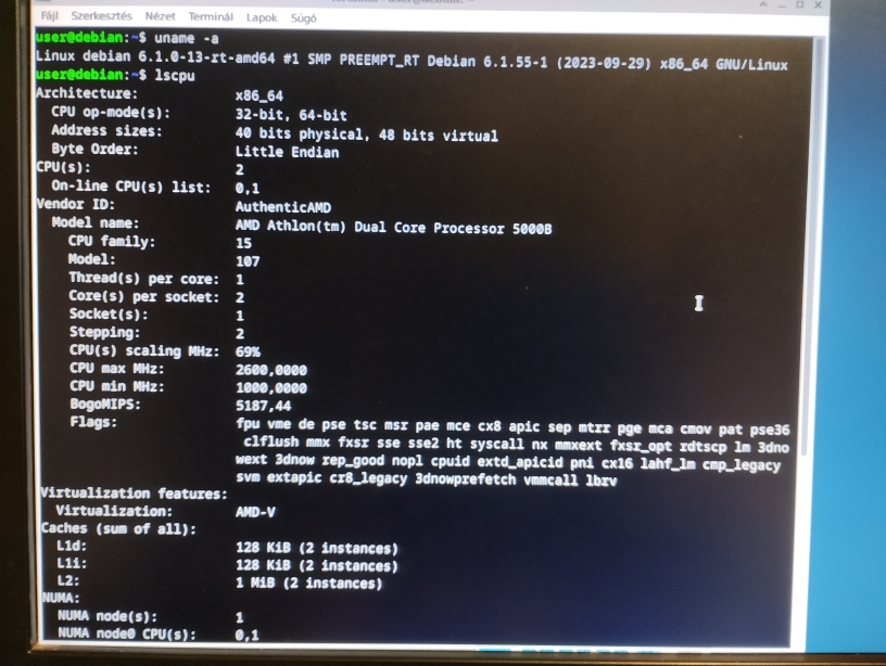

Replied by Topi69 on topic Latency Test is weak...
Hi PCW,
I found this information on PC.
Is that enough or do you need more?
What linux terminal command should I use?

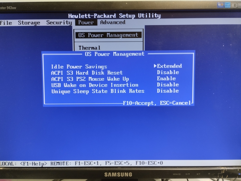

Hi PCW,
You wrote this:"Do you have all power management/cstates>1/Turbo modes/EIST/hyperthreadingdisabled in the BIOS?"
Where i find those (about hyperthrading) BIOS informations?
(- I start the boot process,
- I press F10 for BIOS setup
- In the BIOS I found this about power management (see the attachement))
What I make wrong?
Thx!
What I make wrong?
Thx!
- Posts: 21861
- Thank you received: 7458
15 Mar 2024 12:00 #295954
Replied by tommylight on topic Latency Test is weak...
All disabled.

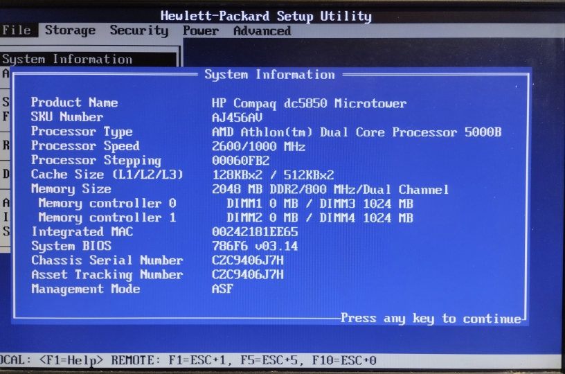

I found more informations for my PC,and I have one question:
This processor on below able for LinuxCnc?
- Posts: 18056
- Thank you received: 5306
15 Mar 2024 18:48 #295988
It should be OK

- Posts: 21861
15 Mar 2024 19:30 #295993
Pretty sure i have one of those HP in the shop, well i have it for sure as i installed Linux Mint and LinuxCNC on it two days ago, so yes it should work if electronics are OK, and it has a parallel port header on the motherboard that usually comes with the DB25 connector on the back.
