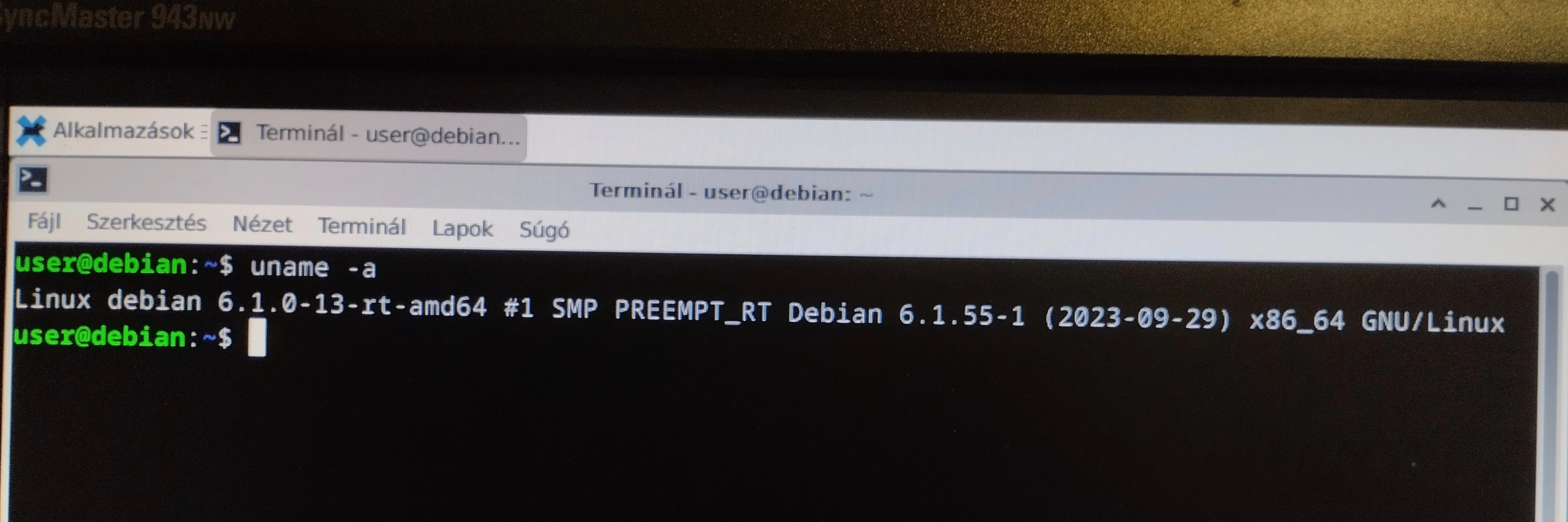

Yes Sir,
I have Debian Linux + LinuxCnc + DB25 paralell port.
(I glad,my PC is able for project, but must will find the good setting.)

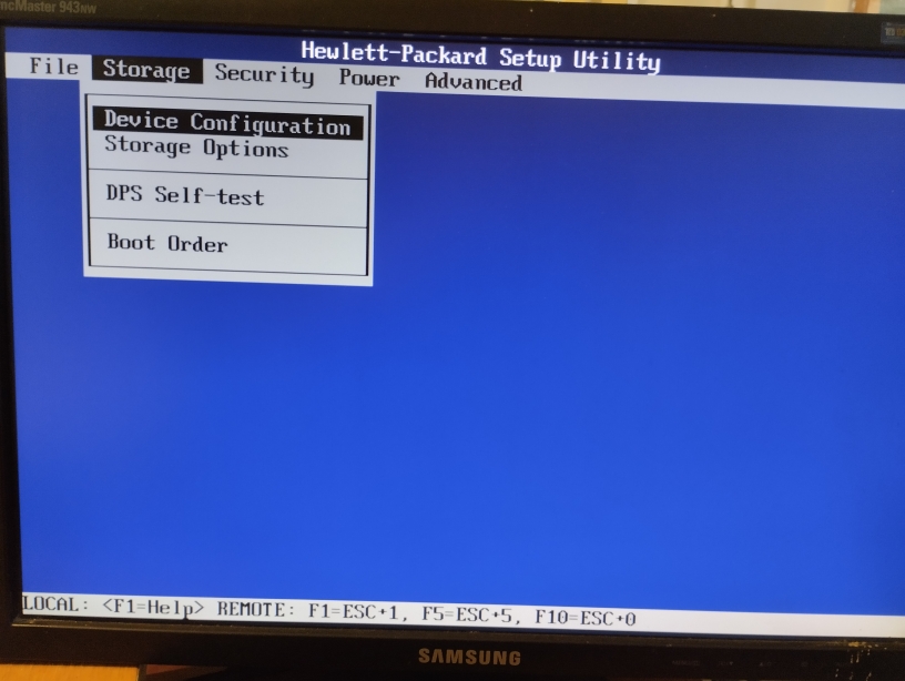

Hi PCW,
Please help me, I am newbie, I not found the setting values.
Where I find this?
Thanks for helping!
Where I find this?
Thanks for helping!

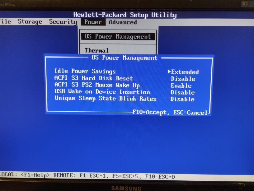

Replied by tommylight on topic Latency Test is weak...
Second screenshot, idle power saving - disabled
Find hyperthreading and disable it.
Find TPM and disable it.
