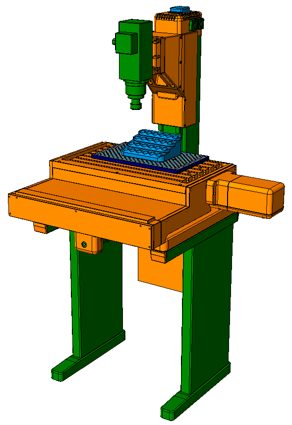

Hello everybody,
my name is Robert, I am 29, designer, cnc-hobbyist and from Germany.
I am facing a very complicated problem with my machine control.
I have EMC2 on Ubuntu 9.10. in use.
The whole on a Atom CPU board with isolated CPU step generation.
The machine is controlled via the parallel port.
Connected to the breakout board of Benezahn.de and 3 step / direction servo controller.
Base - and servo thread at about 4500 (after a long-term test with heavy load), which I've given in Stepconf.
Everything is going very well, except for occasional, but intense machine crashes.
First appears "unexpectet Real Time Delay" and a "joint 0 -" and "joint 1 Following Error".
A second later, the milling spindle is touring on to maximum and the tool moves in X / Y with maximum feed into the workpiece. In about 200 hours of operation, has happened 4 times.
The error occurred on short and long even at different g-codes.
The g-codes themselves are correct.
I myself have only little knowledge of Linux.
A friend has read all the log files that might be helpful.
These logs and my entire machine configuration attached to this post.

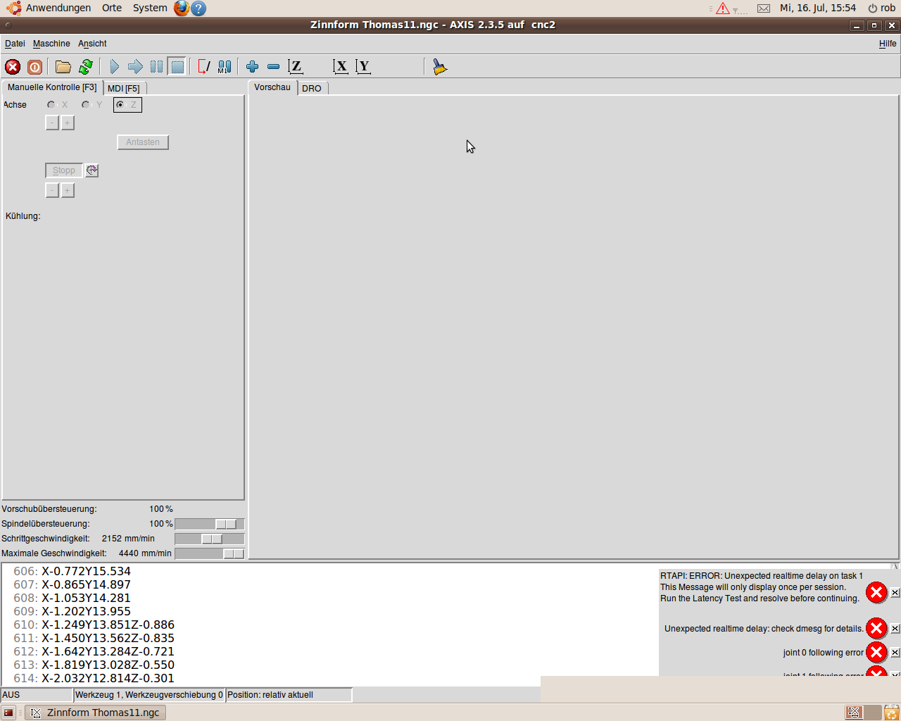

17 Jul 2014 14:57 #48865 by robbe
Replied by robbe on topic machine crash with linux cnc / EMC2
I have run the computer without the machine connected.
I could now reproduce the error in 3 out of 3 tests.
But that takes a few hours.
The appendix contains the log data sorted by start date and start time.
Maybe anyone can see a pattern in it, which leads to the error.
regards
17 Jul 2014 19:32 #48888 by andypugh
Replied by andypugh on topic machine crash with linux cnc / EMC2
You are getting some sort of realtime error.
You also seem to (possibly) have something odd going on with the USB keyboard. Is there any chance of trying with an olde-worlde PS2 keyboard?
17 Jul 2014 19:52 #48892 by PCW
Replied by PCW on topic machine crash with linux cnc / EMC2
I agree with Andy, you have a hardware issue with USB
(and hardware issues especially with USB or the harddrive, often break realtime)
[ 6060.048106] hub 5-0:1.0: port 1 disabled by hub (EMI?), re-enabling...
[ 6060.048119] usb 5-1: USB disconnect, address 5
18 Jul 2014 15:15 #48914 by robbe
Thank you for this hint.
I have now run a test with disconnected Mouse and Keyboard.
If this also shows an error I will try to disable the USB ports in the BIOS and plug the controls in via PS/2.
The fact, that the USB errors occur a long time before the realtime crash is still a little strange to me.
18 Jul 2014 21:21 #48926 by andypugh
Indeed, I would be more sure that was the cause if it was closer in time. I was suggesting an experiment rather than a guaranteed fix.
