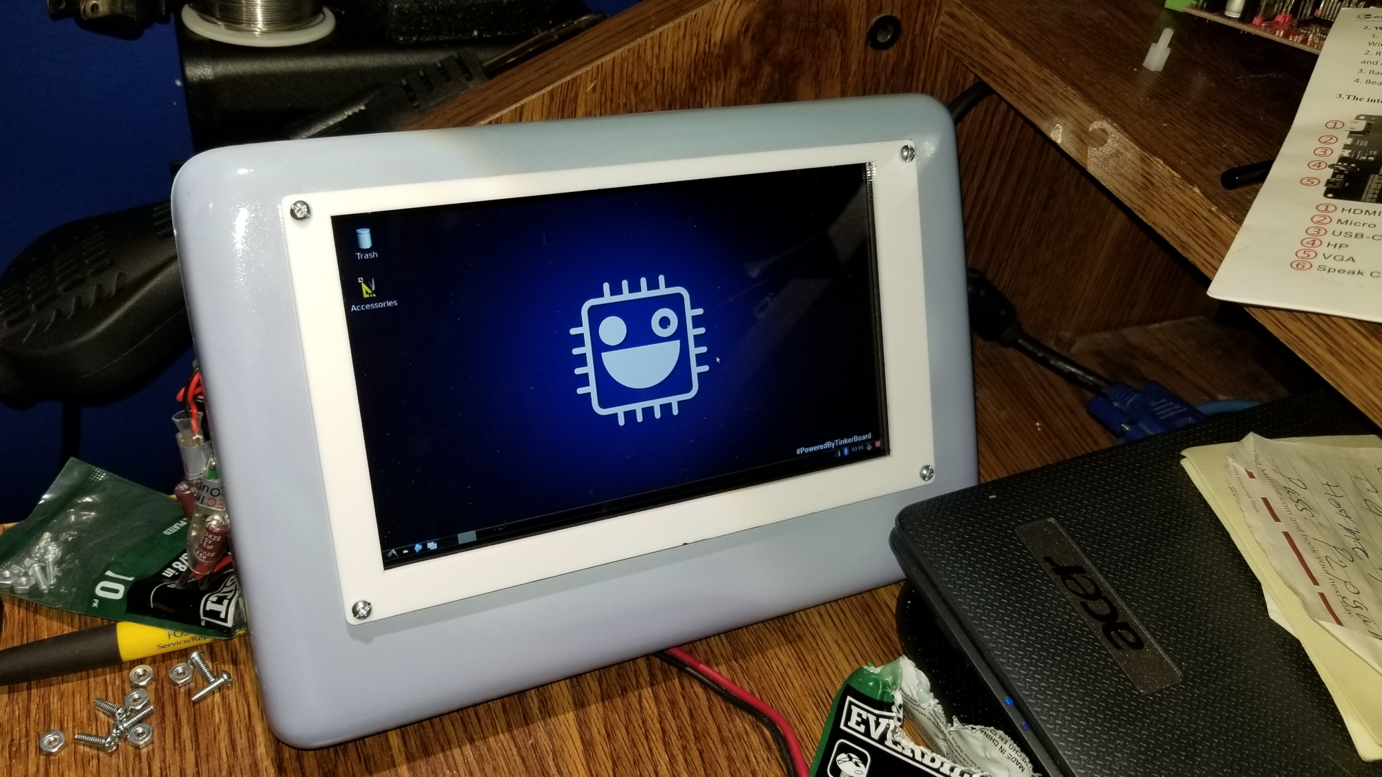

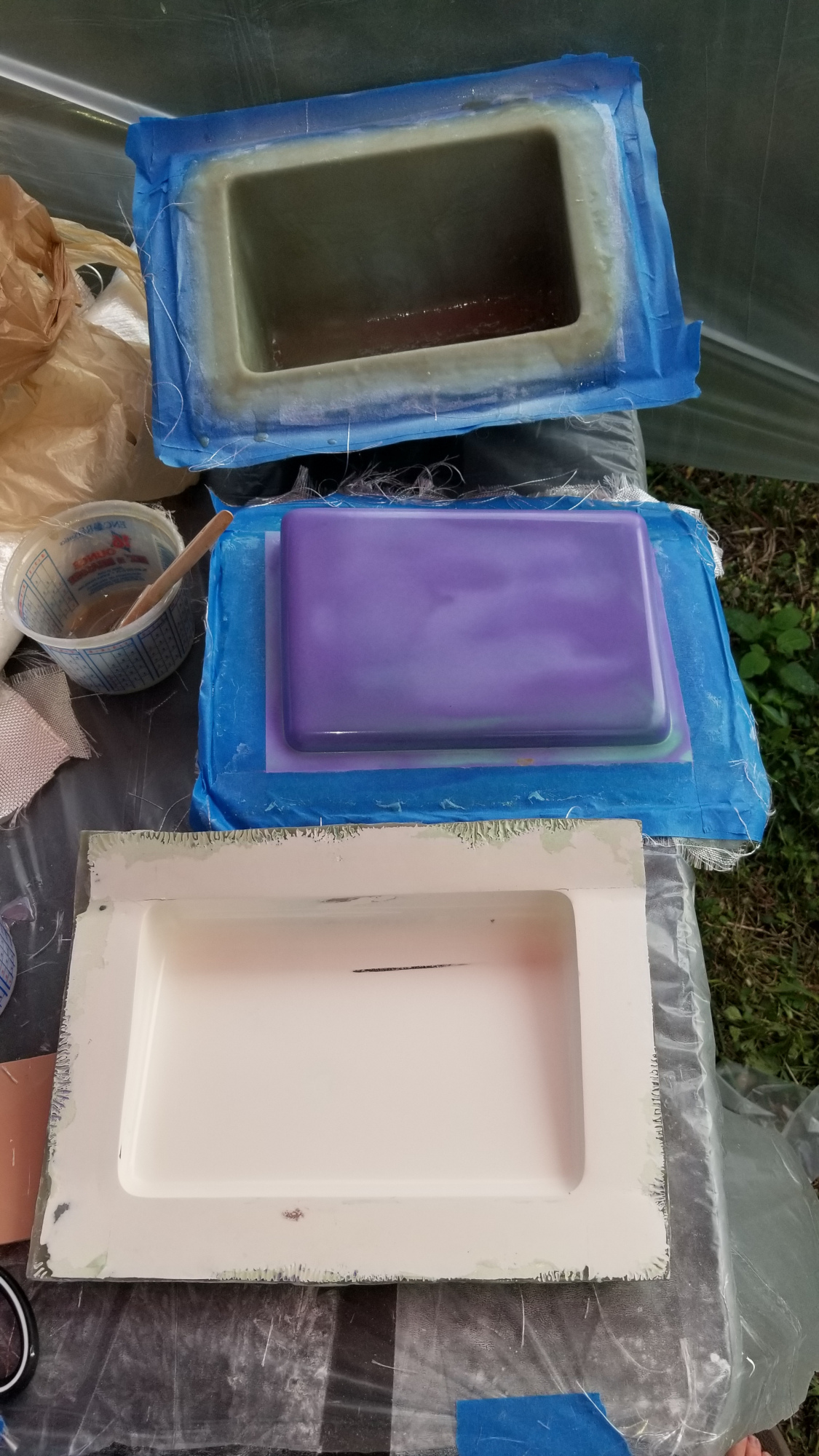

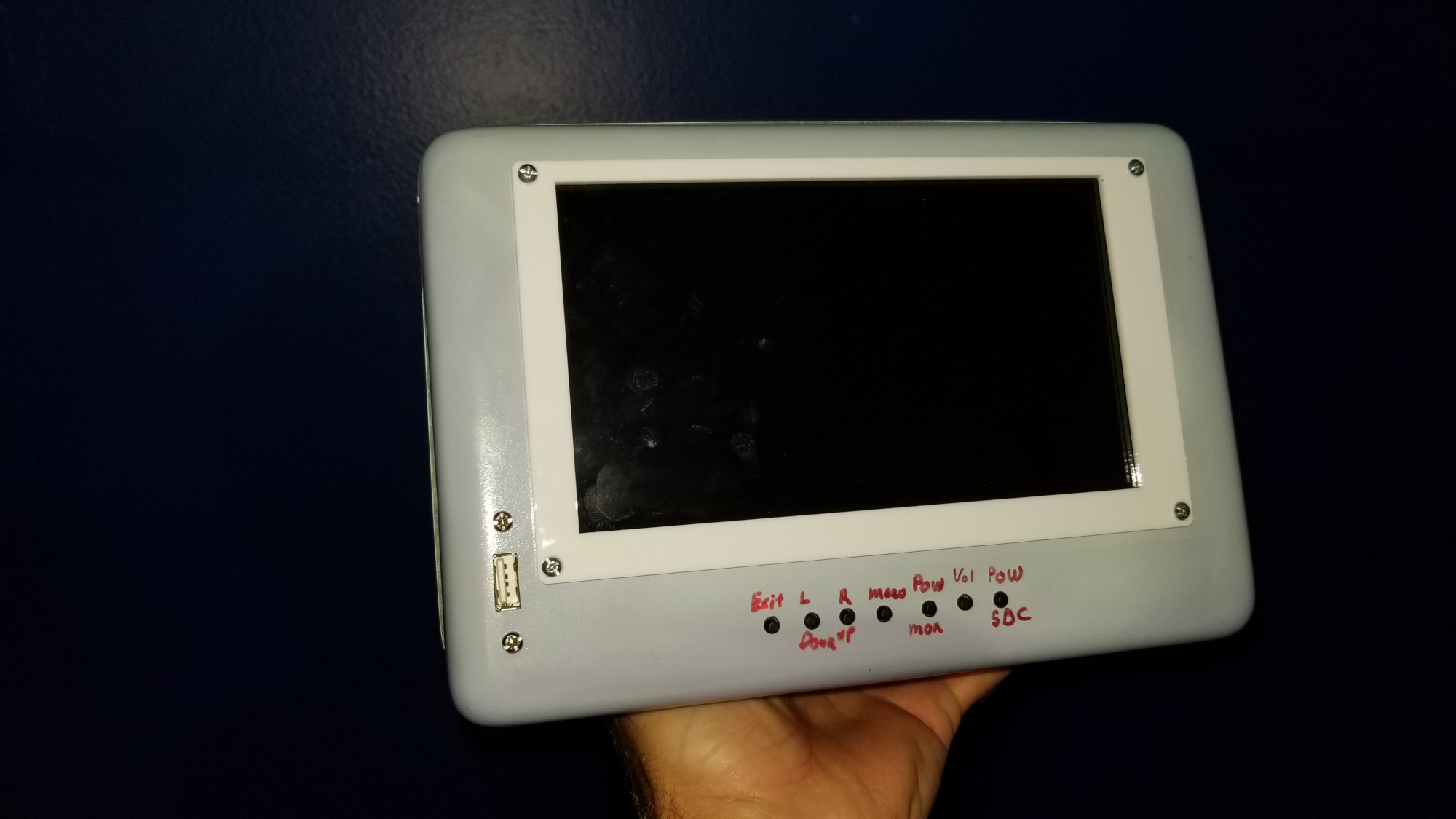

Something to think about.. I'm running armbian on the tinker board... trying to get a real time kernel built though I do not currently have a computer I can use to do so... I have been solving a lot of other issues with the asus tinker board system. I have started a git hub to be a major AID.. My goal is to turn the system into a cnc control ideally a linuxcnc controller. When I get a working realtime/pre-empt kernel i'll upload the image here. currently I'm starting to post howto's on the tinker board. github.com/berinc/Asus-Tinker-Board
I also built a mold to build a shell for SBC's like the PI and tinker board etc....

18 Mar 2019 22:00 #128928 by tommylight
Replied by tommylight on topic Can Asus Tinker Board run LINUXCNC
Nice !
Laser etched writing on the buttons is perfect ! :)
