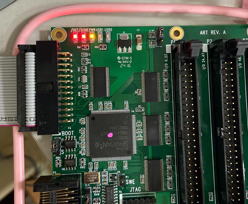

Does the 7I90 configure properly at power-up? (no red lights except a quick blink at startup)
- terry1992
- Posts: 18
03 Oct 2019 20:05 #147056
by terry1992
Replied by terry1992 on topic Can Asus Tinker Board run LINUXCNC
The light blinks just like the attachments shows.
And about 1 second later, only the PWR light remained.

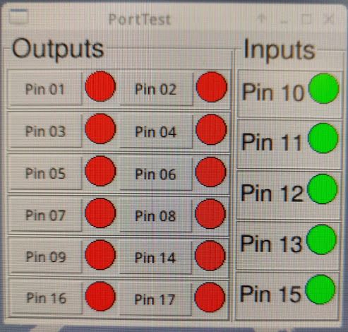

1. I tried to check the parallel port of my computer.
The input are all on when the 7i90 is power on.
And only the input 10 is on when the 7i90 is power off.
Is that normal?

I cant tell but that looks wrong (there's nothing special about DB25 pin 10)
My guess would be a bad cable bad parallel port or bad 7I90
I guess it could also be the the parallel port has a pullup resistor on pin 10
so its high even when the 7I90 is powered down
I would try another PC/Parallel cable and make sure the PCs parallel port is set to EPP 1.9 mode
