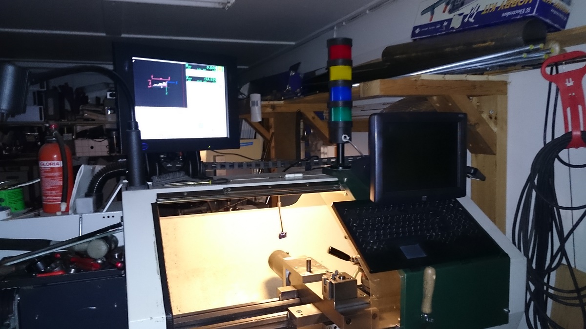

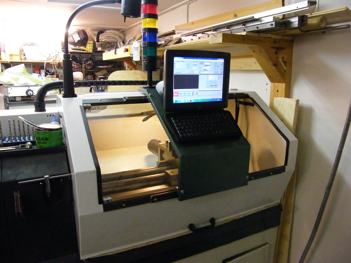

02 May 2017 13:58 #92533
by tecno
Replied by tecno on topic DigiPos 15" touch screen, how to get this up and running in LCNC
sudo apt-get update
sudo apt-get install inputattach
sudo inputattach -elo /dev/ttyS0
sudo gedit /etc/rc.local
# same entries as formerly in ubuntu 10.04 e.g.
/usr/bin/inputattach --daemon --always -elo /dev/ttyS0
exit 0
boot starter program " EloTouchSet "
>>>>>>>>>>>>>>Command: " xinput set-int-prop "Elo Serial TouchScreen" "Evdev Axis Calibration" 32 4081 23 37 4089 "
sudo shutdown -r now
ELO TOUCH works perfect
Did try the link you sent earlier
>>>>>> here it stops so the syntax must be wrong = xinput........
I'm inclined not to use touch due to the size of the screen because I can not mount it at the same location as the small 12 "screen
As you can see it is much bigger and would be fixed at that place as i n picture, still possible to lean over to reach the touch.
Will try....
Cheers
Bengt
exit 0
Will try....
Cheers
Bengt
